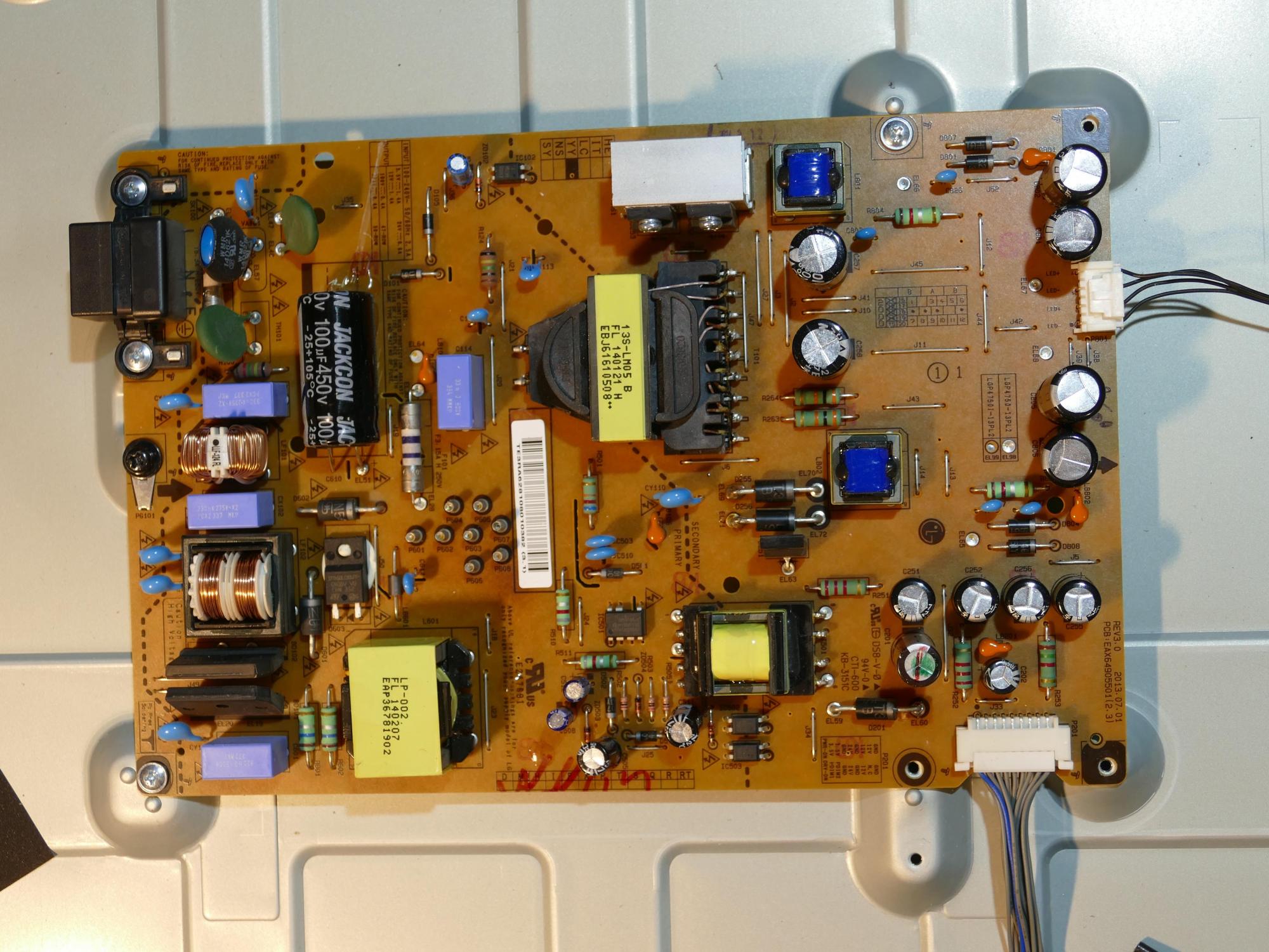

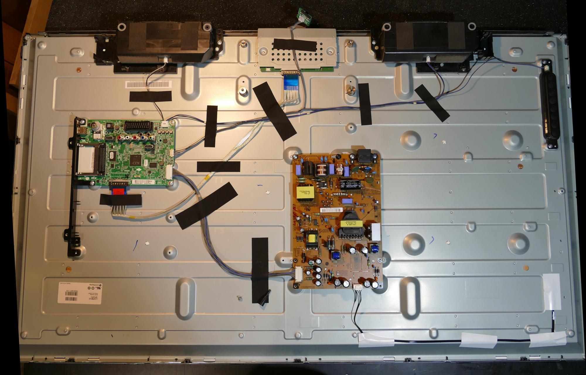

    I opened the back and found a bunch of bulging caps close to the main DC outs on the power board.
    After removing the board I measured high ESR in 90% of the caps which I then de-soldered and rechecked off board. The high ESRs were confirmed.
    I replaced all the electrolytics on the board, checked and refitted. I now have the same symptoms as before - the TV will not power up and the only (continually on) DC voltages are the 3.5V as mentioned above.

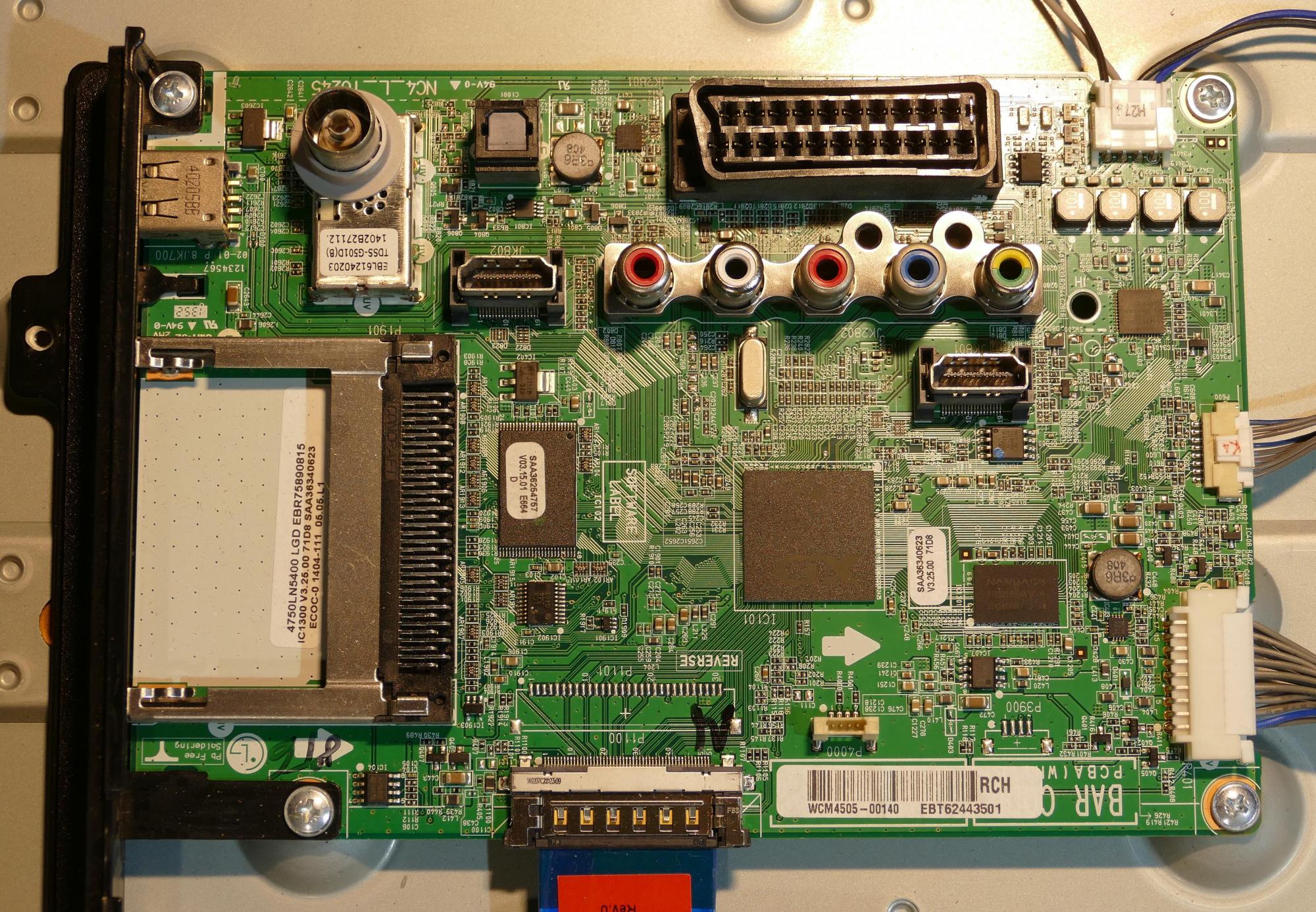

          The numbers on the power board are:
          EAX64905501 (V2.3)
          TE3RA62810801382 (3.1)
          Have tried adding pictures via the insert image icon. I can see the tag but not the image. Here they are via plan B:
          https://www.dropbox.com/s/rknul6e7b7...-edit.jpg?dl=0
          https://www.dropbox.com/s/xu26iv78su...-edit.jpg?dl=0
          https://www.dropbox.com/s/tibtfgq024...-edit.jpg?dl=0

              Here you go.

                    Originally posted by diif
                    Here you go.
                    c257 appears in backwards and looks bloated on top

                      petehall347 is correct, C257 is backwards, and no you can't just turn it around, you need to replace it again.
                      The fact that C247 is bulged like that does suggest the power supply DID turn on as that is the +76 volt line that supplies the backlight circuit.

                        lets hope it didnt get powered up again after the pic . op might be sore from it exploding .

                          OMG! Thank you all so much!! TV Fixed!
                          I replaced C257 and we're in business!!.
                          BTW the bulged cap [47uF/160V]read 49.08uF ESR 0.50
                          BIG lesson learnt - thanks to you all.
