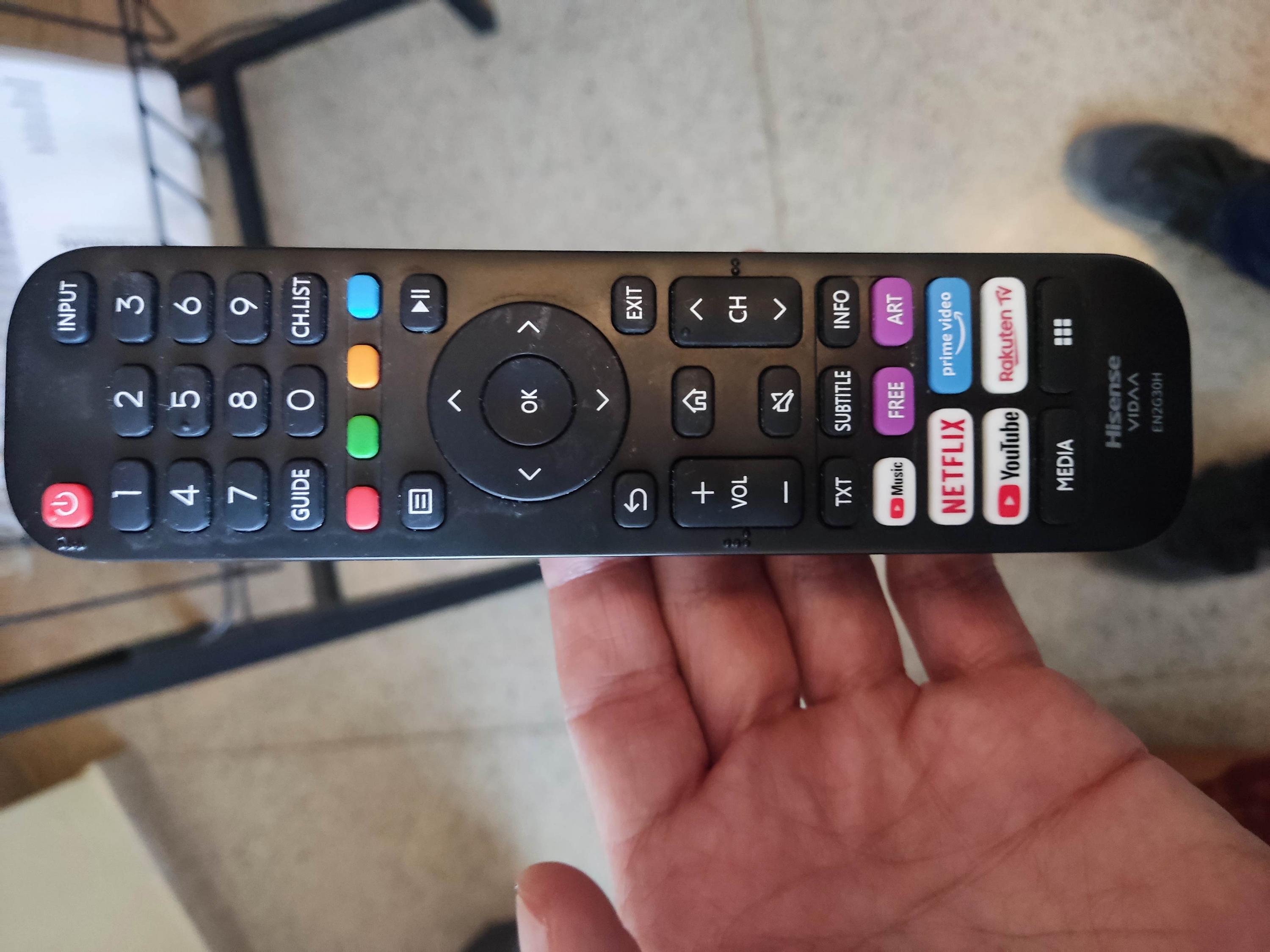

    Hi! I have this TV set that does the following:
    1) I press the red power button on the remote
    2) The TV turns on normally
    3) After that it won't take any other command from the remote, neither power off, volume, channel, NOTHING
    4) We need to either pull the main cable or use the built in button at the bottom to select funcion OFF
    Then after it's off, it would again accept the TURN ON from the remote and same again
    BUT:
    -The remote does show the correct IR beam while observed thru a phone camera
    -The TV works fine while using the MiRemote App in Xiaomi (power on, off, volume, channel, input, etc...)
    -There is no pinhole RESET button in the back of the TV (neither sides, nowhere)
    -There are no switches/pushbuttons at all under the battery cover of the remote
    I want to try a full TV factory reset but I need the remote to work, and the Xiaomi MiRemote emulates all buttons correctly except the OK button, which does nothing (this happens to me on other emulated remotes) so I have no way to enter into the setup option.
    Anyone can suggest anything to try?
    Thanks in afvance!

                            • Diah
                              • Feb 2013
                              • 6357
                              Re: HiSense 55A7500F won't obbey to remote after power on
                              upload here clear photo for yours RC

                                • edugimeno
                                  • May 2017
                                  • 568
                                  • Spain
                                  If you mean "outside" here it is. I don't have a pic of it inside here
                                  • nomoresonys
                                    • Jan 2013
                                    • 12113
                                    • U.S.
                                    Did read the whole thread, just because all buttons are emitting a signal doesn't mean the signal is correct, have had more than a few remotes that emit signal but just didn't work.
                                    • edugimeno
                                      • May 2017
                                      • 568
                                      • Spain
                                      Just because all buttons are emitting a signal doesn't mean the signal is correct, have had more than a few remotes that emit signal but just didn't work.
                                      I understand, but again, why does the PWR button work when the TV is off and then does not work when the TV is on?
                                      • nomoresonys
                                        • Jan 2013
                                        • 12113
                                        • U.S.
                                        I had a a bad remote that worked like that not long ago, also had one that the only button that didn't work was volume down.
