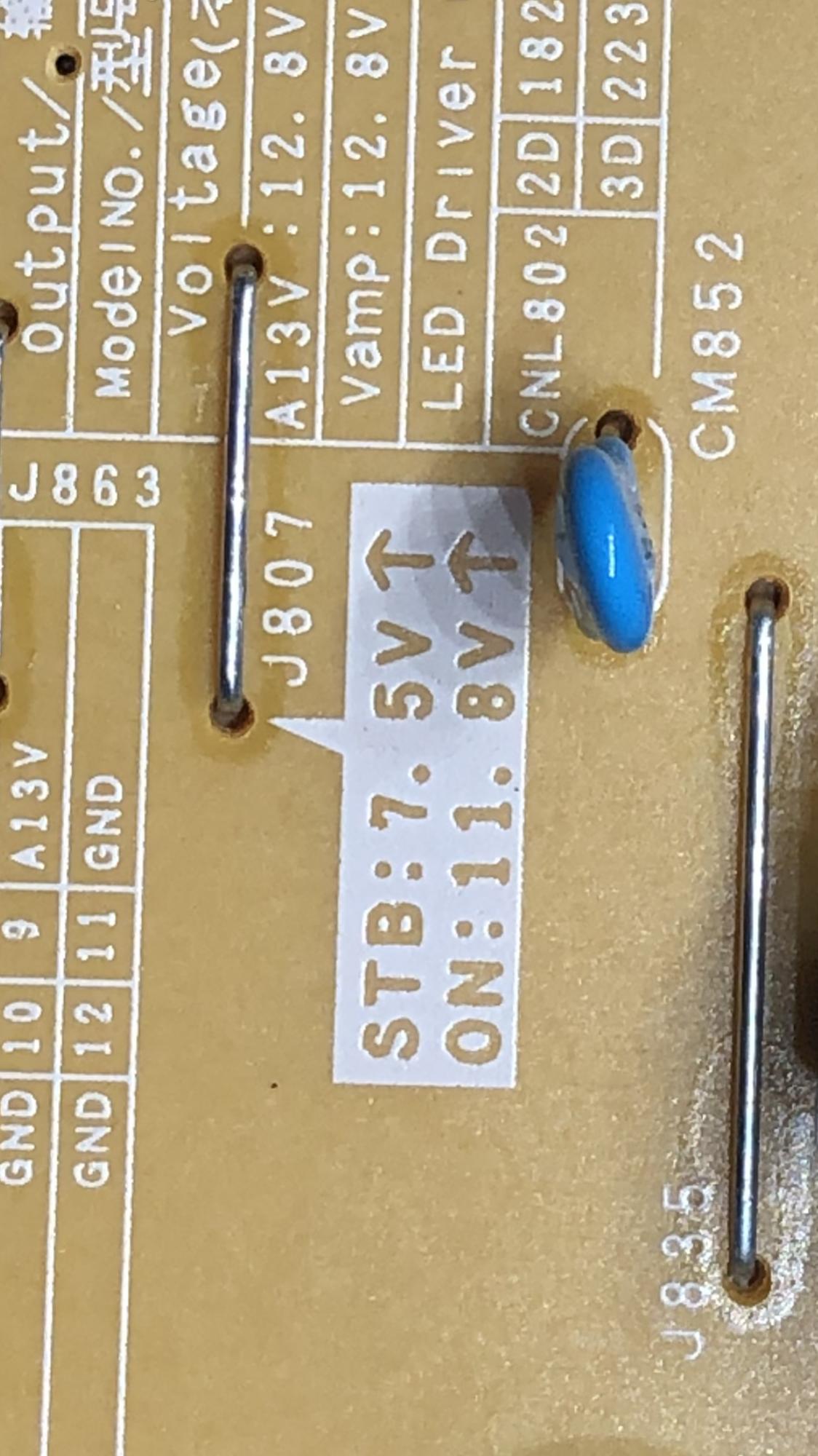

      Hey R_J, should I be concerned the voltages are higher
      2V for standby
      1V for on
      Mark

          Re: Samsung UN65MU6500FXZA won't turn on
          I would not be concerned, It is very likely the board is marked wrong. If you look next to that voltage mark it says A13v:12.8V which is the same point
            Thanks for the reassurance. I’ll get a main board and post back.

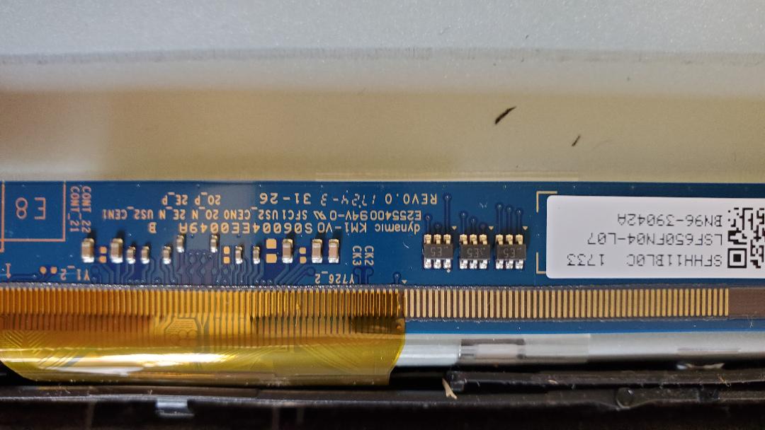

                  We are seeing a lot of these coming in with a short in the lower driver board. It's tedious to go through the caps removing them one by one to find the short but it's doable. If your Tv backlights and optical on main board are turning on and off unplug the Tv and remove on ribbon cable going to the panel one at a time. If the backlights and optical stays on then the short is on that side you have disconnected. You have to remove the speaker and the lower driver board cover and test those itty bitty caps. Solder tweezers really come in handy for this job. You can also isolate it since each side has two bottom boards by disconnecting the U shaped ribbon. I am seeing most coming in with 3 green and one blue and the short was always on the blue. It's almost like Samsung had a "Houston, we have a problem here" and shoved a piece of crap board in there just to get by. It's marked BN96-39042A Once you unhook that oddball blue driver board the backlights and Tv stays on fine in most cases if it's not the Main board. Check two caps next to CK2 and CK3 on that blue board. We now save the lower driver boards on damaged panel tv's to get the good caps off them for future repairs. I also tell all my customers to avoid this model like the Covid19 virus because this is happening on 2 year old Samsung's and that's not worth the money SAMSUNG! Samsung engineering>
                    More failed MLCC.

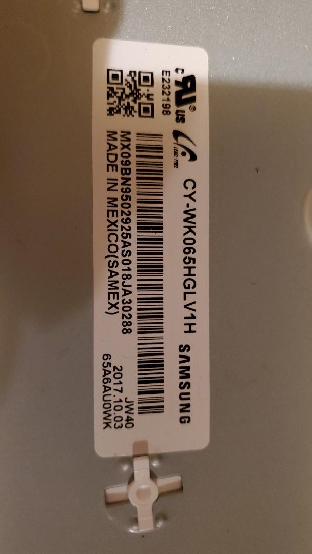

                    Is that SAMSUNG LCD panel, or other OEM?
                      Yes Bud...more crap from Samsung in their quest to do away without a Tcon board it's taking these caps out prematurely. Samsung panel for sure....here's the panel number. It's a pain in the ass repair and we are so busy we don't even do them anymore for fear another one will go out.

                        LCD panel Made in Mexico? I did not expect that.

                            BruceTV, you have perfectly described the issue I am having with a UN65MU6500FXZA. I plug it in and the backlight and TV come on for a few seconds, then powers off. If I unplug the mainboard, it stays powered on and lit up. I read this post and saw that I do have 1 Blue and 3 Green lower driver boards. I tested with just the blue one disconnected, and it stays on. I also tried with the blue one connected, and the other side U cable removed, and it stays on. This leaves me wondering if I have the same issue or not. The blue board is marked BN96-39042A.
                            Any help would be greatly appreciated.
