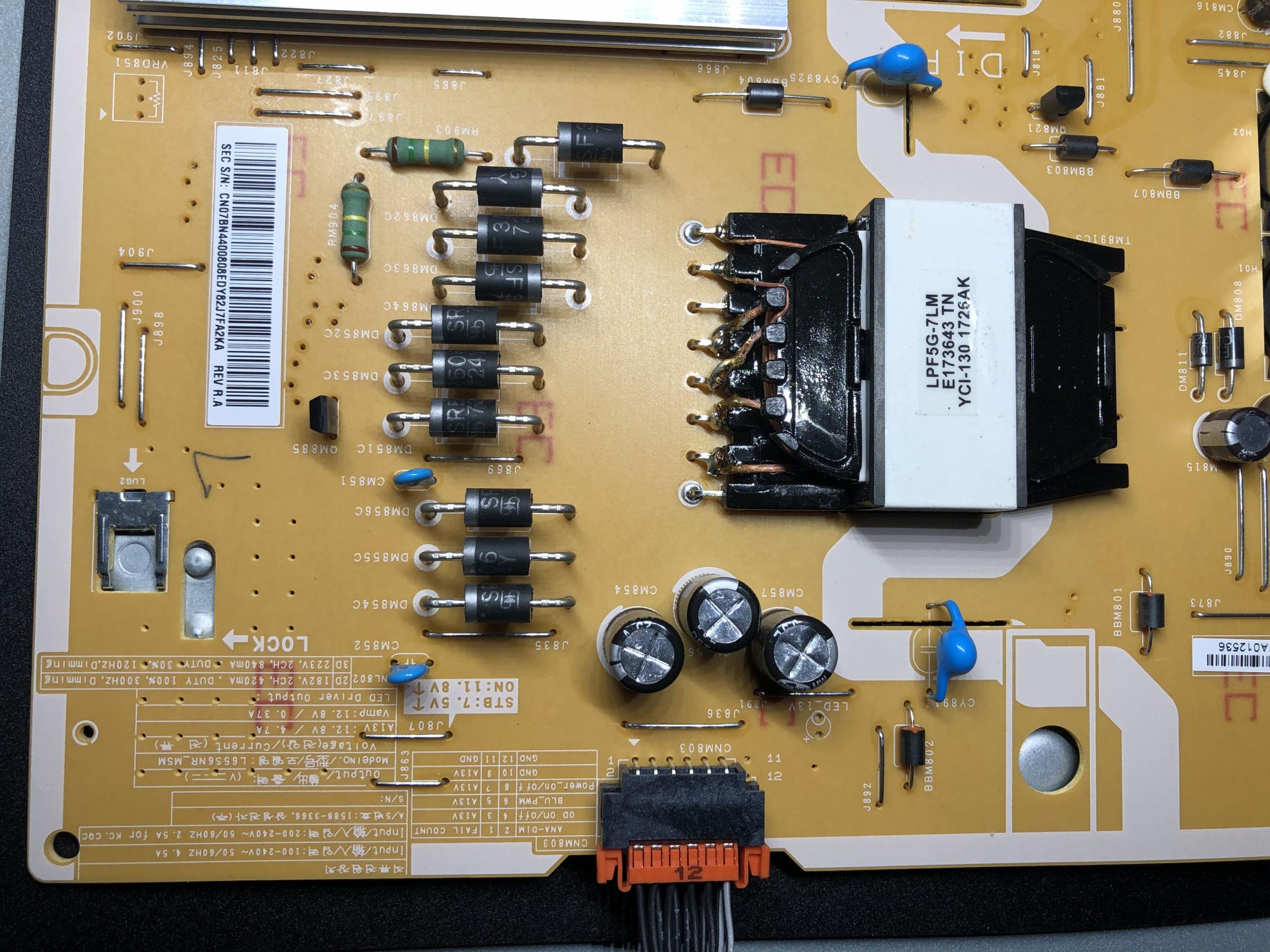

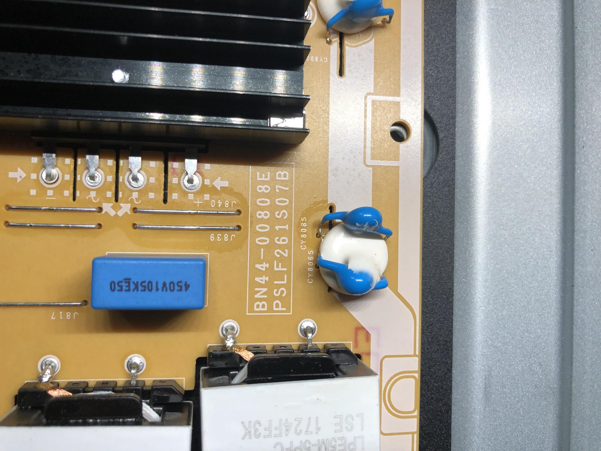

      Re: Samsung UN65MU6500FXZA won't turn on

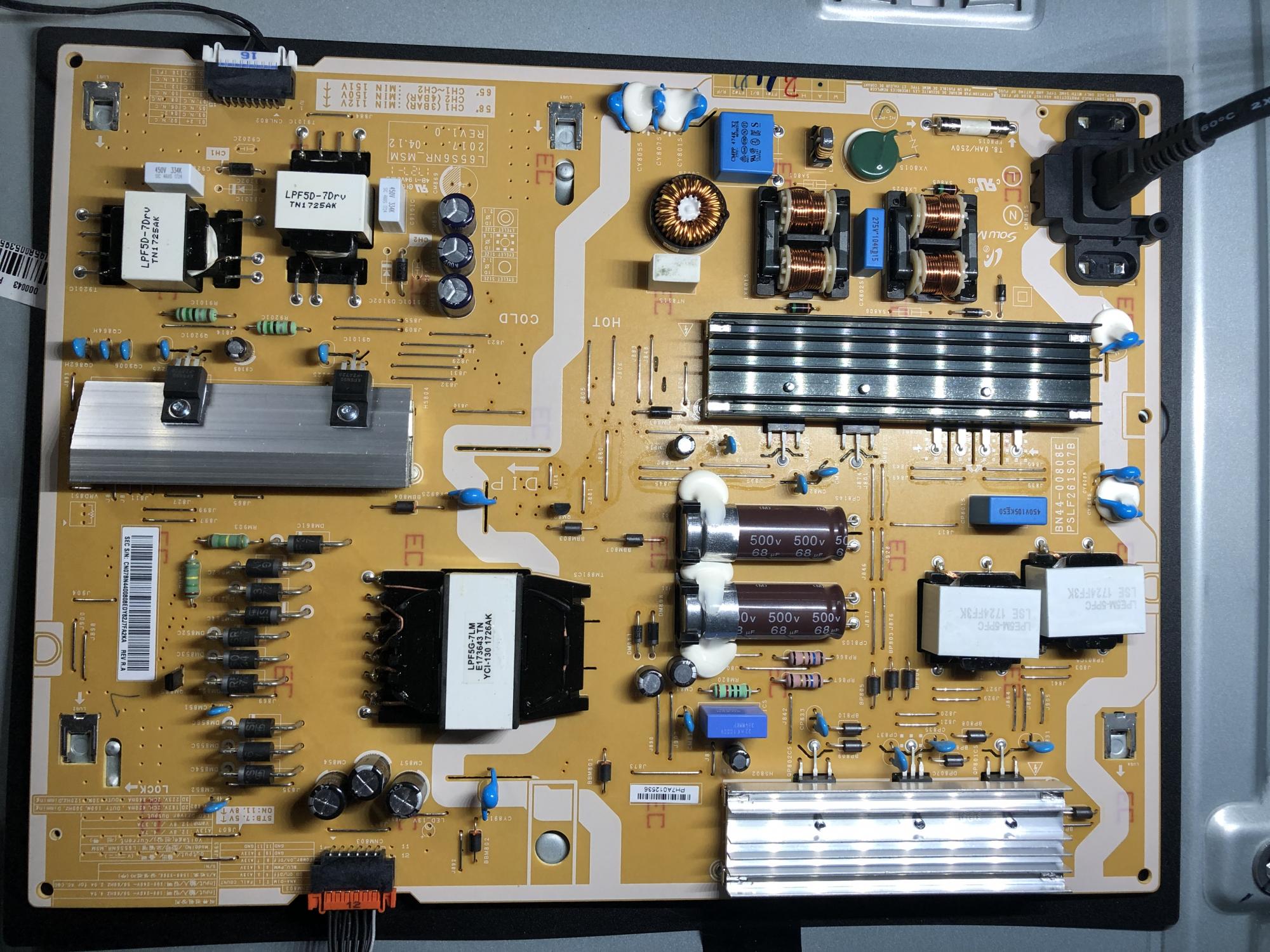

      Here are some pics of the power supply. The bar that says stay pwr is zero if this helps
      Thanks Mark

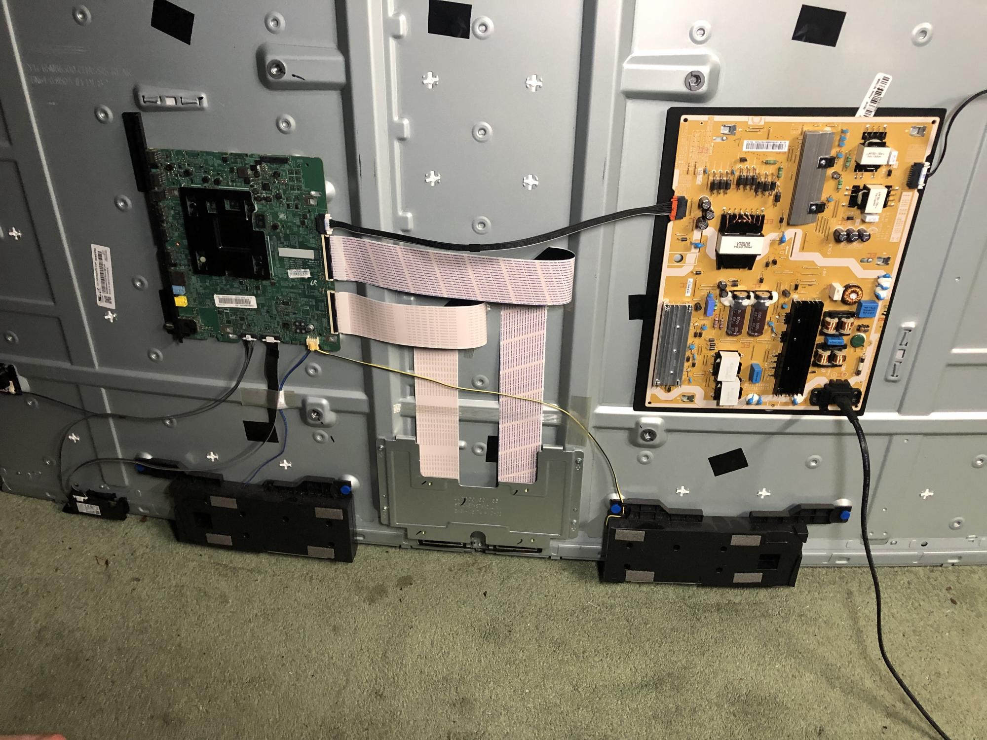

            Hello nomoresonys and CapLeaker, thanks for the replys I will do test 3. And CapLeaker there is no power LED when I hit the power button that I can see. I am not that familiar with this TV I am trying to help a friend. Where is the light located. I will go and do the test for you nomoresonys.

            • R_J
              • Jun 2012
              • 9588
              I see that you have backlights etc. with the main dissconnected so the power supply must be ok.

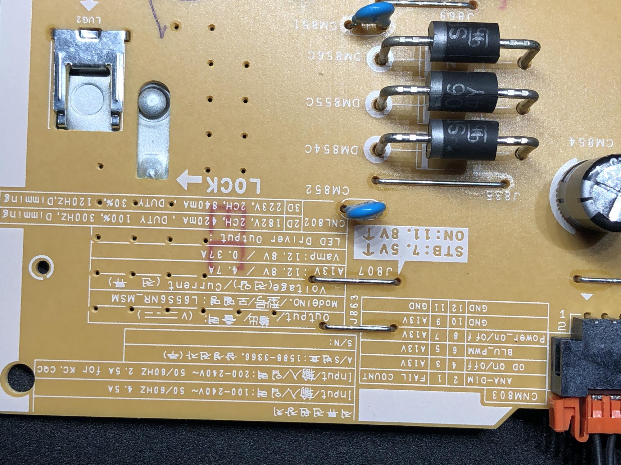

                  Hi R_J j807 is 9.66VDC. the one above that is 0VDC
                    Pin #
                    1 FAIL COUNT 0
                    2 ANA-DIM 0
                    3 A13V 9.67
                    4 OD ON/OFF 0
                    5 A13V 9.67
                    6 BLU_PWM 0
                    7 A13V 9.67
                    8 POWER_ON/OFF .103
                    9 A13V 9.67
                    10 GND 0
                    11 GND 0
                    12 GND 0
                    All these measurements were the same with power button not activated and activated.
                    thanks Mark

                    • R_J
                      • Jun 2012
                      • 9588
                      Is that J807 9.66 volts with the mainboard connected or not? It should be around 7.5v in standby and then go up to 11.8v with Power_on/off (or with the main board disconnected)
                      I suspect the 9.66 is the standby voltage, so if you are not seeing the Power_on/off line voltage change when you push the power button, your fault IS on the man board and it could be a faulty eeprom, Shopjimmy does have them available so it can be the problem. (If you order one, get the correct one for your board)
                      • Rotorcraft230
                        • Jan 2015
                        • 27
                        R_J, j807 is 9.67 with everything connected. if I disconnect the main board connector it goes to 12.84 and the back light comes on.
                        Mark
                        Successfully fixed: Sanyo 42" LCD, Sony 52" Bravia XBR9,
                        • R_J
                          • Jun 2012
                          • 9588
                          Ok, then that power supply is working like it should.

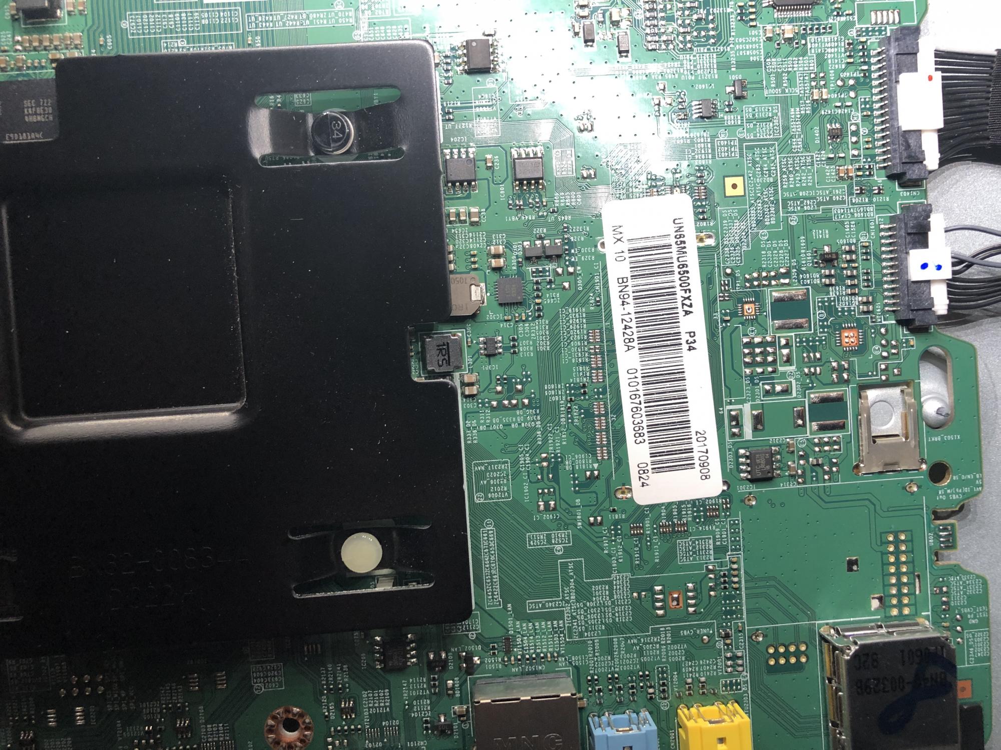

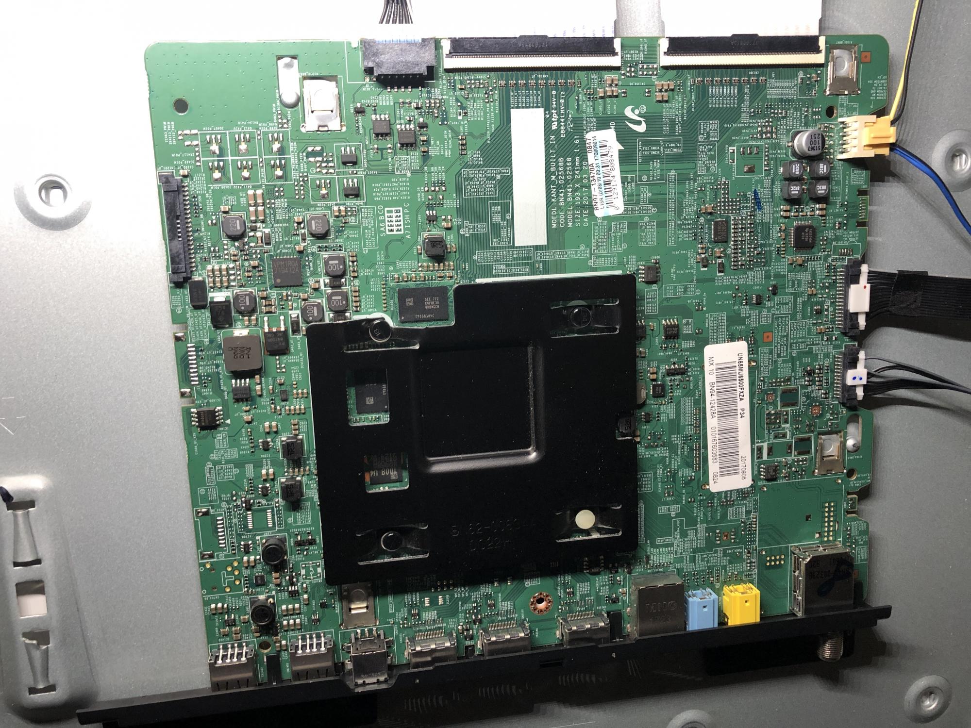

                              • Rotorcraft230
                                • Jan 2015
                                • 27

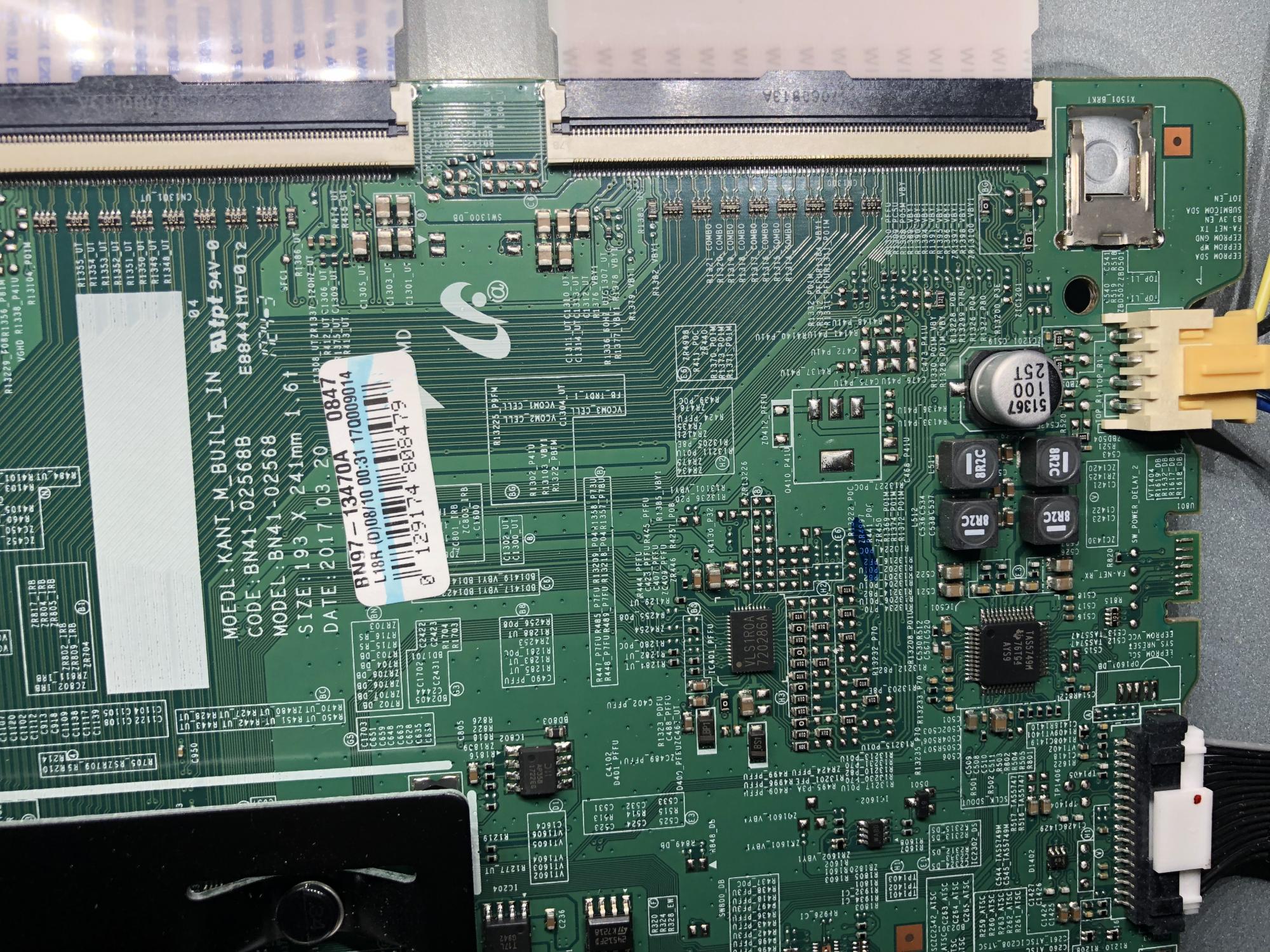

                                Hey thanks nomoresonys. There are lots in EBay the one you found isn't the same one my TV has but I appreciate you spending the time looking.
                                I just was wanting some guidance on diagnosing. Sounds like a main board problem. Here is the one from my TV
                                  BN94-12428A and BN94-11709A will both work.
                                    Ah sweet. I will shop for either one
                                    Thanks nomoresonys!!
                                        Mark
                                        That IS the one you need, done this many many time, I would not steer you wrong.
