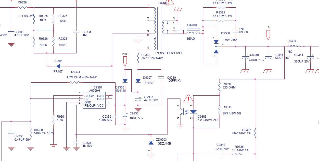

              Here is a very similar circuit

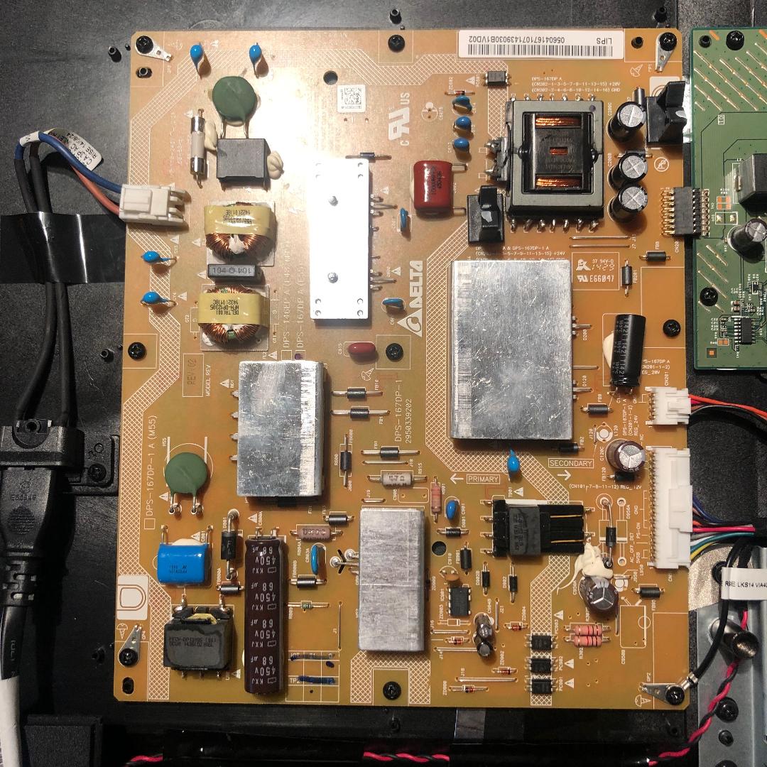

                      How about uploading the pictures so we can see what we are dealing with.

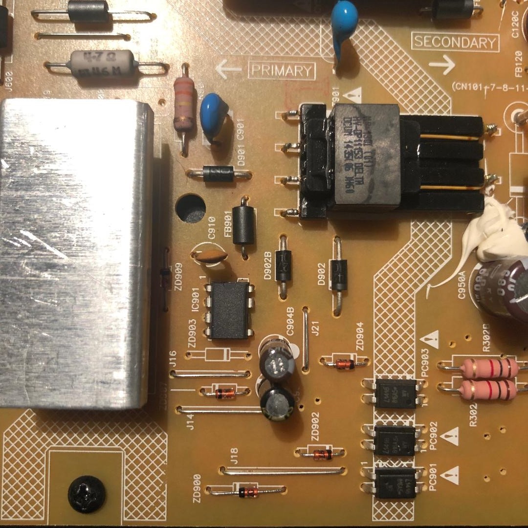

                        I understood hot-ground to refer to the "negative" of the 120V from the wall. Here is a picture of my circuit board.
                        I think what I did actually only indicates that I have no power across the components. The voltage is the same as the line voltage. Where is the main filter cap? Is it the large capacitor in brown at the bottom left of the board?

                          The main filter cap is the brown cap rated 450VDC.
                          Negative leg of the filter cap the circuit ground ref point for the hot side circuit ground.
                          So why are you measuring AC?

                            Re: Vizio E550i-B2 no power, no sound, no LED -- blown IC found
                            Measuring the voltage between the negative leg of main filter cap and each pin on the IC, I got the following results (in DC):
                            Pin1 (top left): 0
                            Pin2: 0
                            Pin3: 0
                            Pin4: 0
                            Pin5 (VCC): 10-20V (consistently varies wildly, it is unstable)
                            Pin7: 166V
                            Pin8: 166V
                            Measuring D902B bottom-side results in same fluctuating voltage as Pin5, so I assume this is upstream thing? Not sure if this is even something to be concerned about?
                            (I began measuring VAC when I had difficulty getting stable voltages with my erroneous method)

                                Check the zener diodes around the ic, the one connected to pin 4 might be bad, or the optocoupler could be damaged

                                  Using an un-powered circuit, I investigated the diodes surrounding the IC and everything had a forward voltage of 0.6V, except for ZD909 (to left of IC). It had 2.1 ohm resistance, and 0V reading (using diode setting on DMM), in either direction. This seems to indicate that it's toast, no?
                                  • R_J
                                    • Jun 2012
                                    • 9551
                                    ZD909 has a resistor (4R7Ω) across it, so it is likley ok but to be sure just unsolder one end of the diode and check it

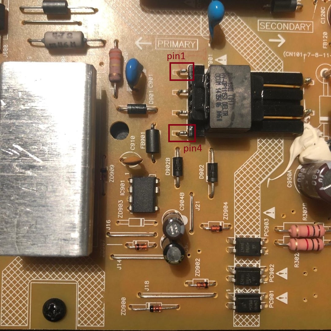

                                    Check the resistance of the transformer feedback winding, betweens pins 1 & 4 of T901,it should be less than 1Ω, then check the resistors, R908a~c they should read about 1Ω total.

                                      1) I pulled ZD909 out half-way, and I was getting 0.018V in both orientations. This seems to confirm that it's kaput.
                                      2) I checked resistance across what I think is pin 1 and 4 of T901 and got 0.5Ω. Picture is attached of this resistance reading.

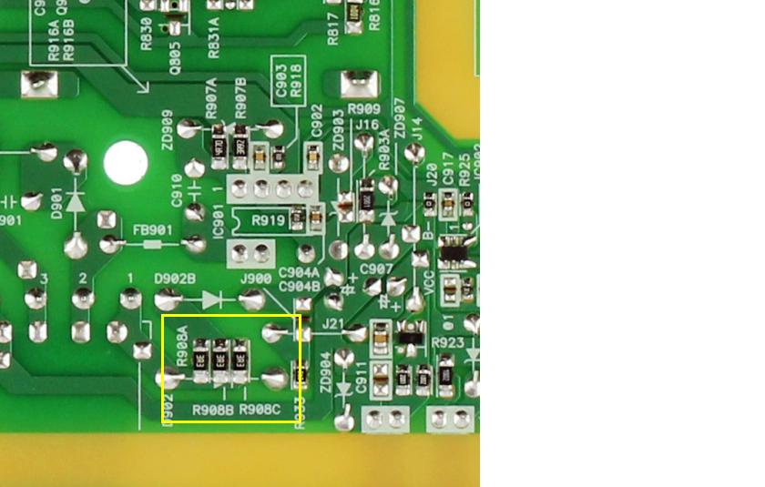

                                      3) I'm not sure where R908A-C are. Did you take those values from my screenshot? I was not able to find any resistors of this number, nor any that had an A-C series.

                                        I was only going by a sj picture of the board for the resistors, maybe your board is different
