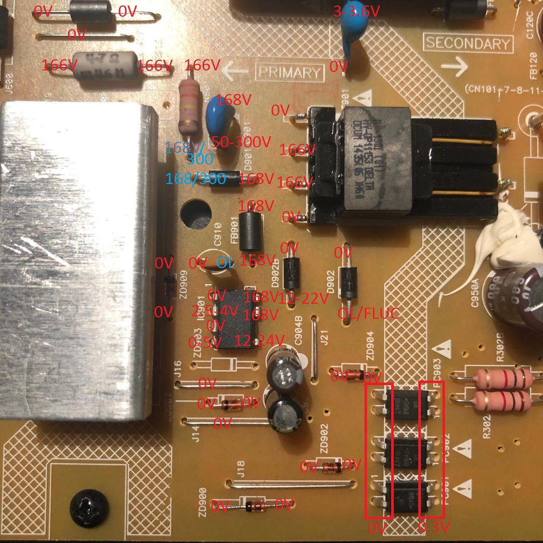

              Did more testing of the voltages, as well as checking the resistors again. Also checked continuity.
              1) Found nothing continuous with Pin1 + 3 of IC901. 3 is GND--maybe no issue. 1 is "S", which is source terminal of internal power MOSFET. PDF recommends connecting with a sense resistor to GND--maybe also not an issue.
              edit: Pin 1 and 3 are continuous with an elements closer to the main cap, so soldering is not an issue.
              2) Many of the resistors appear to have no power across them, as their voltages appear identical on both sides.

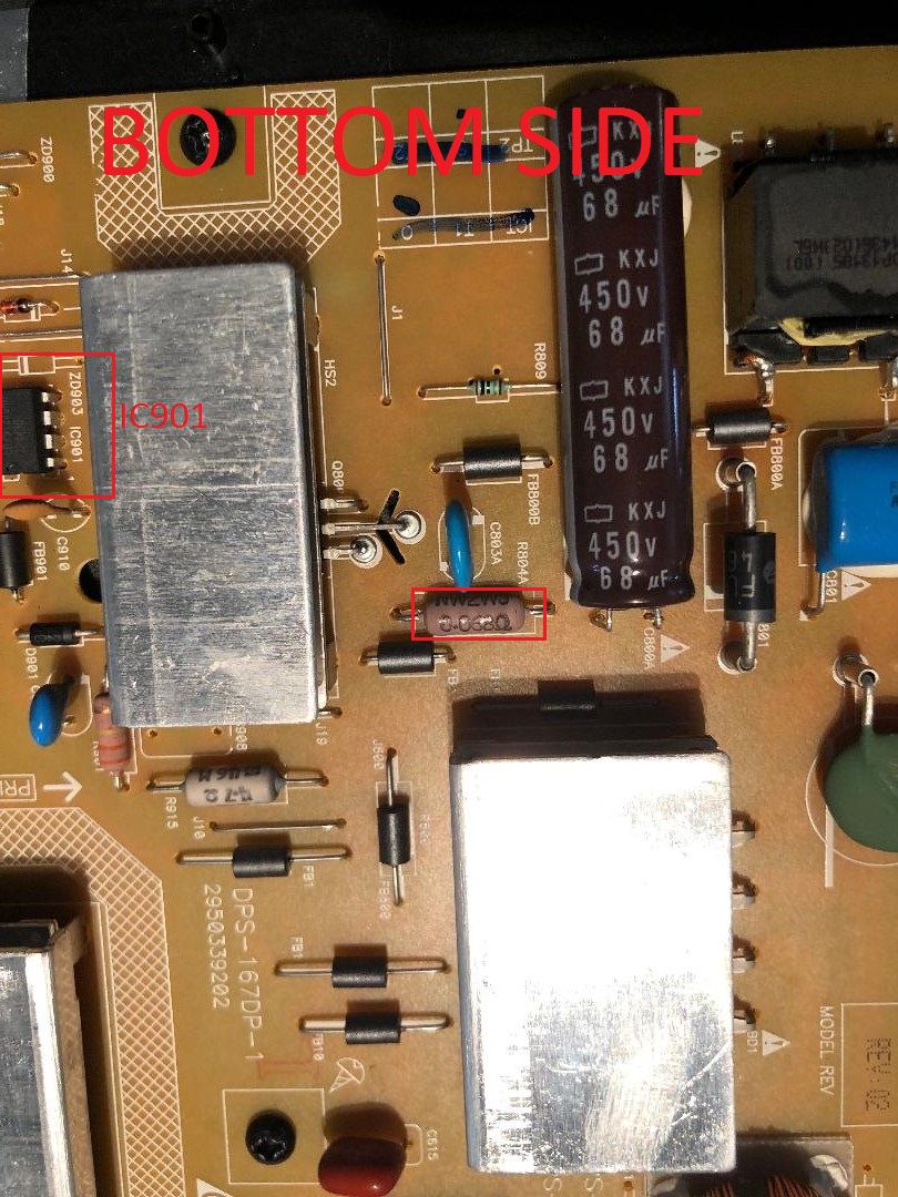

              3) R804A, which is near the main cap, has 0.2 ohms of resistance. It's marking is 0.068Ω (68mΩ). Maybe a problem. Shown in second uploaded picture.
              4) ZD909 (which has been replaced) is showing no forward voltage again, while connected to the circuit (I know this isn't best way, but it's showing same characteristic as previously replaced diode, unlike the other zeners)
              edit: all voltages are taken with regards to the negative leg of the main cap.
              Also, where and what voltage tells us the cold side is getting powered successfully, and therefore IC901 is repaired?

                R804 is likely good, you need to consider your meter lead resistance whne checking very low value resistors. What is the resistance with your meter probes shorted together
                  Good question. It's 0.1 ohm. So the measured value of R804 is within a rounding error.

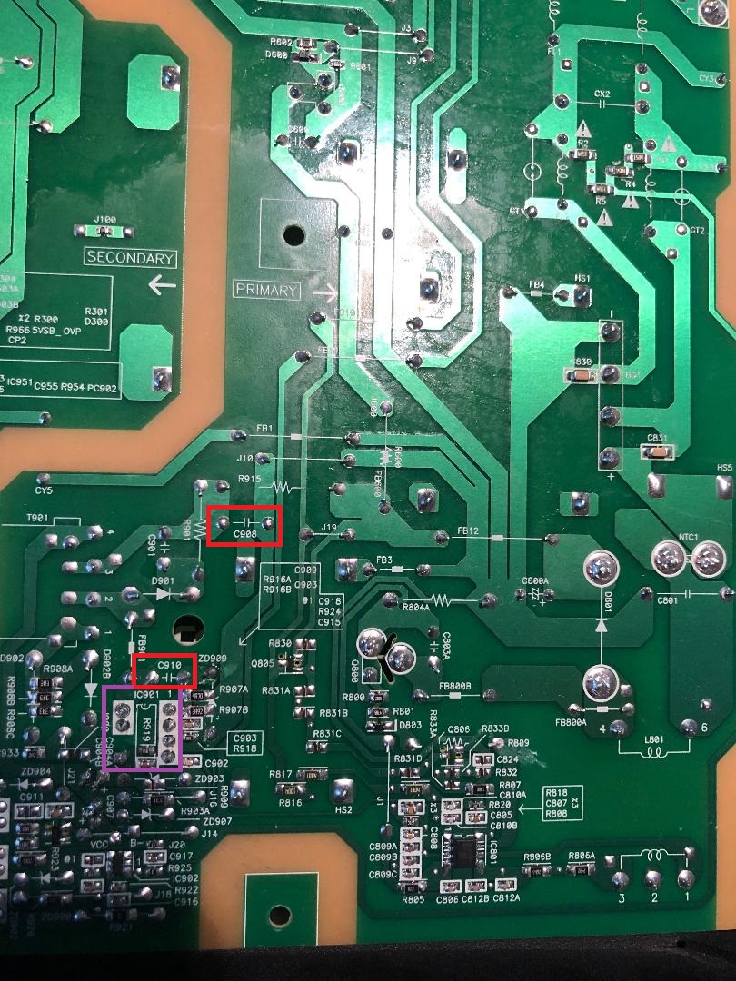

                    I replaced the power board and now my TV is back online. Thanks for the effort, all.
                    I'm going to try to find the root cause by comparing the two. I would still love any assistance if anyone is interested in getting to the root cause here, as the original board is still broken.
                    Edit: Found that C910 and C908 have different values while in circuit, which seems to indicate something nearby is different. This is shown in picture. Capacitors in red have 73uF capacitance in good board, 140uF in bad board.
                    I started looking around the IC when I found that the new PCB has very stable voltage (~18V) on Pin 5 of IC901--while connected--whereas the old board did not (fluctuated 12-24V).
                    I measured many of the diodes and resistors around IC901 and found them to be identical.

                      Regarding C908, Have a look at the other side of the board. C910 is a disc cap, likel a few pico farad. Are you checking and comparing both boards voltages in standby?
                        Yes, both boards were in standby (power connected, but not turned on).
                        A little bit amusing maybe.. there is no element on the topside at C910. So.. I'm not sure what to think about that.
