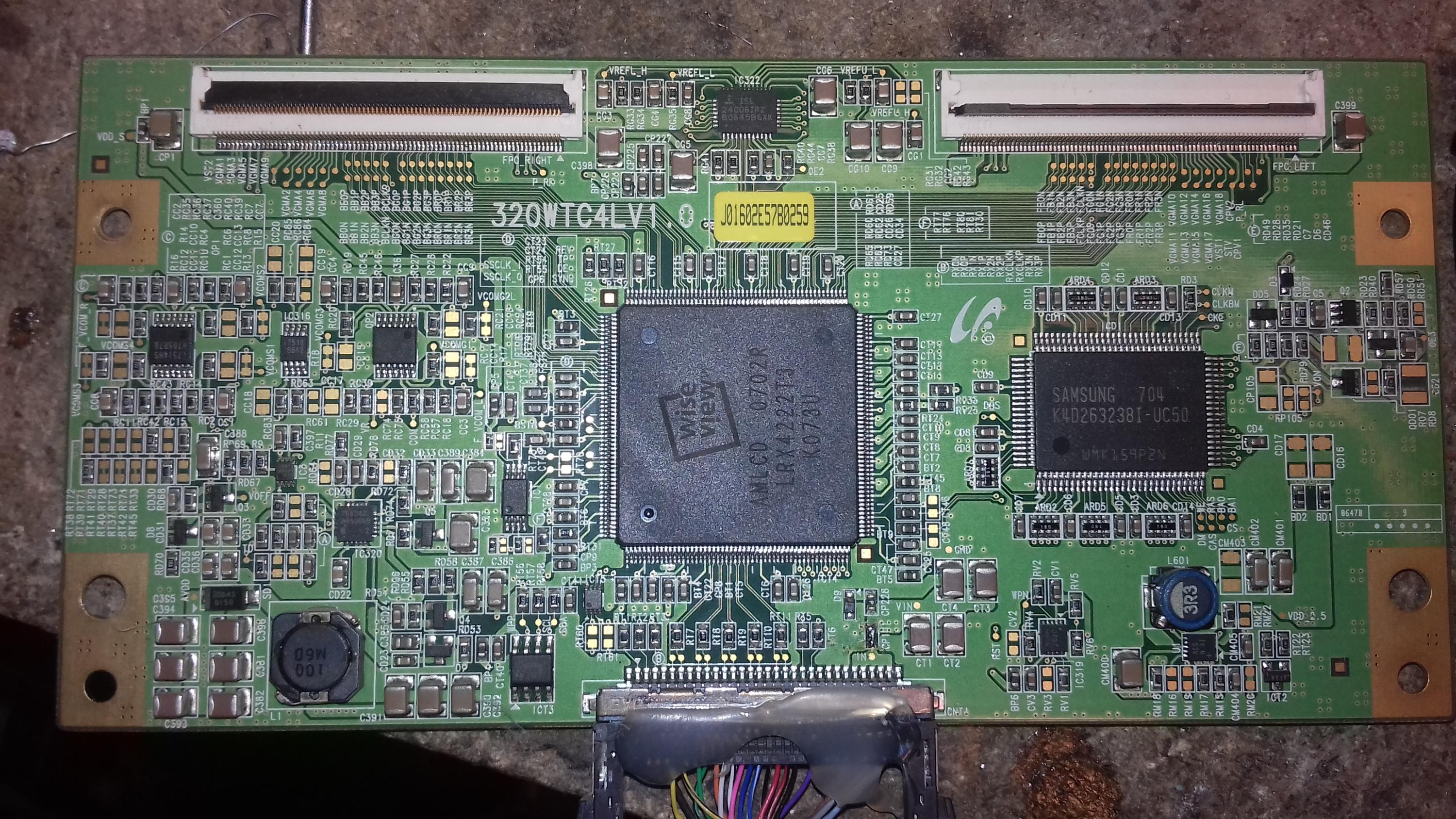

    bad tcon fuse
    sorry i dont have pics or board number to hand .
    main fuse 4.7v one side 0.47v the other side . the fuse measured 0 ohms yesterday . today after testing voltage it measures 7 ohms . is there anything i should check on the tcon board before replacing the fuse . fuse is 5 amps measured on board .
    might this just be a case of a worn out fuse i wonder ?
    Re: bad tcon fuse
    Check the resistance on the load side of the fuse against the T-CON circuit ground, you should check the resistance between T-CON circuit ground against test points AVDD, VGH, VGL, etc, if you can locate them

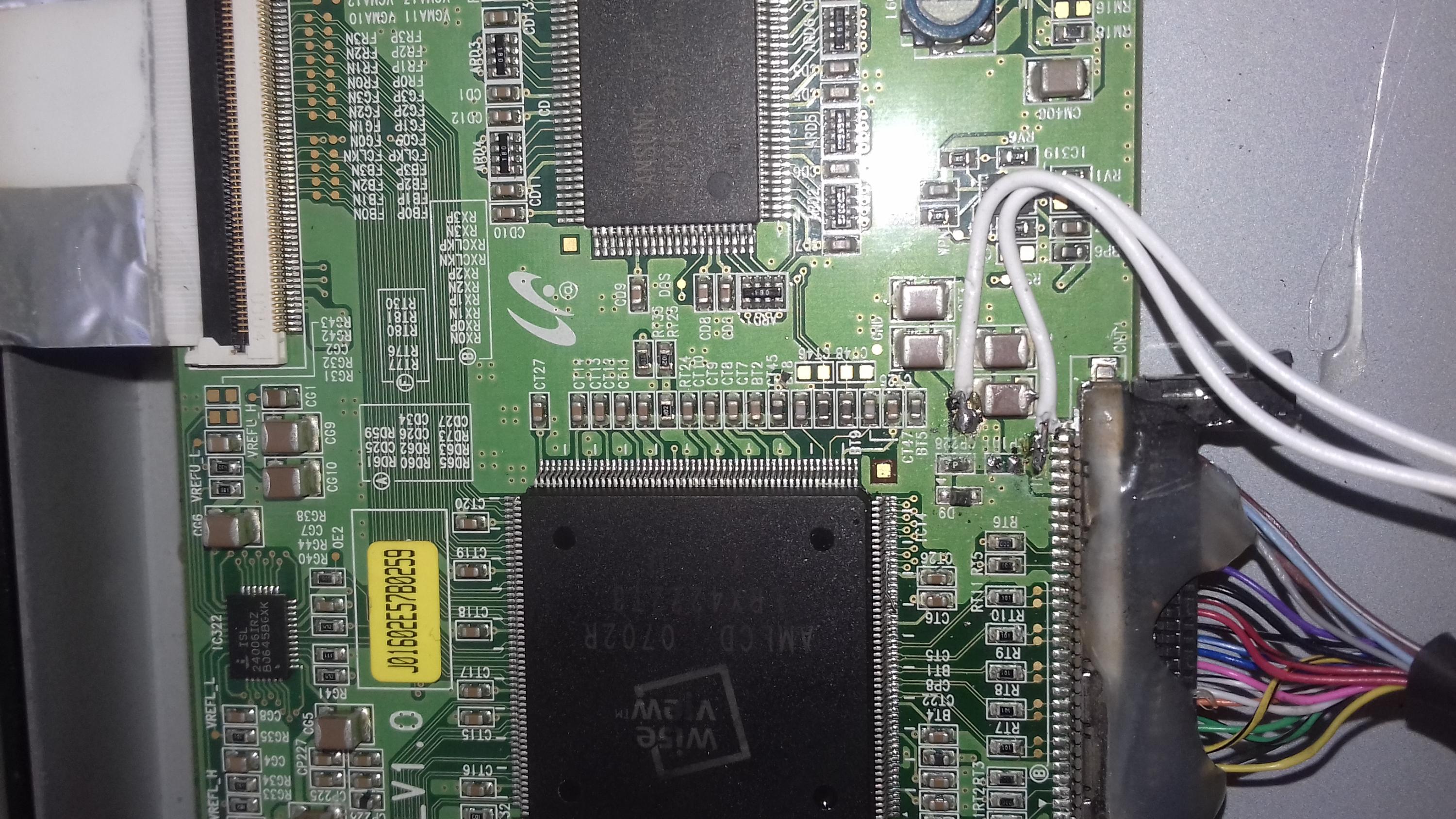

        Re: bad tcon fuse
        ok no apparent shorts so soldered 5 amp fuse wire on top of old fuse and now have picture . think i will get some new fuses for it just in case something goes wrong . tiny little things they are .think it is marked with an s and i believe it to be 5 amps .

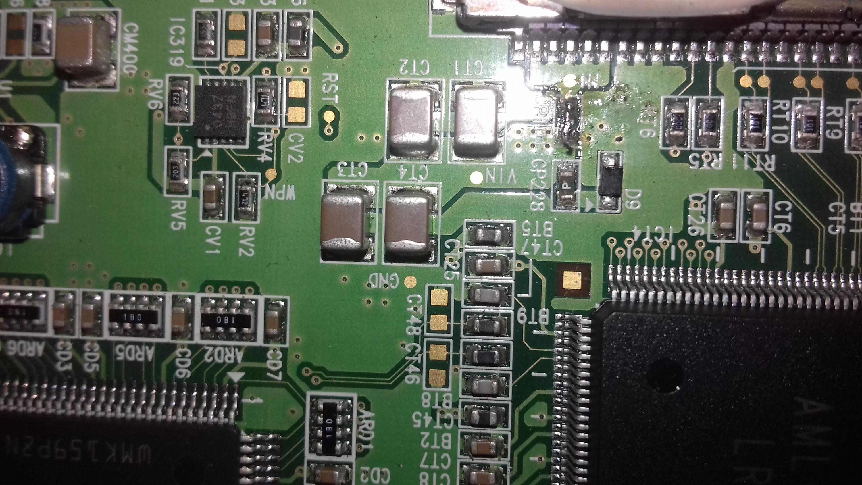

          Re: bad tcon fuse
          its a p and green . about 1.65mm x 0.86mm .. just looking up code for sizes

            Re: bad tcon fuse
            here is the board fuse is cp01 . excuse my messy soldering of the fuse wire . same as fuse next to it

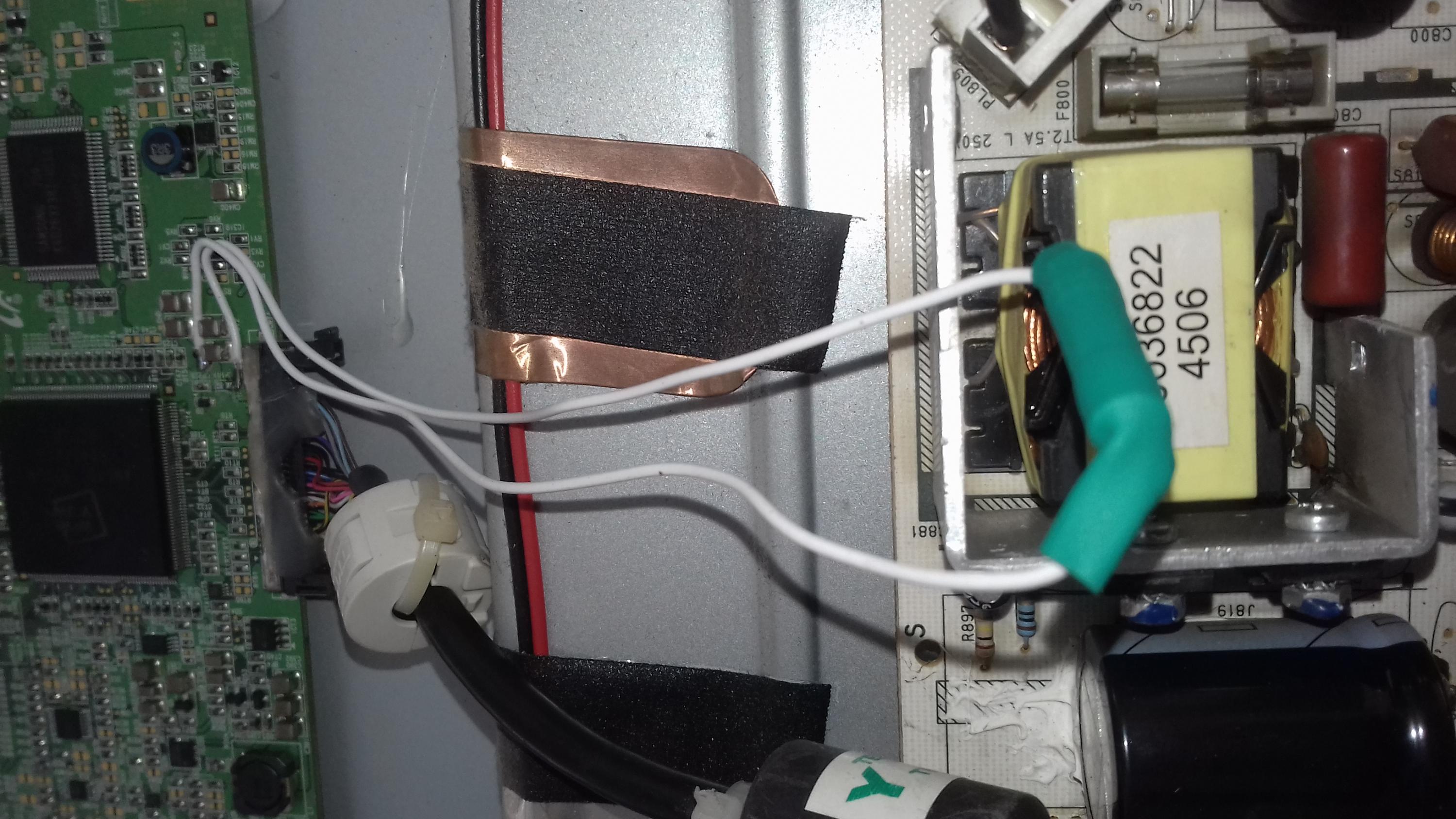

                    Re: bad tcon fuse
                    worked out what i am going to do to replace the fuse .i have a plan . am leaving the 5 amp fuse wire where it is . i am going to trace the 5v feed wire to tcon and cut it and splice in a 3 amp fuse . simply solder wires to a 20mm fuse and shrink wrap it . this will make it easy to change if the need arises .

                      Re: bad tcon fuse
                      i fixed it . hoping it lasts . excuse my messy work .
