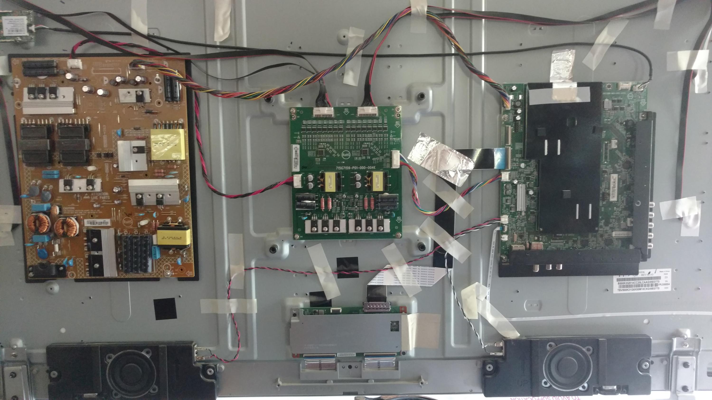

    I have acquired a non-functional Vizio M50-C1. Previous posts have revealed higher than expected voltages on the 12v pins (recorded at 19v). Mine is the same. LED on main board illuminates when plugged in as solid red. When powering up, it changes to red and blue. The power indicator comes on then fades out as normal. Nothing displayed on the screen even with the flashlight test. No backlights at any time. Remote functions, turning the TV on and off. Power will cycle about every two minutes. From my reading of others before me, it appears to be a short in the main board. Replacing the board will run about $60 plus shipping. Trying to eliminate any other possibilities before I spend the bucks. Pictures can be posted if required.

    Yes photos, investigate the 19v instead of 12v.

      Image attached.

                Investigate the 19v instead of 12v, follow the trace and see which component it goes to. You have a multimeter ?
                Your photo does nothing to assist.
