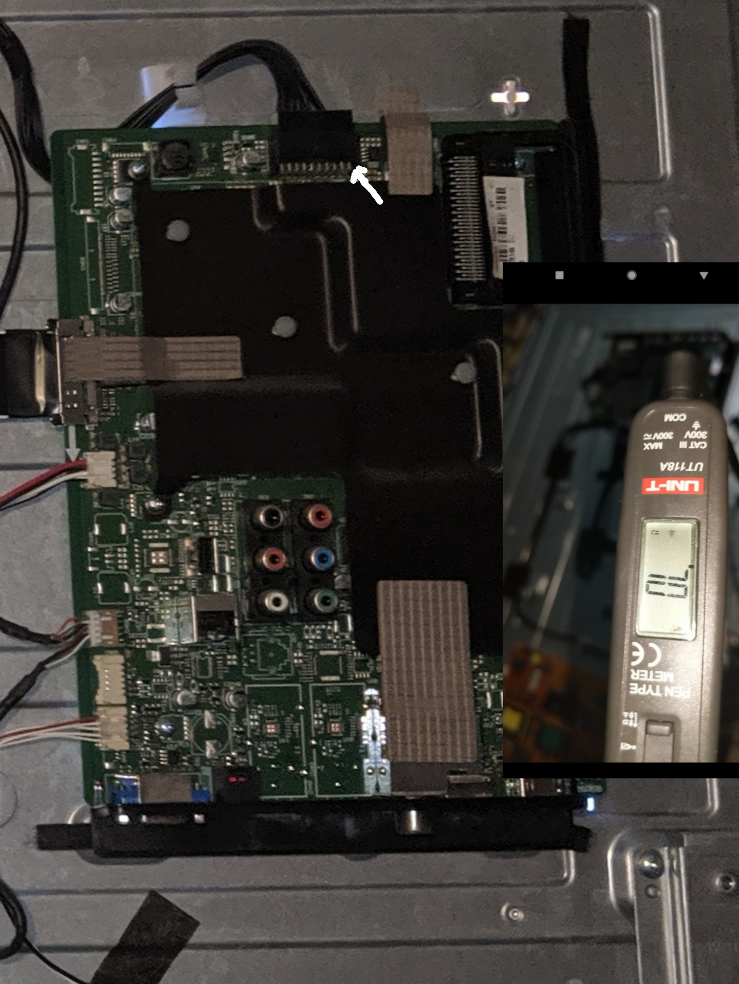

    Does this mean a short? Panasonic TV's

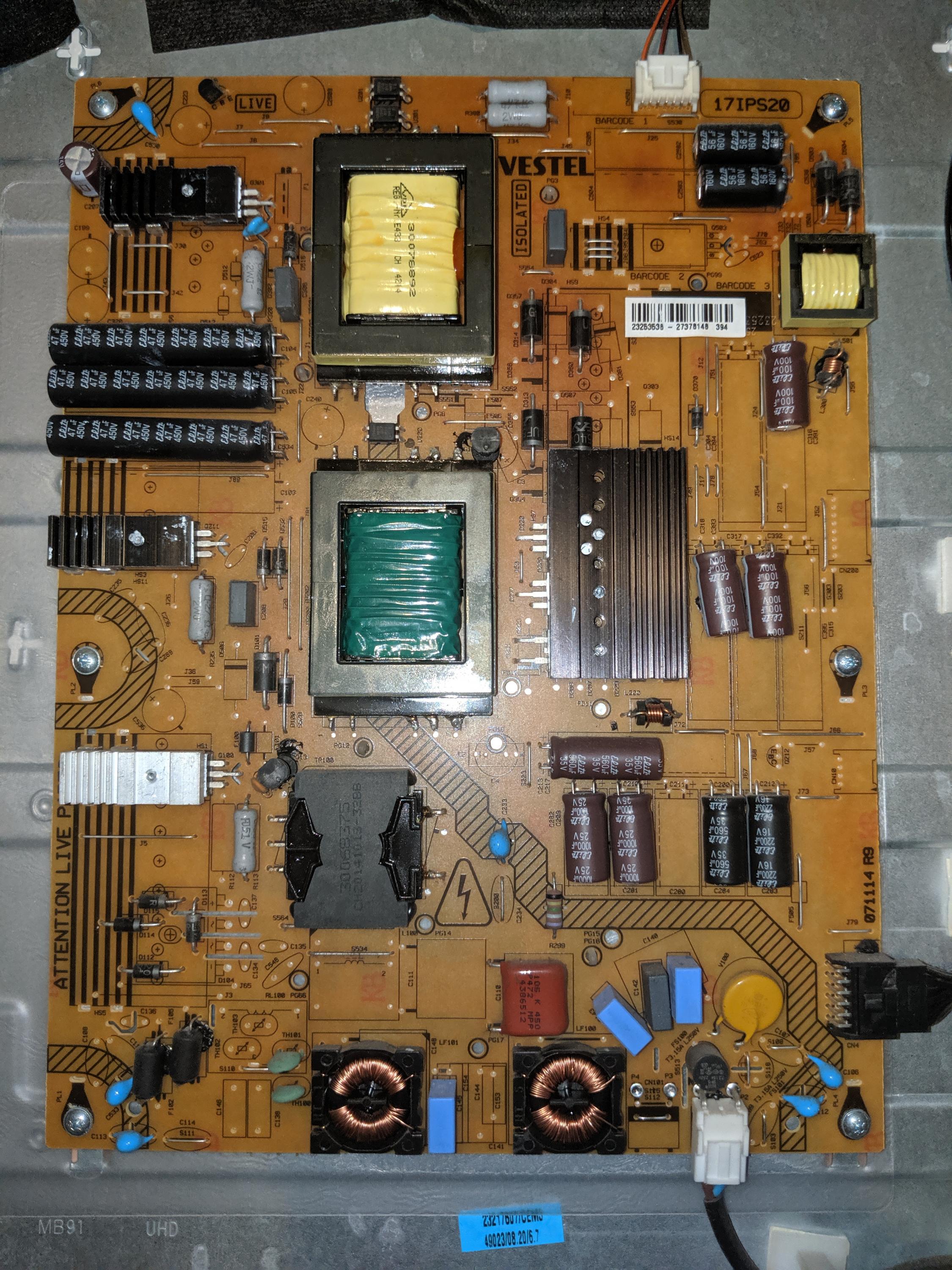

    I received 14 blinks on Panasonic TV vestel board I tested the power board to main board socket on the powerboard side first on the mode as pictured attached (multimeter mode) and it beeps shortly then goes away on the last pin all the rest no beep
    However when testing the main board at the point where the wire comes from the powerboard. As pictured attached
    I uplugged the connection wire so it wasn't connected to the powerboard and just testeed the socket of the main board pins, the last pin arrowed is a constant beep does this mean the main board has a short and needs replaced as I heard 14 blinks inicates the aboard or main board??
    Set has sound and black light just no image except backlight on
    Schematic attached also incase

    Re: Does this mean a short? Panasonic TV's
    Use resistance mode not continuity mode. It's hard to tell from your photo but there are pins that are connected to ground on the connector.

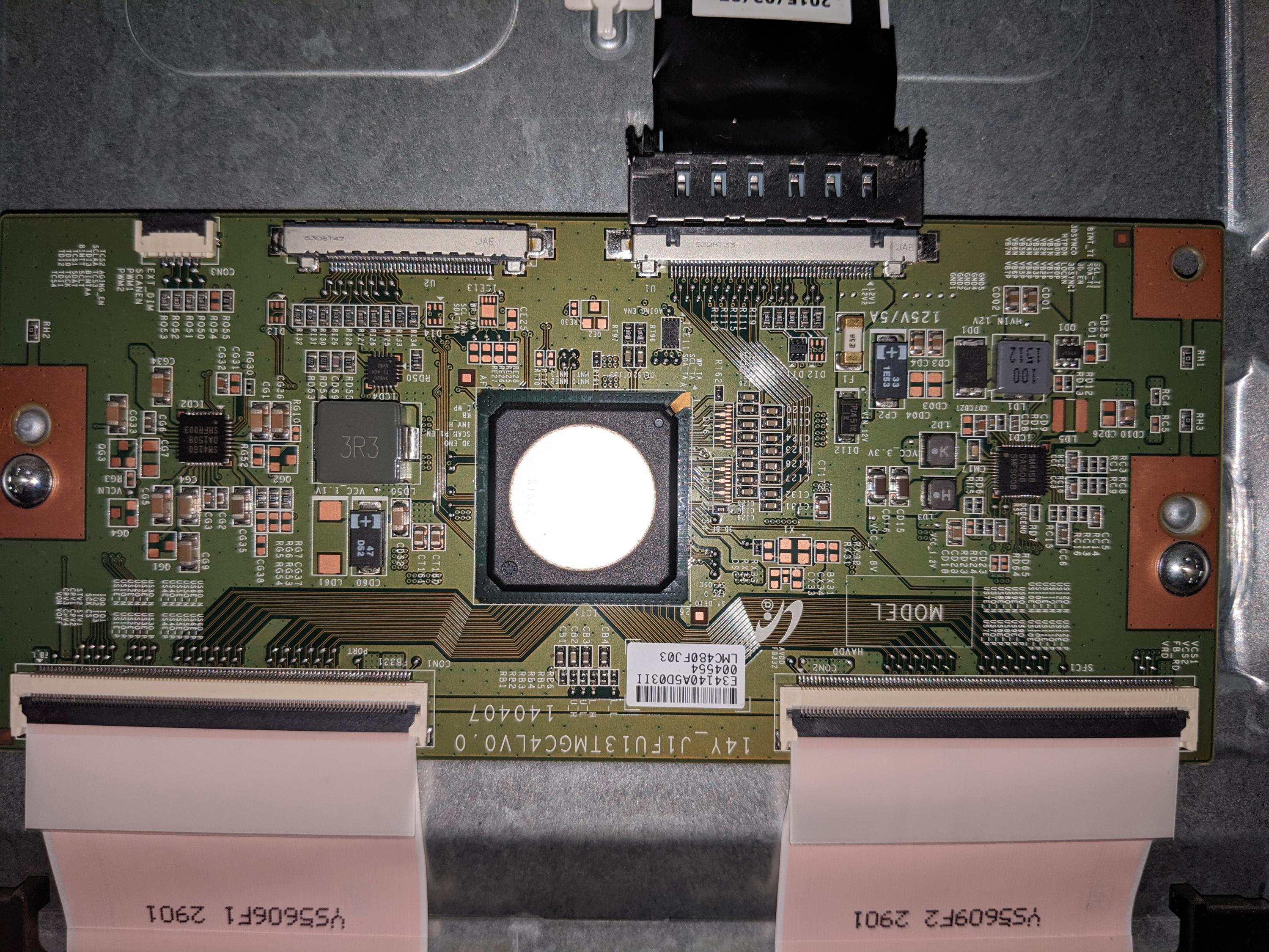

    Is there a tcon ? Have you measured the voltage both sides of its fuse ?
      Thank you for replying,
      Edit connection was loose will try now.
      In resistance measuring at the pin I don't get that beep thank you for helping me on that also
      11.84v each side of T-con fuse is meant to be 12.12 or it can be lower,
      I wonder if it's meant to be 12.12 and is slightly low
      • diif
        • Feb 2014
        • 6978
        • England
        That voltage is fine.

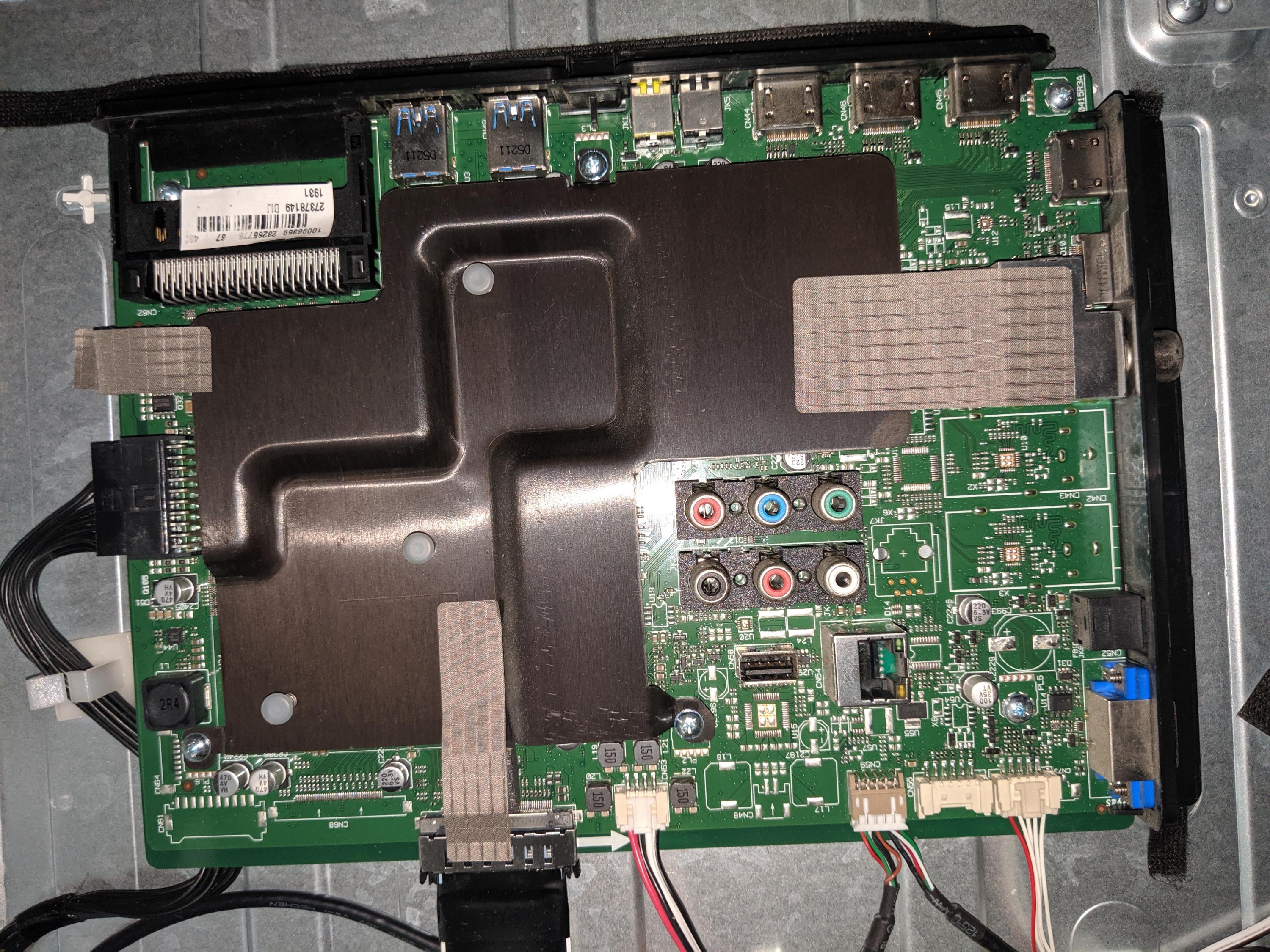

          Ok thanks for helping me troubleshoot that I think as there cheap I will get a T-con and a other main board and hopefully it's one of these

              What do you get if you have one ribbon cable between panel and the T-CON connected one at at time? What Voltages do you get on the T-CON board test points?
                Unfortunately I can only see VCC on there from the test points you mentioned but I will check
