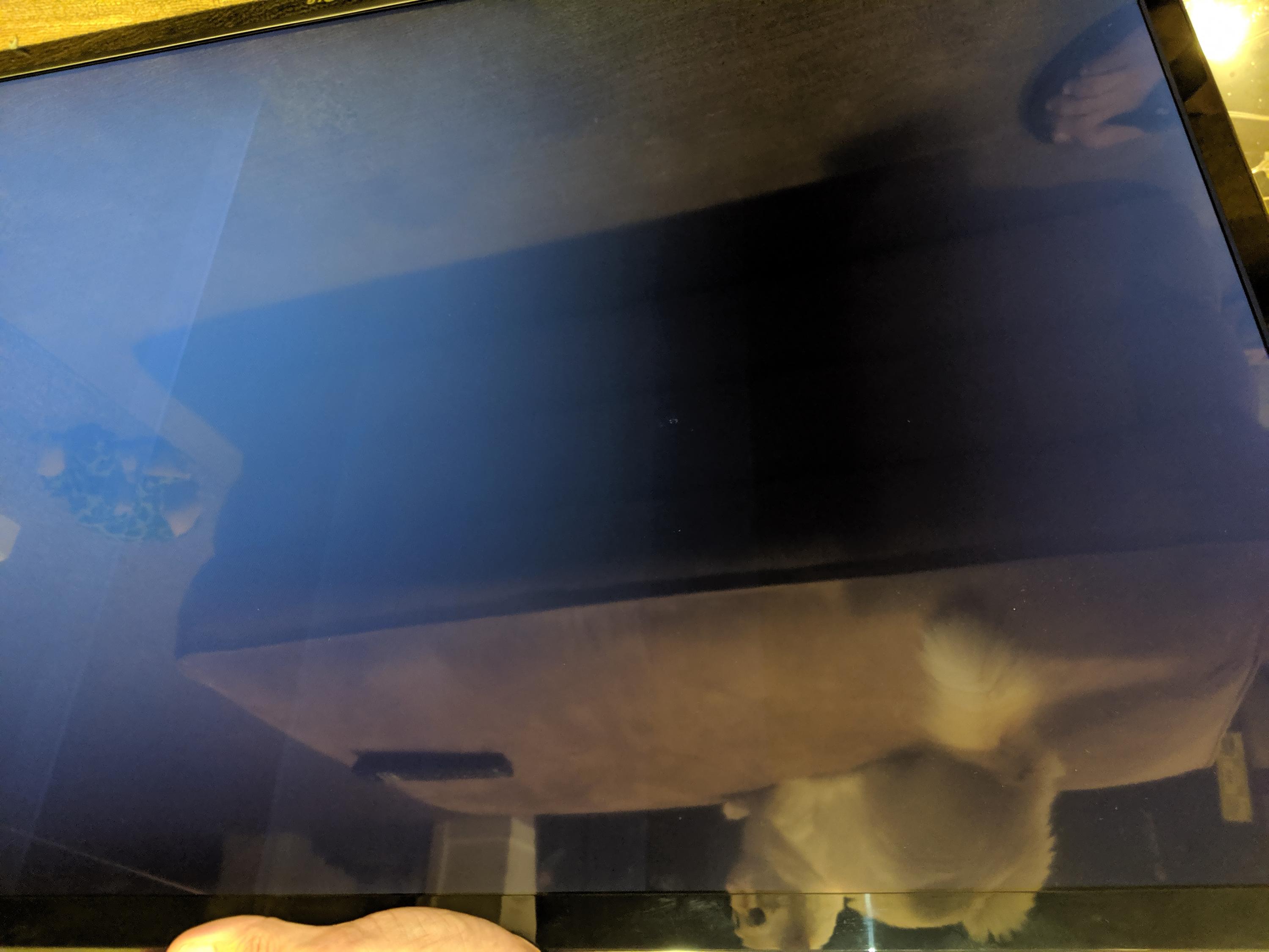

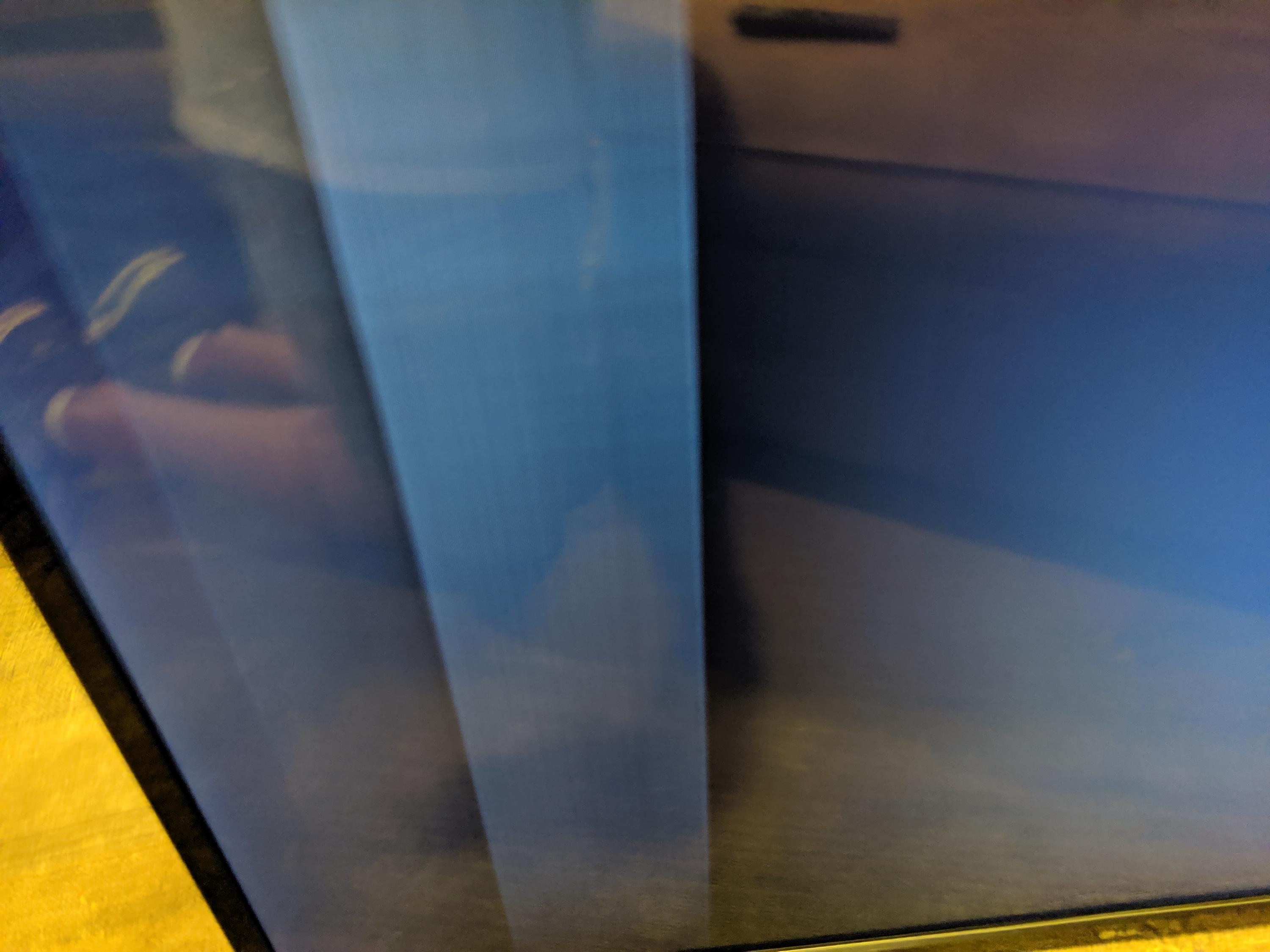

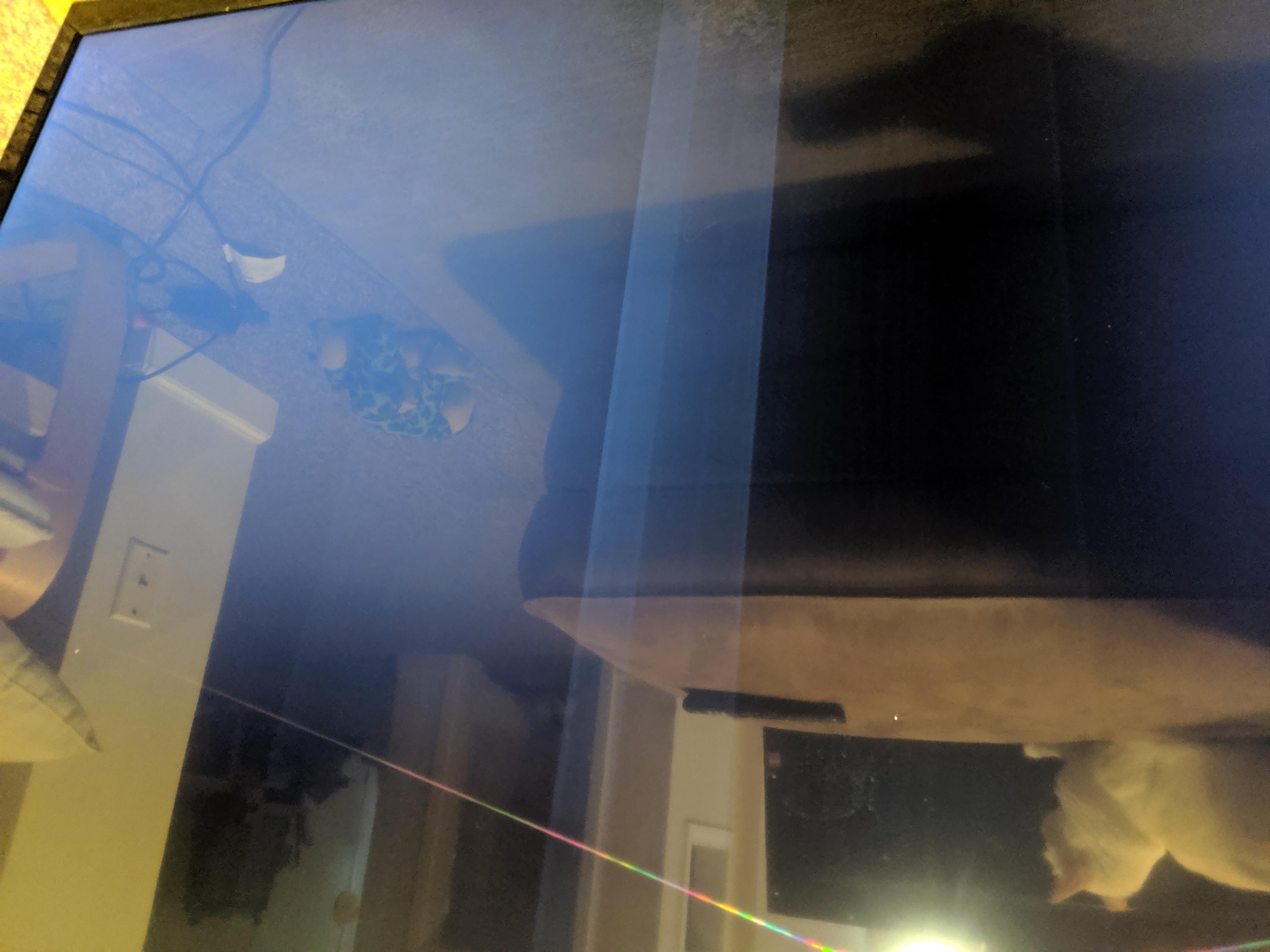

    LG55LS4500 picture started displaying dark horizontal lines (alternate picture lines were basically black). Then the next day no picture at all. Now there is basically no picture except for some vertical light gray bands that seem to move across the screen. I opened up the TV and saw no fried caps or any obvious failures. Last year (about 18mo ago) this TV POPPED and went black. I opened it up and found a fried cap. I replaced it and everything was good. This time there is no obvious cause. Backlight works fine. I checked and reset all the ribbons. Nothing. See attached photos. I'd like to fix this TV as it's not that old and it is just used for my kids to play xbox.

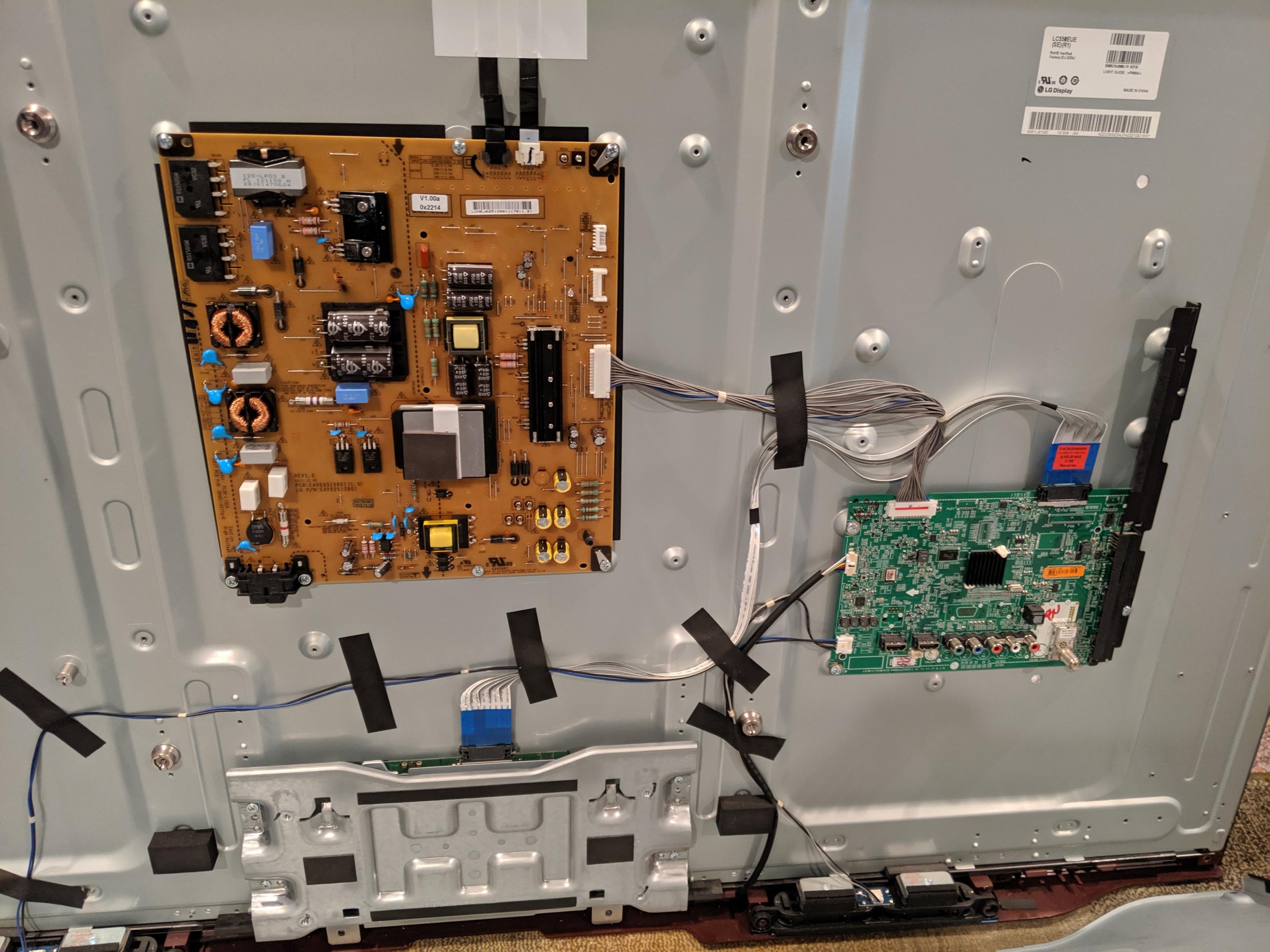

    We need to see the pictures of the whole backside of the TV showing all the boards.

      Re: LG55LS4500 picture went bye bye
      Does it have stand alone T-CON board? If it does, what do you get on the screen if you have only one ribbon cable between the T-CON and the LCD panel connected one at at time?
      Here is the back panel. I assume you are referring to the two ribbons at the top...the one with the black connector and the one with the white. If BOTH are connected, I get the mostly black screen with the vertical white/grey patches that change location over time. If I disconnect either ribbon, I see the same thing for a second, then it all goes dark and a yellow LED starts flashing on the right side of that orange main board.
        Your T-CON board is under the metal shileld at the bottom center of the TV, you see white flat cable with blue marking.
        Those two cables you pulled ARE NOT cables for T-CON, those are for LED backlights, make sure you put them back on correctly.

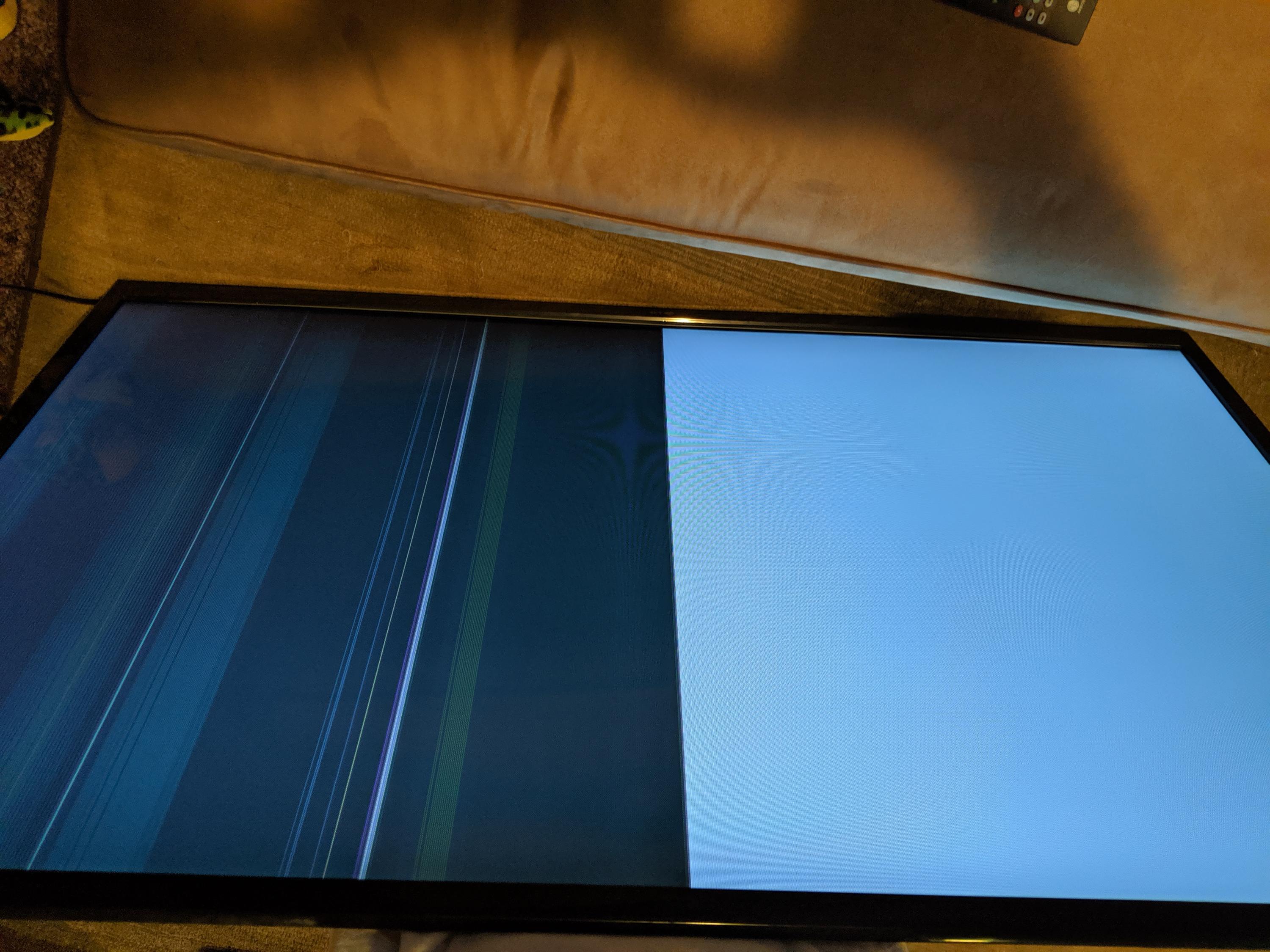

          When I disconnect the white ribbons with the blue tape from the T-con and turn it on, the backlight works but the screen is blank. When the cable is connected to the t-con, the screen gets that grey/white vertical band that moves left to right across the screen (it changes position every couple of seconds).
          Is this a bad T-con, and if so does it need to be replaced or are there parts available cheaper?
                OK. I didn't see the two cables at the bottom before.
                [yes, I always unplug the TV before doing anything inside it]

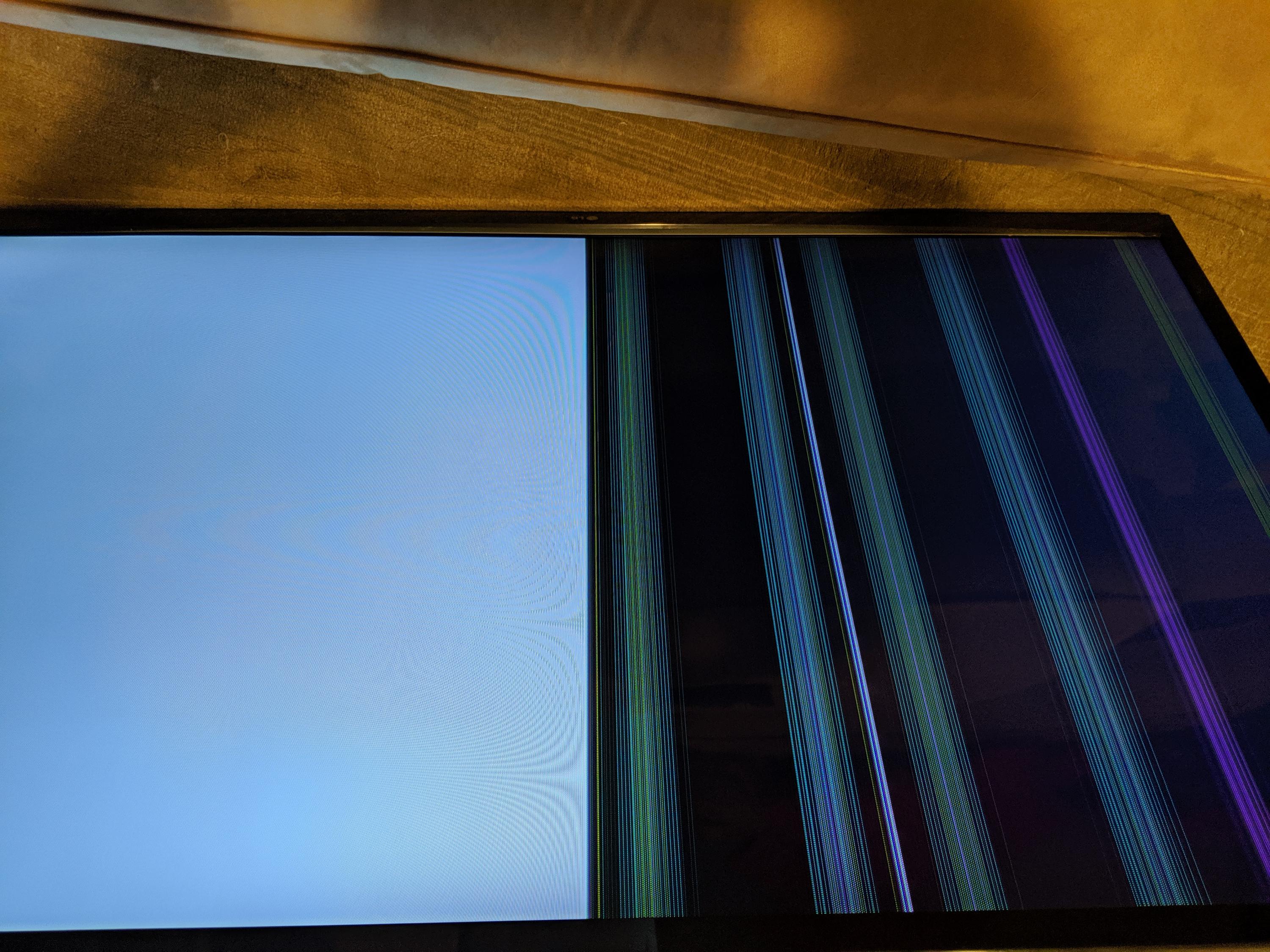

                I disconnected one, powered up....checked the screen. right side is white, left side is black with vertical lines. unplugged. reconnected the first, disconnected the other, powered up...checked the screen. left side is white, right side is black with vertical lines.

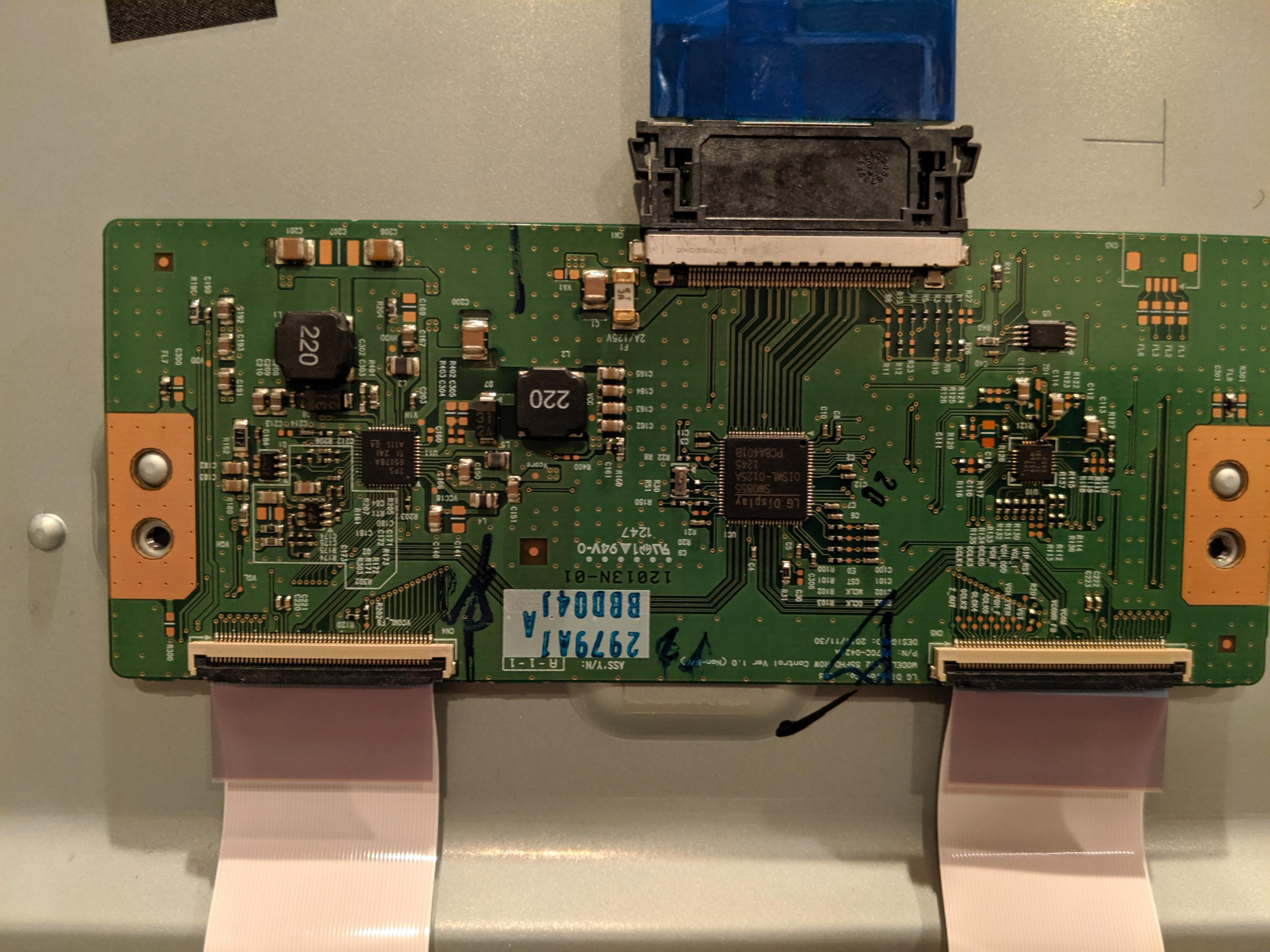

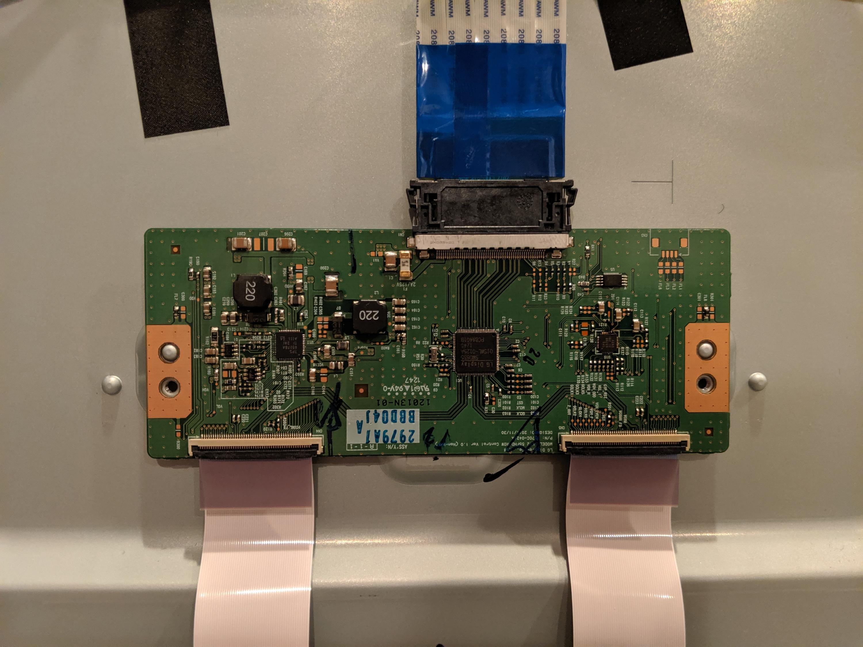

                      Please up load good clear straight shot pictures of the T-CON board so I can locate the Voltage test points.
                        Here you go. Hope it's clear enough.
                          The test points that I can see so far are

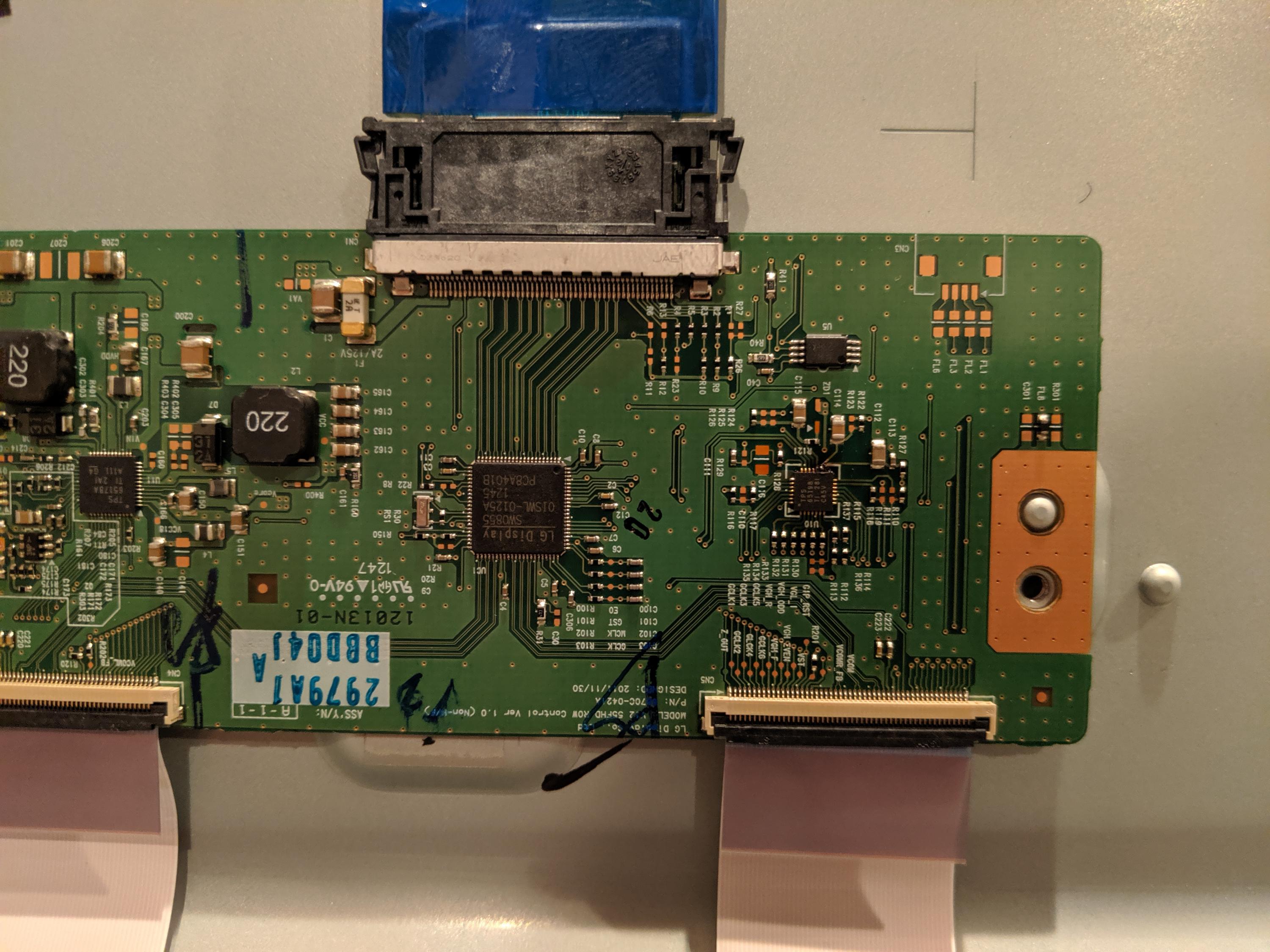

                            Here are some more shots. Hopefully a little clearer.
                              Just check those test points and report them.

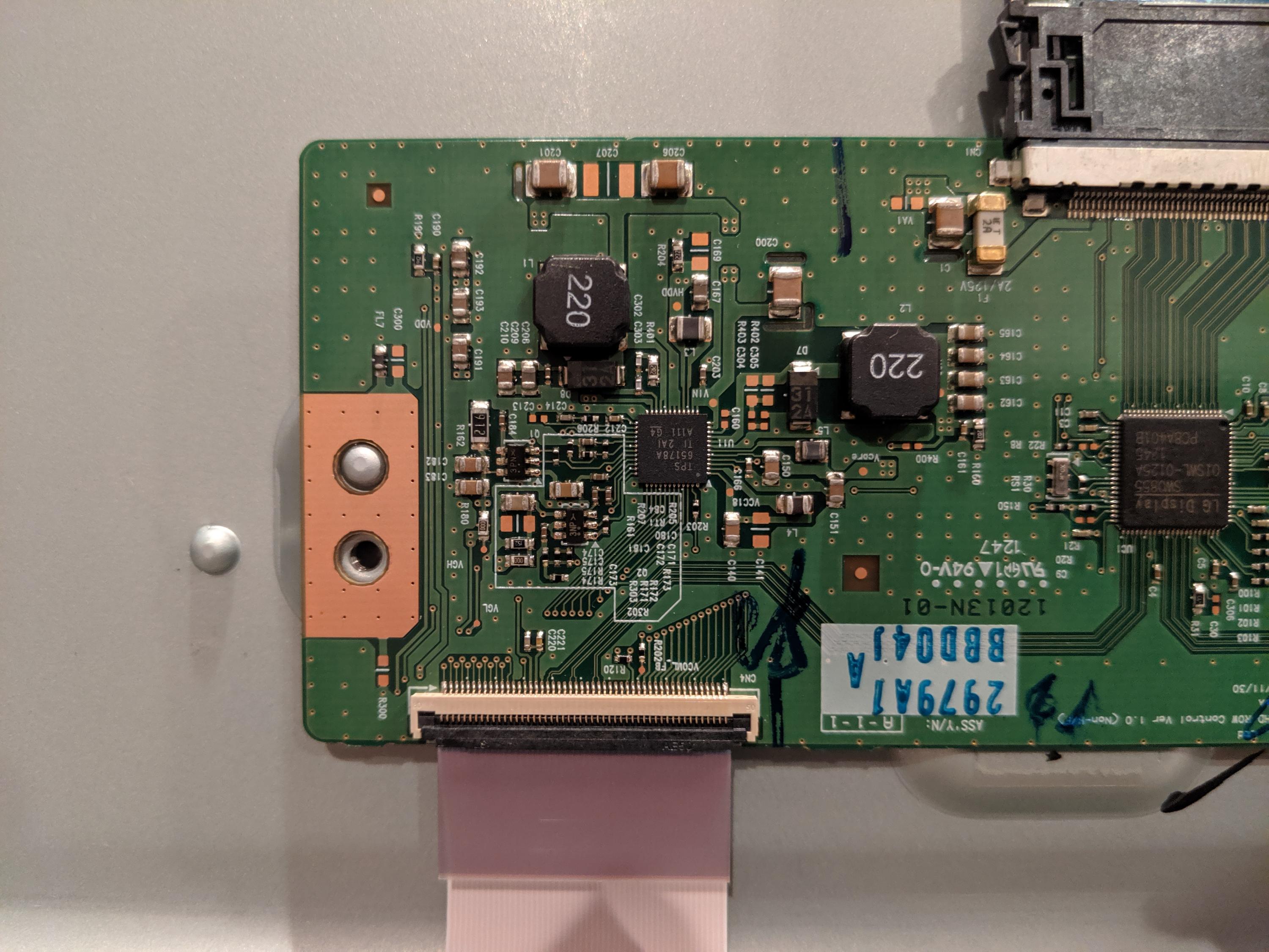

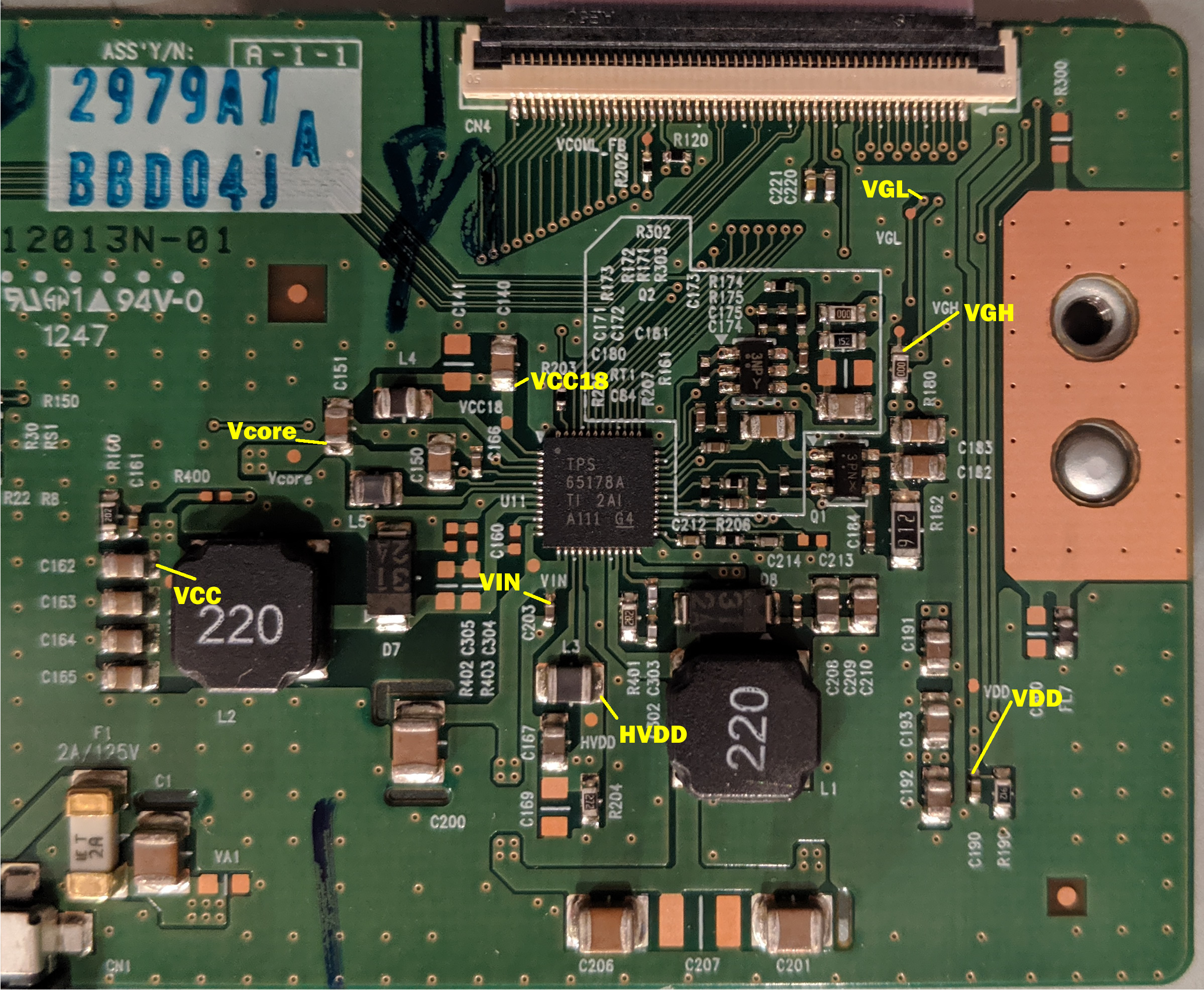

                                Can you confirm I have the points right? Some of them are unclear which points they are indicating. See below drawing. If I have any of them wrong please let me know.
                                Thanks again.
                                Tim
                                • Tim K
                                  • Jul 2019
                                  • 16
                                  • US
                                  HVDD, VIN and VCC are particularly unclear to me.
                                    You got it right. The bare copper dots are the test points, so you have it on the leg of the component which you can see that it goes to each bare copper dot.
