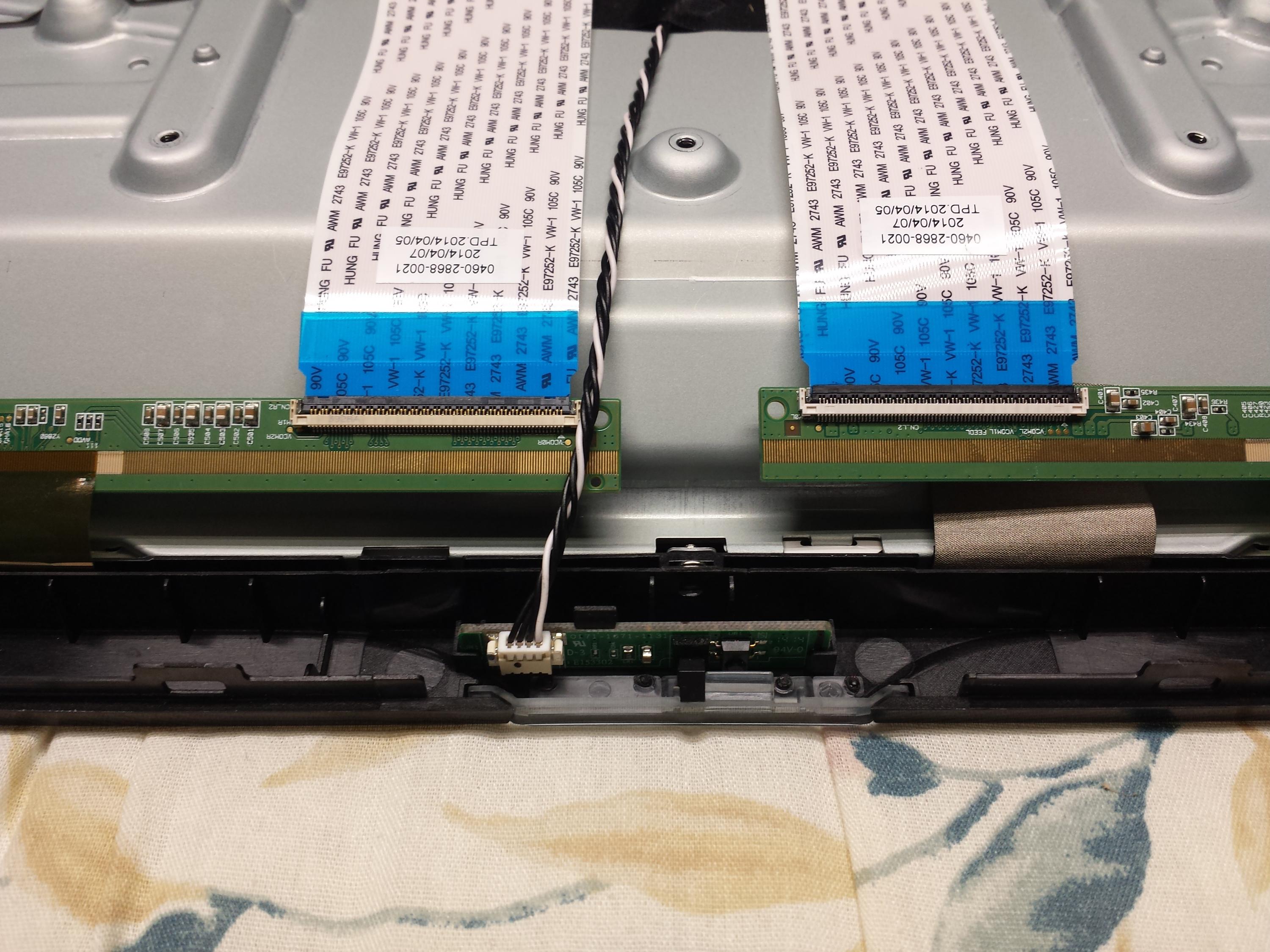

    TV has no picture but is back light and has sound.
    Boards

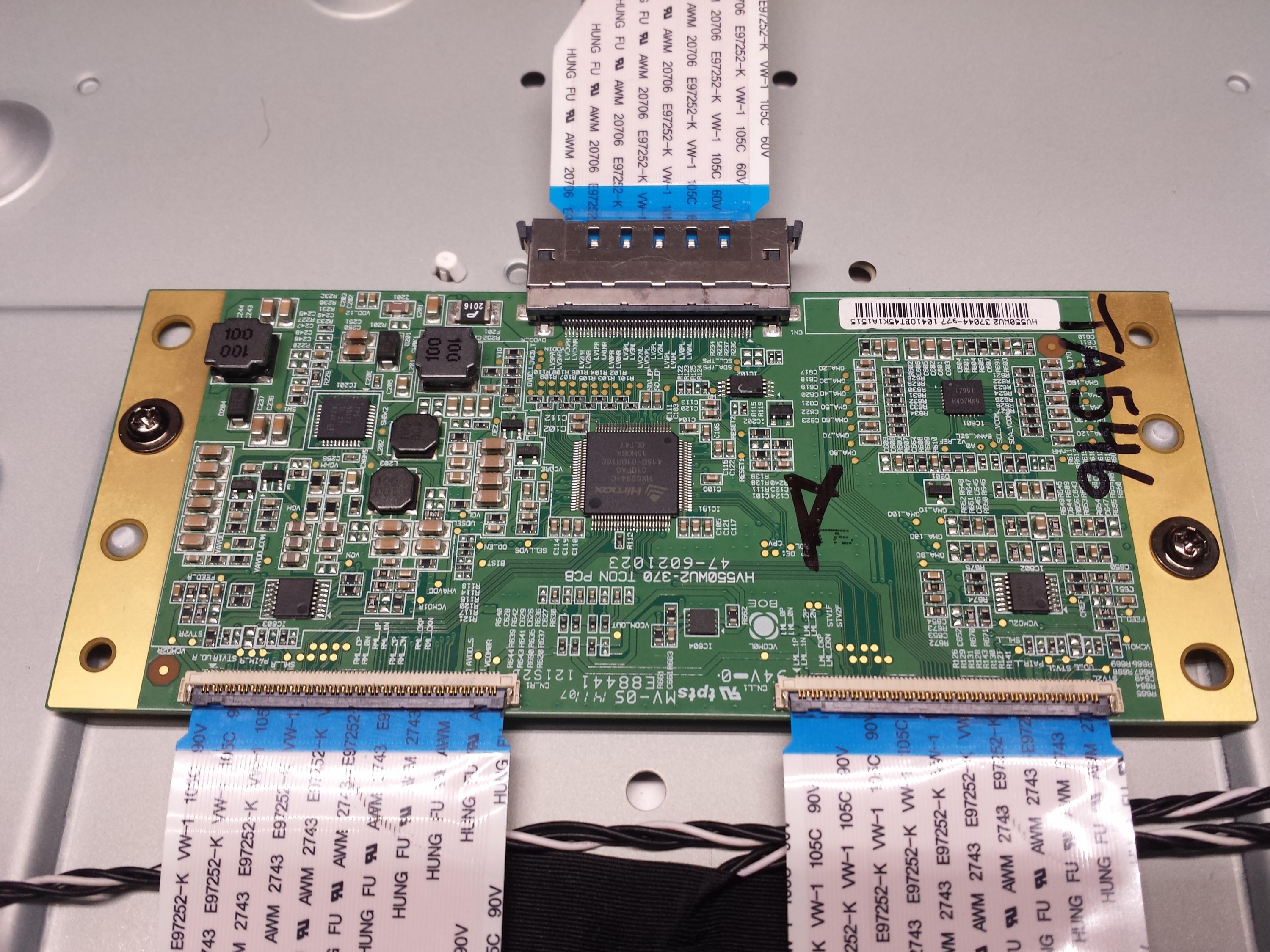

    T-Con HV55WU2- 370

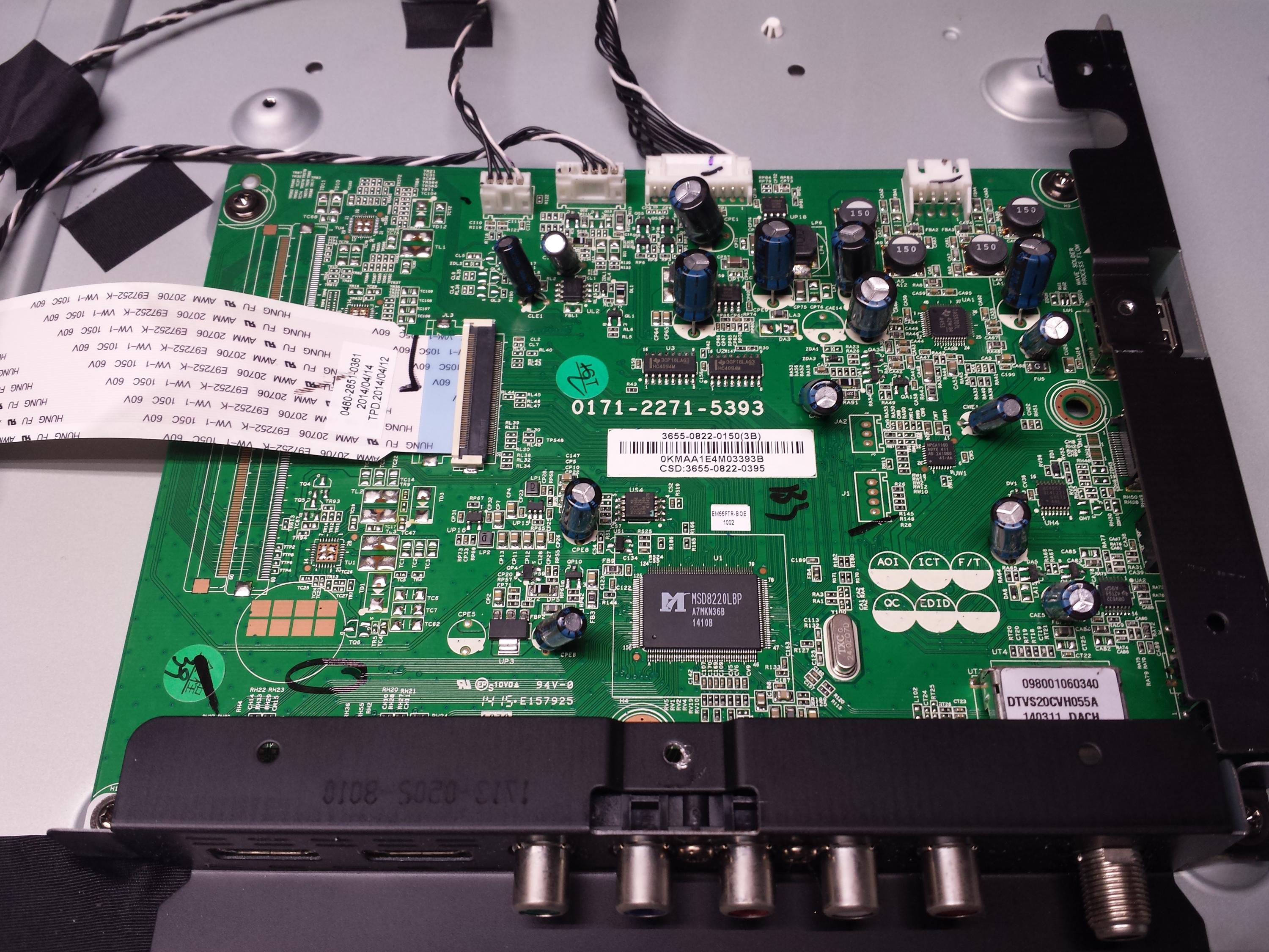

    Main 3655-0822-0395(3B)
    Measurements
    All measured Main board test points check out.
    All measured T-Con board test points check out ONLY when left panel ribbon cable is disconnected. If the cable is connected, most of the voltages around the ribbon cable/lower right/left IC drop to 0v ( as if something is shorting )
    Cannot find any shorts to ground anywhere on T-Con and on left side Panel PCB
    Observations
    When the left side panel ribbon cable is disconnected and TV is powered, a picture can be seen on the right side of the TV while the left is completely white. When the ribbon cable is connected, then the entire panel is black ( with backlight)
    Replacing the T-Con board did not resolve the issue.
    Questions
    At this point I am confident that this is a bad panel but wouldn't there be some sort of evidence such as a short ? I measured all the components on the panel PCB and they all seem ok, nor was I able to find any shorts.
    Before I rip this TV apart for parts thought I first check in with you guys for any suggestions/

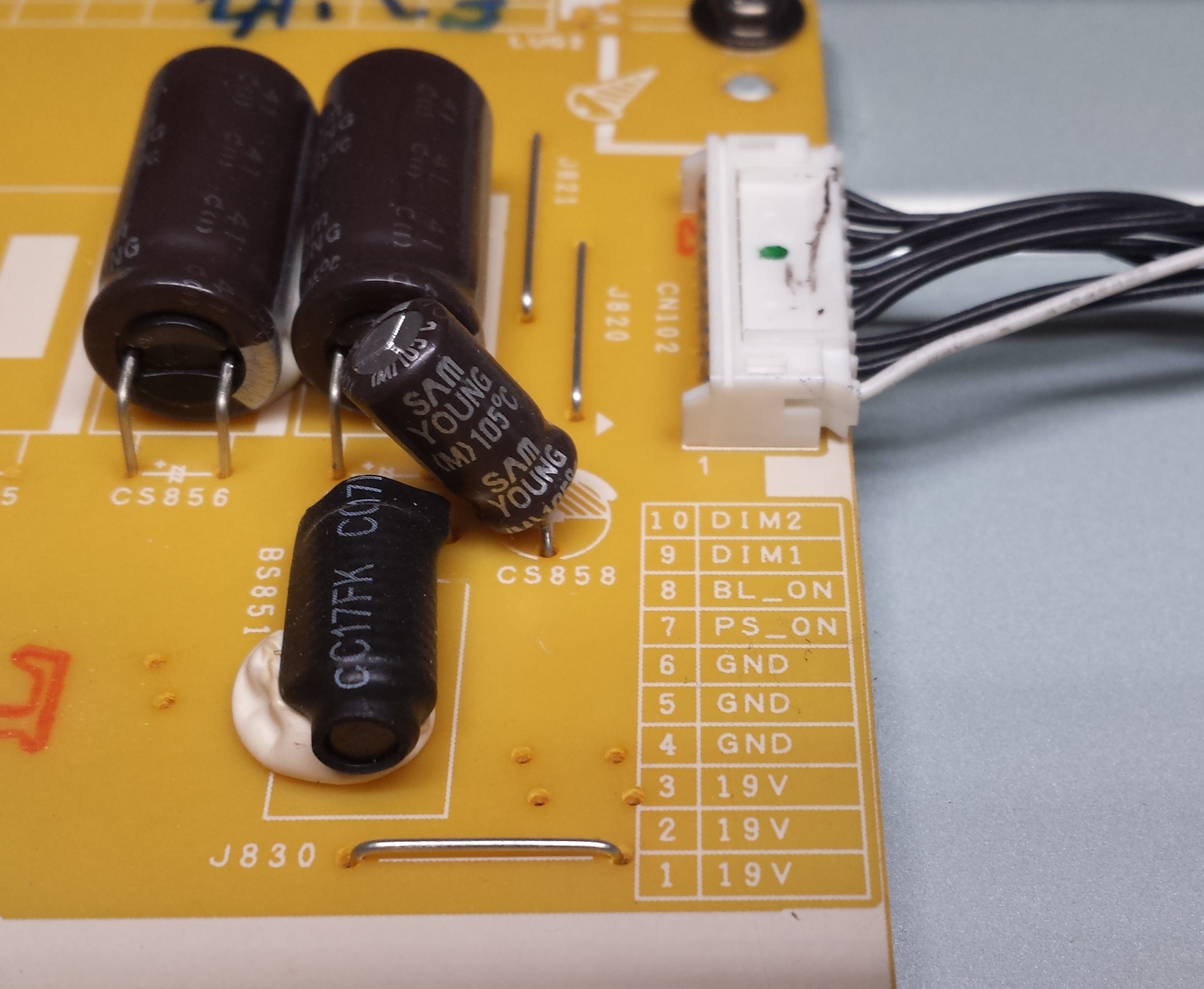

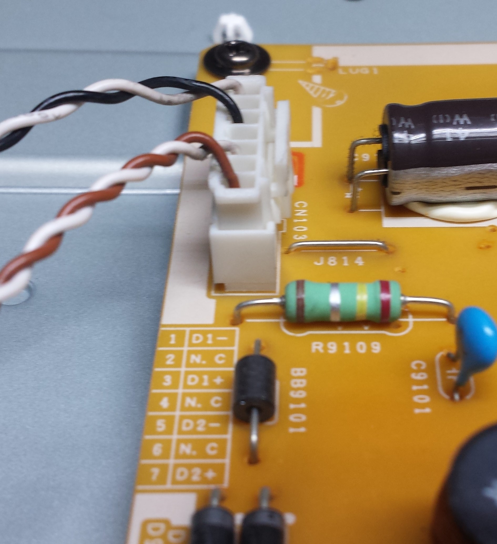

    Test connector from mainboard to powerboard on powerboard side with all boards hooked up, test with tv plugged in but off then hit power, report both conditions here, give pin number, pin description/name and condition both off and when you hit power on.
    • TheTesterMan
      • Apr 2015
      • 91
      Re: JVC EM55FTR No Picture, Yes Sound, Yes Backlight
      Power Board Connector OFF, ON
      Dim 1 -> 0, 2.7v
      Dim 3 -> 0, 2.7v
      BL_ON -> 0, 3.32v
      PS_ON -> 0, 3.31v
      GND -> 0, 0
      GND -> 0, 0
      19V -> 19.08, 19.08
      19V -> 19.08, 19.08
      19V -> 19.08, 19.08
      LED OFF, ON
      D1+ -> 0, 112v
      D2+ -> 0, 111.7v
      FYI - I have at my disposal not only a multimeter but also a scope should there be useful measurements I can take.

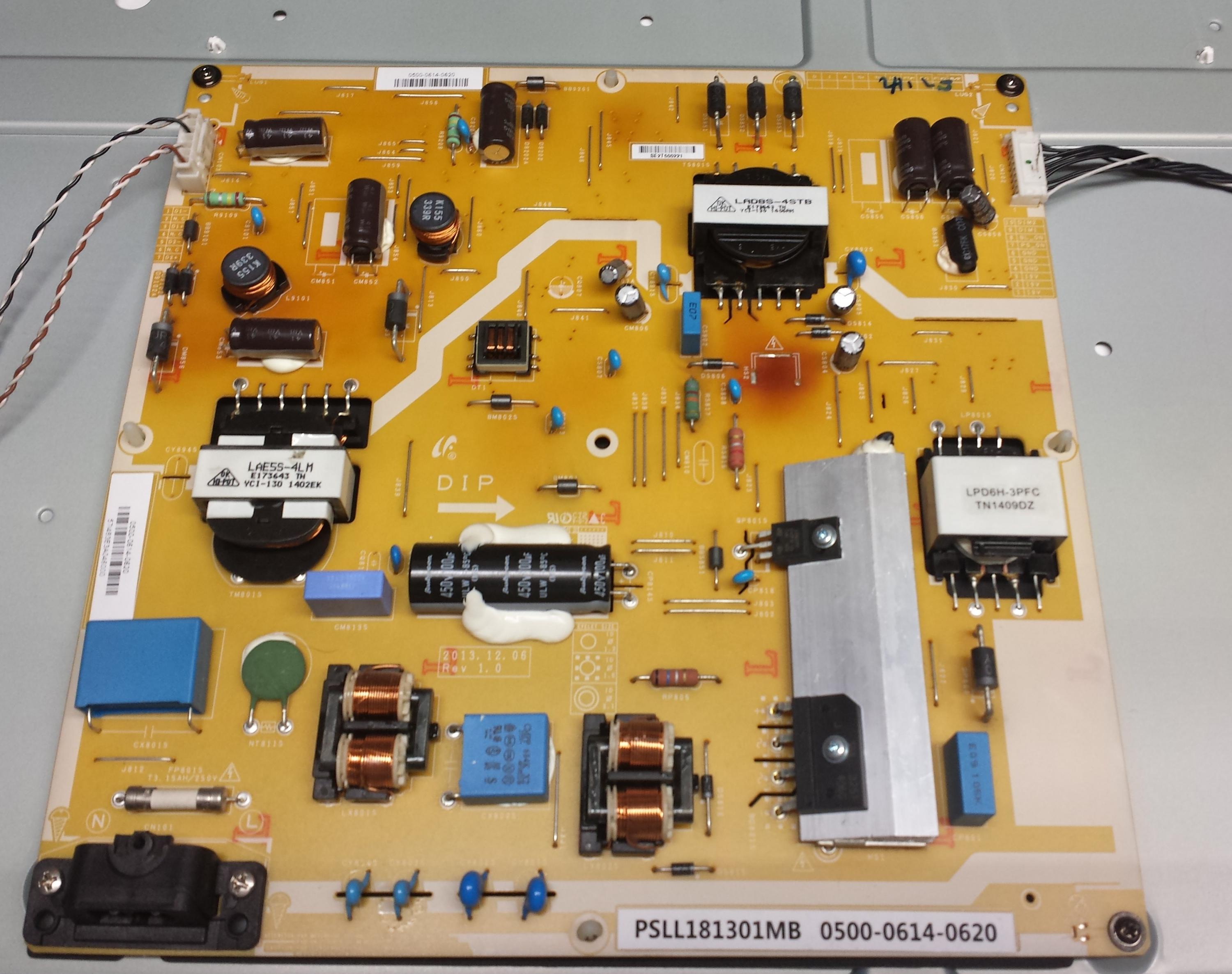

        There is nothing wrong with the power supply because you are getting sound, backlights, and half of the screen if one of the cable (good side) between panel and T-CON is not connected.
        You have problem in the LCD panel based on your description in post #1.

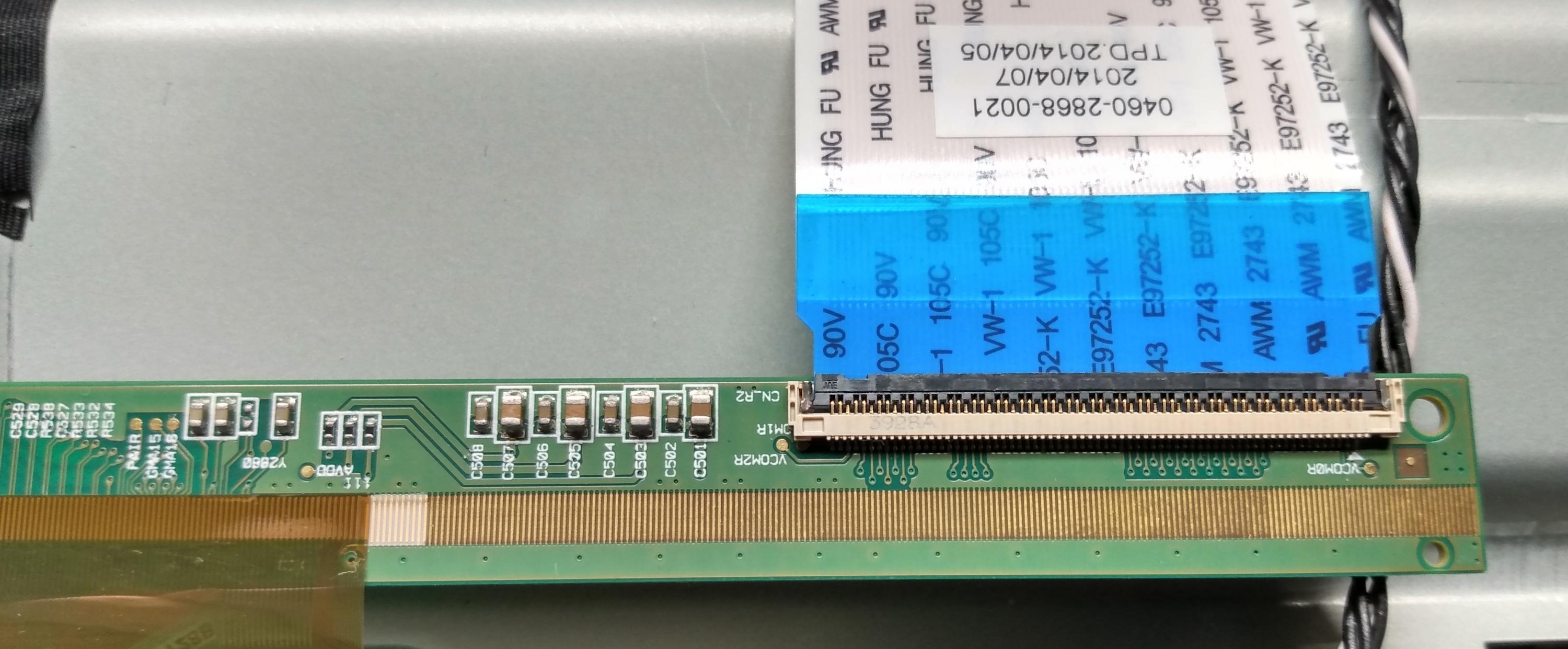

        So you check the resistance of all the caps on the tab bonding of the bad side of the panel? You are 100% sure?

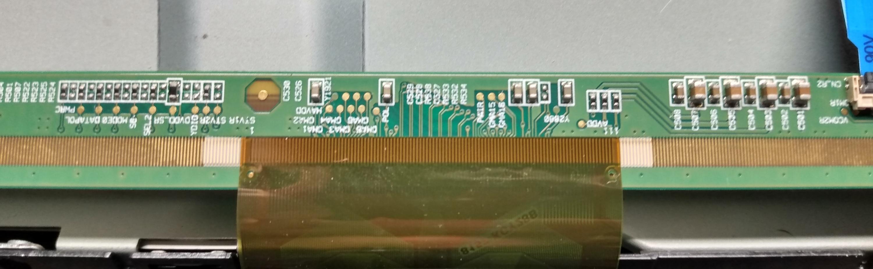

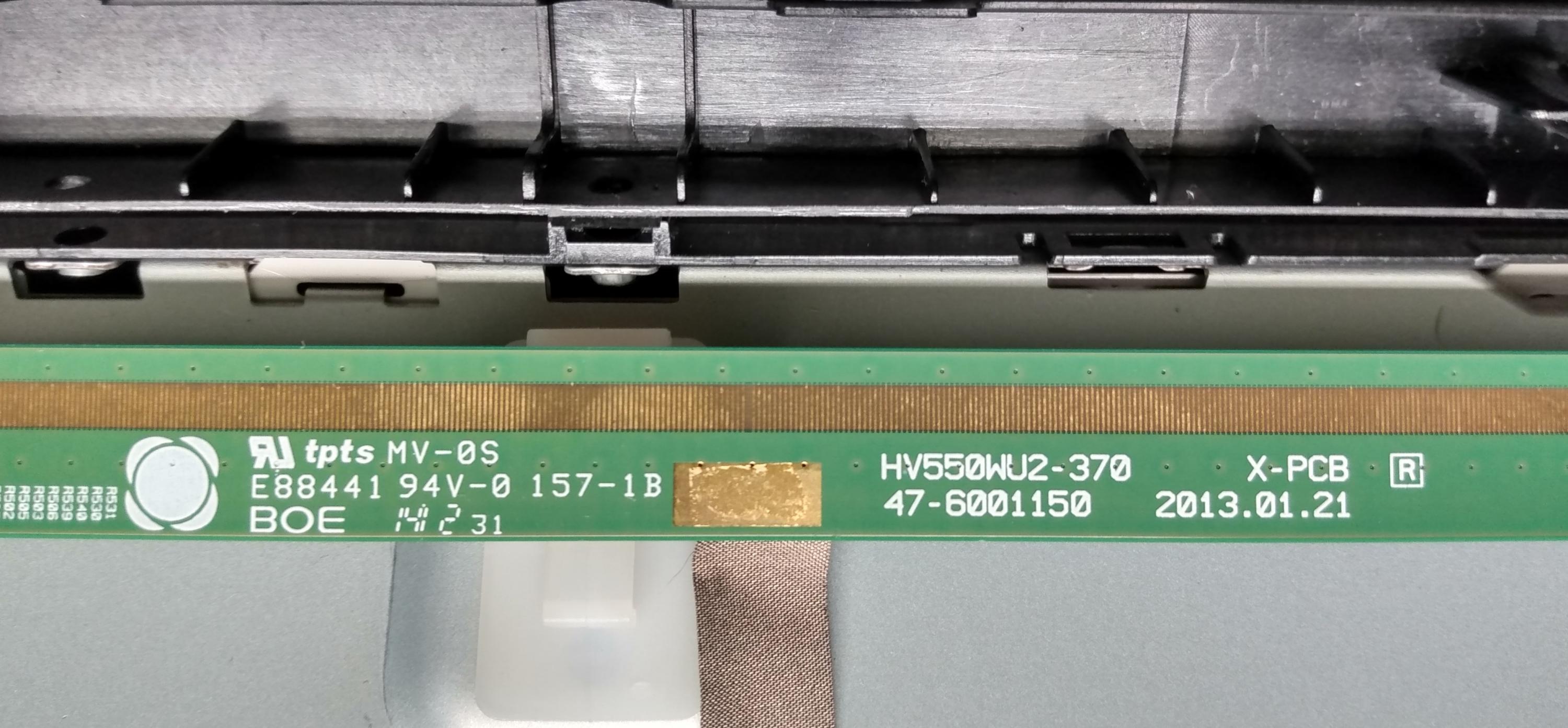

            What is the actual resistance you are seeing?

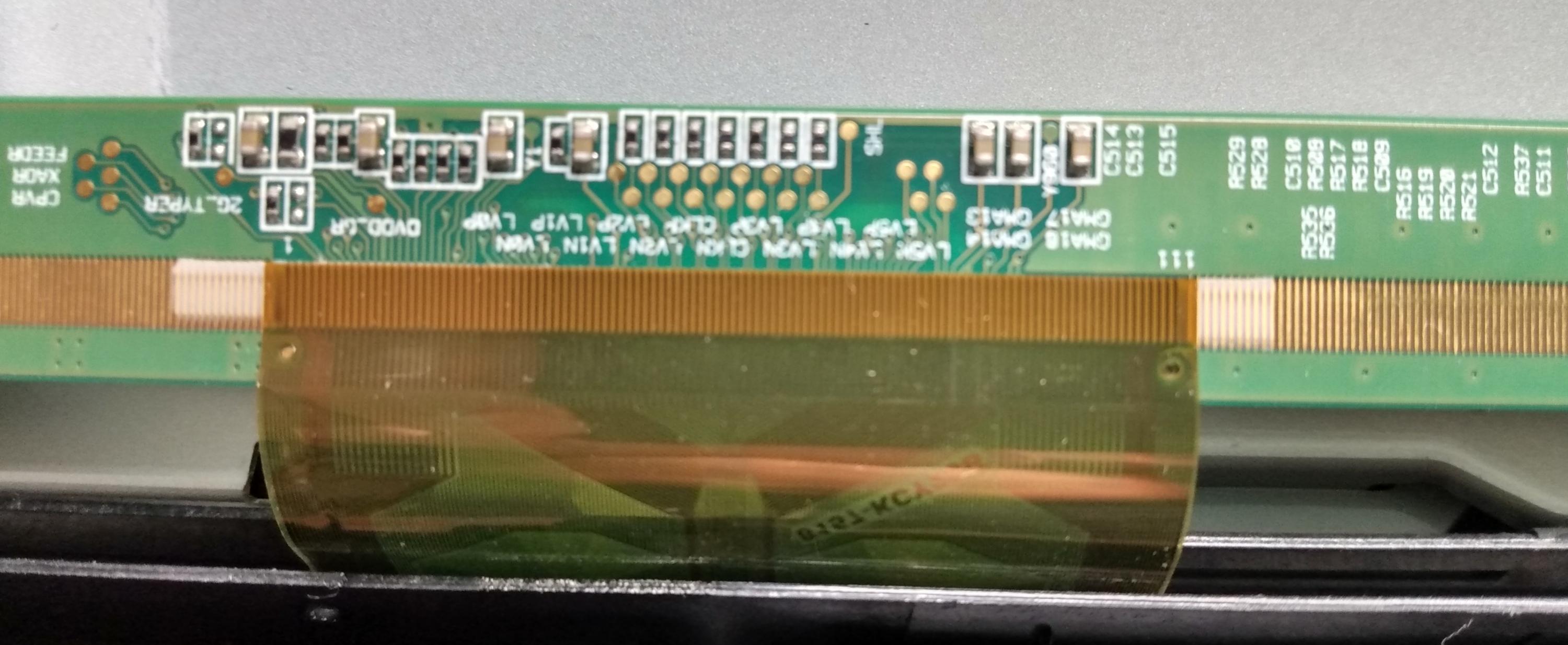

            Can we see the pictures of the tab bonding boards that the LCD panel is connected to?

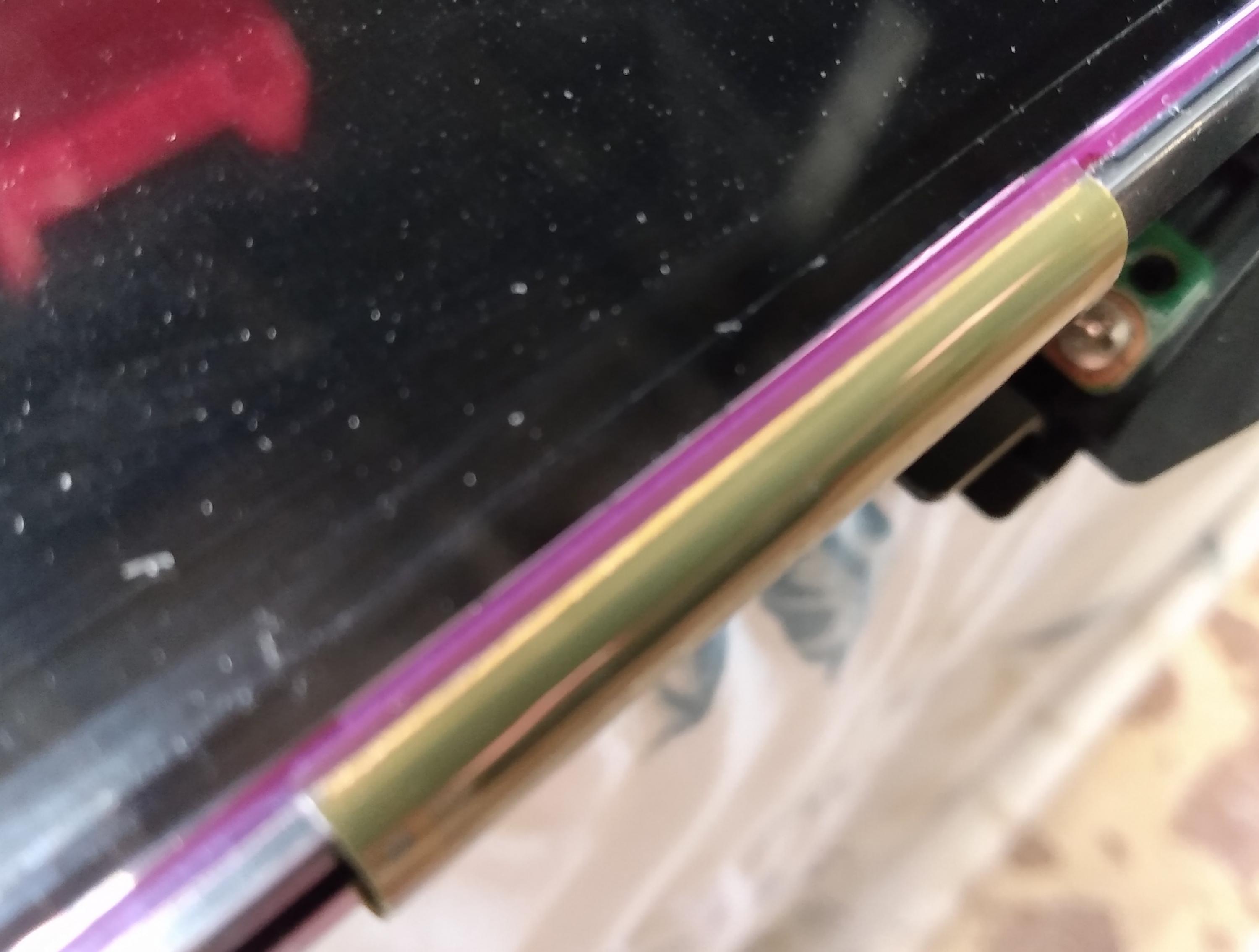

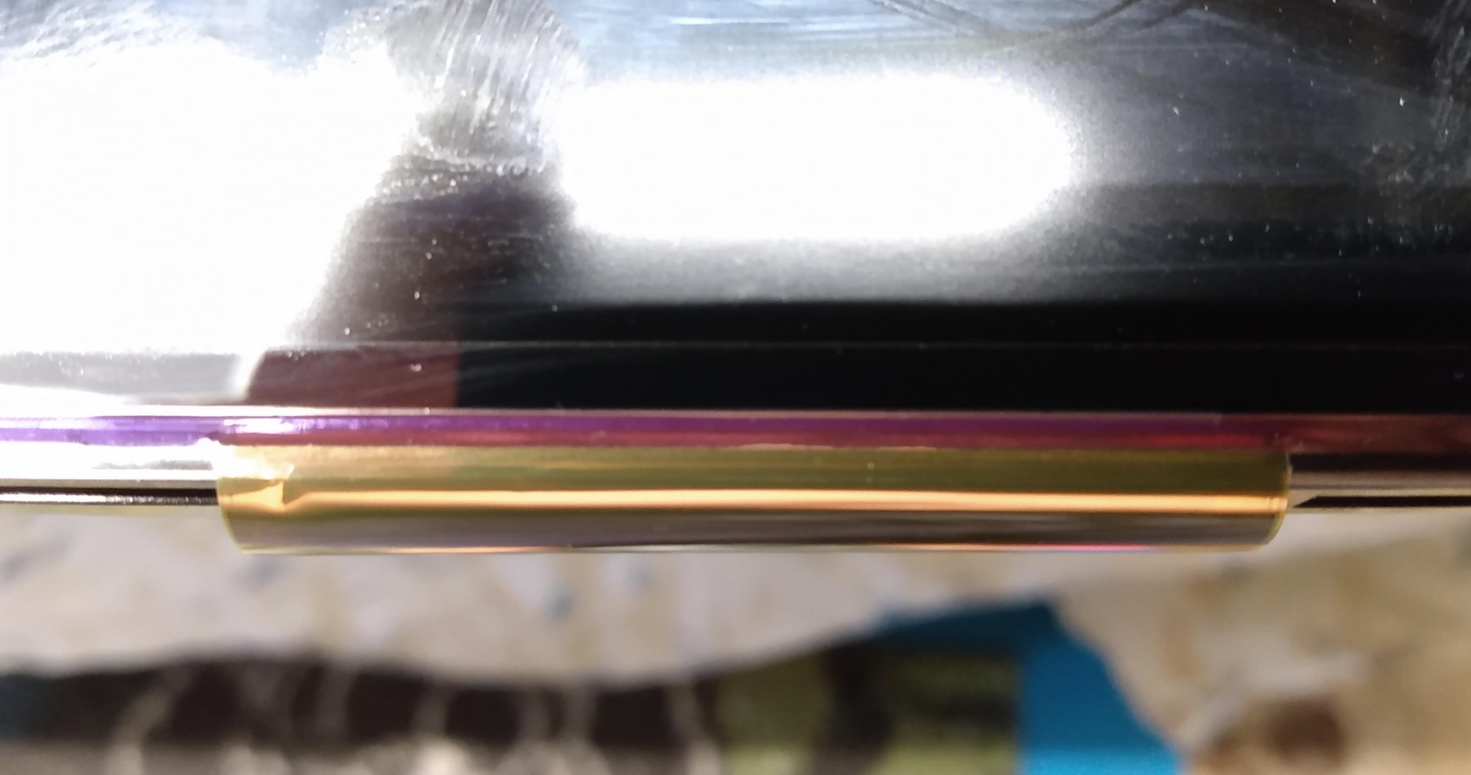

                @ budm, if you could specify which measurement you are referring to I can post results.
                @neilc6 thanks for the link, that sent me down couple of hours of research some of which I have applied without results. I have not yet cut any ribbons, but have tried taping various pins, usually a few at a time, from one side to the other and never got a picture.
                Lastly, this TV does have side tabs, I tried taking pictures of those but was difficult. Suffice it to say that none of the ICs on the side panel ribbons look burned or unusual.

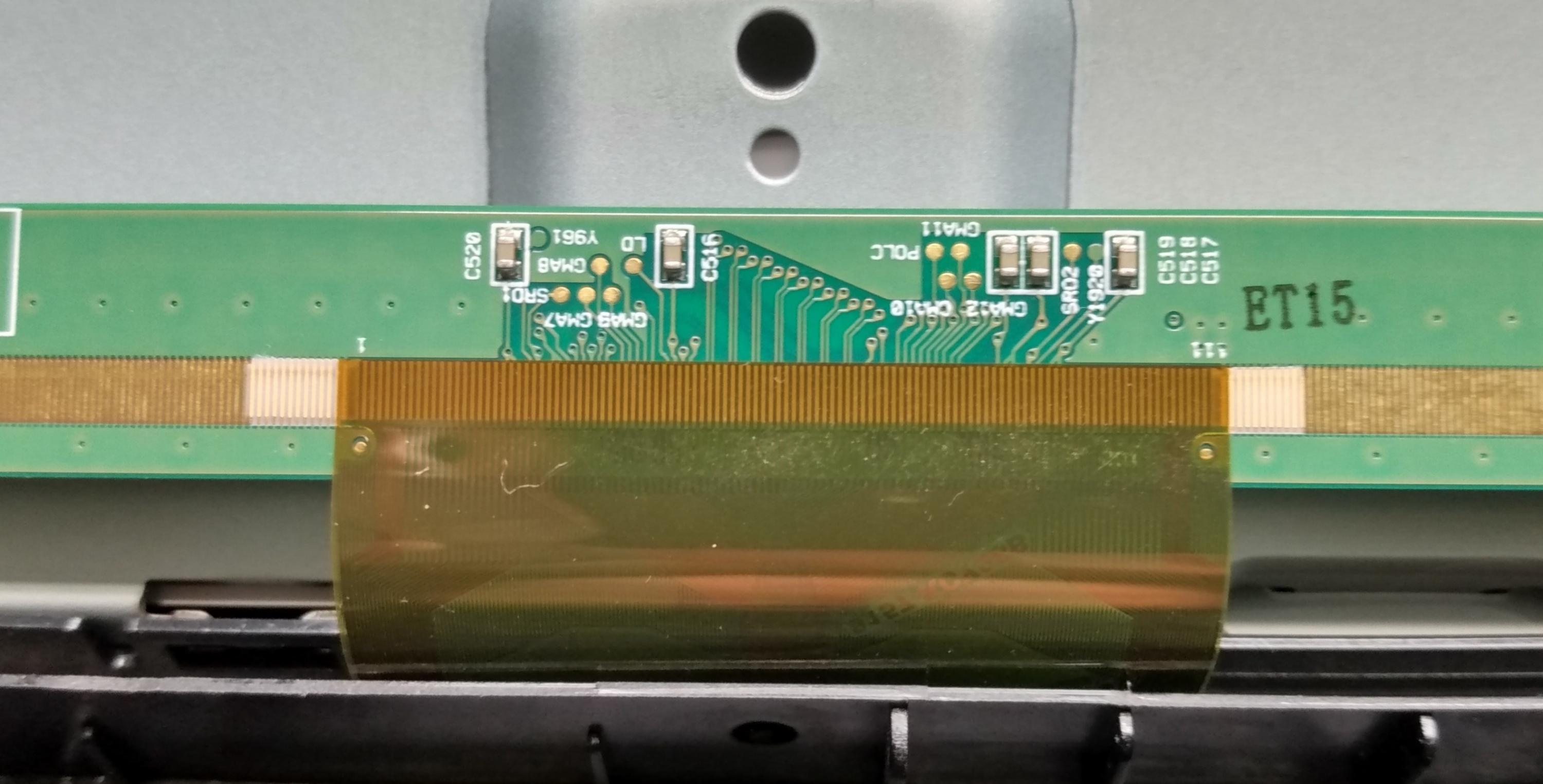

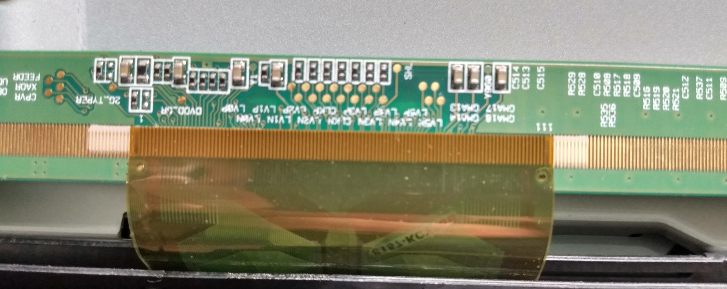

                      https://www.badcaps.net/forum/attach...5&d=1564526438
                      There are a bunch of MLCC (light brown body) caps that you need to check them all for the DC resistance to find out if any one of them show low resistance reading or not.

                              So what are the lowest DC resistance did you get?

                                These MLCC should read open or infinity. If you get any kind of resistance reading post what you got as budm asks.
                                  I already ask in my post #6:
                                  But never show the result, here we are at 15 posts, no readings shown.
                                    I measured all the caps on both panel strips ( bad left and good right ).
                                    Half the caps read roughly 300k while the rest read 1meg, this is the same on both sides.
                                    I also checked the caps with a cap meter ( on a fluke multimeter, not very accurate ) and all the caps measured roughly 6microF.
                                    All this with the ribbon connectors disconnected.
