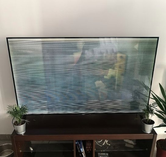

    Hello all,
    I moved my TV and there has been a kind of "split inside". Now I have a kind of white screen. I can see a bit my movie.
    It is a Sony Bravia 55XF90.
    In general, do you know if it can be fixed or it is the LCD ?

    Re: Sony White Screen (after move)
    Not understanding "split inside" can you clarify?
      Sony XF XD series suffer from this because they make the LCD holding round plastic very funny and there distances between LCD and the last sheet. easy way to solve it : take clean dry Micro fasser cloth and massage the screen starting from the middle toward the top and side and down . the white will disappear.
