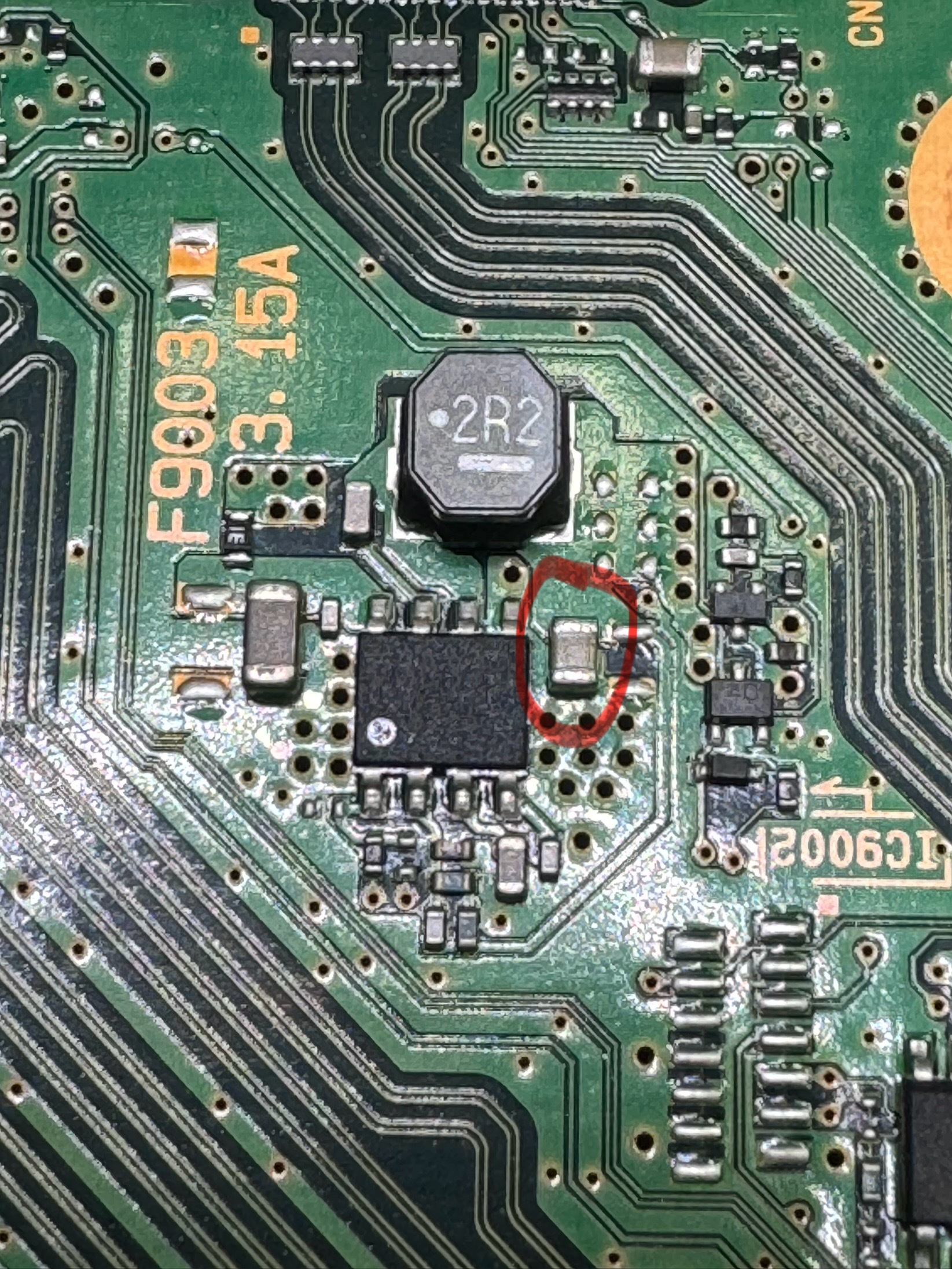

    I did also found a possible shorted cap on main board as it is showing 10 ohms when measure with meter
    or is possible the chip next to it? Pin 5 and 6 are connected. where I measure another similar chip, the pin 5 and 6 are not connected
    I just want to confirm with you guys before I take it out
    also If you guys know what spec should I use as there is no label or markings on the cap

    Hm, check those other little caps right in that area and also any other caps that size and compare.

        10 Ohm is a completely normal resistance, it can power the processor core, but there is always low resistance, if something shorted, the fuse would blow, what is the voltage on this inductor relative to ground?

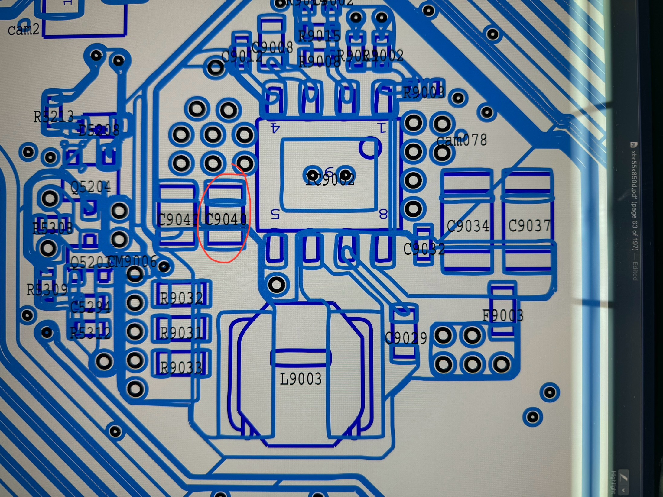

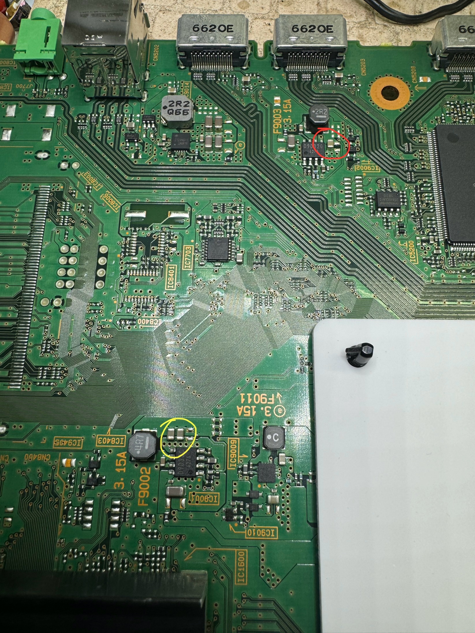

              here is another similar setup on the same board

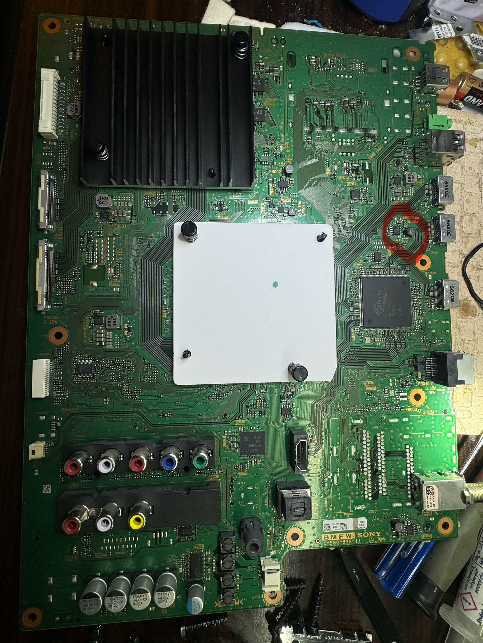

              Red circle is the one I am thinking possible shorted cap
              now measured 39 ohms on caps end or chip legs 5-6
              yellow circle
              Both caps measure 7k ohms
              and same for the chip next legs 5-6
              as for the backlights error, won’t remove the line BL_ERR to LD board and ground on the main board side would at least try to turn on the backlights (by pass the error)
              but I get no reaction
