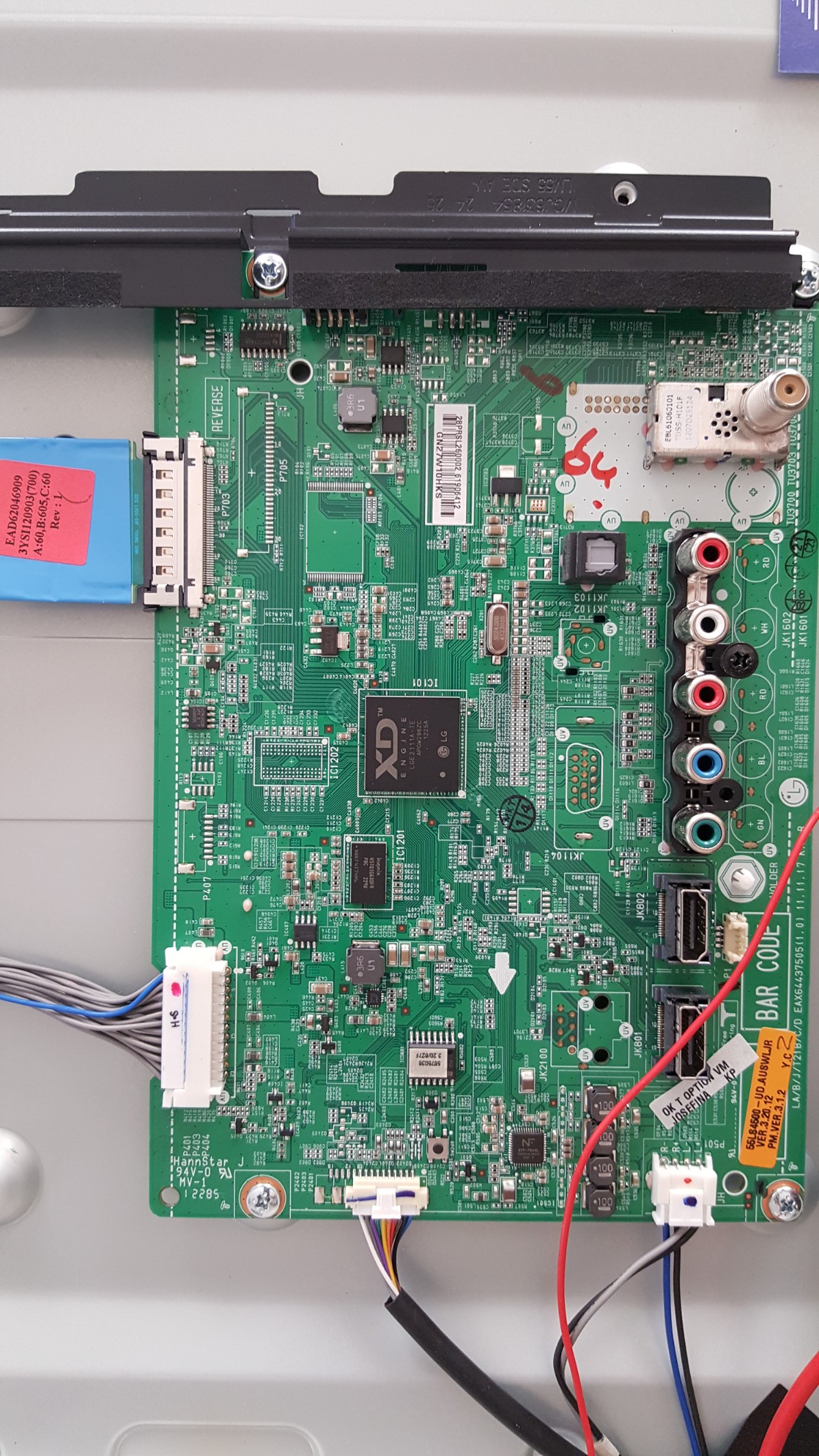

              Re: LG 55LS4500 No Standby light will not power on
              At this point we need to know what the Voltages are for all the pins of the power supply connector that goes to the main board when TV is off and when power switch is activated.
              We also need pictures of the whole back side of the TV showing all the boards so we can see what we are dealing with.

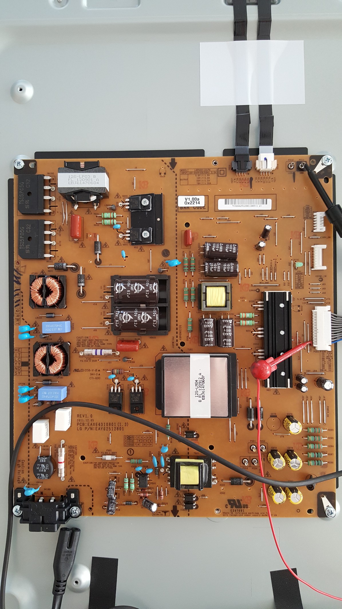

                BTW, is this your power supply board?
                https://www.shopjimmy.com/lg-eay6251...-led-board.htm
                Other boards:
                https://www.shopjimmy.com/catalogsea...?q=LG+55LS4500
                  P201 on powers supply board, Mains Connected, no standby light on
                  P-Dim2 .04
                  12V .04
                  12V .04
                  12V .04
                  GND 0
                  GND 0
                  3.5V 3.5
                  3.5V 3.5
                  GND 0
                  GND 0
                  PWR ON 0
                  pressing power on .....no change
                  I jumpered 3.5V to PWR ON before I realized it was supposed to be 24V
                  jumpering 3.5V all voltages present. 380V on large filter caps
                      when jumpering 3.5V to Pwr On the LED strip voltage is 56V. Seems low should be 78V.
                        It also need DRV-ON (BL-ON) for backlights circuit to come on, sometime the Dim control pin may also need to be forced on too.
                        When performing force on you must disconnect the cable going back to the main board first otherwise you can damage the main board, it should also be done using resistors in case wrong connection is made.
                                        Testing power supply/backlights circuits:
                                        1) TV is not plugged into AC outlet. Disconnect the cable between power supply board and the main board, leaving everything else connected.
                                        2) Put resistor (any value between 330 ~ 1000 Ohms 1/4 W or what ever you have) between 3.5V pin and PWR-ON pin.
                                        3) Put resistor (any value between 330 ~ 1000 Ohms 1/4 W or what ever you have) between 3.5V pin and DRV-ON pin.
                                        4) Plug TV into the AC outlet, the backlights should then come on and stay on as long as the AC is being applied to the TV. If the backlights still do not come on then we may have to use another resistor on the Dim control pin, but try the test first to see what happen.
                                        But based on your report (all boards connected) that the PWR-ON pin Voltage does not change state when power switch is toggle, it means you have problem on the main board.
