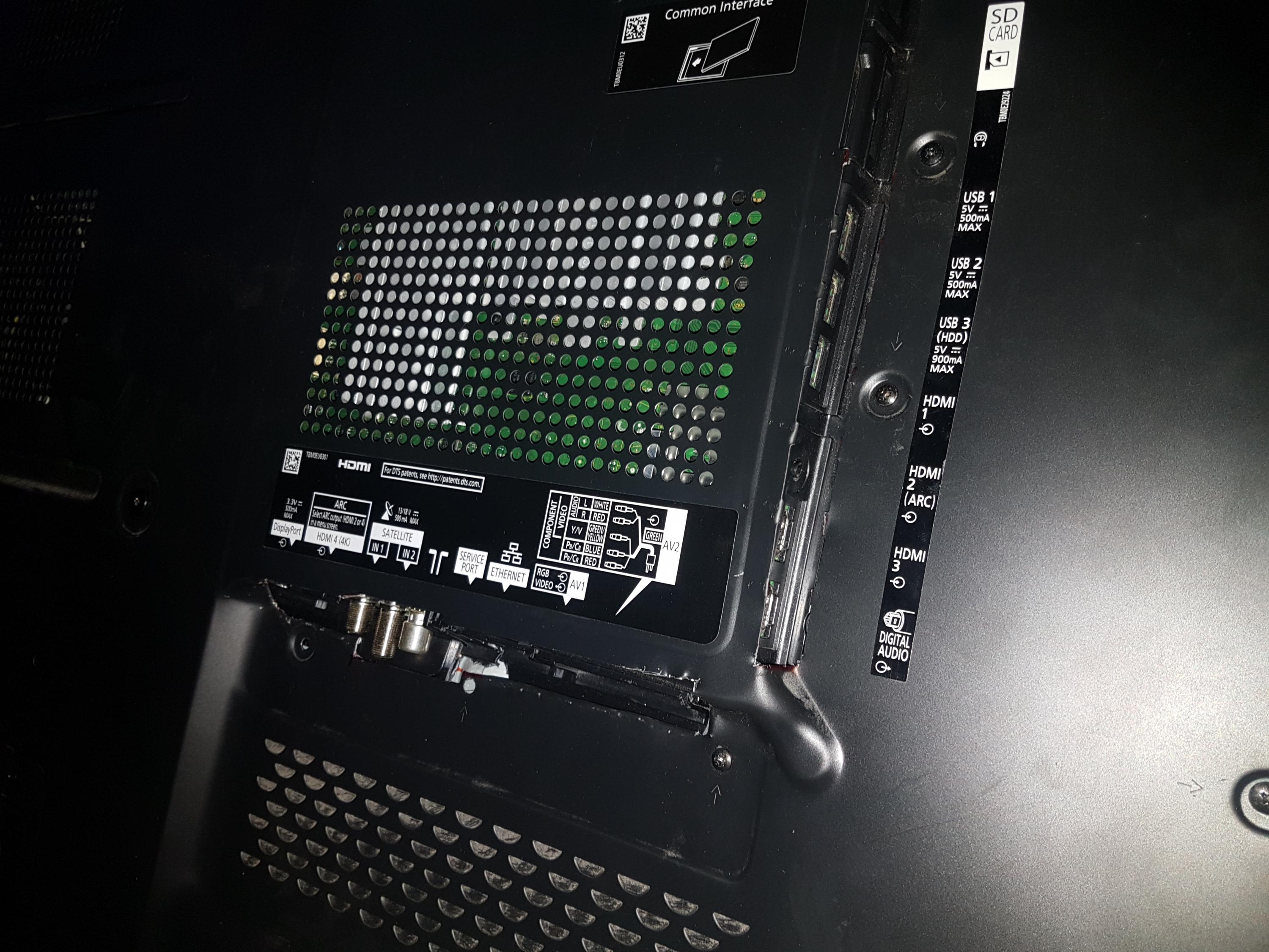

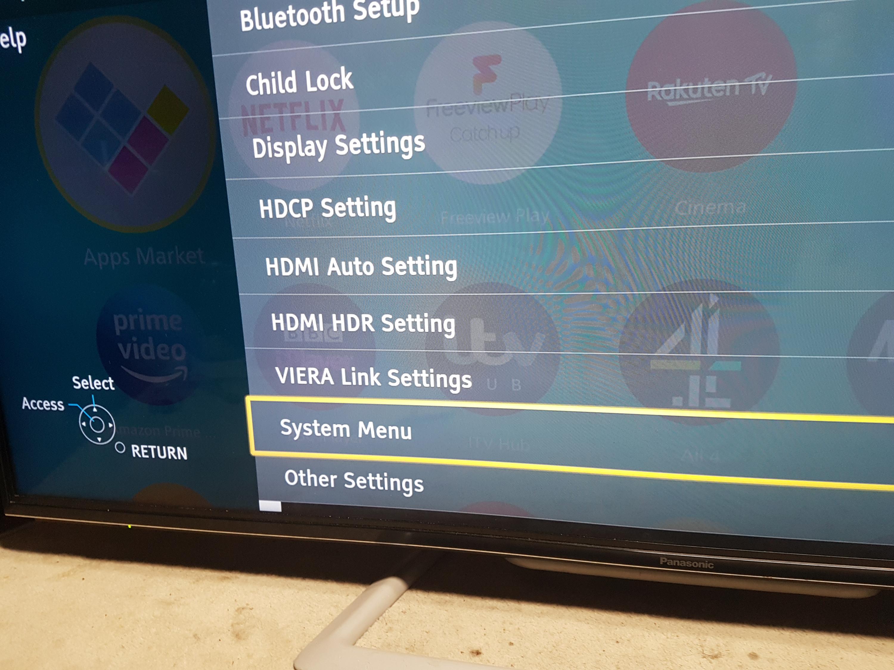

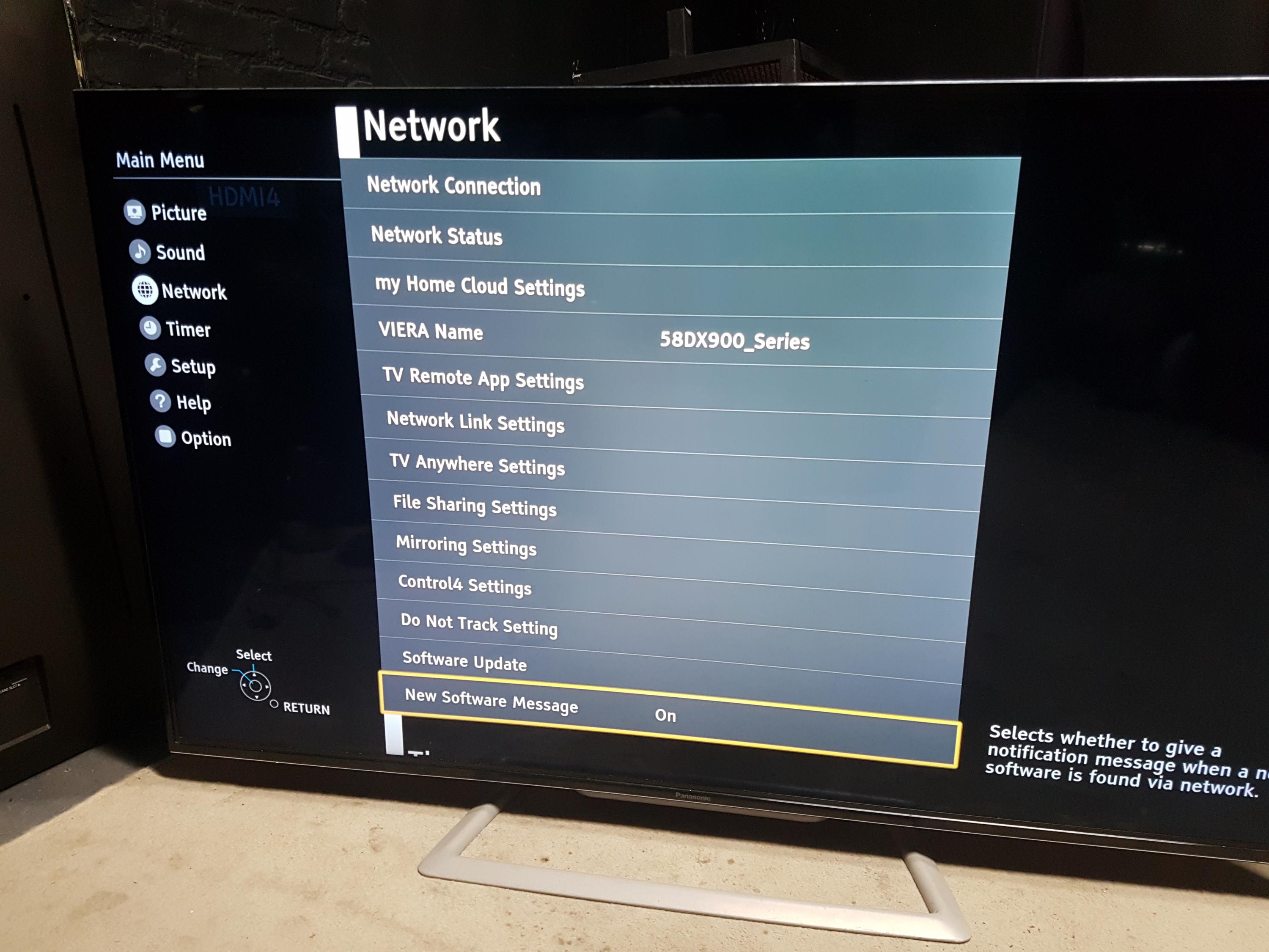

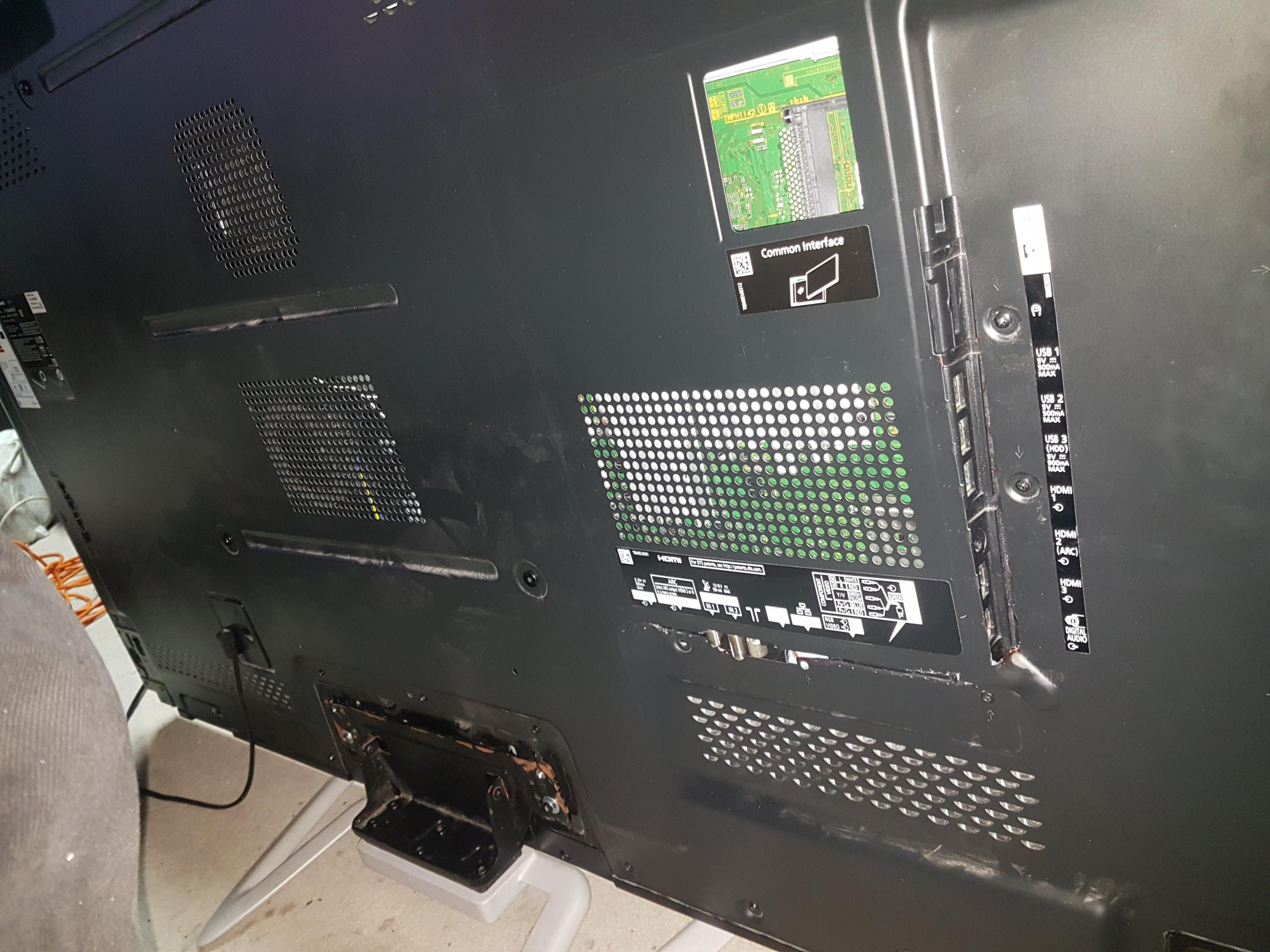

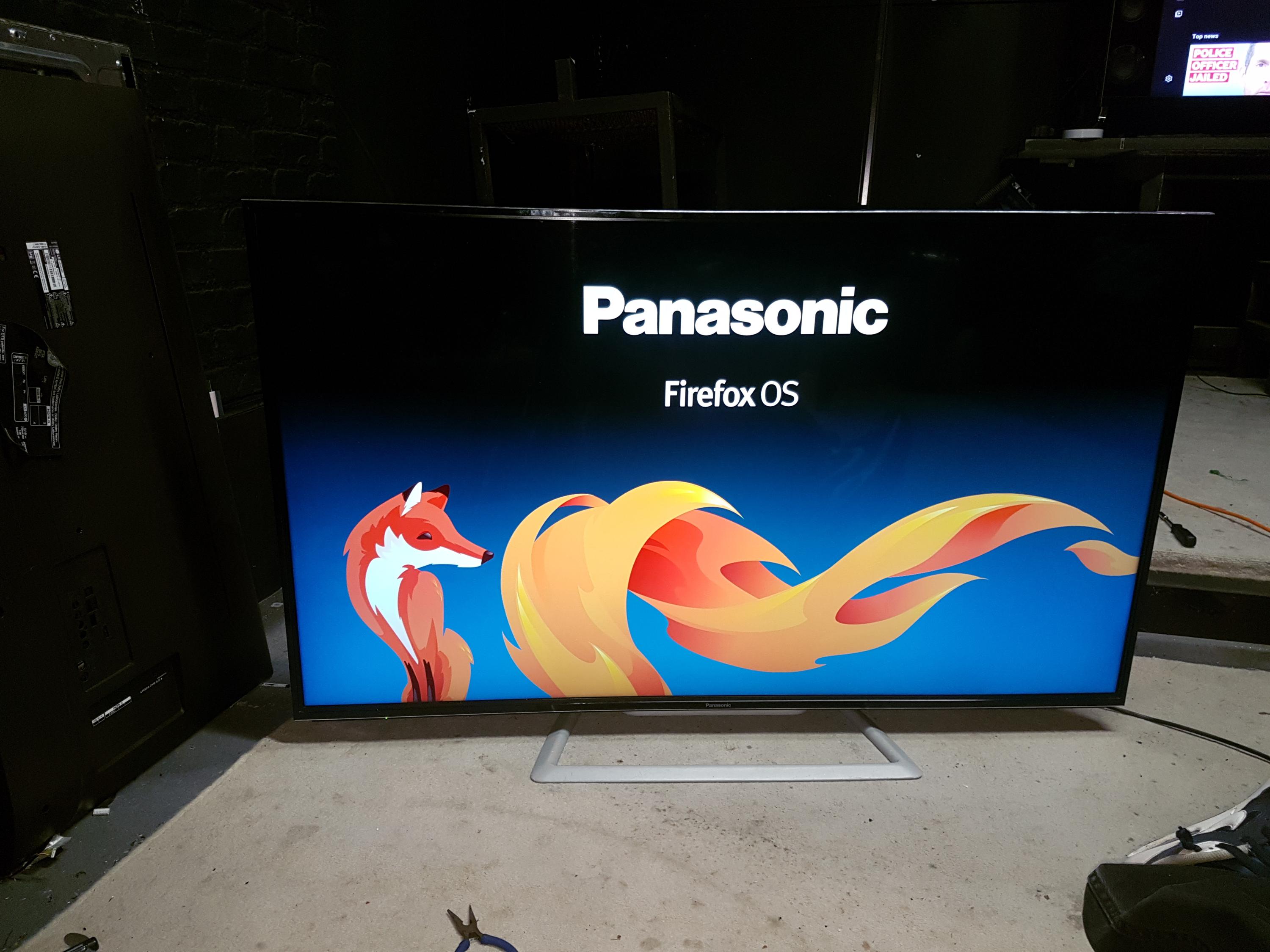

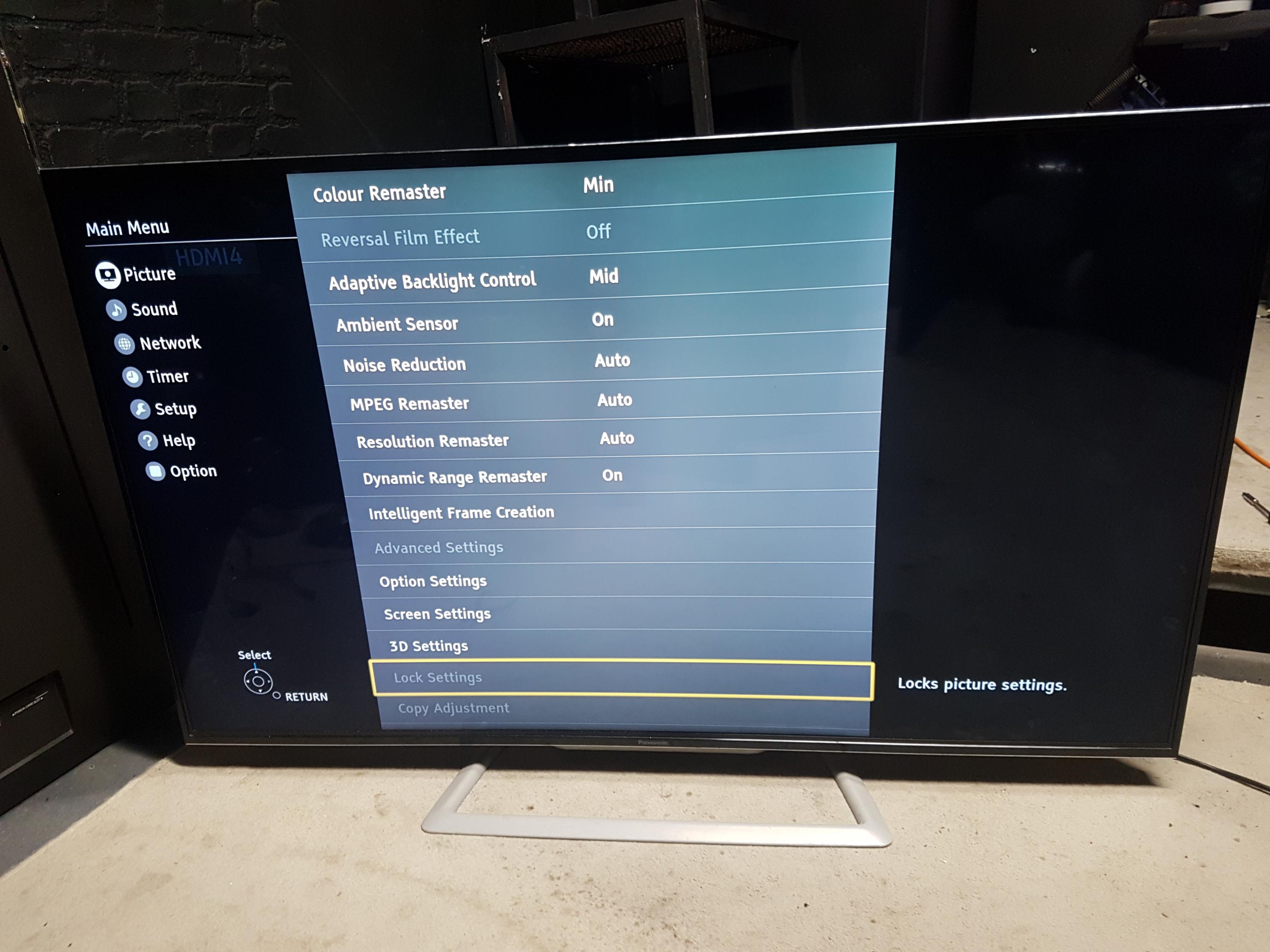

    Hi, jumping in on the end of this talk about the poor fast dying model the TX-**AX802.
    I have some good news!!!
    I picked up a main board from a TX-**Dx902 flagship model off the bay for £40 (not bad compaired to £150)
    If one ever turned up on the bay, it would most definitely end up going bad. A Bit like a £150 ticking time bomb lol...
    A little bit of modification to back cover with the metal snipped & removal of the 5 aux ports on top of the main board, also add putting correct pin to pin rewiring main to power, main to ir & buttons. This is not plug n play!!! Be warned!!! Also remove original HDMI/backlight control boards.
    Stitch up after rewire, zap with 2.6 jigga watts and Frankenstein is alive.
    I know it's A bit ghetto but keeps recycling fun

          Sounds good, what is the exact description oft the bord you used? You thik it depends in the sitze oft the TV?
          Could u show the wiring that you changed?
          Regards

                        Hi, this is such a great work!
                        I can't really understand how u wired the backlight between the new main board and the inverter board. Or is there no need for wiring. Could you please explain that to me.
                        Best Regards

                          I just downloaded both service manuals, then compaired both power boards and main boards to put correct pin 2 pin.
                          It does get very confusing lol... As long as you check your wiring 3 time over before you switch it on.
                          I wired the B/L on to the standby button, and when you turned tv off with remote it didn't turn off the B/L.
                          So that was the only thing that wasn't perfect!!
                          but just ment turning it off with the button on the side instead.
