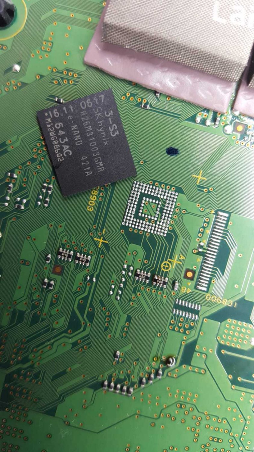

                            So I have the big brother for this TV. A TC-65AX800U.
                            It recently started getting stuck after the logo. Red LED then flashed 6 times, over and over. Stuck, had to unplug to boot again or hold power button down and release. Was intermittent but eventually it was broken for good.
                            From repair manual it said 6 blinks was Mainboard issue.
                            Part TNPH1097 (A)
                            Got a pull from China for $141. TV fixed.
                            Reading this thread I'm curious what really brought my board down.
                            I still have the “bad” one and I have an SPI programmer with SOIC-8 adapter.
                            It's on Ebay as parts/repair but if I can dump the flash, happy to help.
                            Would love to know what really went bad.
                            Got the good board on Ali-Express, they had the boards for the 50 & 58” versions as well, as of 3 weeks ago.
                            The 65AX800 is back in service, if I can dump any files that would help, tell me how. I won't be taking it apart, but maybe I can access another way?

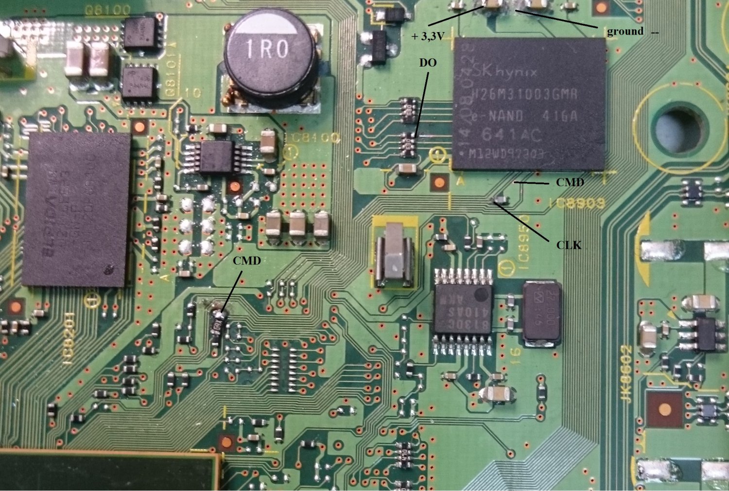

                              Hello guys,
                              My TV TX-58AX800E also died - error code, code 13 blinking led, motherboard TNPH11002A.
                              The eMMC seems now to be available here :
                              * https://**************/dump/lcd_pdp_tv/panasonic/panasonic_tx_65axw804_shassi_main_board_chassis_la53/289-1-0-138885
                              https://kenotrontv.ru/files/file/969...-h26m31003gmr/
                              Before going further, i would like to know : what kind of hardware is required for programming this eMMC ?
                              The chip is "H26M31003GMR" from SK hynix (IC8903).
                              From the service manual, it seems to be safe replacing the IC8903 :
                              "When eMMC (IC8903) is replaced, Main IC (IC8000) is not necessary to be replaced the same time."
                              Thank you for your help !
