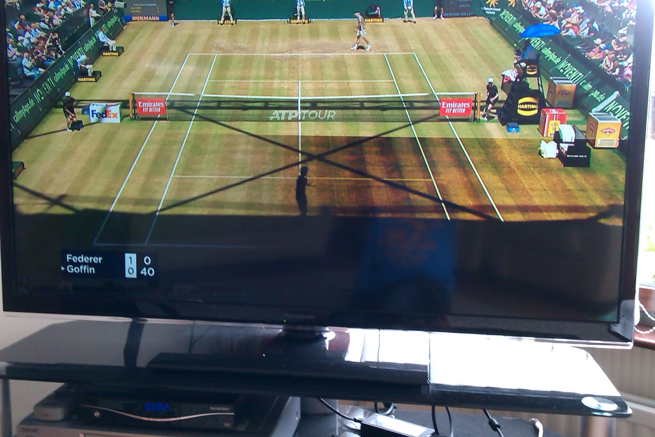

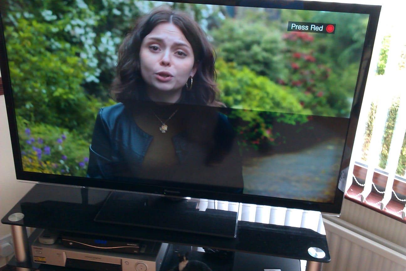

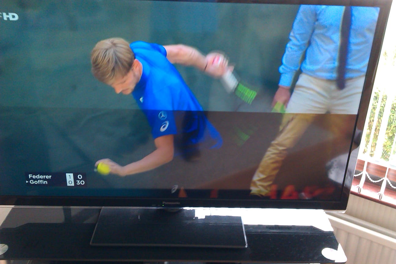

Any thoughts on this one ? Panasonic TX-L50EM6B
  • brianbelfast
    • Jun 2010
    • 29
    • Northern Ireland
    I've just been sent these photos my a friend so I'm guessing it's gonna arrive on my bench pretty soon. Any thoughts guys ? I'm thinking bad panel personally, but just wanted to see if anyone knows different. Thanks.
  • nomoresonys
    • Jan 2013
    • 12331
    • U.S.
    Re: Any thoughts on this one ? Panasonic TX-L50EM6B
    Looking like a tab bond problem, there's a similar or same issue here: https://www.badcaps.net/forum/showthread.php?t=77004
    • nomoresonys
      • Jan 2013
      • 12331
      • U.S.
      This thread I put the youtube links in, just 2 examples, there's many more: https://www.badcaps.net/forum/showthread.php?t=72836
      • brianbelfast
        • Jun 2010
        • 29
        • Northern Ireland
        Yeah I guessed as much. Thanks so much for the quick reply. Much appreciated.
