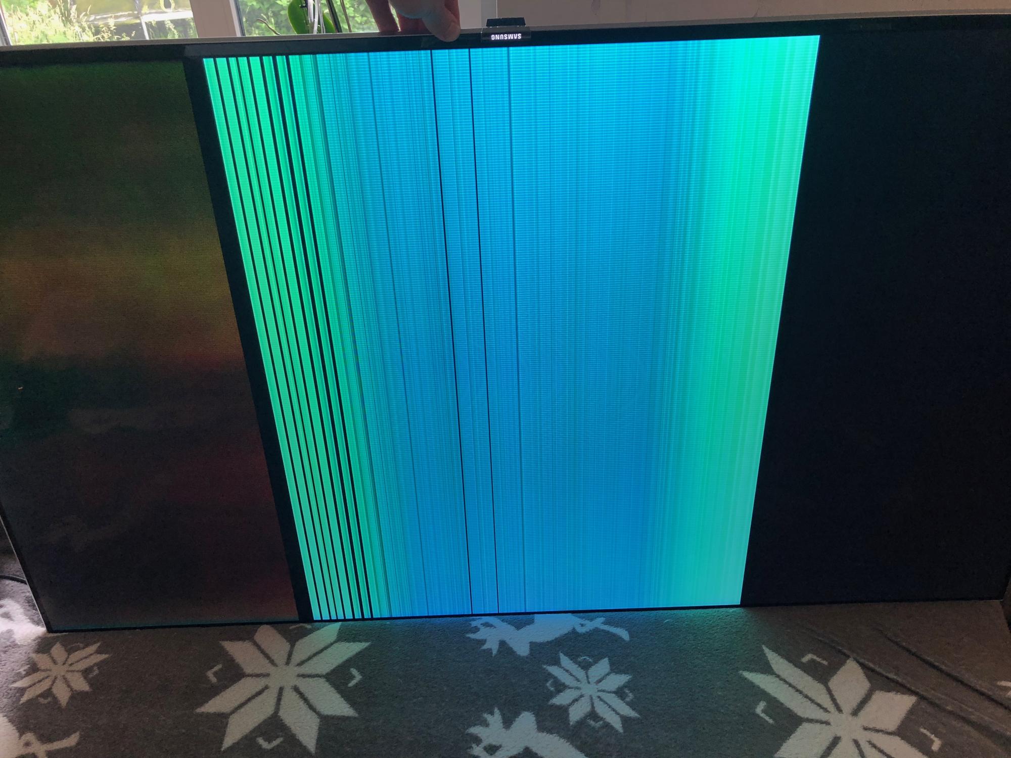

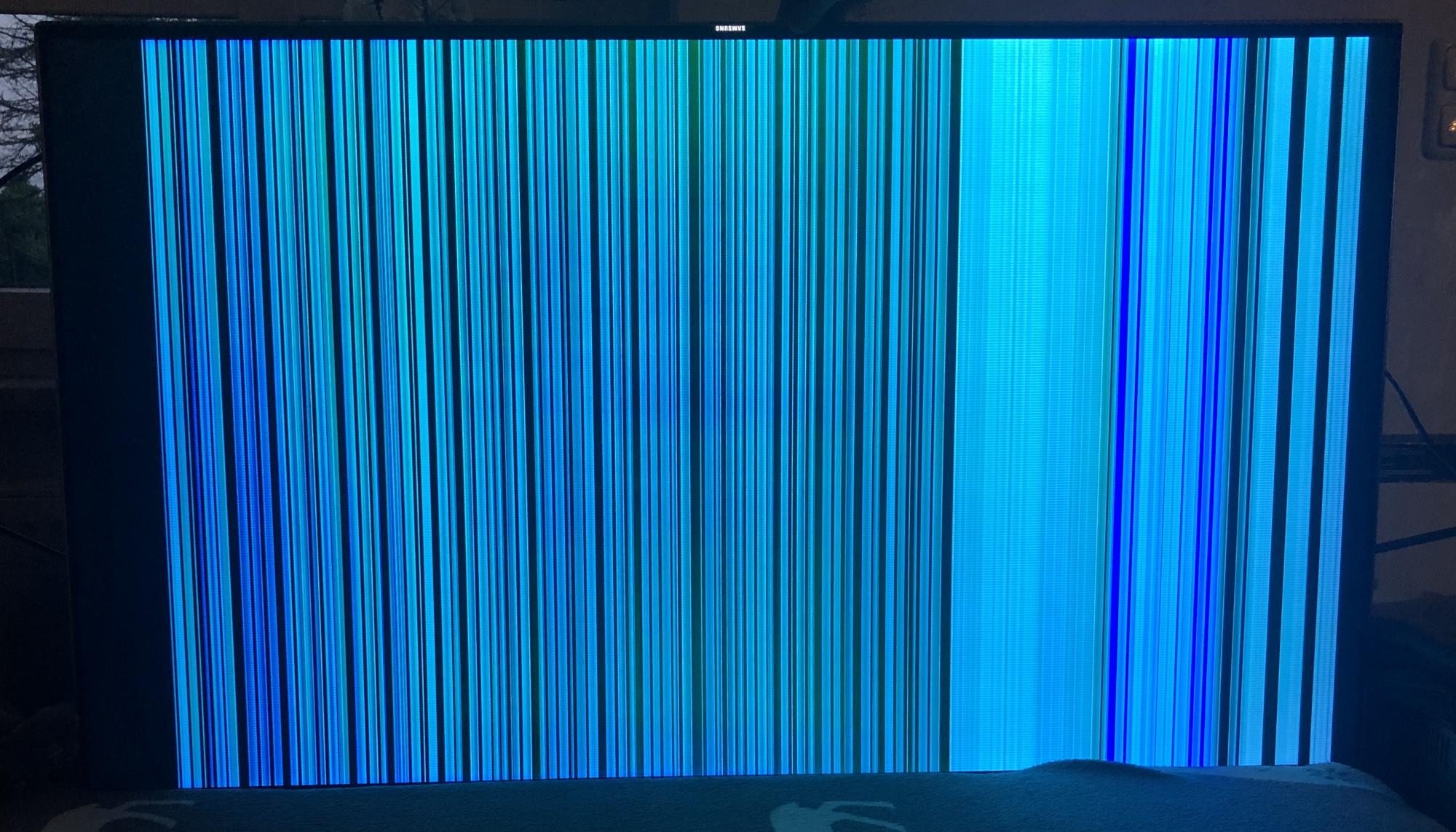

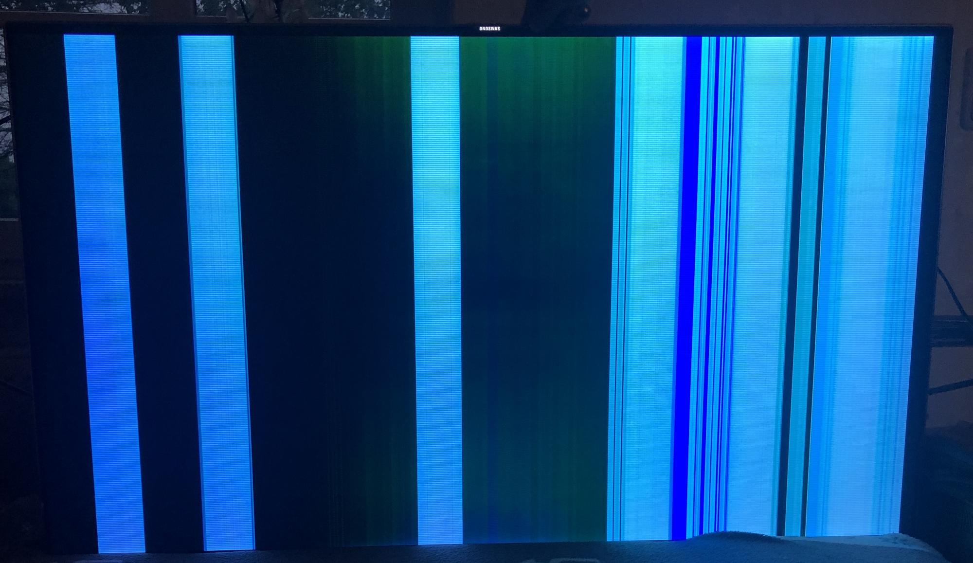

    Hello guys,

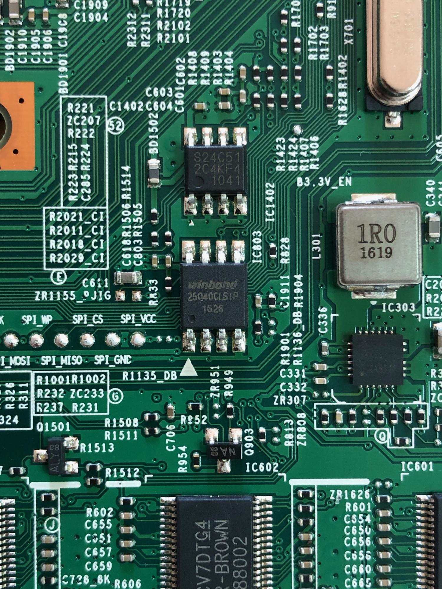

    I bought this awesome 55" Samsung TV. The problem was, that it tried to start but did this indefinitely.

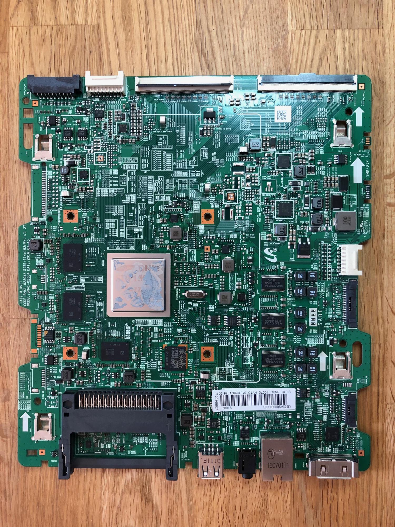

    I found a relatively cheap mainboard from a 65" KS8090 with broken panel and bought it. It is mechanically identical.
    After mainboard replacement the TV started again. I was able to pair the smart remote and I could hear sound.

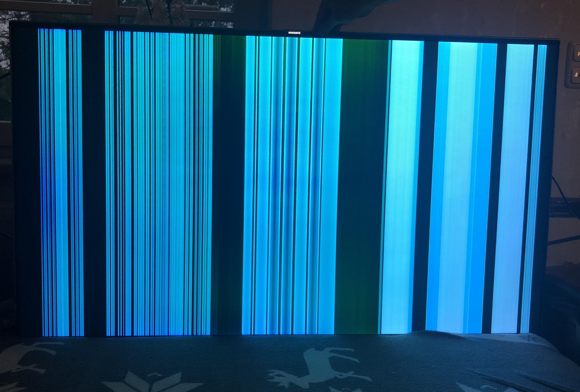

    The problem is, that the TV does not show the right image. It only shows vertical colored bars.
    The colored bars change with the content that should be displaced on the screen.
    Sometimes they are all over the screen and sometime only in the middle or at one side.
    I flashed two EEPROMs (W25Q40 and W25Q80) with the software from remont-aud: https://****************/dump/crt_tv.../102-1-0-63971
    This dump was from an UE55KS8000. At the moment I can't flash the 24C512.
    But the problem stays the same. The TV works, but the displayed picture ist wrong.
    I attached some pictures of the mainboard and the weird displayed image.
    Has someone any ideas? I don't know what to try next.
    Thanks!
    Hauke

        Well to be honest this could be 2 things.
        1) Bad t-con ( if available )
        2) Bad panel.
        Did you check the boards connected to the panel for liquid damage? There are people out there that clean tv's with water hahaha.

          Re: Samsung UE55KS8090 - Mainboard replacement failed
          @Moreno83: Oh no, that would be very sad..
          There is no real T-Con board like it is in other TVs.
          I asked the seller of the new mainboard and he said, that he also wanted to repair his 55" TV with this mainboard. He told me, that he had vertical bars, too. He thought his panel was dead and so he sold the mainboard.
          Maybe the "new" mainboard is defective? Could this really be caused by a bad mainboard with integrated t-con? If yes I would try to buy a brand new mainboard for about 150€.
          What would you say? Would you risk it?

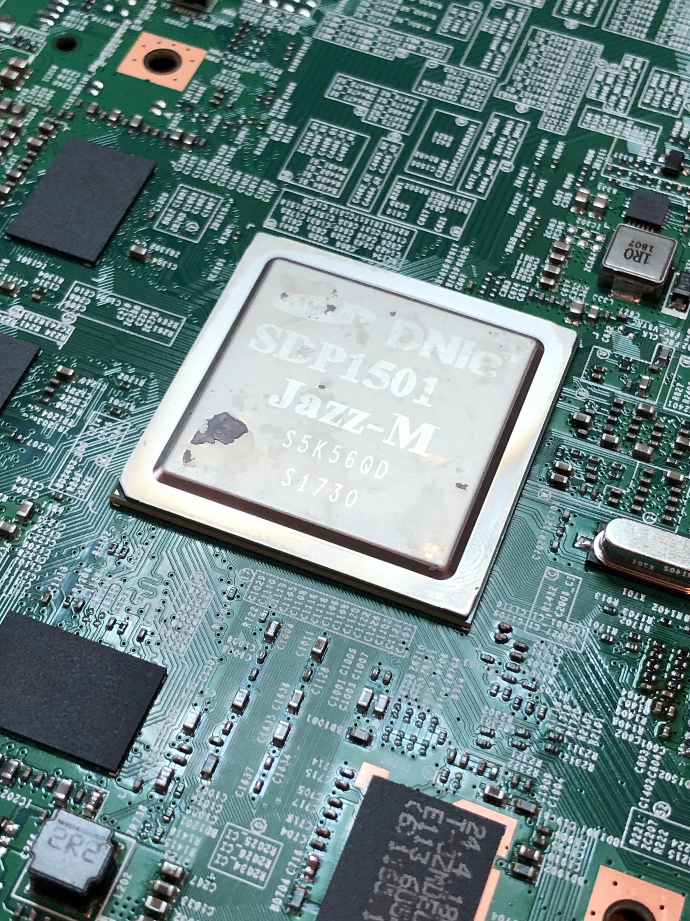

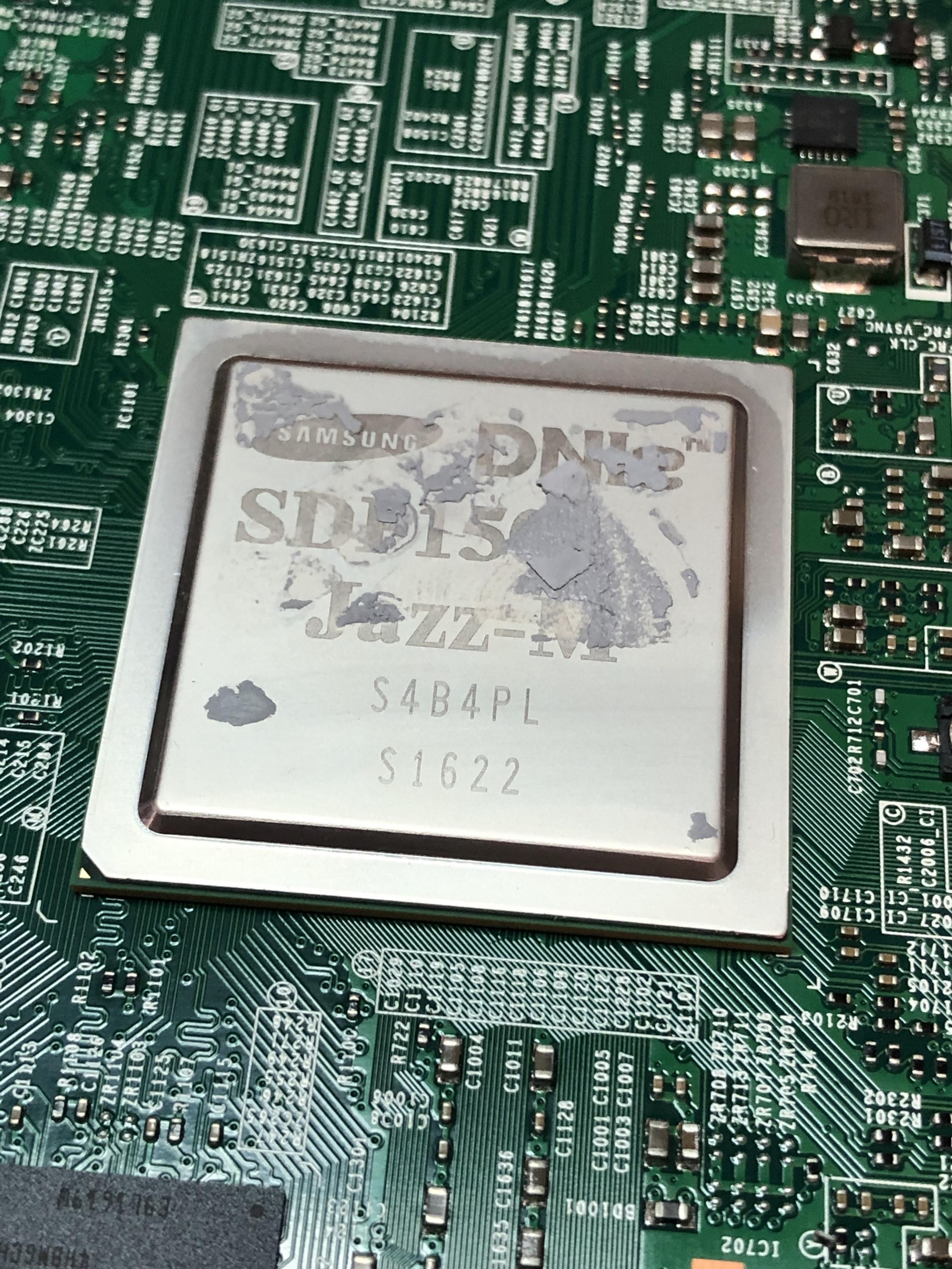

            Could it be possible that the 55 inch and 65 inch use different main CPU chips on the main board? Even if it is the same board part number it may be a different revision. This could possible cause the lines.
            • Hauke
              • Jan 2017
              • 78
              I checked the CPU chips. Maybe you are right.
              Both boards use "SDP1501 Jazz-M" chips, but the the original mainboard has a "S4B4PL S1622" and the new board has a "S5K56QD S1730".
              I will try to find the datasheet and look what these numbers mean.

                SDP1501 Jazz-M both same.usually the integrated T-CON located at the panel taps not on the main boards.. back to post #4 and inspect the panel taps this should be the first things you need to do right now.
                  Ok, ich checked the panel taps. They looked good.
                  I got a little deeper into troubleshooting. I bought a UE55KS9090 with a broken panel really cheap. I read, that the only difference between my model and this broken unit is the curved frame.
                  I took out the mainboard and put it into my TV. I got these colored lines again.
                  Then I put my replacement mainboard in the TV with broken panel and now this unit displays colored vertical lines too. After putting in the original mainboard the screen was normal again.
                  It looks like the mainboards aren´t exchangeable..
                        Kind of looks like the mainboard you bought is defective???
                        I don´t really know. The mainboard from the TV with broken panel also creates vertical colored lines in my TV.
                        Originally posted by William1967
                        Every type of display has it's own screencode, a 65"has another code than a 55" so I guess that's wil be the problem.
                        Yes, but the mainboard of the 55" TV with broken panel does also not work in my TV.
                        After reflashing all EEPROM and Flash ICs on my original mainboard it starts. Now I can hear the starting sound and the backlight comes up. But the panel stays black.

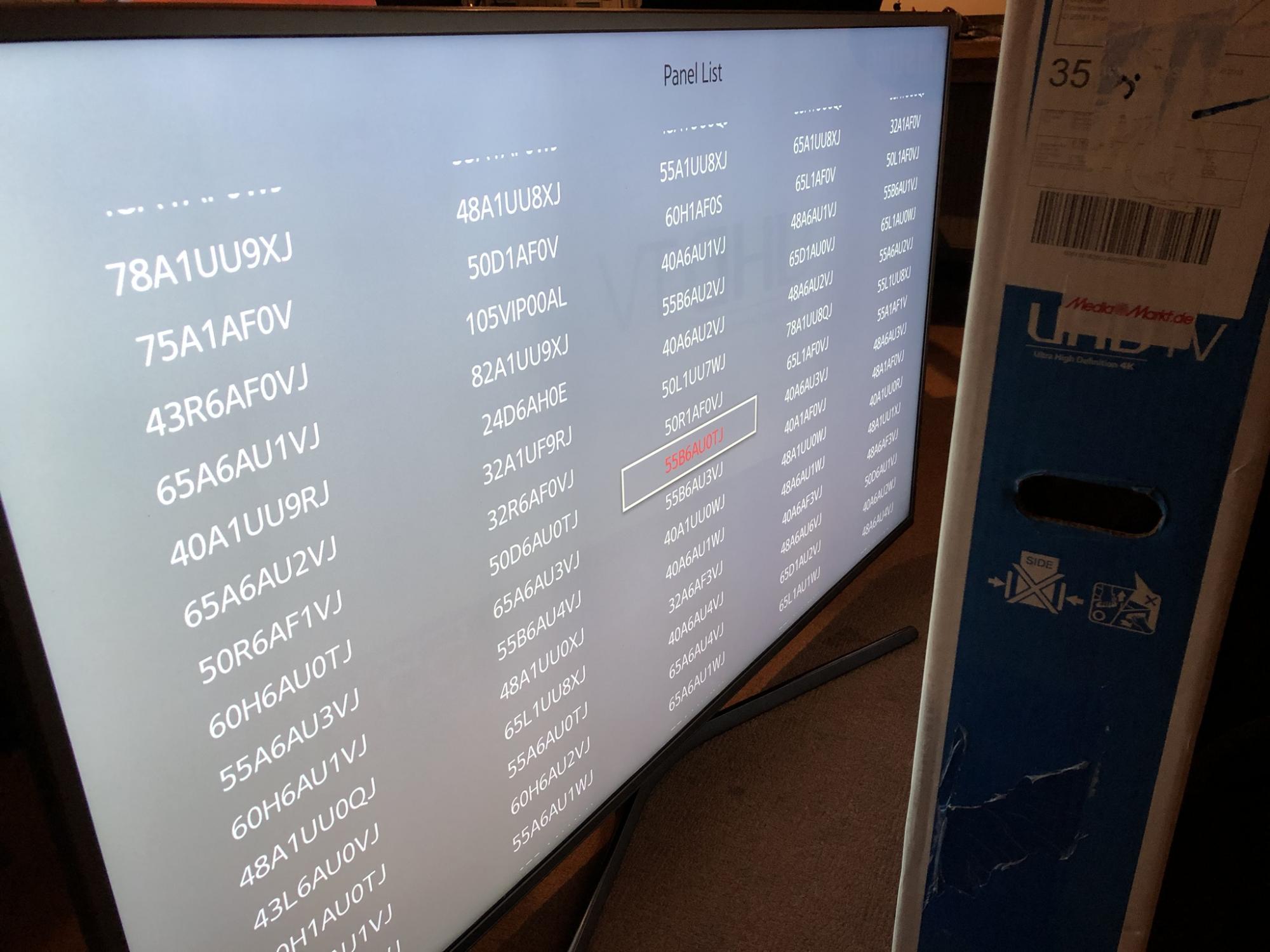

                              Thank you nomoresonys! I managed to do a factory reset. I pressed INFO -> MENU -> MUTE -> POWER. After the TV booted completely I pressed OK several times to select the factory reset.
                              Now the TV starts with the initialization sounds, but the screen is dark. The backlight is alright.
                              At this site I found some pictures of the service menu: https://forum.samygo.tv/viewtopic.php?f=94&t=10732
                              There are some configurations about LVDS, T-CON and Panel available in the service menu. I think "LVDS format", "Panel EEPROM upgrade" and "Panel flash upgrade" are interesting. But I don´t know what these really mean...
                              Maybe I will try to call samsung tomorrow. I never had luck with customer support until now, but maybe they can help me.
                              Edit: I found this menu in an other Samsung UHD TV of mine (Picture attached). Maybe this could be the reason? But how to select the right one if I cant see anything..

                                is there a setting for panel id number or size ?
                                    I will search for it. The only thing I found until now was the panel selection menü.
