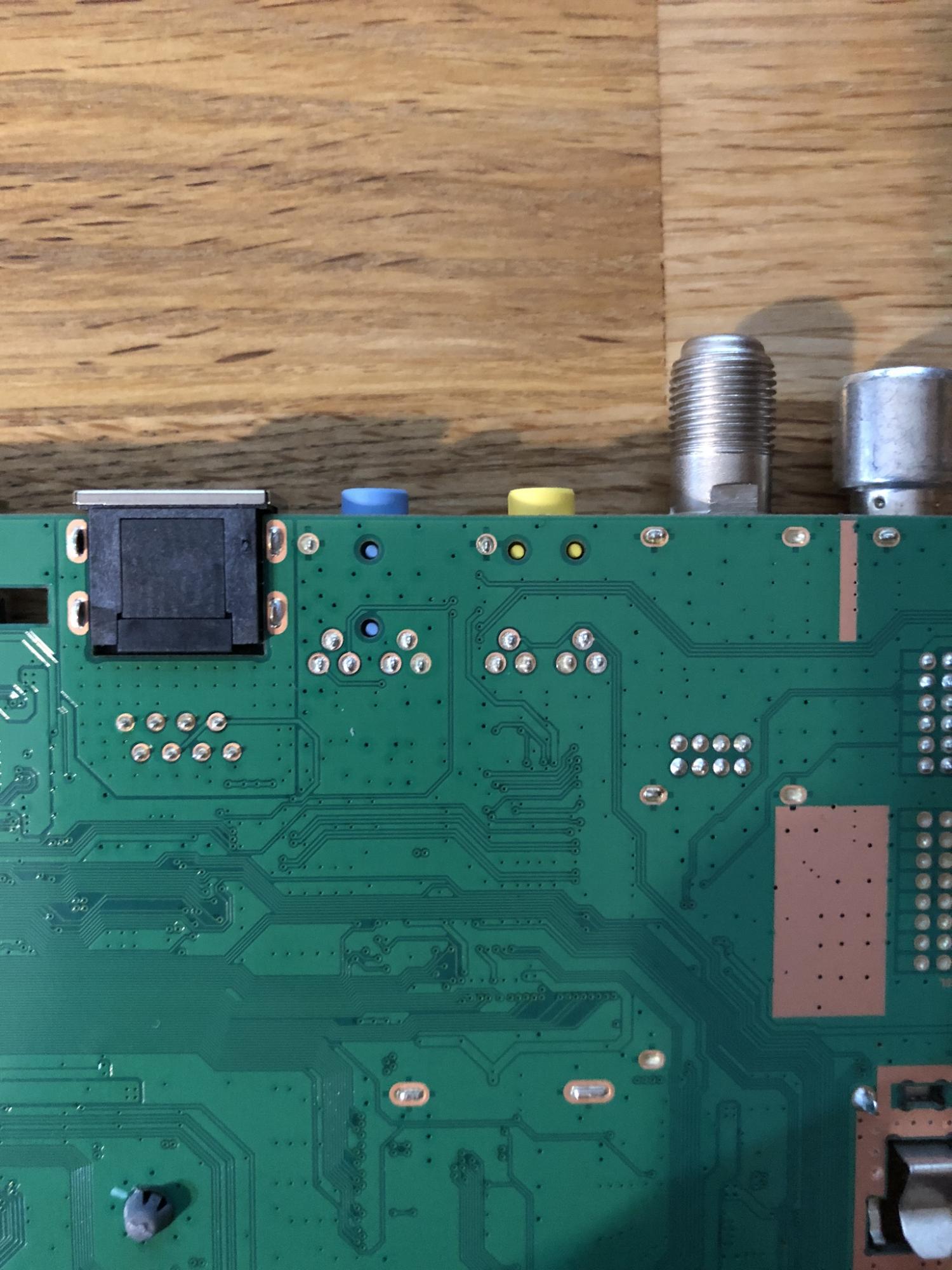

          • Hauke
            • Jan 2017
            • 78
            Re: Samsung UE55KS8090 - Mainboard replacement failed

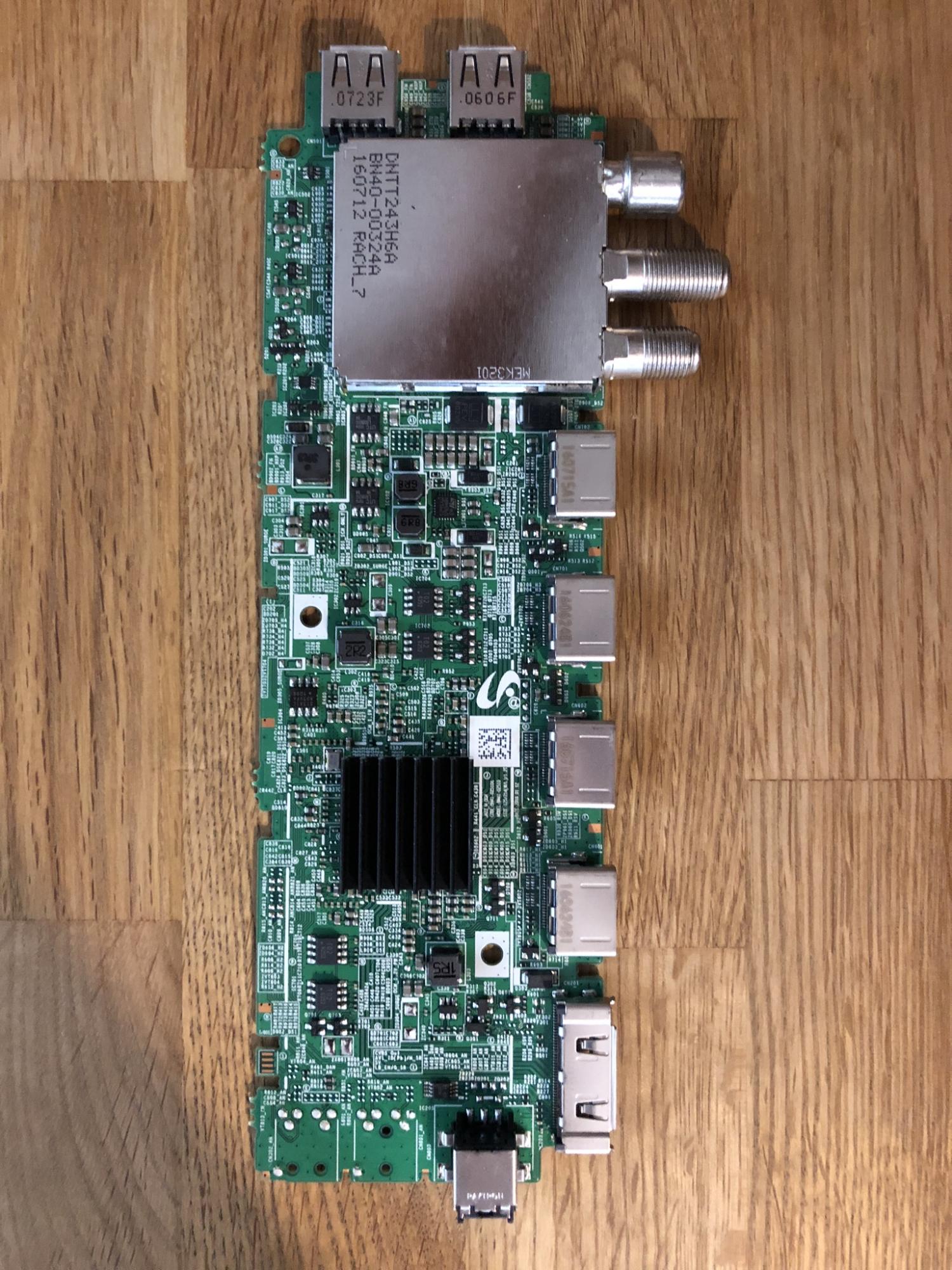

            Because the One Connect Box has just 4 HDMI, 2 USB, SAT and Optical Audio. This is my box: https://shock-store.de/multimedia/31...ox-bn91-17814c
            Ok I will try out all variations.

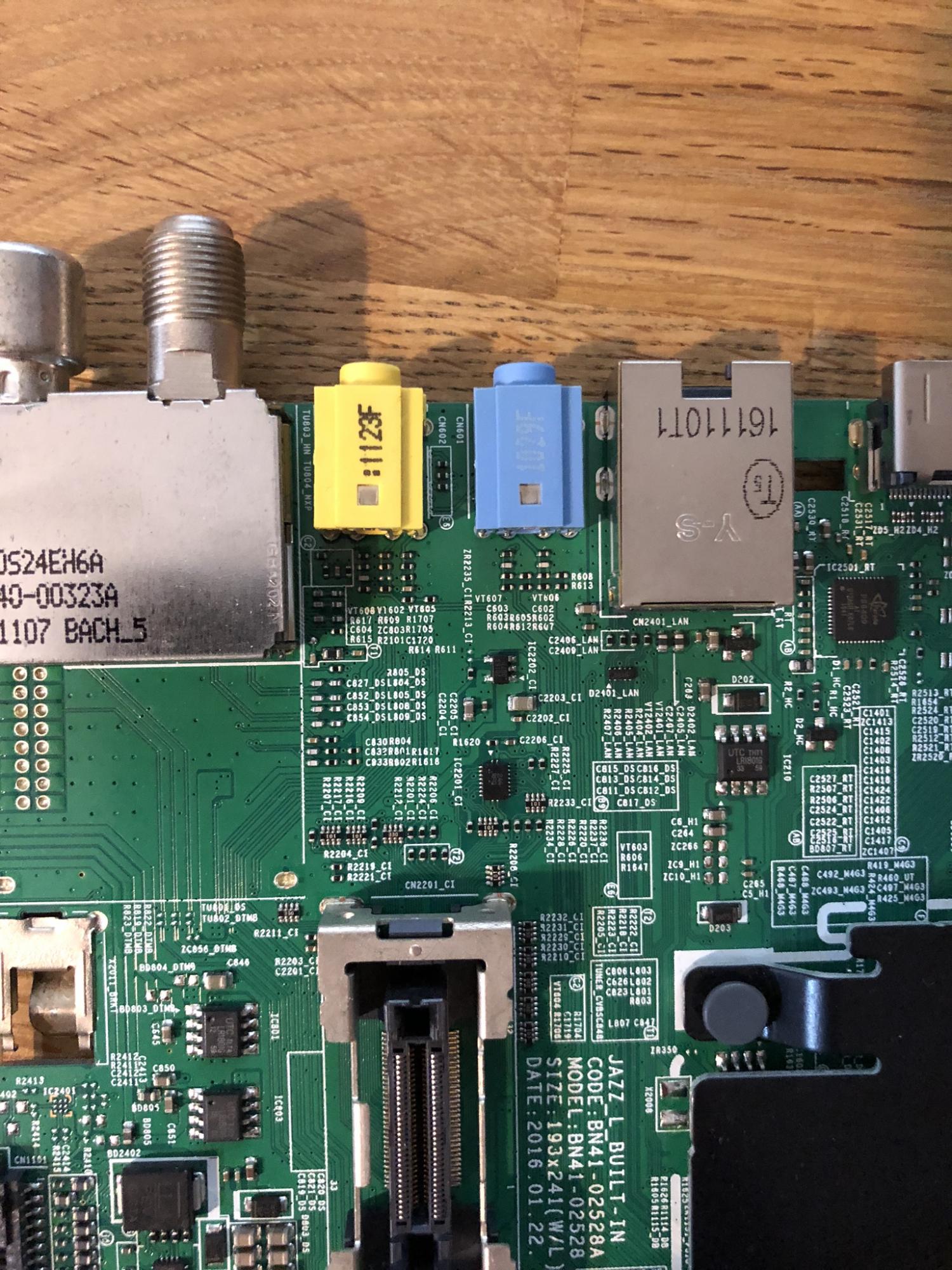

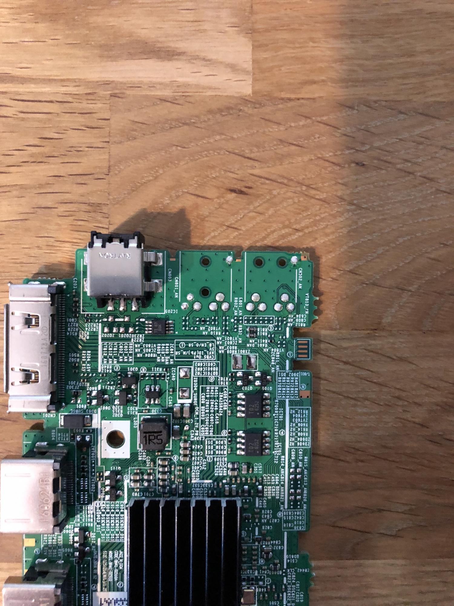

            Edit: I attached a photo of my one connect box pcb.
            It looks like there are 2 connectors "missing" which could be the ones for analog video.
            Edit 2: Sorry for multiple editing. I checked another samsung UHD mainboard and these are really the analog I/Os. The connectors have the same footprint. I try to solder the connectors from the board to the one connect box. Maybe I am lucky and these are enabled. I also added some more pictures.
            • R_J
              • Jun 2012
              • 9625
              If they did not install the jacks on the board I suspect there will also be other componets not installed that connect the jacks to the circuit. Resistors, caps, diodes etc.
              • Hauke
                • Jan 2017
                • 78
                Yes, I was too fast. I didn´t see that those passives were missing..
                Is there an other way to get the output of my TV on a second TV? What happens if I connect two TVs with the one connect cable?
