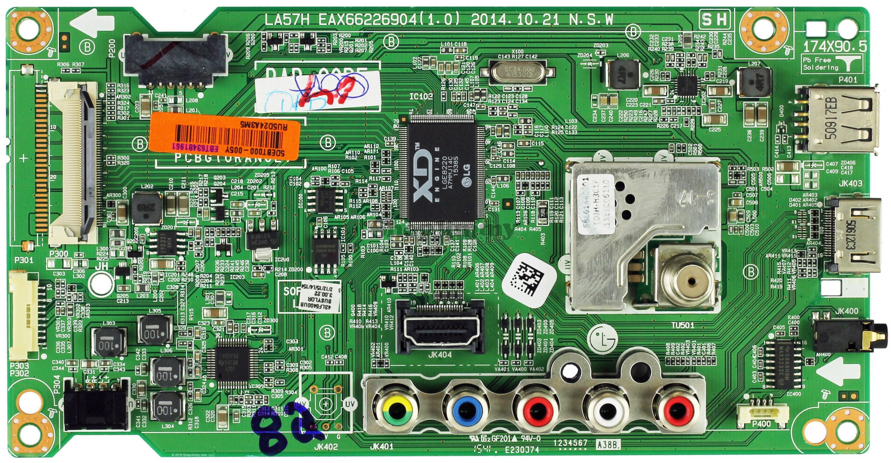

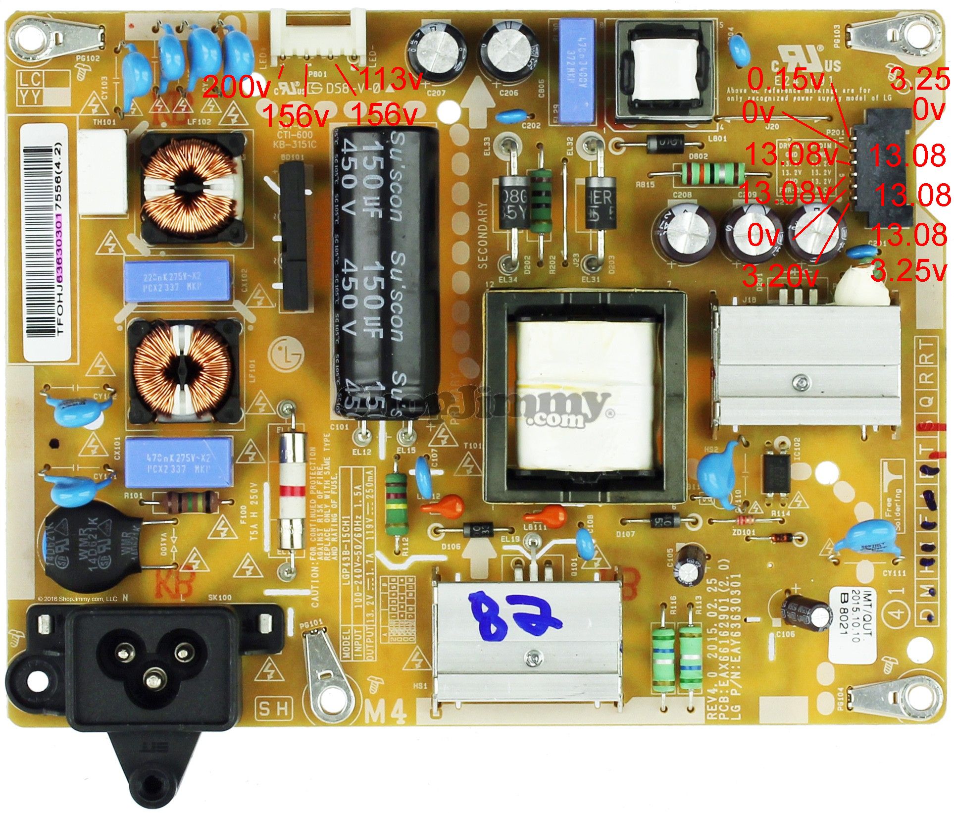

Has anyone had experience with a lg 43LF5400-UB that will not power up?
No standby led, no sound, blank screen - just seems dead.

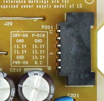

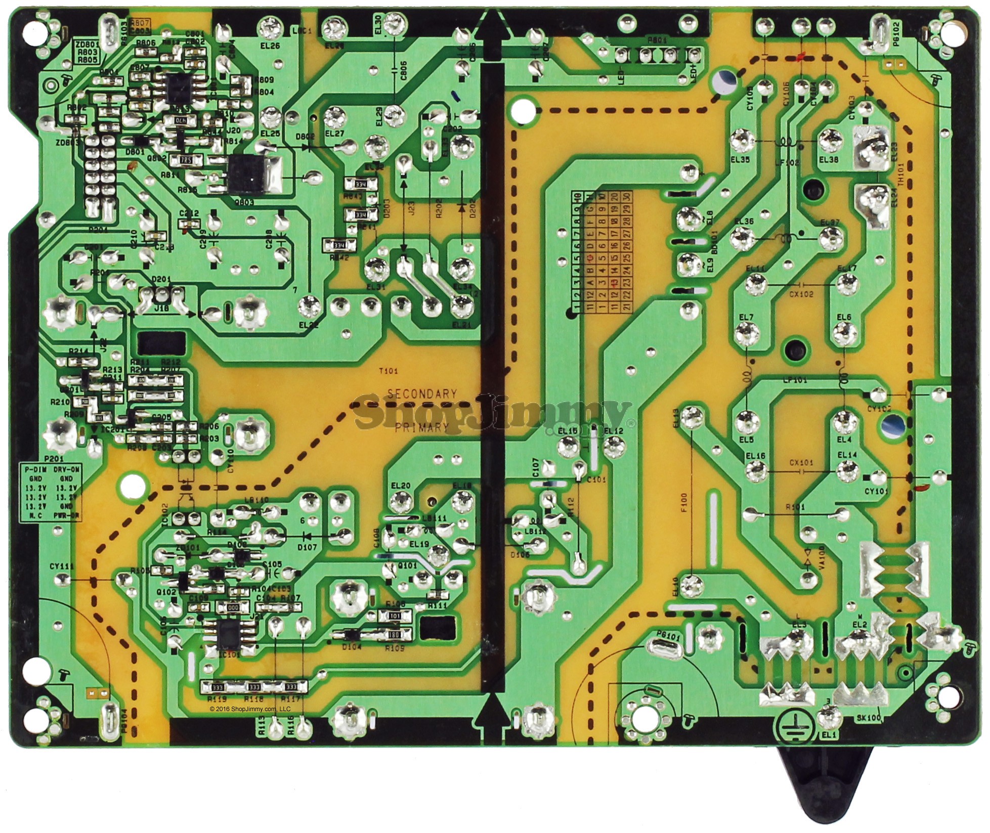

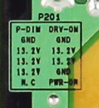

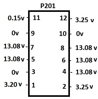

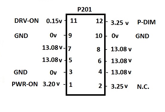

The pwr supply does have
. 169v on the filter cap
. 200v to the backlights
. all backlight leds ( 72 leds => 2 x 36 ) are good
. 3.2v standby
. 13v to the main board

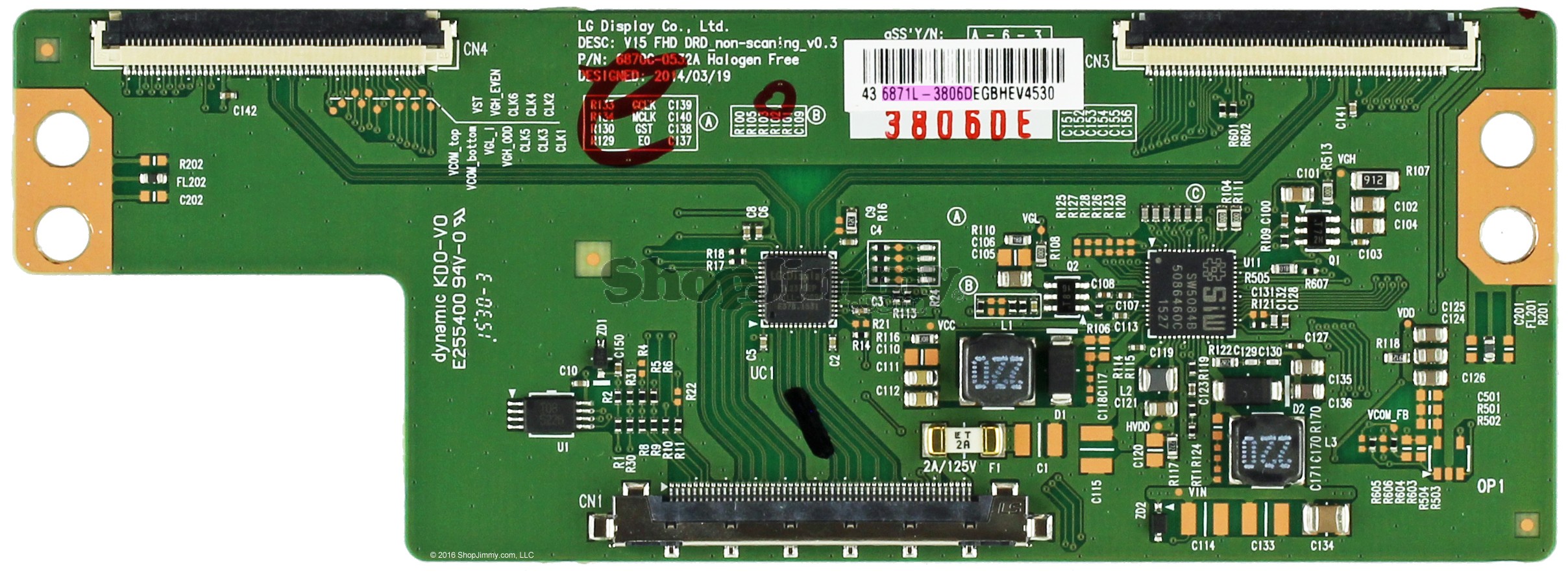

The pictures included are from ShopJimmy.com

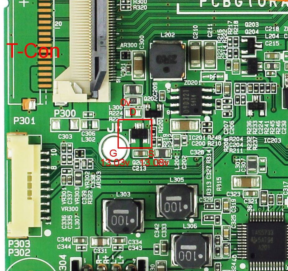

Also what would be the symptoms for a corrupted Eeprom?
