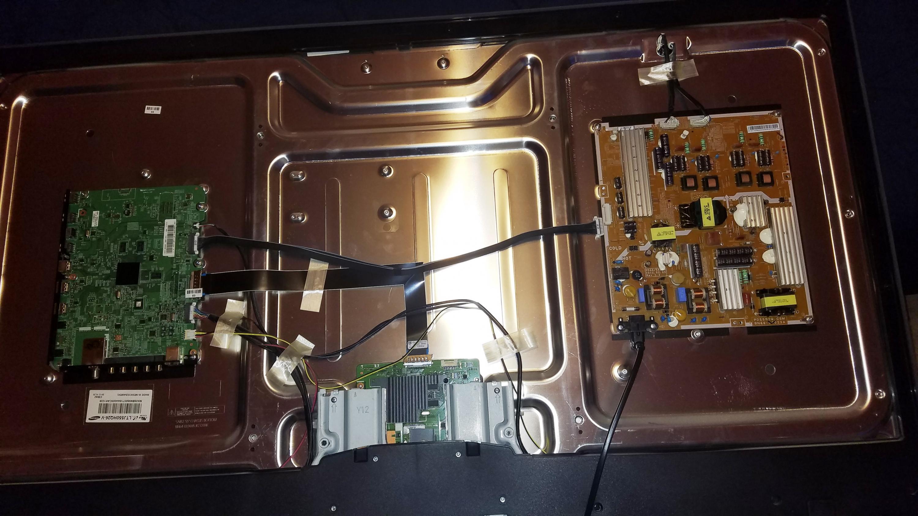

    Samsung UN55ES7100 Blinking front light and no backlight - clicking
    Unless I'm mistaken, these Samsung TVs typically turn the backlight on when main to PS cable is disconnected.
    This TV does not. Tested the backlight (edge) and they all seem to turn on.
    There doesn't seem to be power to the backlight from the PS. measurement of few mV.
    Main caps only have 162 VDC on them.
    I'm assuming the PFC is not kicking in / working?

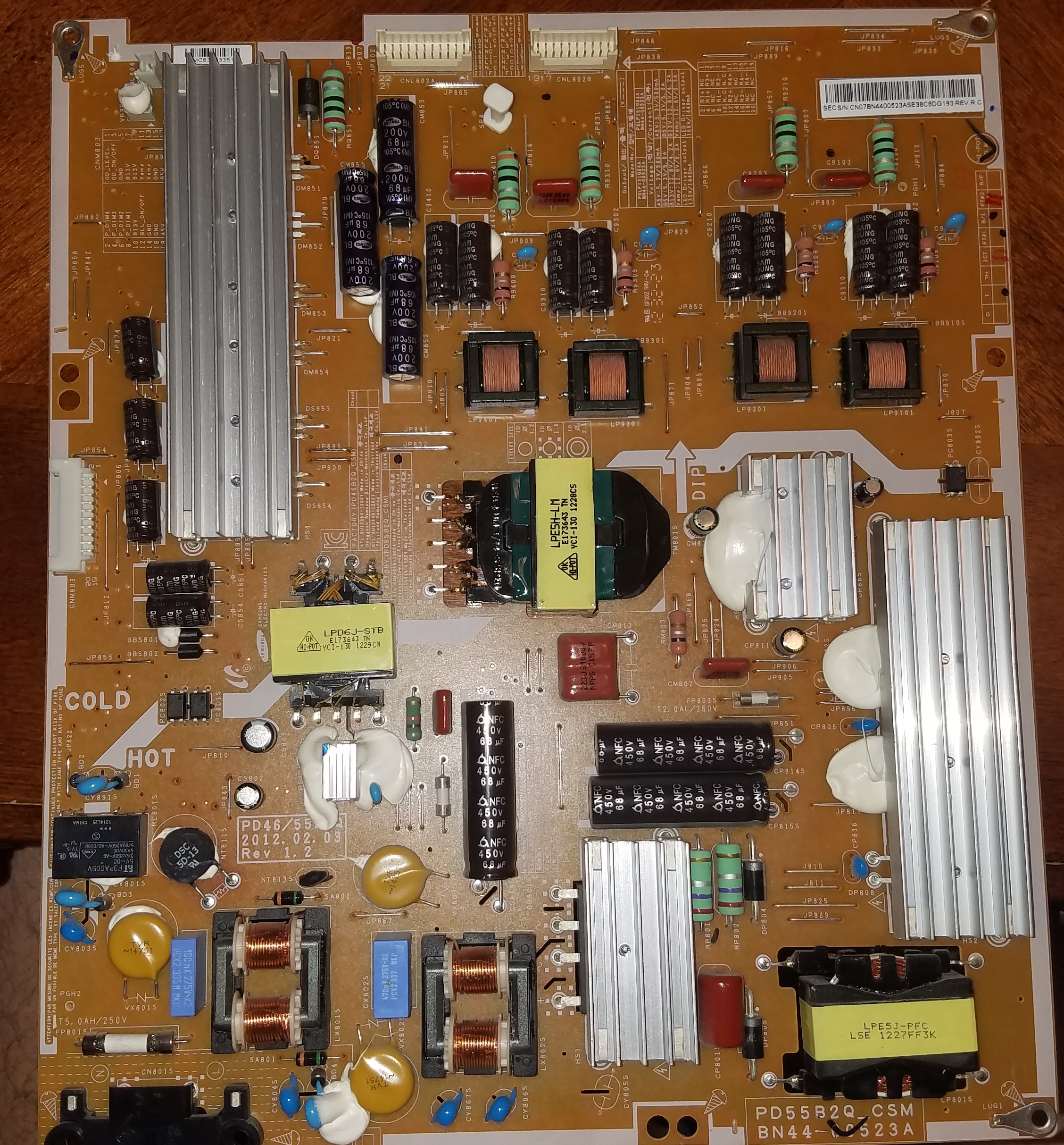

    I'd like to fix the board (BN44-00523A), but I haven't had much luck with a schematic.

            The PS_ON pin should turn on the power supply main supply and pfc only, and give you B5 and B13 volts, not the backlight, that can use a different pin/s
            Have you checked the fuses FP802s & FP803s?
            I see shopjimmy lists a repair kit for this board, maybe check the parts shown in there kit

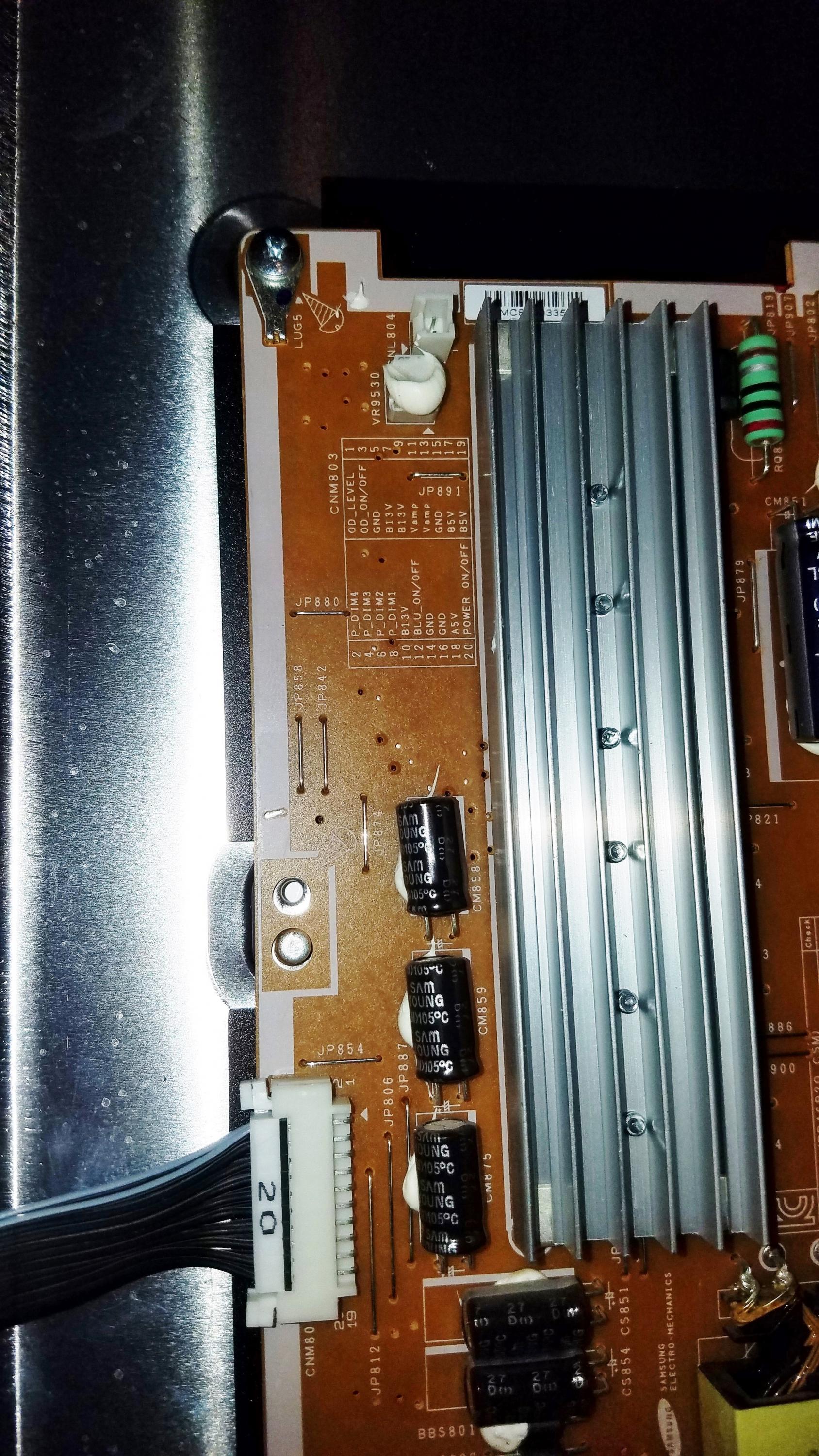

                Re: Samsung UN55ES7100 Blinking front light and no backlight - clicking
                referring to the photo here (PS labels), with the connector unplugged from main
                Pin 20 is 3.3 V
                Pin 18 5.14 V
                No other voltages are present.
                I jumpered 20 to 18 = No state change (no clicking)
                connected 12 to 18 and to 20 = No change
                Connected 3 to 18 = no change
                In all the combinations above, B5V, or B13V never came on.
                  I would'nt worry about the backlight circuit, you first need to get the B5v and B13v working.
                  Did you check what I asked before?
                  You say pin 20 is 3.3v, that is with the plug disconnected from the main, Pin 20 should have a pullup resistor connected to A5v. It then connects to another resistor to the base/gate of a transistor. That transistor may be bad and if it is the power supply will never turn on.

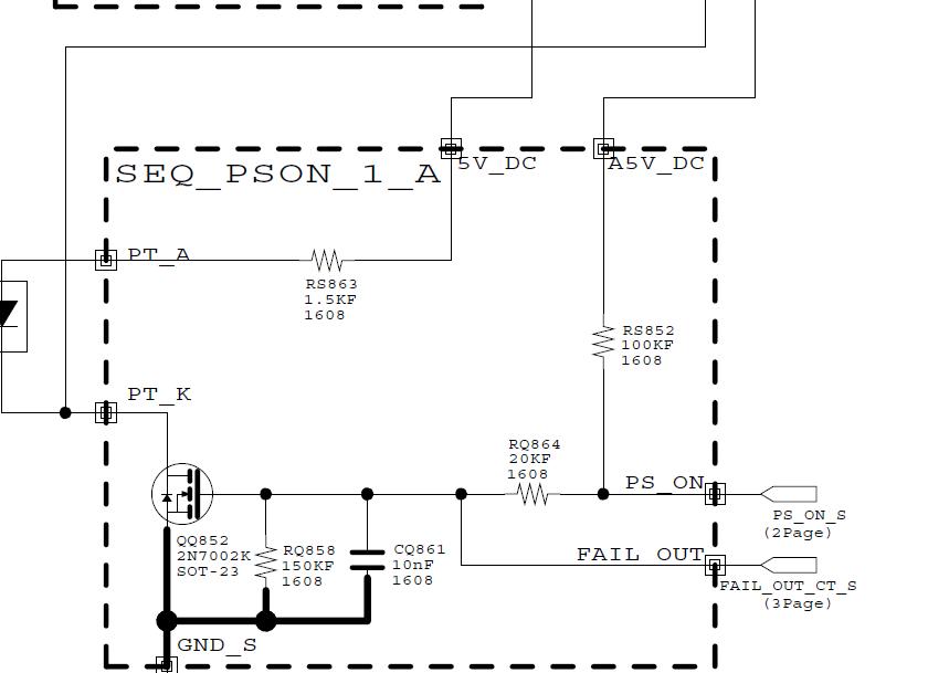

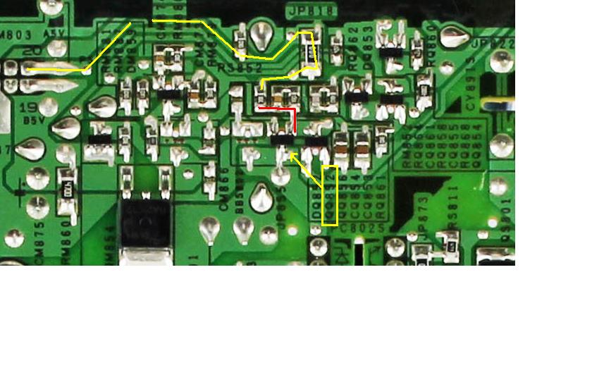

                  Locate QQ852 and check the resistance between the gate (marked in red) and ground, next to it is QQ856, it might be shorted also.
                    Resistance between base & gnd is 67.6k (keeps going up slowly) high impedance on the other transistor as well. No sign of shorting

                      I guess RS852 must be a high value (100k) so it drops the A5V down to 3.3V at that PS_ON pin. similar to this circuit
