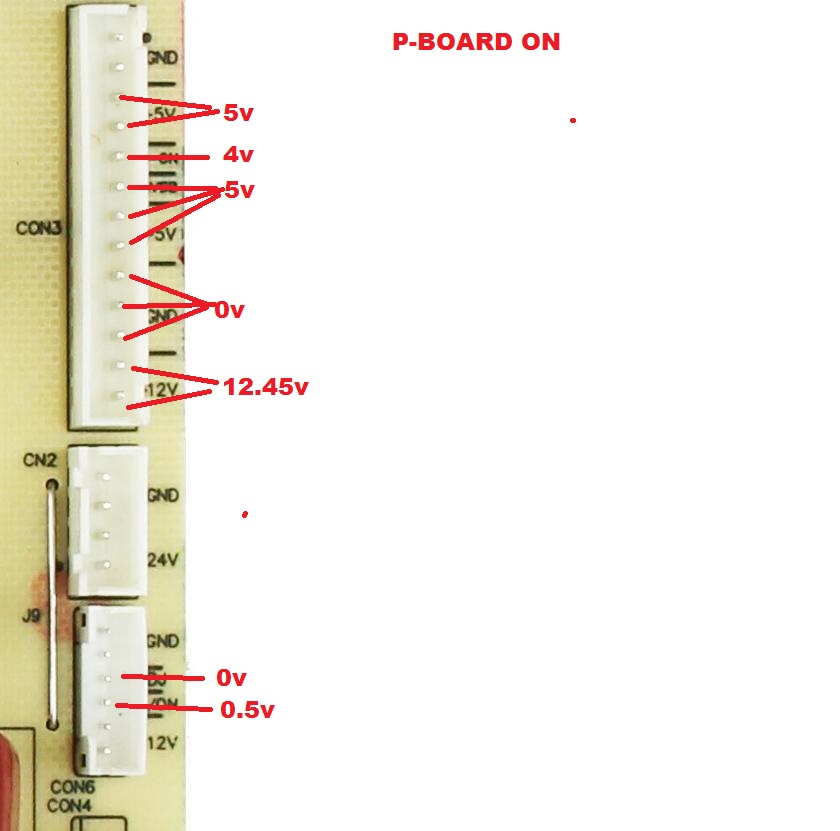

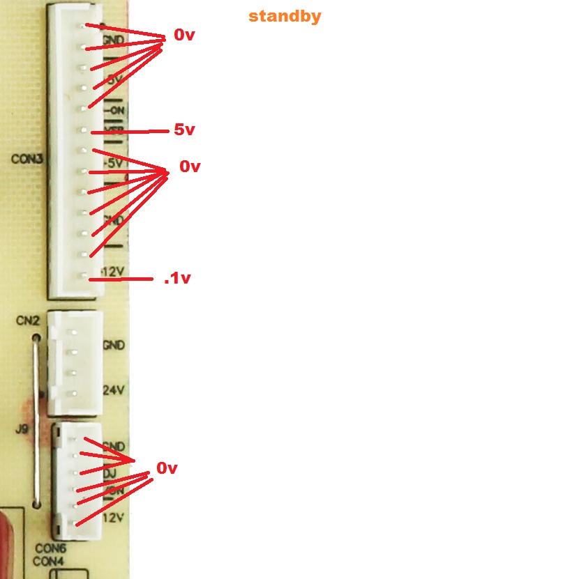

              Disconnect the cable's Con3 and Con6 from the main board, plug in the power supply an check the voltages on con3 and con6 and mark them on the picture, that way we can tell the state of the power supply in standby, without the main connected. then we can tell if a pin needs to be taken high or low to change its state.
              You should only have the standby voltage in this state.
                  Here it is.

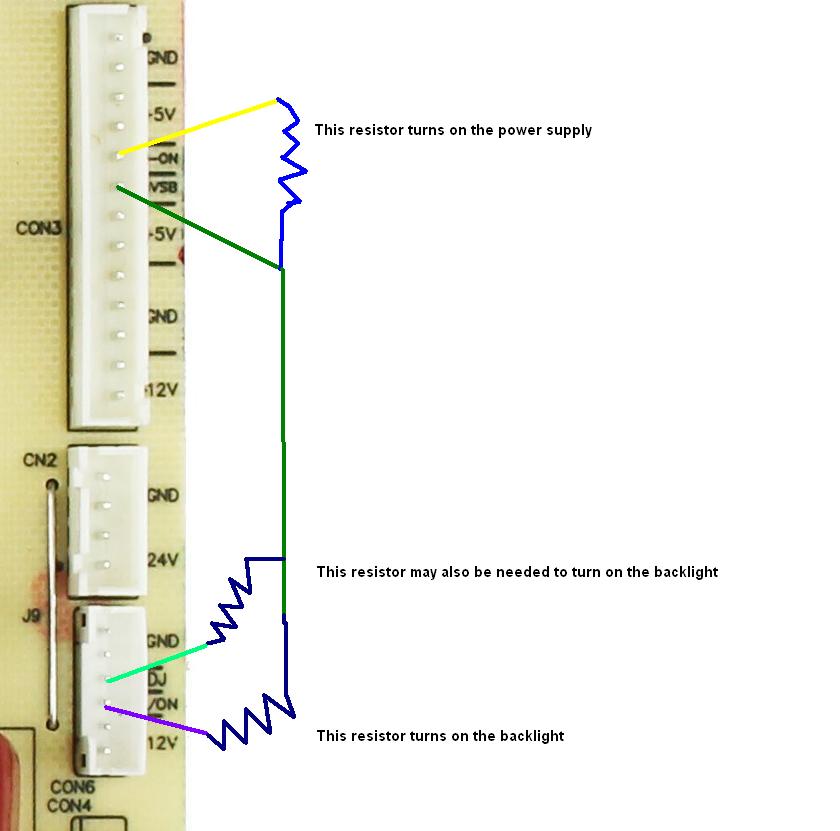

                      The first picture must be with the plugs connected. If you don't disconnect the main board you could damage it when forcing on the power supply. Also having the main connected could be preventing the blon and adj from changing state.
                      You need 3 resistors 1k~5k its not that important.
                      Connect the first resistor between stby 5 volts and PSON, that will turn on the power supply
                      Then connect another resistor between stby 5 volts and BLON and see if you get backlights, if not also connect a resistor between stby 5 volts and adjust pin

                          Sad end to this story. Your advice worked. it just needed a signal to BL ADJ to turn on. Sadly it appears the screen is cracked. My mom had taken it from her house to a tv repair guy then to my house and it must have hit a bump sometime then. Shes not great at being gentle which is why i wanted to verify the screen was ok before buying them. luckily i didnt order those parts yet. Thanks for all your help guys. This ones closed
