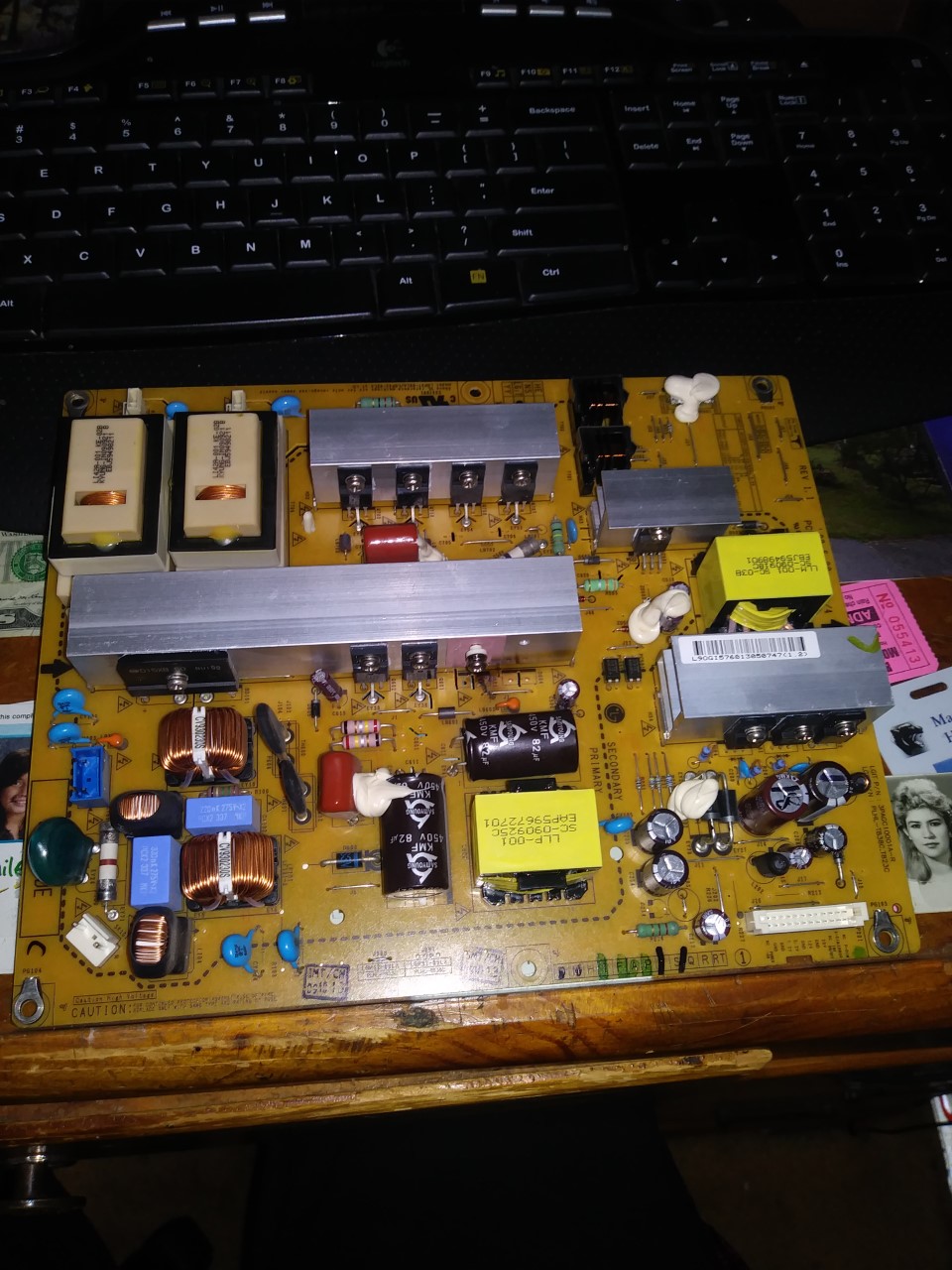

    Hey Guys-
    I have this on my bench right now. I'm looking at the power supply board and there is a diode that popped on it. It's D601 on the board. It's mounted to a heat sink. Unfortunately, when it blew, it knocked the marking off of it. Anybody out there know what the p/n is? or maybe the characteristics of the diode? It's board # EAX55357705/4

    LG EAY57681305 Power Supply / Backlight Inverter
    https://www.shopjimmy.com/lg-eay5768...pply-unit.htm#
    I do not have the P/N but that is PFC diode, Anode is on the right pin, it is non Isolated tab to-220 casing.
    You need to check the two PFC MOSFET's mounted on the same heatsink, also check fuse F501 too. Is the main AC fuse still good?

      I don't have the exact board but a similar board uses a FSU10B60
        Re: Lg42lh30 power supply
        I would go with at least 800V rating.

          WOW! Thanks for the quick replies guys! I really appreciate it. Yes, the fuse was blown out. I had a 1000V volt TO-220 to try but I'm glad I didn't. The switching time on the one I have is 25µs not 40ns. That would have been a problem. I'm gonna rummage around my spare parts and see what I can come up with.
          Thanks Again Guys!
