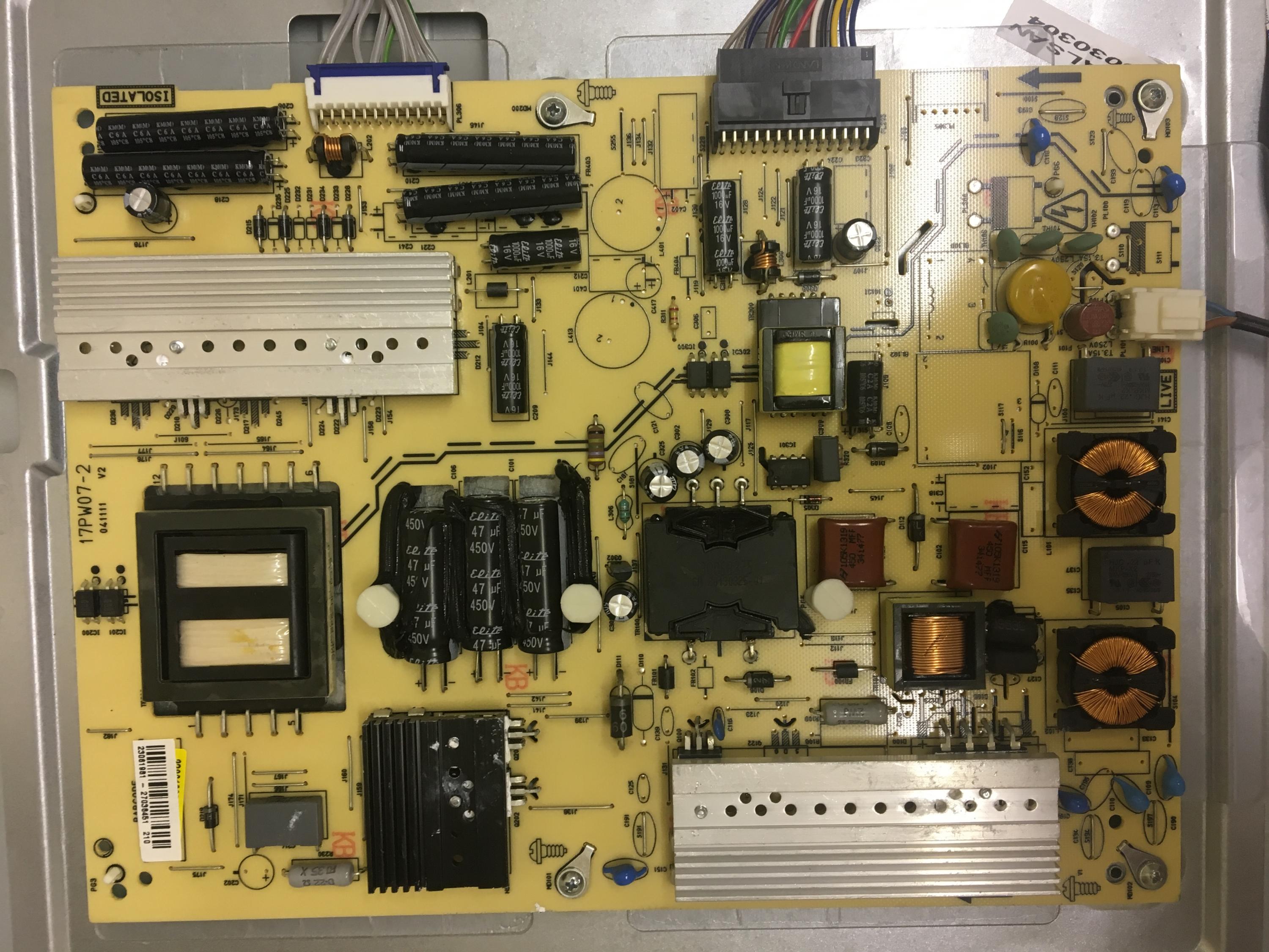

    Hi guys just spent all evening playing with this Toshiba 40D1333B with no backlight
    When powering up the tv the backlights flash on for split second then off, ah ha another failed led or so I thought

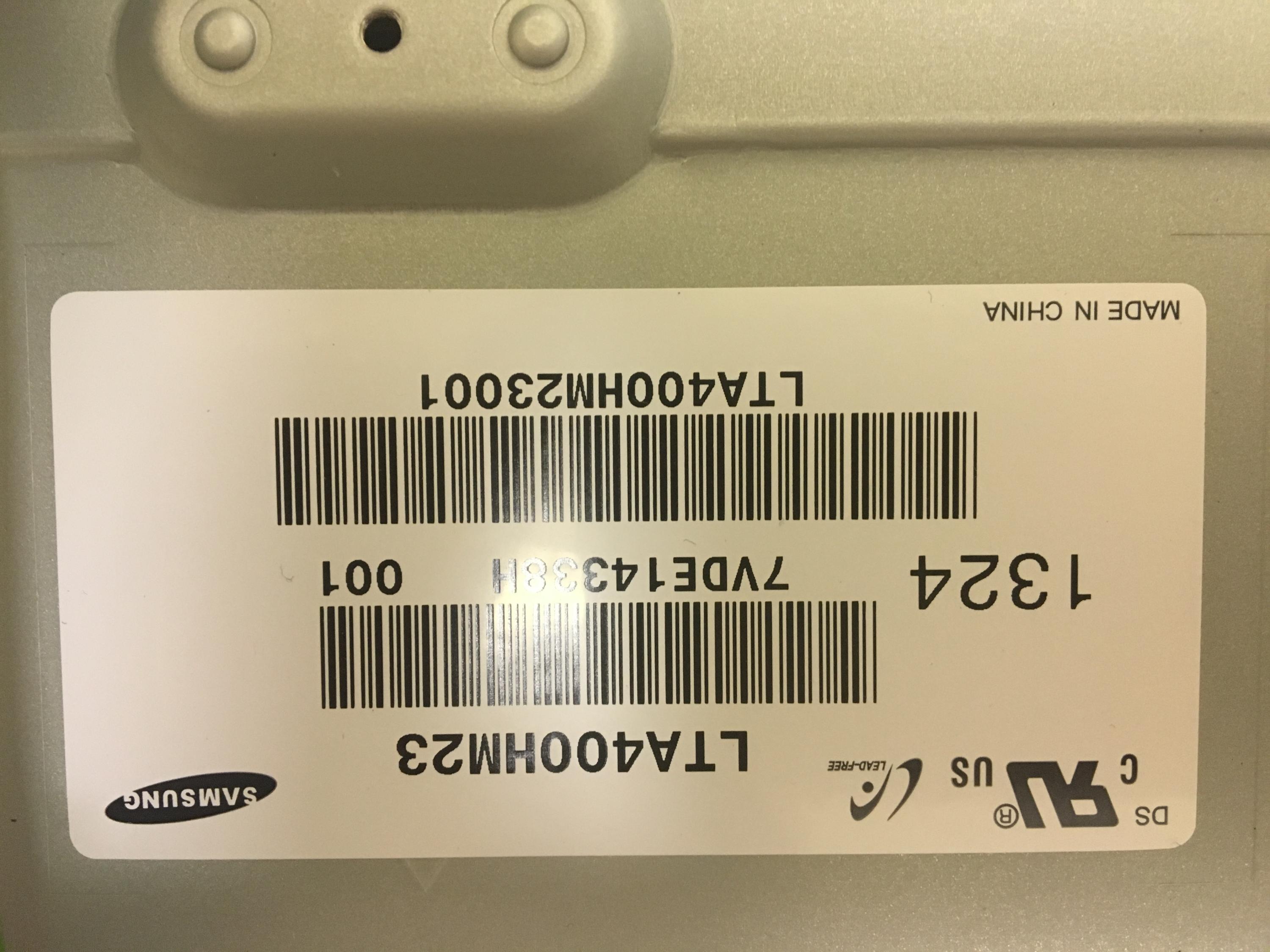

    Tested voltages at led connector got 24 volts so then stripped the screen panel LTA400HM23 to find the dead led/s. However all working using my backlight tester, checked full circuit and every connection all seems good.
    This screen panel does have an inverter in the panel, crap idea if you ask me.
    Built the screen back up and now asking for help please, Power board maybe or maybe the inverter
    Testing PL306 on the power board supplying the leds I have pins 1 to 5 showing 24.6 V, pins 6,7,8,9,10 showing 0V, pin 11 showing 1.3V, and pin 12 showing 3.2V.
    Does that sound ok
    I am not at home tomorrow so will be sunday before I can look at this tv again
    Any help please
    Will get my pics on asap

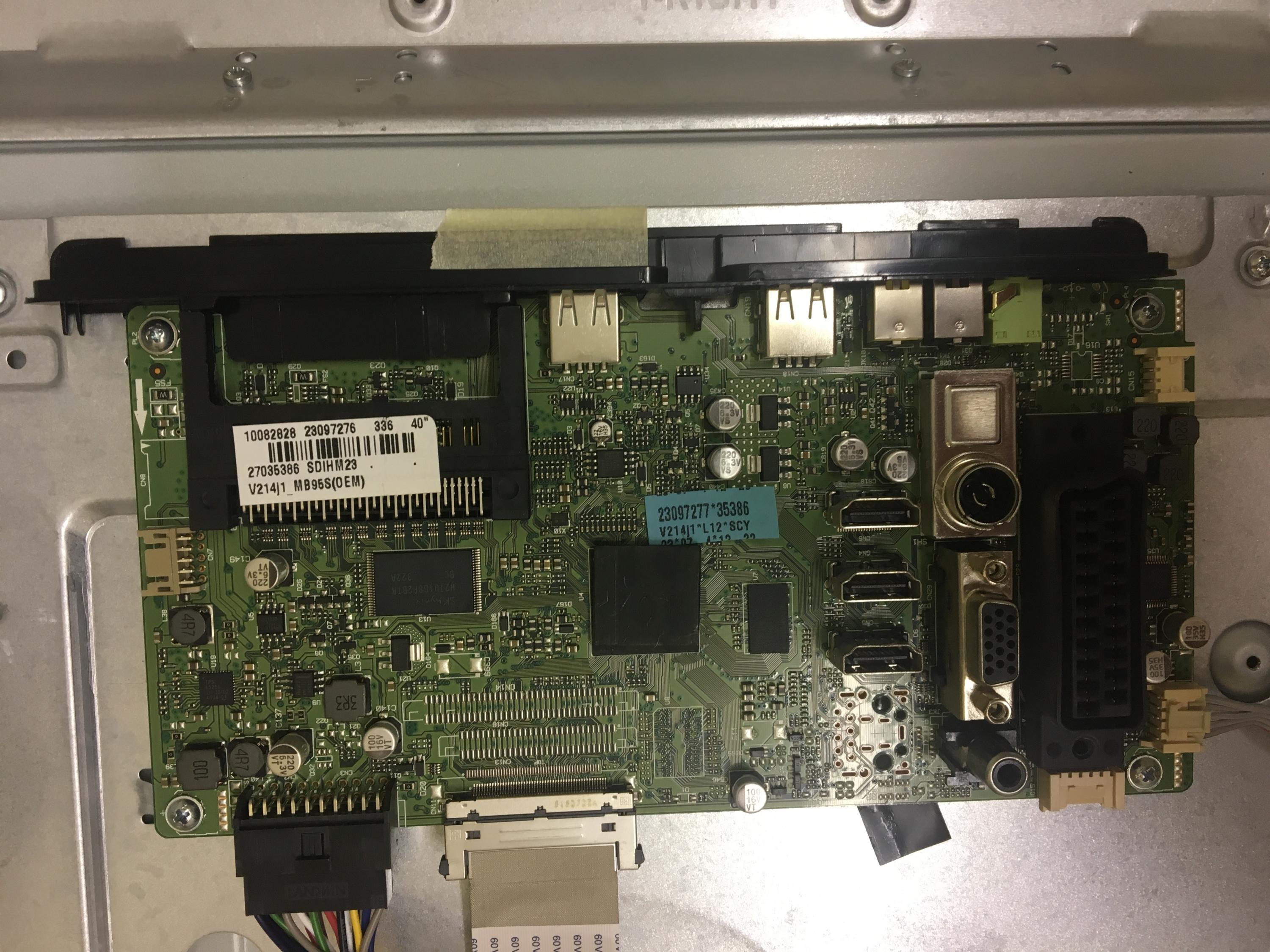

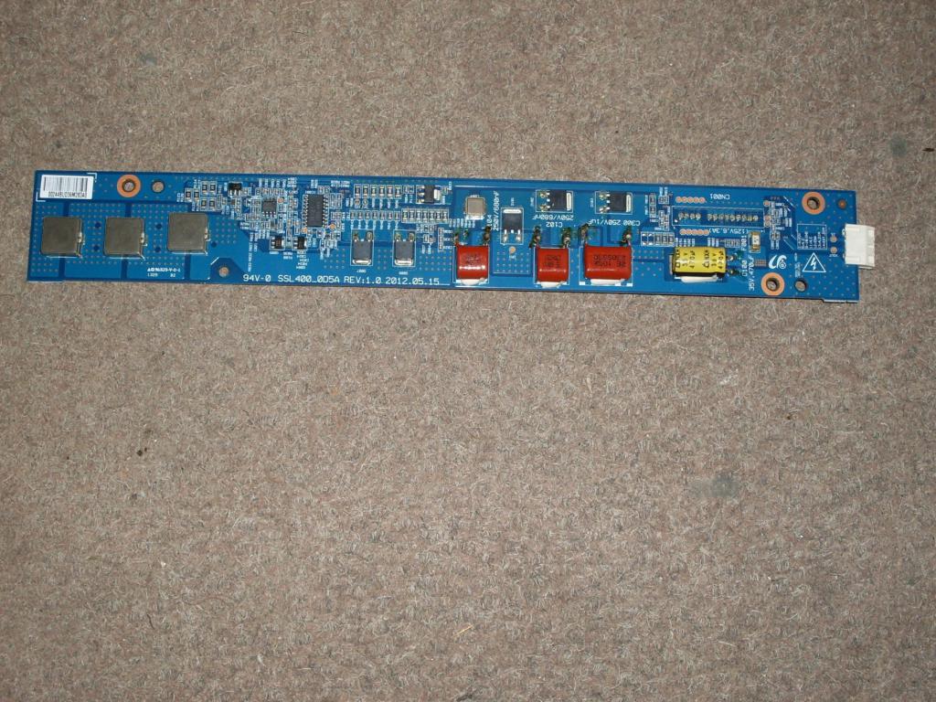

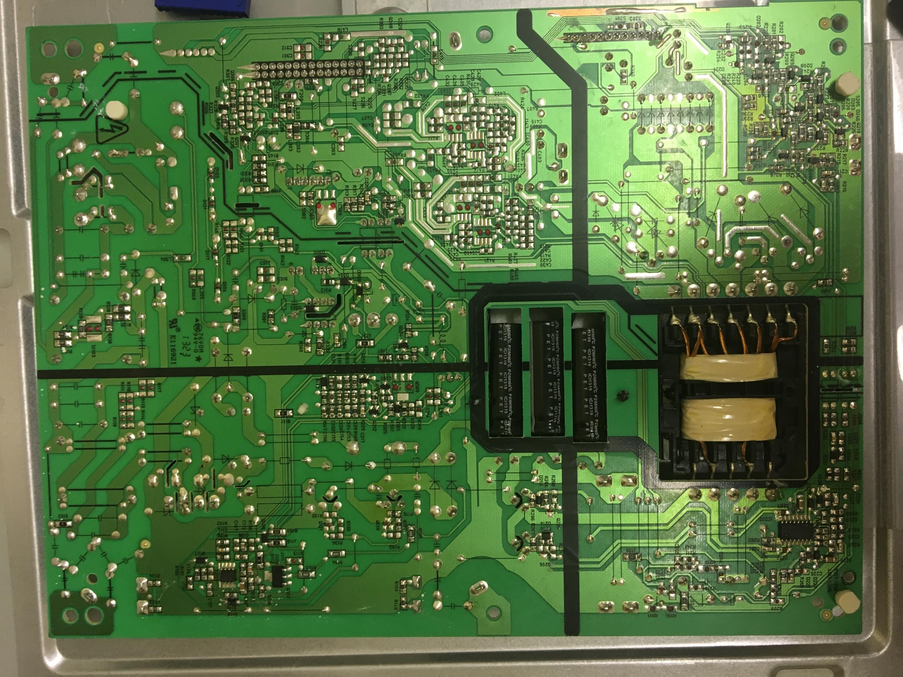

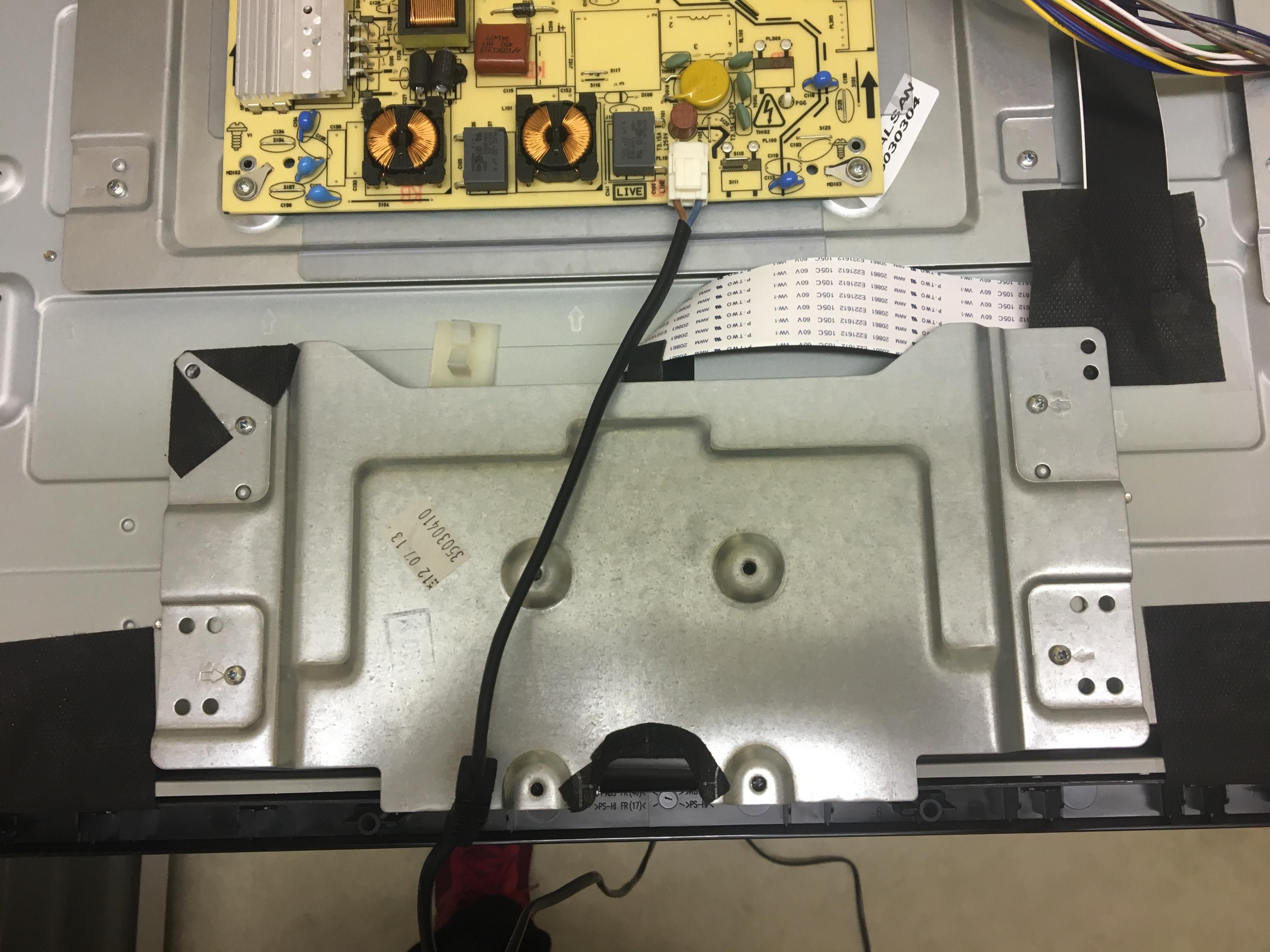

    Pictures as promised
    Picture of the inverter is not my inverter as I had reassembled my screen but am sure this is the same as mine
    Only other thing that I have noticed is when the set is powered on there is a buzzing from the power board, can not pinpoint where it is coming from yet

                        OK Update on this tv
                        Stripped panel again today to get to and check led's
                        Checked with backlight tester and all led's lit
                        Then removed all led strips and slightly bent all the plastic connectors on the ends of the strips to ensure a firm connection between strips
                        Re assembled panel and led's all lit under the tv's power
                        Tv now back together and seems to be working fine
                        Conclusion there must have been a poor connection or connections between led strips or inverter to strip
                        I am happy now but boy what a crap tv this is
