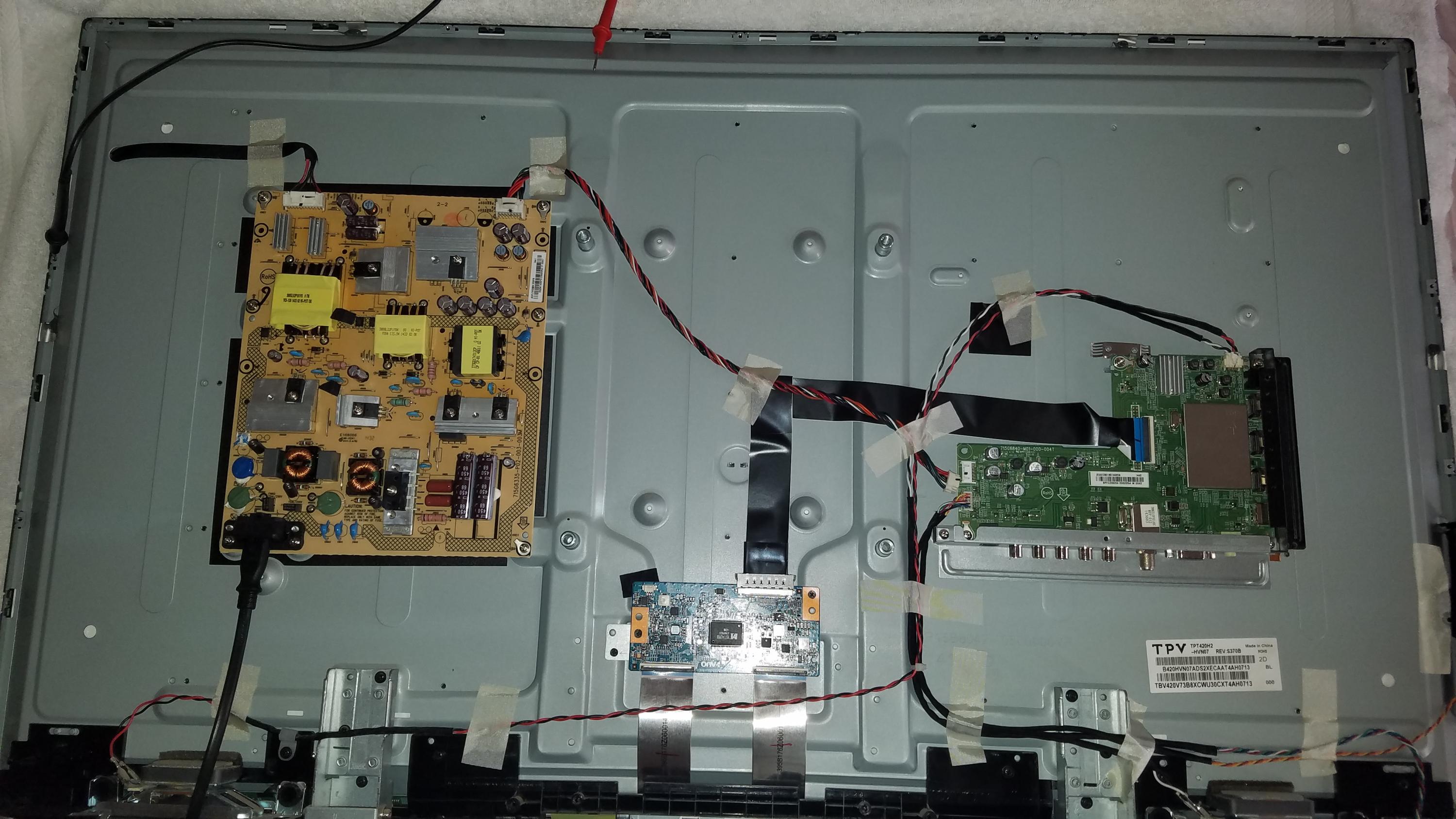

    a newer TV, Sharp LC-42LB261U shows 7 red flashes then blue on the power LED (I think this is normal), No backlight.
    1. I tested the backlight with a tester, and both string turn on. Voltages on the VLED+ (1 and 2) is 41.5 V, VLED- (1 and 2) about 0.115 V)
    2. Checked the connector from power to Main board. 12V is showing 19.46V (I thought defective, till I looked at the service manual page 21 - Seems 19.5 nominal is ok?)
    3. Buttons are responsive. PS_ON, O/F seem to do what they're supposed to (toggle from 0 to 3.3 V)
    4. Disconnected LVDS - No effect
    5. Disconnected ribbon cables to panel - No effect - Backlight is still not coming on.
    If I'm understanding the service manual correctly (Page 21) it's suggesting replacing the panel? Does not seem right to me unless by Panel they mean "Backlight"?
    Thoughts anyone?
    Thank you

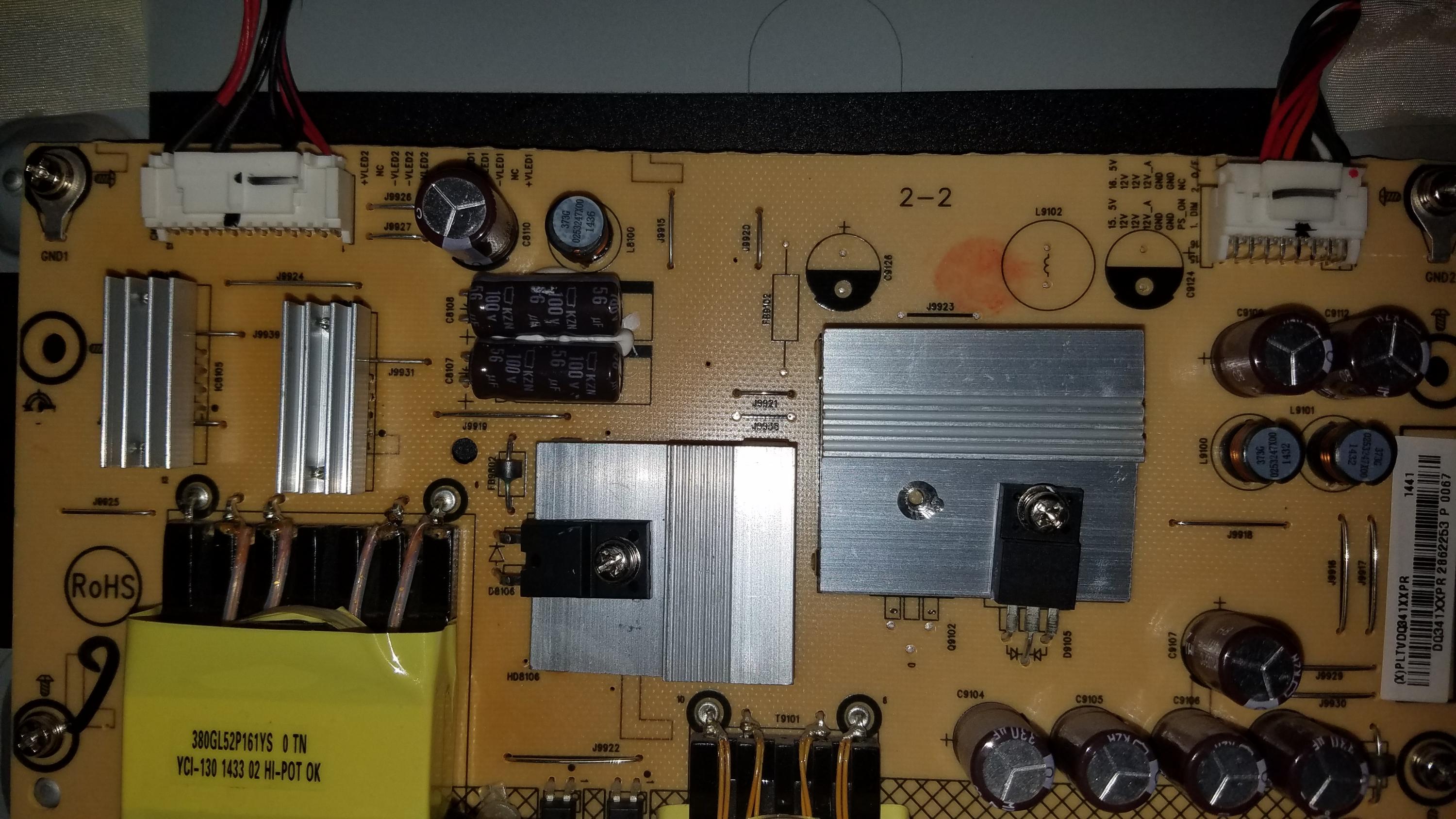

    Re: LC-42LB261U No Picture
    1) You need to report all the Voltages of the connector of the power supply that goes to the main board.
    2) What does the Meter of the LED tester show when you test the LED strings?
      Only one voltage on the connector from PS to Main. That has 19.46V

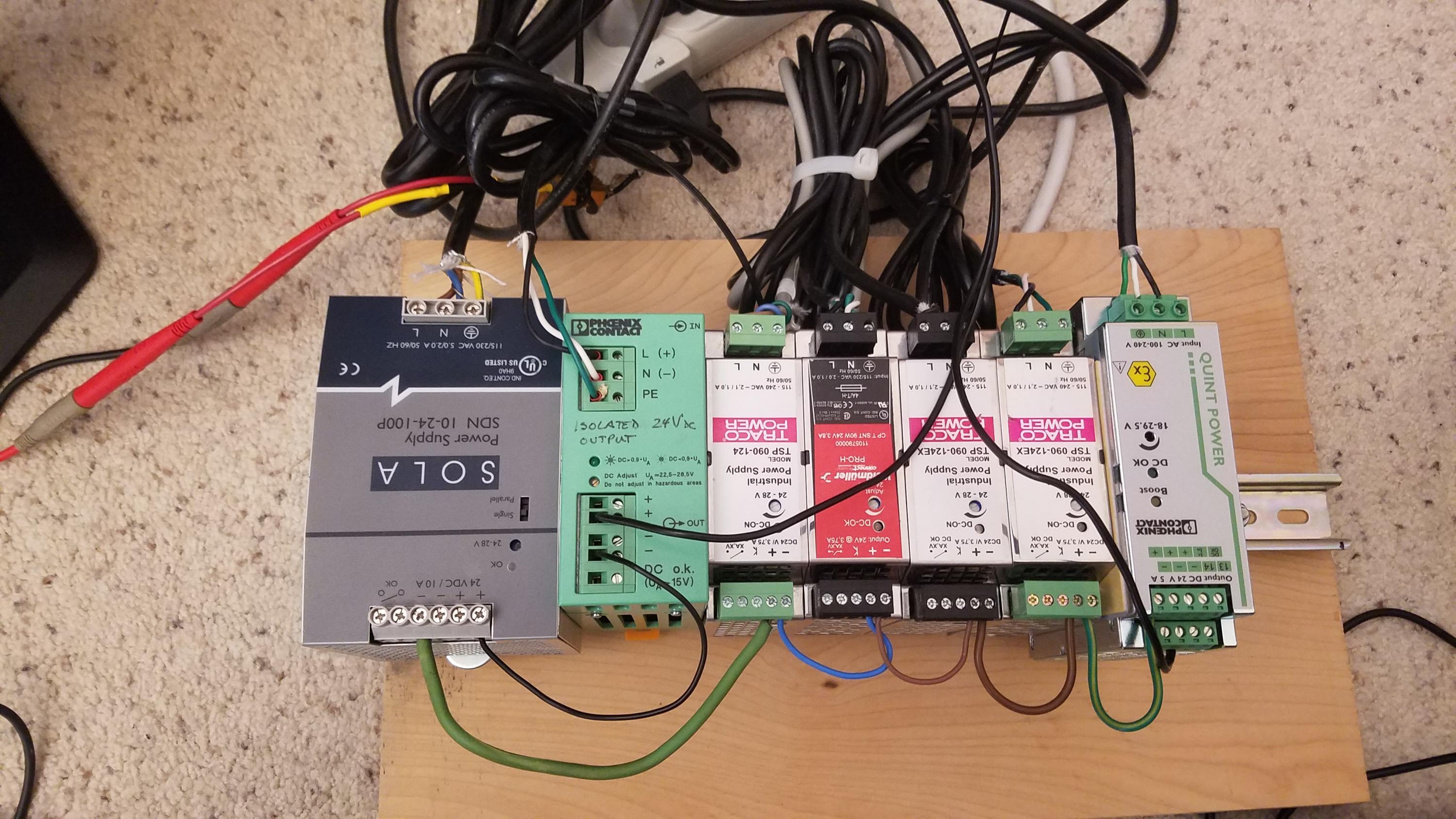

      My tester is a home made (multiple power supplies in series with current limiting resistor) and doesn't have a built-in meter. I'll have to test that again.
      I opened the panel and sure enough 3 of the 5 strips have one open LED each - replaced those and it's back to life. Thank you
            Thank you.. I just ordered one. I've had several 24V power supplies with floating output, so I just put them in series.. I get close to 200V and current limit with an external resistor. Not elegant, but it does the job.. half-ass I guess Thanks
