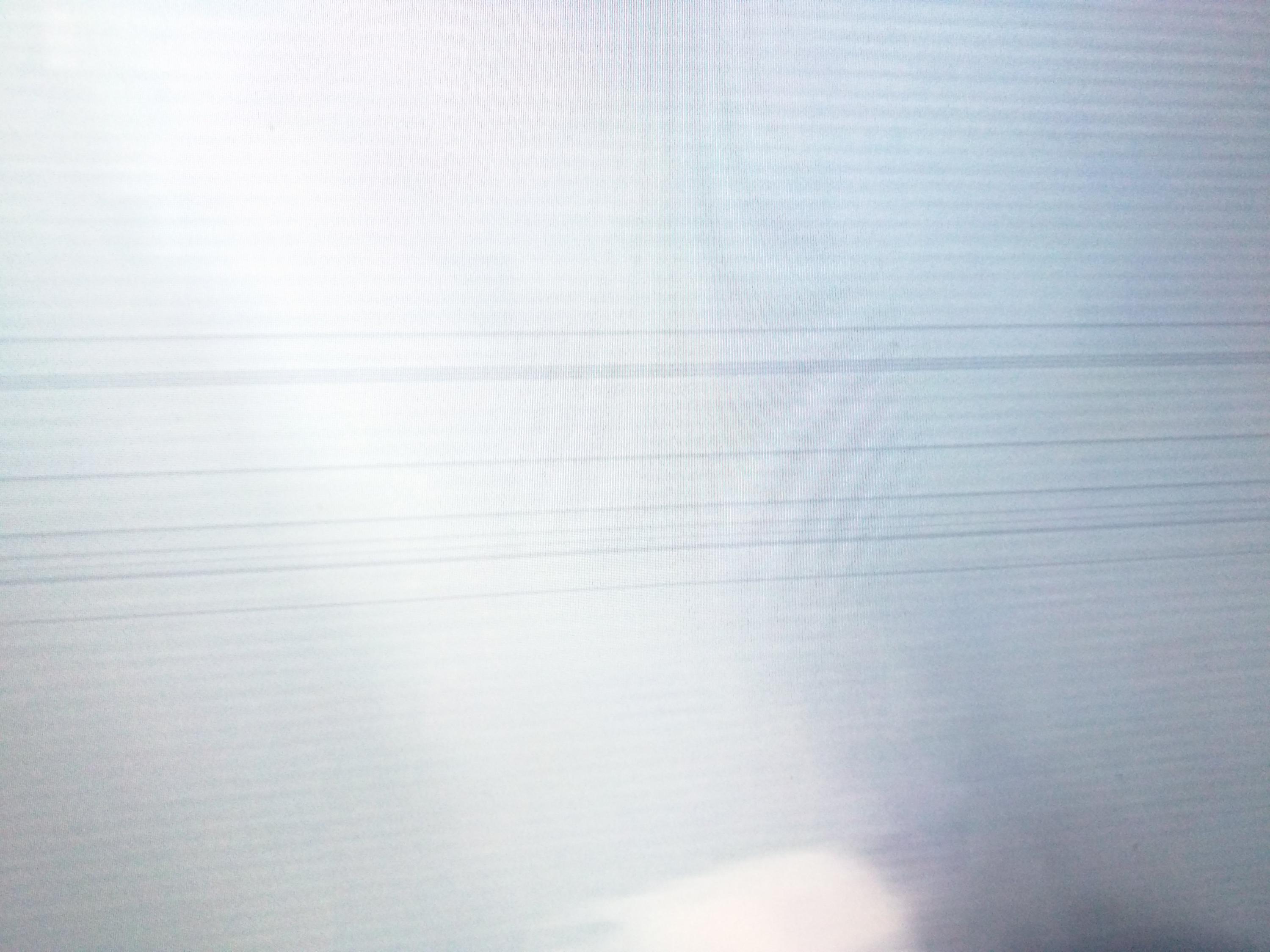

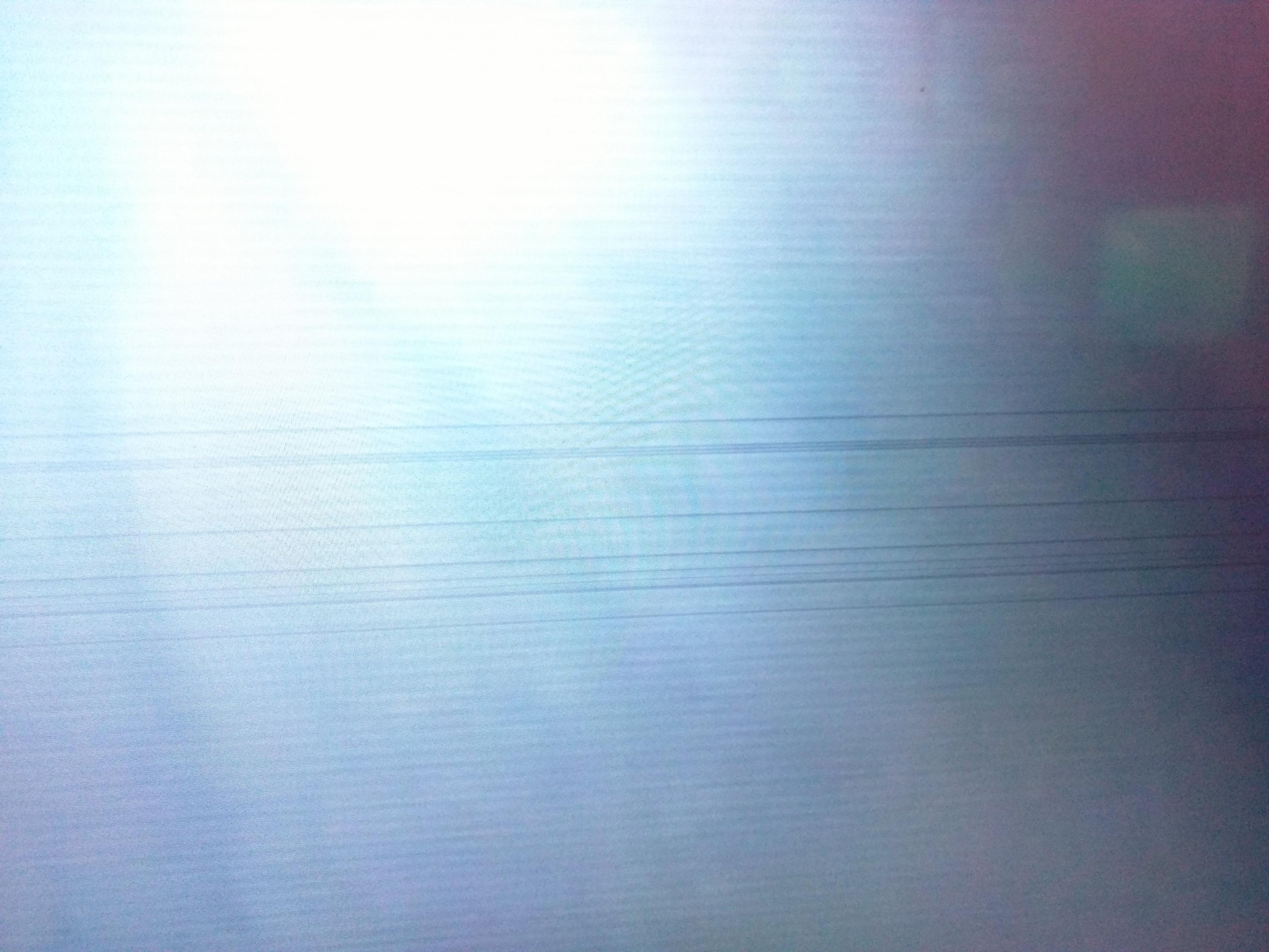

          ok so i finally had time to mess with this a bit more and eventually found 1 led that was working but drawing way more power than the others causing the bl_sos. sooooo...... now i got the tv working but it has some narrow horizontal black lines on the screen starting darker from the right and going to just over half way across the screen and fading to invisible by the time they get to the left side of the screen. there are about 10 - 12 randomly spaced lines, hard to get a photo but you can just about make out the lines. i have checked all the connections and tried flexing / moving all the ribbons which makes no difference, so has anyone any idea what might be causing the lines? to be fair i never seen the tv working before i got it so it might be that the lines were there even before i got it. thanks everyone for the help etc etc.

            you were quite right, i eventually found 1 bad led that was lighting fine but drawing too much power and causing the bl_sos. the tv is now working again though it does have some lines on the screen that may have been there before i even got the tv or maybe as a result of damage from getting into the pannel (bloody thing was glued together and fought a good fight to stay glued together lol) but anyway thanks for the advice and just though i should let you know that you was correct.
