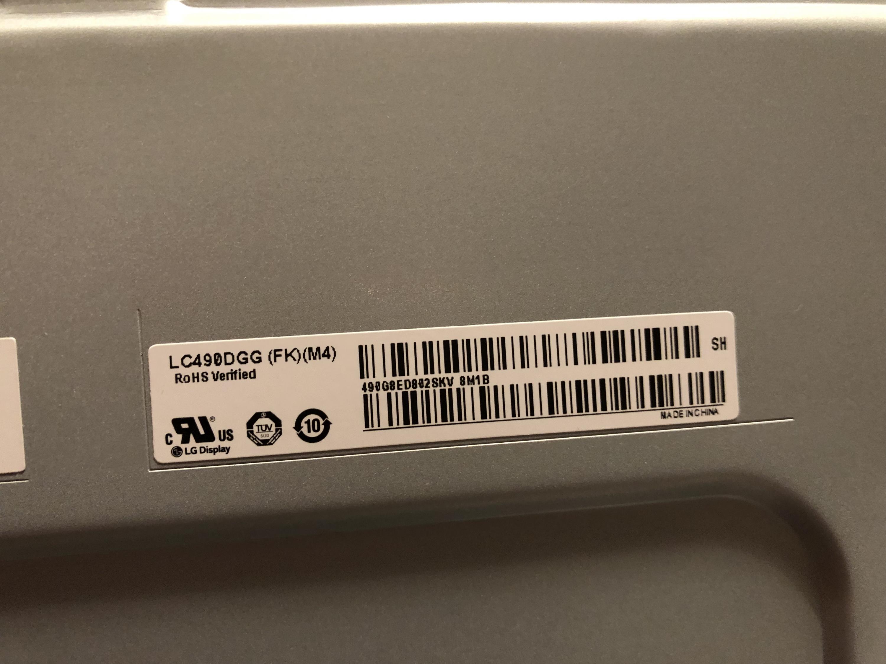

              So he double images at the bottom section of the screen are gone?
              BTW, what is the LCD panel model number?
              • jasonr2000
                Advance Tech
                • Nov 2013
                • 209
                Re: LG 49UJ701V (Display Problem)
                hi budm yes the double image has gone
                as for the panel number ill attach a photo.

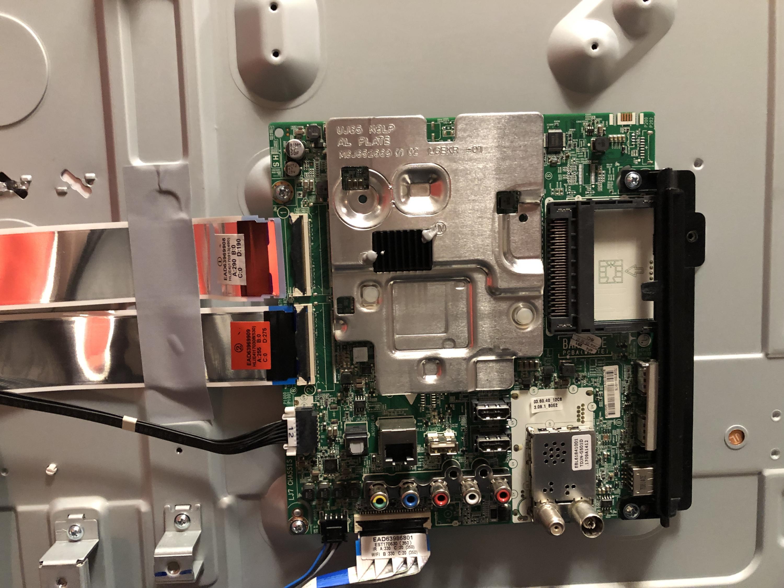

                  Hi, i think there's not much more you can do to improve this, from your pic. i cannot see the brightness problem you talk, but you can try to locate more precisely the right trace to cover and not the others, needed a bright tcon picture with board markings well visible..

                    hi davi.p the T-Con is intergreated in to the mainboard so there isn't a T-Con as such.
                    I can live with the brightness issue.
                      This doesn't prevent you from photograph it.
                      • jasonr2000
                        Advance Tech
                        • Nov 2013
                        • 209
                        #31
                        yeah thats true
                        here is a photo of the T-Con/Mainboard
