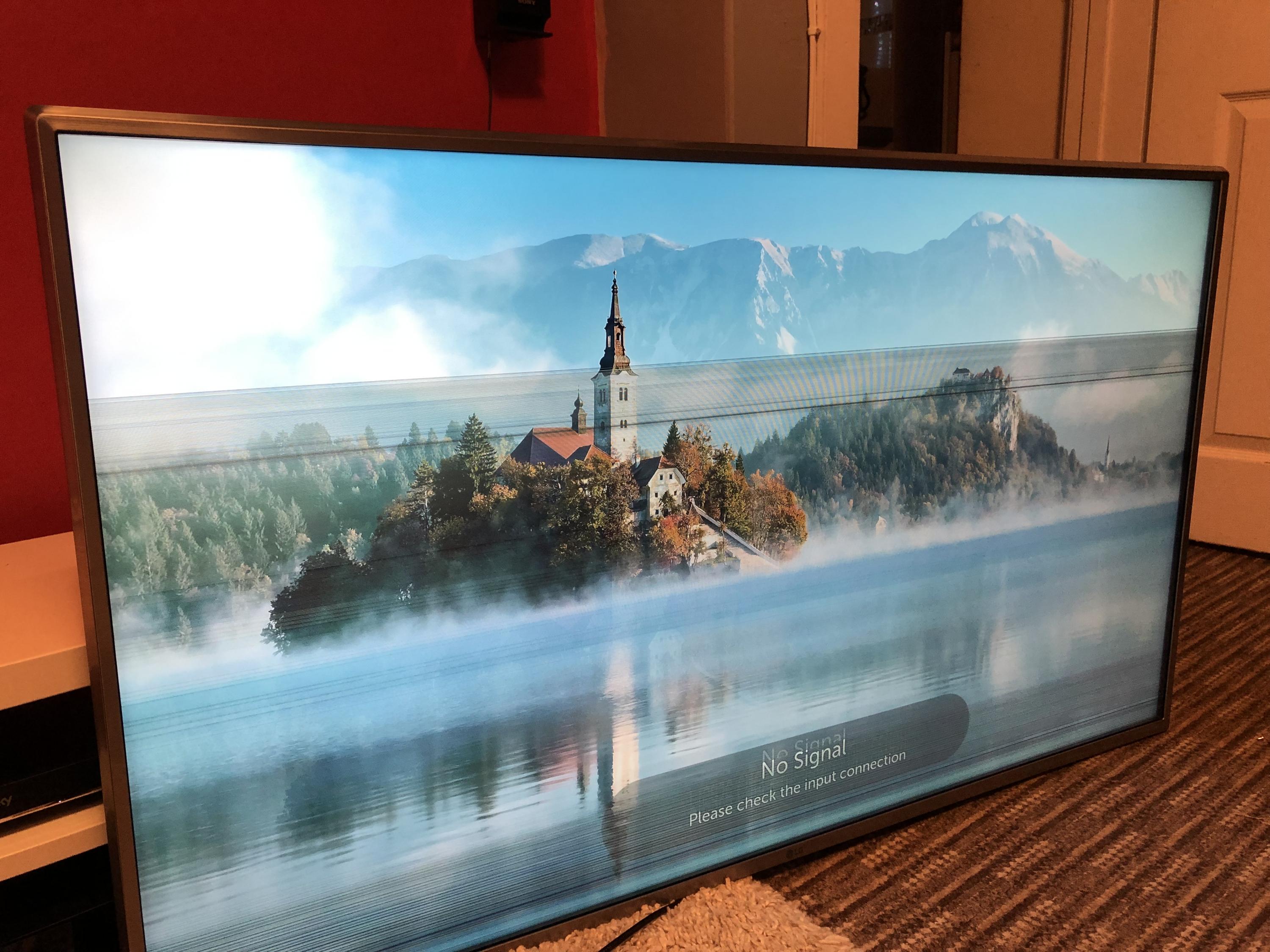

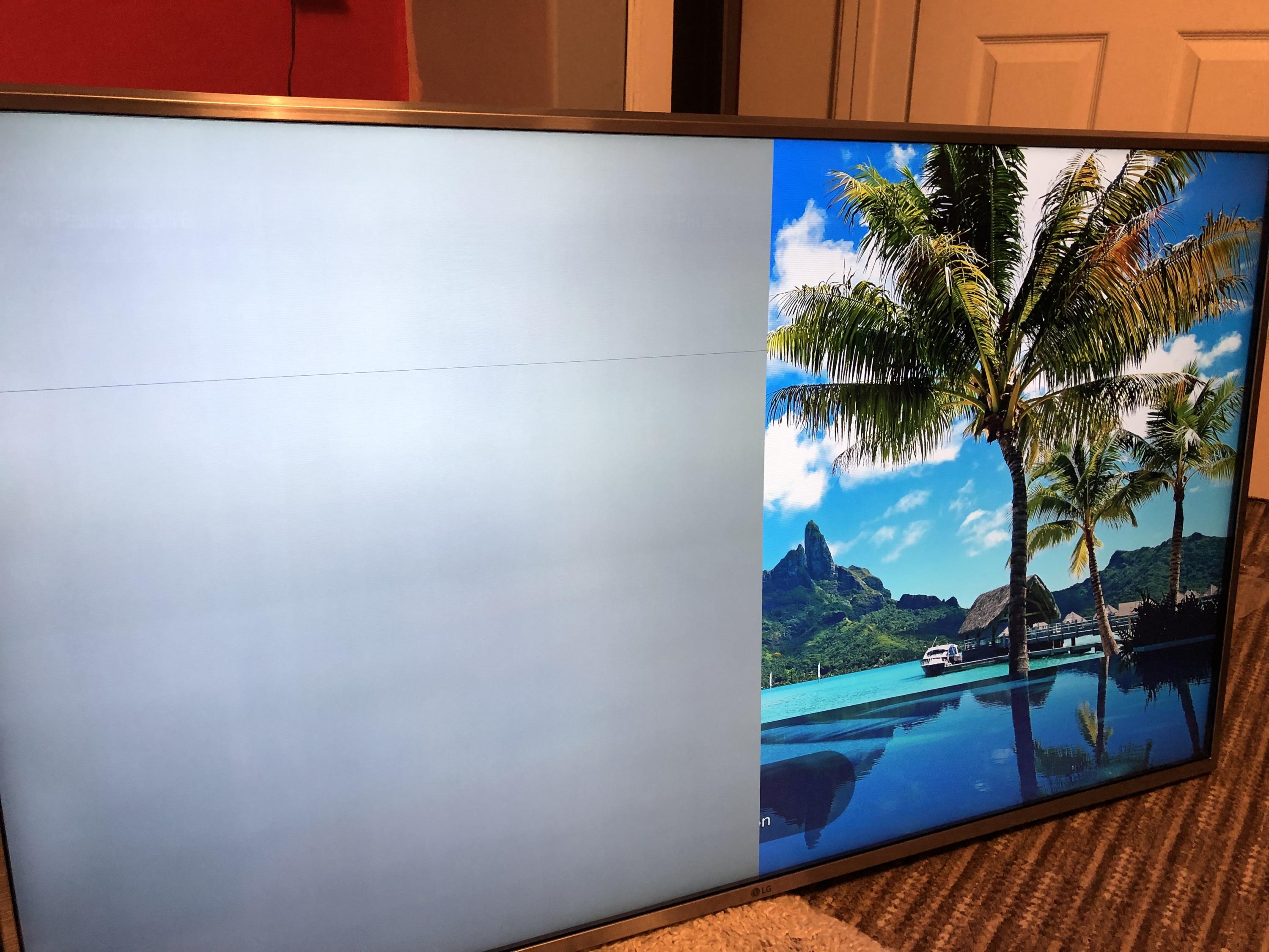

    hi guys I have the above tv,
    I've now got a problem with after a year of use the screen is now garbled then normal and then garbled but the top is perfect.
    the tab bonds are at the bottom of the tv I have checked by pressing on them lightly to see if the symptom changes but sadly it don't,
    ive noticed the tcon is all part of the mainboard on this TV,
    could it be the tcon has failed ?
    as if I disconnect one side of the panel I get a perfect picture and a grey screen on the side disconnected.
    but if I disconnect the working side of the panel and then leave the opposite side connected I just get a black screen on the half nothing else.
    thanks for any help

    here is 2 photo's of the fault I forgot to add them to my original post I will also post a video shortly
    thanks

          Re: LG 49UJ701V (Display Problem)
          It looks like Gate drive problem in the panel.

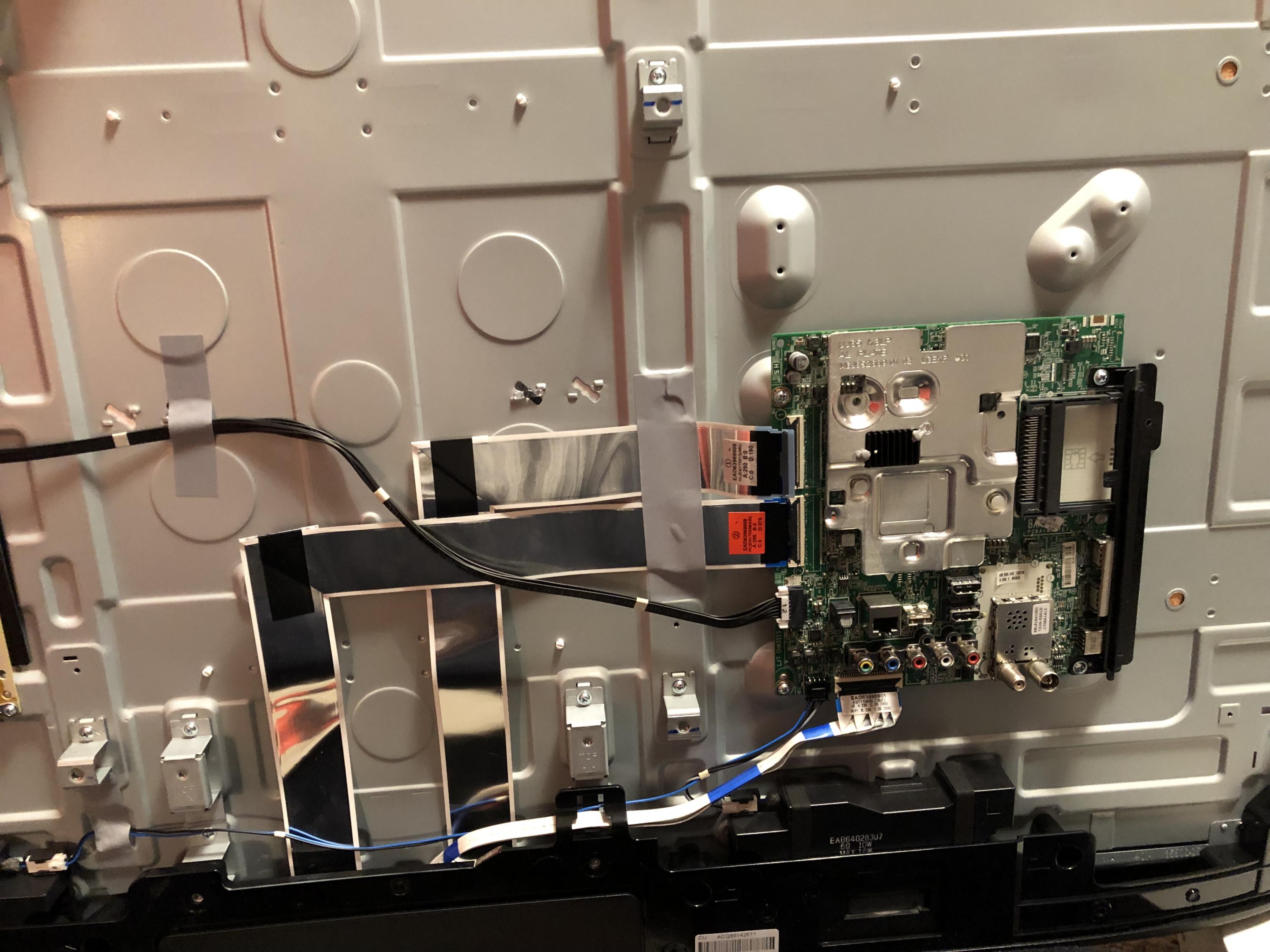

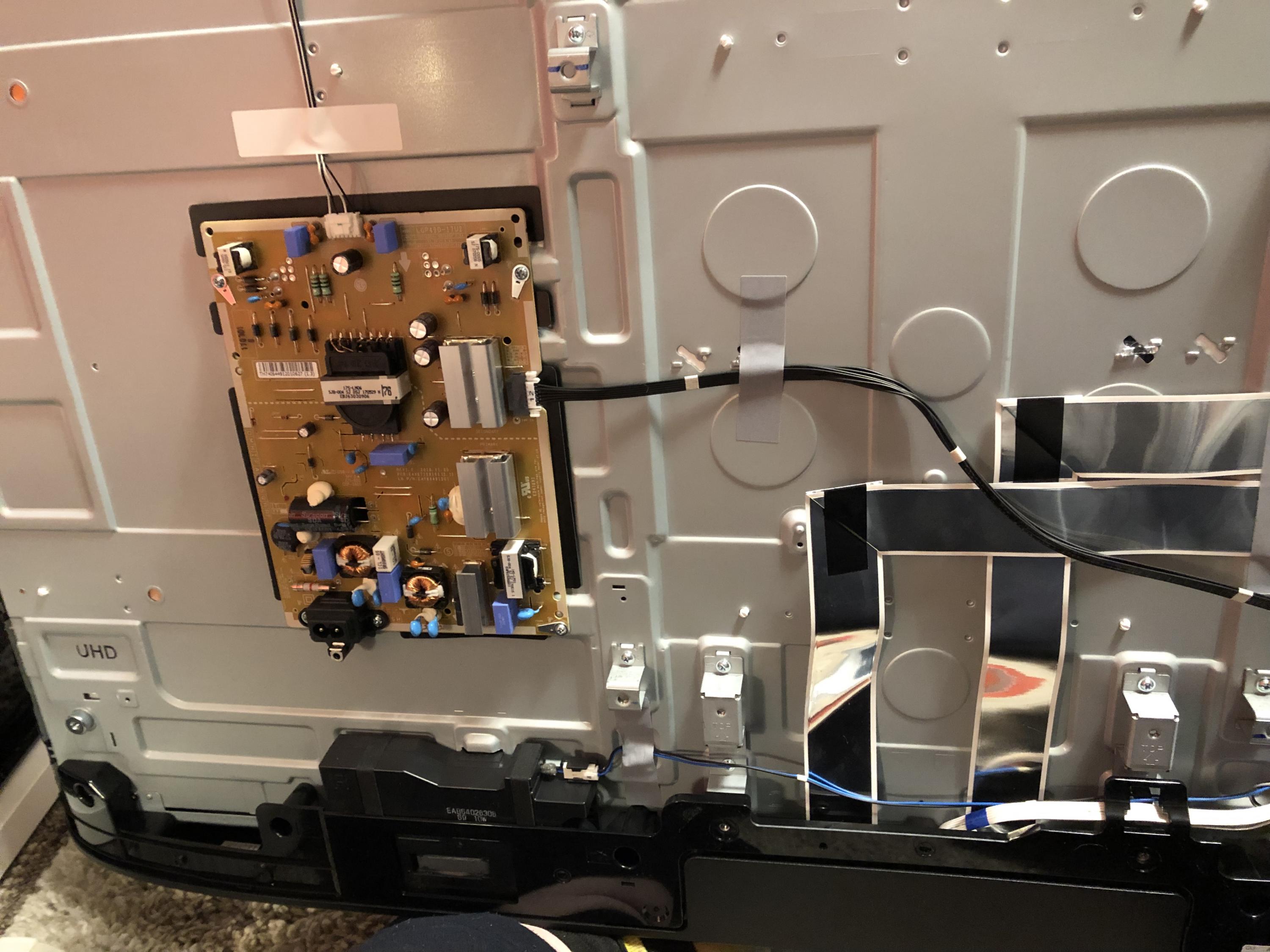

            its look disruption from right side tap. but let hope first with first test i mentioned
            please upload whole photo of the tv boards at back side.

              Hi jasonr2000:
              Could be a panel problem.
              I have a 50" LG LED TV model 50LN5700. The TV works but has a similar fault as yours (good image on top 2/3s of screen and double vision on lower 1/3).
              The boards work properly with a different (good) panel.
              The (bad) panel produces the same problem with different (good) boards from another TV.
              My panel problem is permanent and does not flicker or change over time.
              Your problem may be fixable if you can find out what part is intermittent.
              I'm not saying your problem is the panel for sure, but on my TV with similar issue it is the panel.
                      pictures as requested
                      thanks all

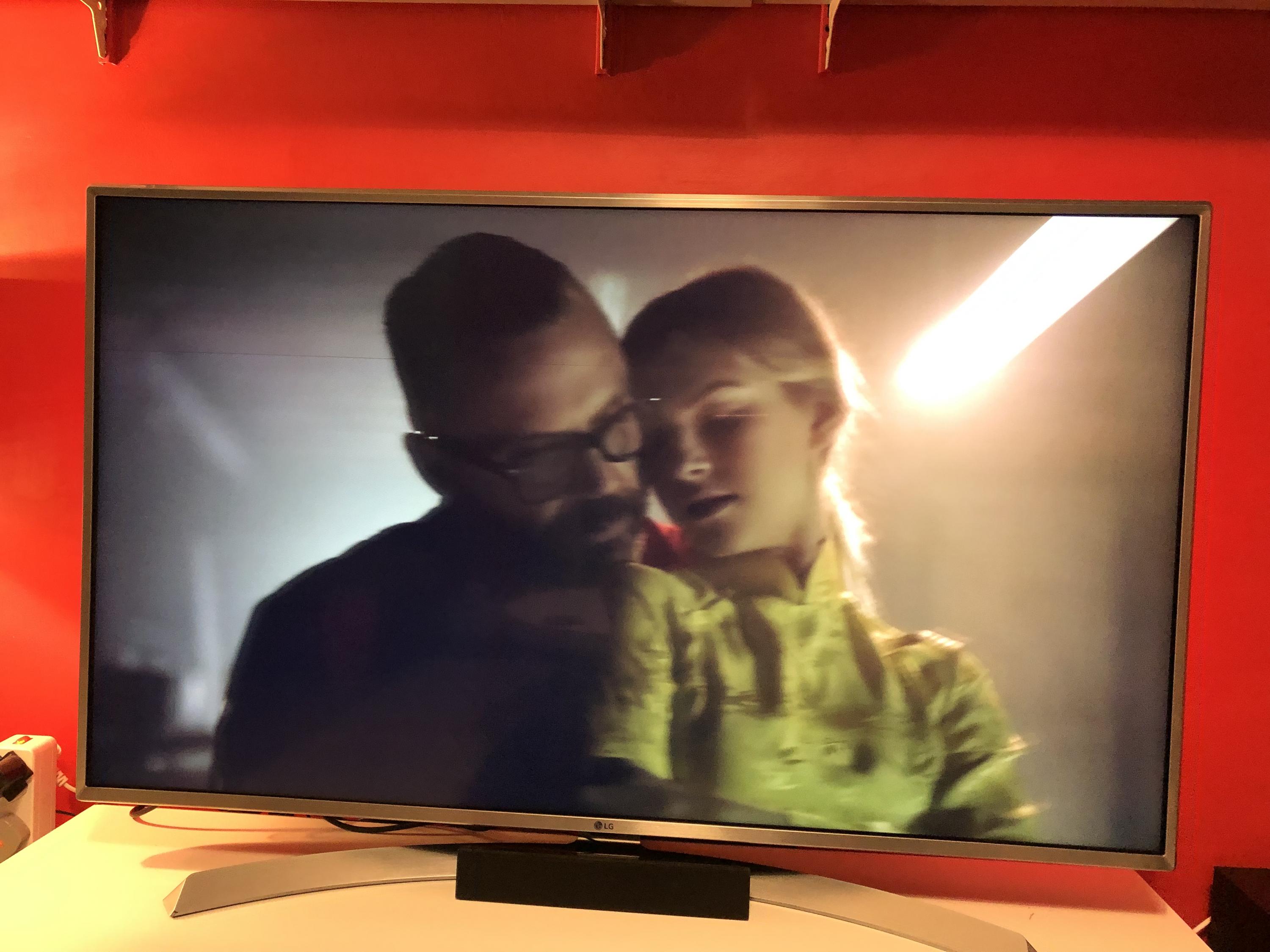

                                        hi again,
                                        I have tried the tape fix got a picture of a normal variety but I've noticed now the colour is off on the left side of the screen where the fault existed
                                        I've taken a photo but I dunno if it will come out or not,
