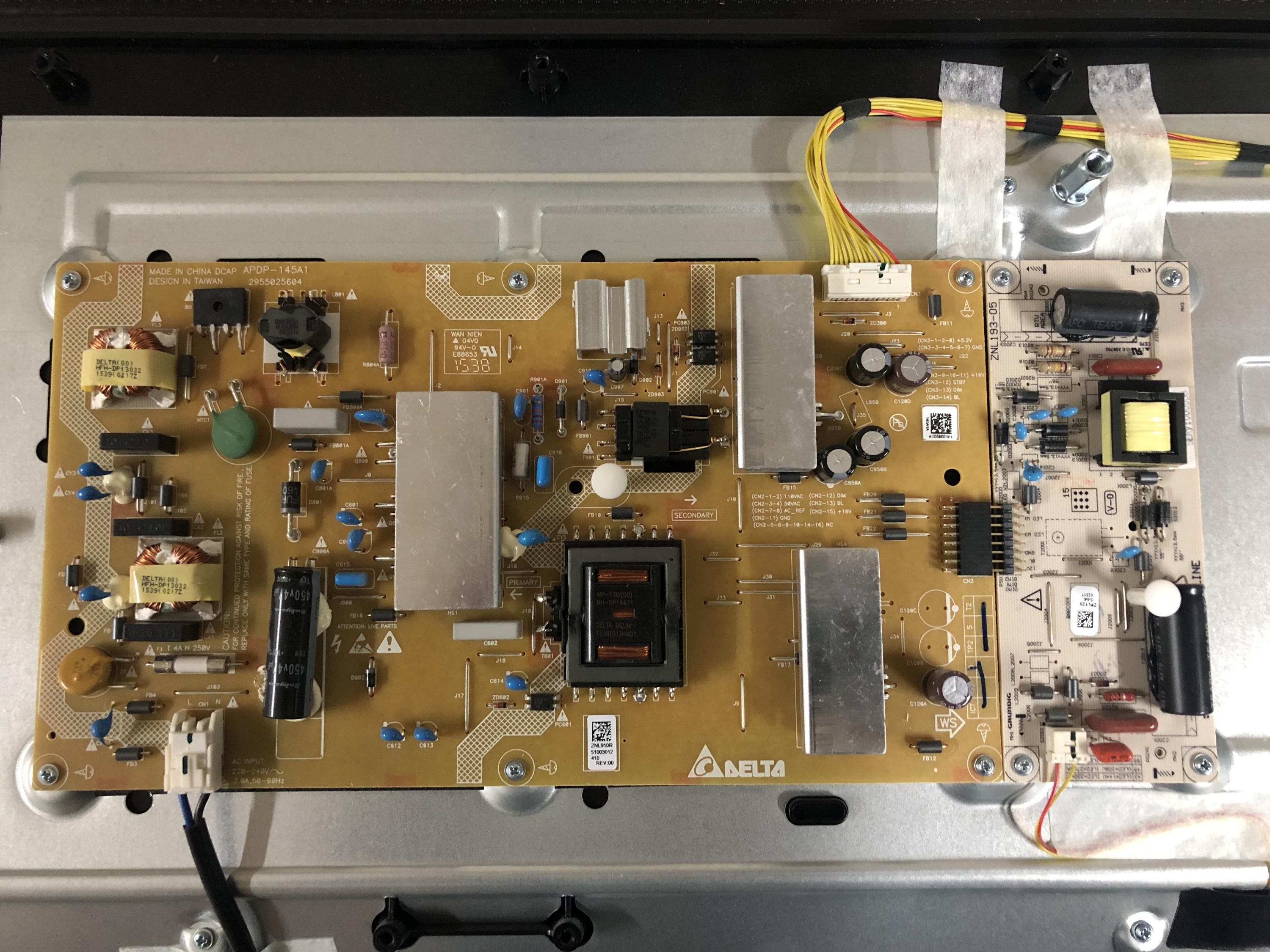

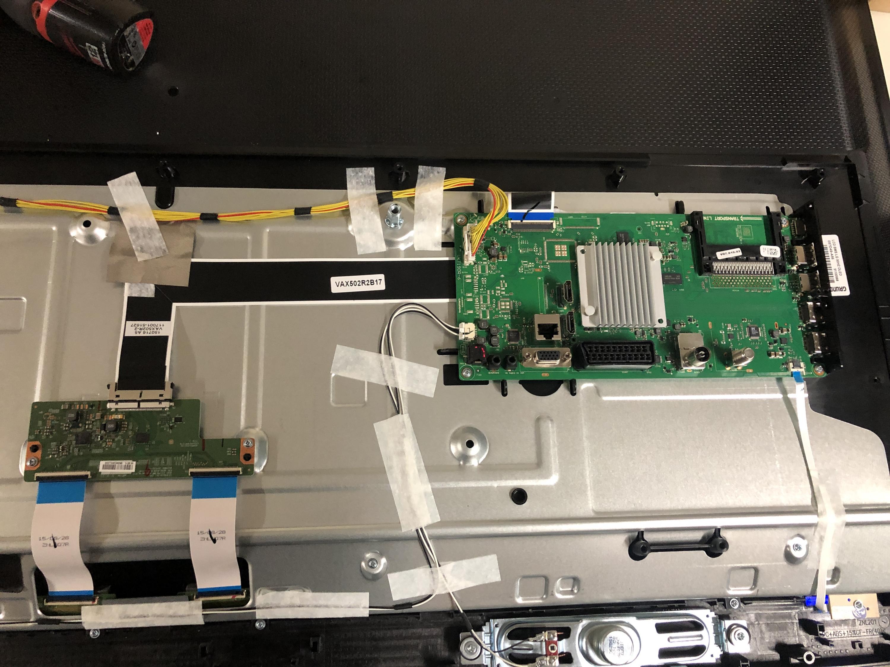

    Backlight blinks on-off constantly.
    All Caps look ok.

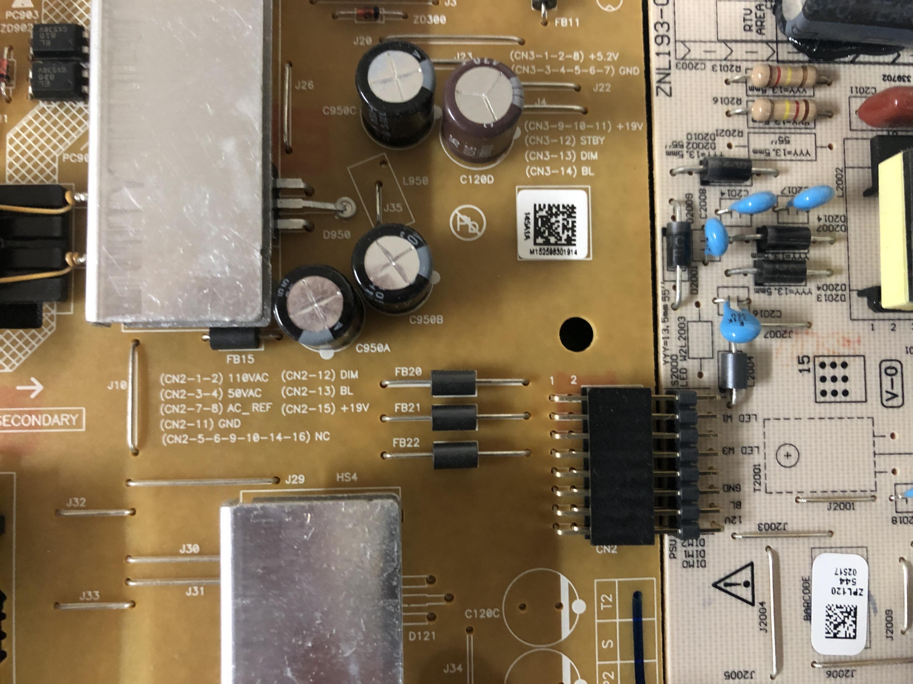

    PSU measured:
    CN2 13 BL - 3.3
    CN2 15 - 19VDC
    CN2 1-2 = 27VAC
    CN2 3-4 = 67VAC
    CN2 7-8 = 75VAC
    Some of those values dont make reference...
    Video of TV here:
    https://www.dropbox.com/s/3ky1tzmfys...30.38.mov?dl=0
    Any ideas where the fault may be or where to search?

    I suspect the ac voltages listed are high frequency as the come from the switching power supply, (20-50khz) most meters won't measure them
    If you can, turn down the backlight (or sometimes brightness) in the menu and see if the blinking changes, It is very likely you have one ore more bad led/s in the panel.

      to add to RJ, also check CN2 for cracked solder joints on both boards.
