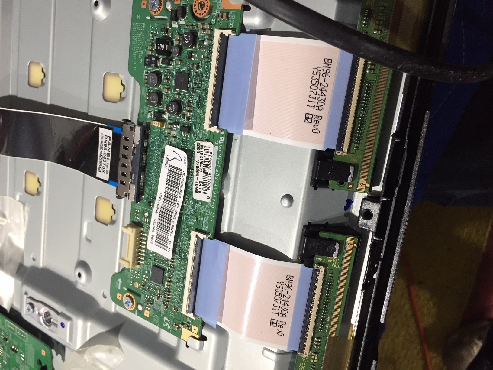

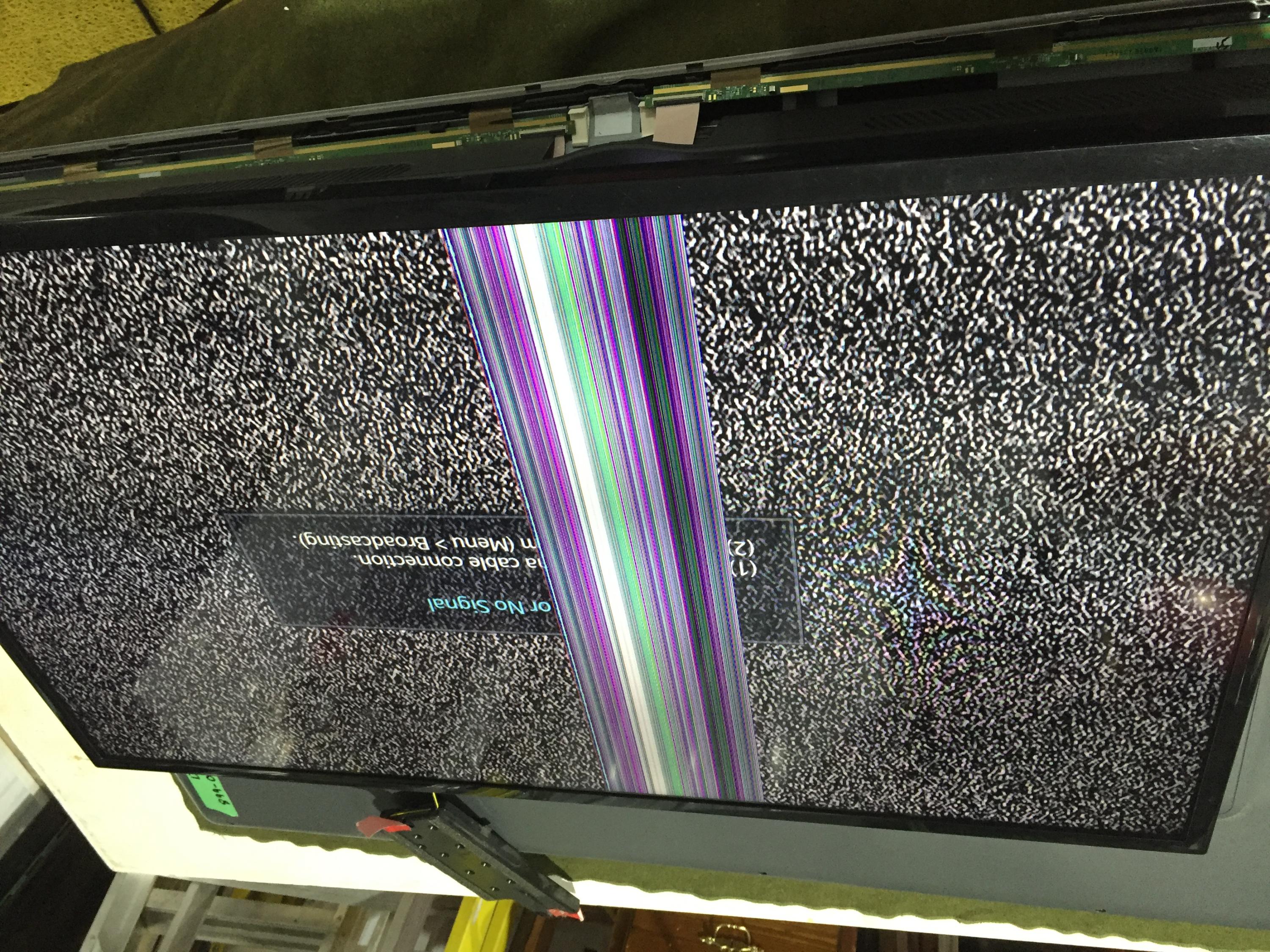

    I replaced led strips on this 40" samsung and already i think my worst fears are realized.I think its the panel even though i was super careful and have done this procedure many times before.Is there a sure way to tell?Ribbons look good and flat cables have been cleaned and reinserted various times.

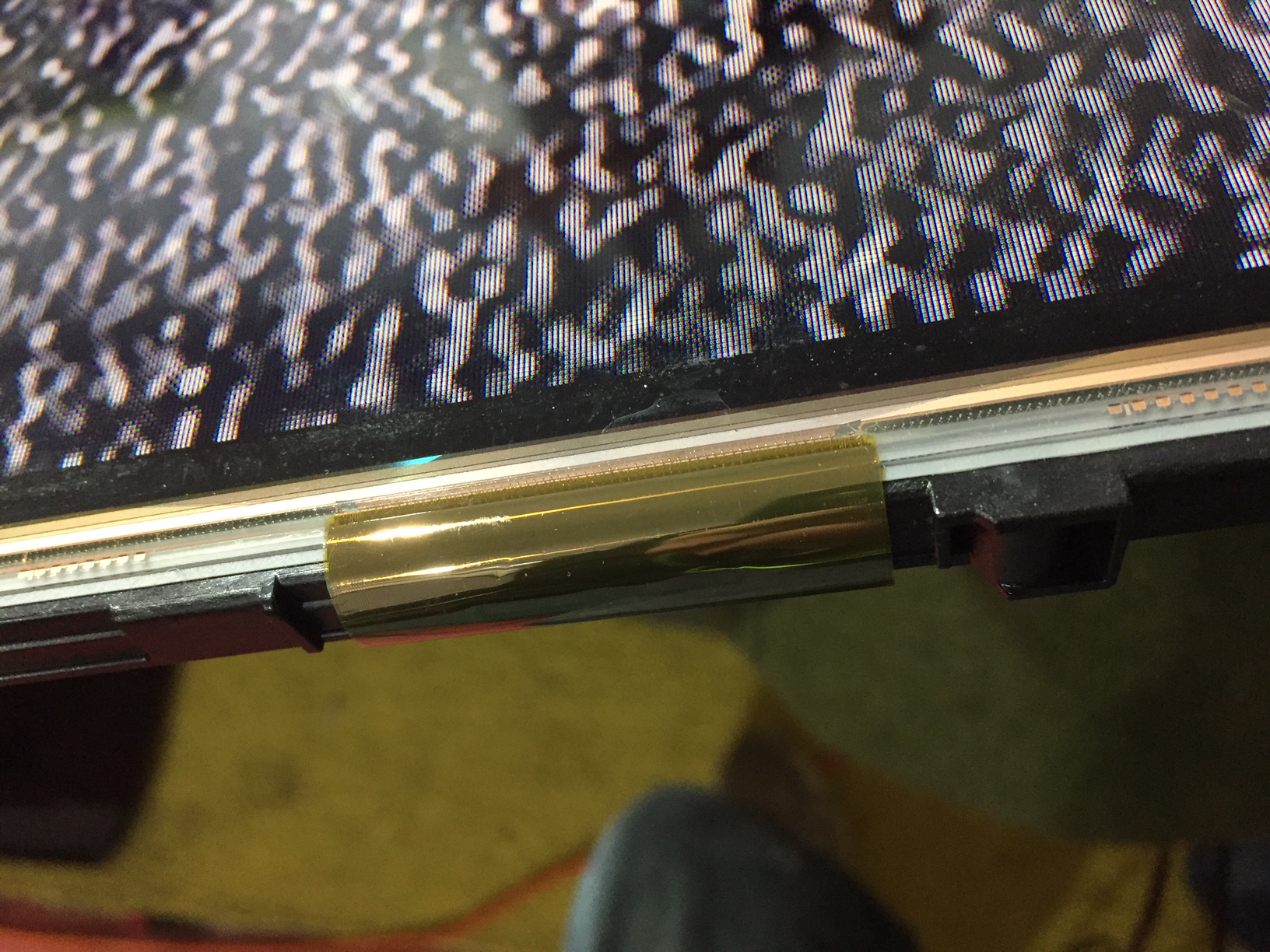

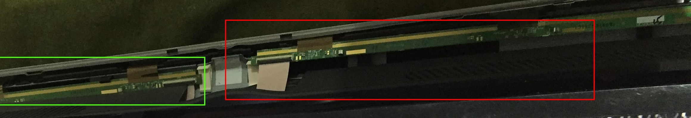

    It looks like the tab bonding board on the right is not put in place correctly, it is sitting higher than the left side.

        I assume you are talking about tabs on that long board on panel the brownish copper looking ribbons that connect to the panel?

          Re: 40" samsungreplaced led strips
          Yes he is https://i.ytimg.com/vi/98a8iMokMcY/maxresdefault.jpg

              Well, look at how board is sitting right now. Hopefully the connection of the flexible PCB film did not come loose from the tab bonding board.

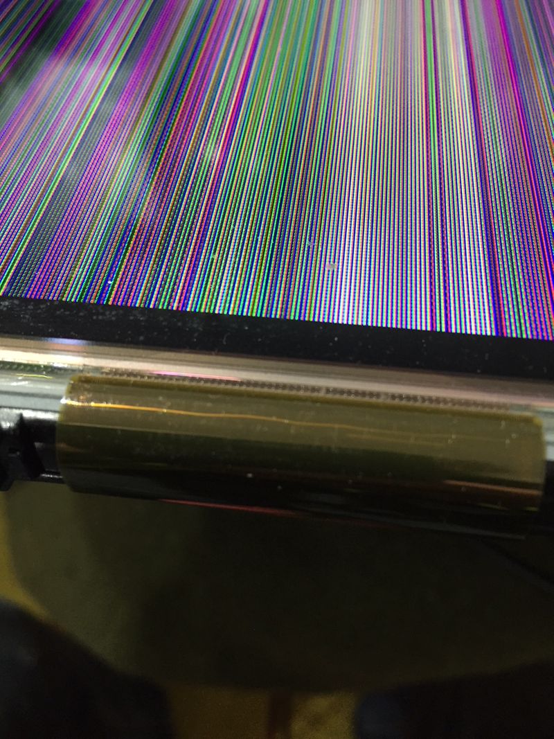

                  Hey budm:I have an update.I used my microscope to check connections on the panel and couldn't find a problem with either.So out of curiosity i switched around the ribbon cables and low and behold the problem followed the cable.Its a bn96-24430a.I tried cleaning it to no avail,guess i have order one.
                    https://www.badcaps.net/forum/attach...2&d=1551827545
                    BTW: This picture does not match what you show on post 1.
                      Yes bud your'e right i made a mistake on that,thank god someone is paying attention.Afterwards i looked at cables on effected side and all looks good.What is your suggestions?
