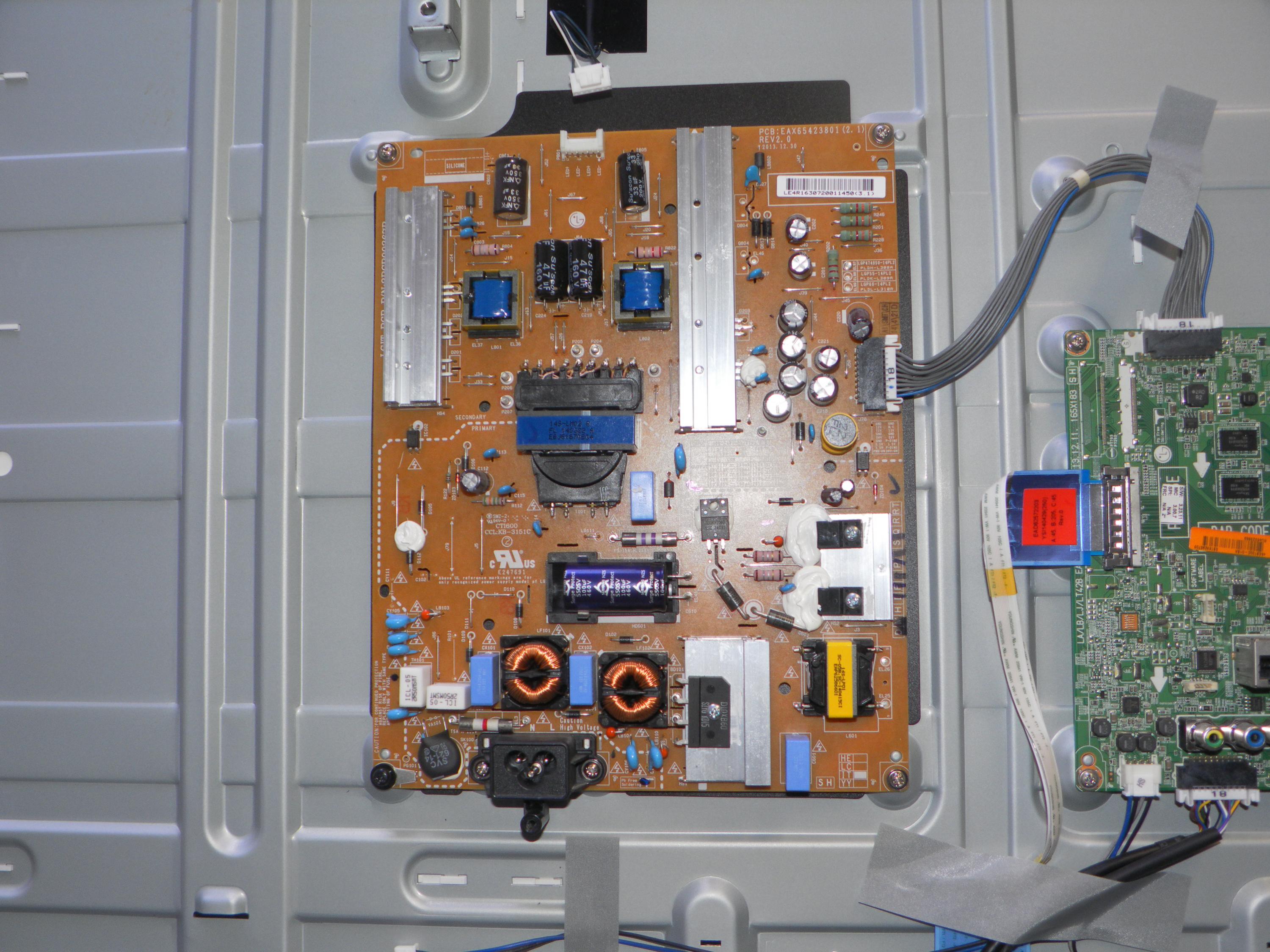

This TV came in with the picture flashing rapidly on and off. I tested the LED's and they are fine. I then checked to voltages to the led's from the power supply and the voltages were changing from high to low on led+ on the left and changing too fast to tell what voltage's were on led+ on the right. Has anyone ever seen this before?
LG 50lb6300 voltages are reversed

You have tow boost converter circuits for two LED strings.
The two LED strings are not the same size.

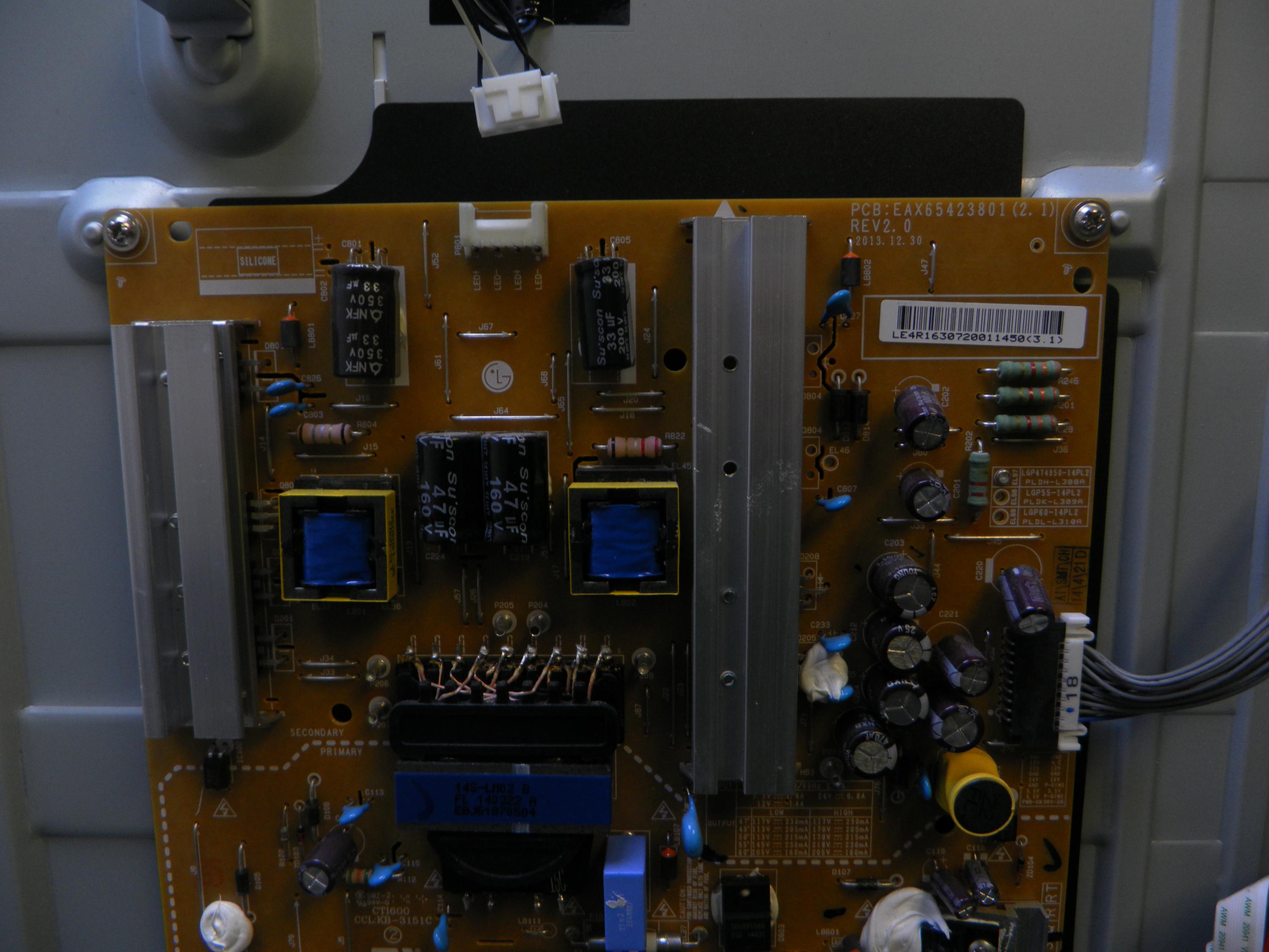

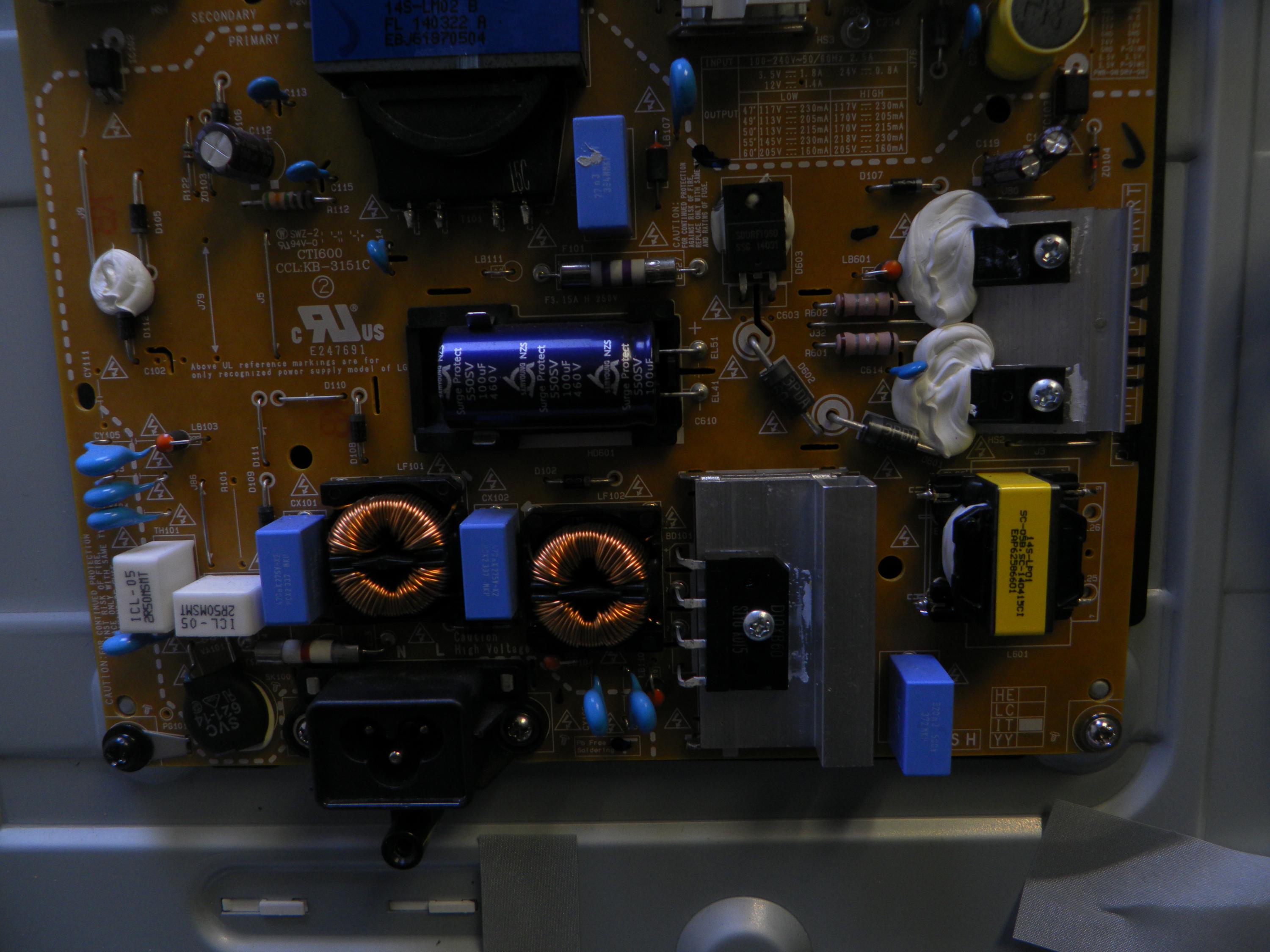

How about good clear straight shots of the whole top and bottom side of the board?
Also what Voltages did you test on the connector of the power supply board that goes to the main board, what are they? You need to put down pin name of each pin and follow by the Voltage reading.Never stop learning

I do not know why my answer to your last question did not post but here it is again. I put the ground on one of the screws on the back frame.
1 is pwr-on -
2 drv-on

the point that you are using for "reference" which is the black lead IS NOT at ground potential (most likely floating) and hence any measurement to that "reference" is probably not going to be what you are looking for.
you can verify ALL your ground points and other areas with the set unpowered / unplugged and measure resistance between various "ground points" that you think should be grounds. They should all measure "0". Once you have determine that, then you can proceed to measuring things again.Comment

Just to be clear, you are saying that the 3.5V, 12V, and 24 all shown as - 3.5V, -12V, -24V? Can we see the probes hookup and the screenshot of the meter display?
All the boards are screwed down, correct?Never stop learning

Turn down the backlights level on all input to as low as possible to see if it has any affect on the symptom.Never stop learning

I turned down the backlight on all inputs to 50% and it ran fine for one day. I turned it on this morning and back to the same problem. I ordered a power supply since the main board is not available and I will hope that is it.Comment
Re: LG 50lb6300 voltages are reversed
Did the new power supply board fix it?Comment
