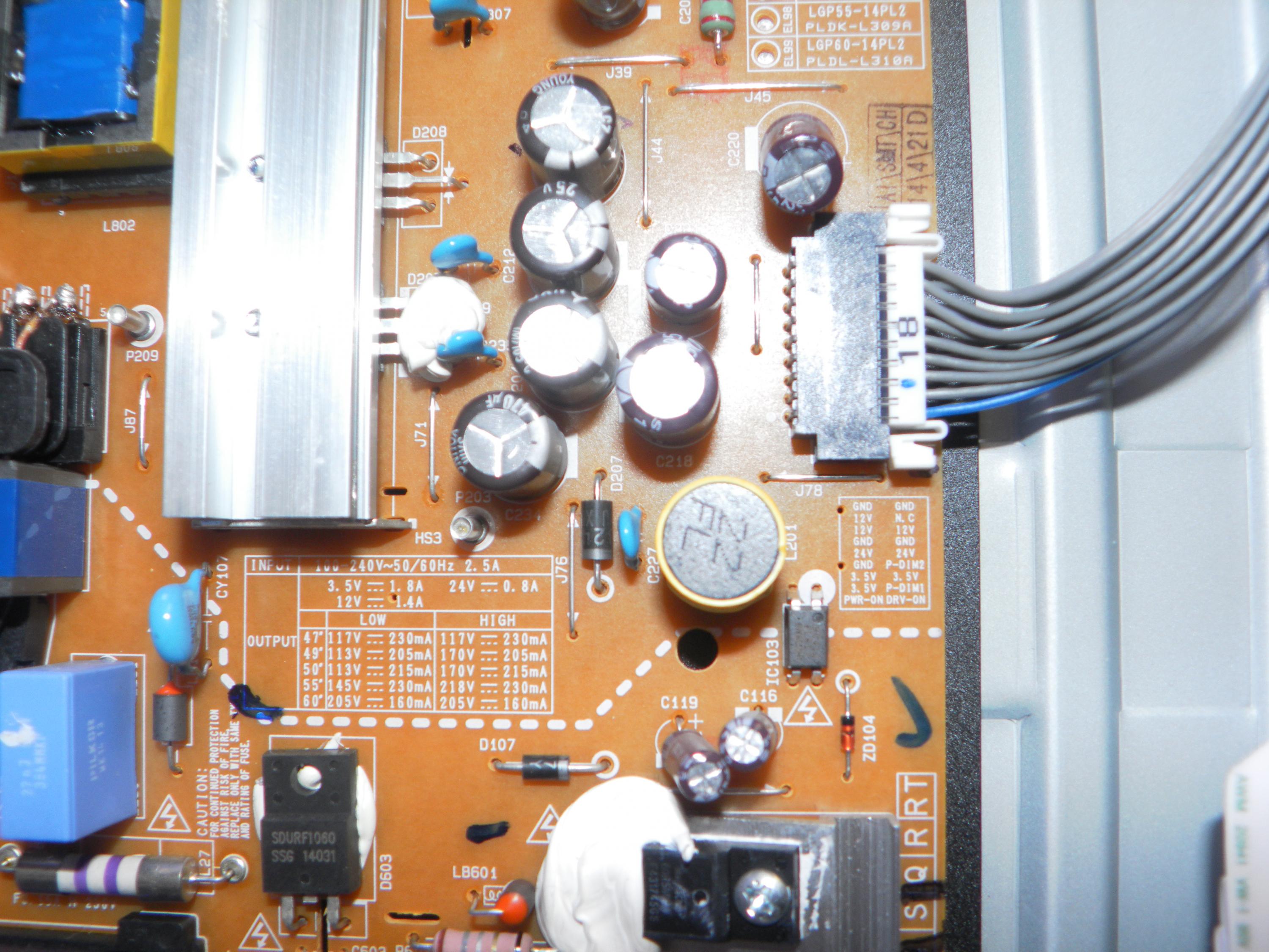

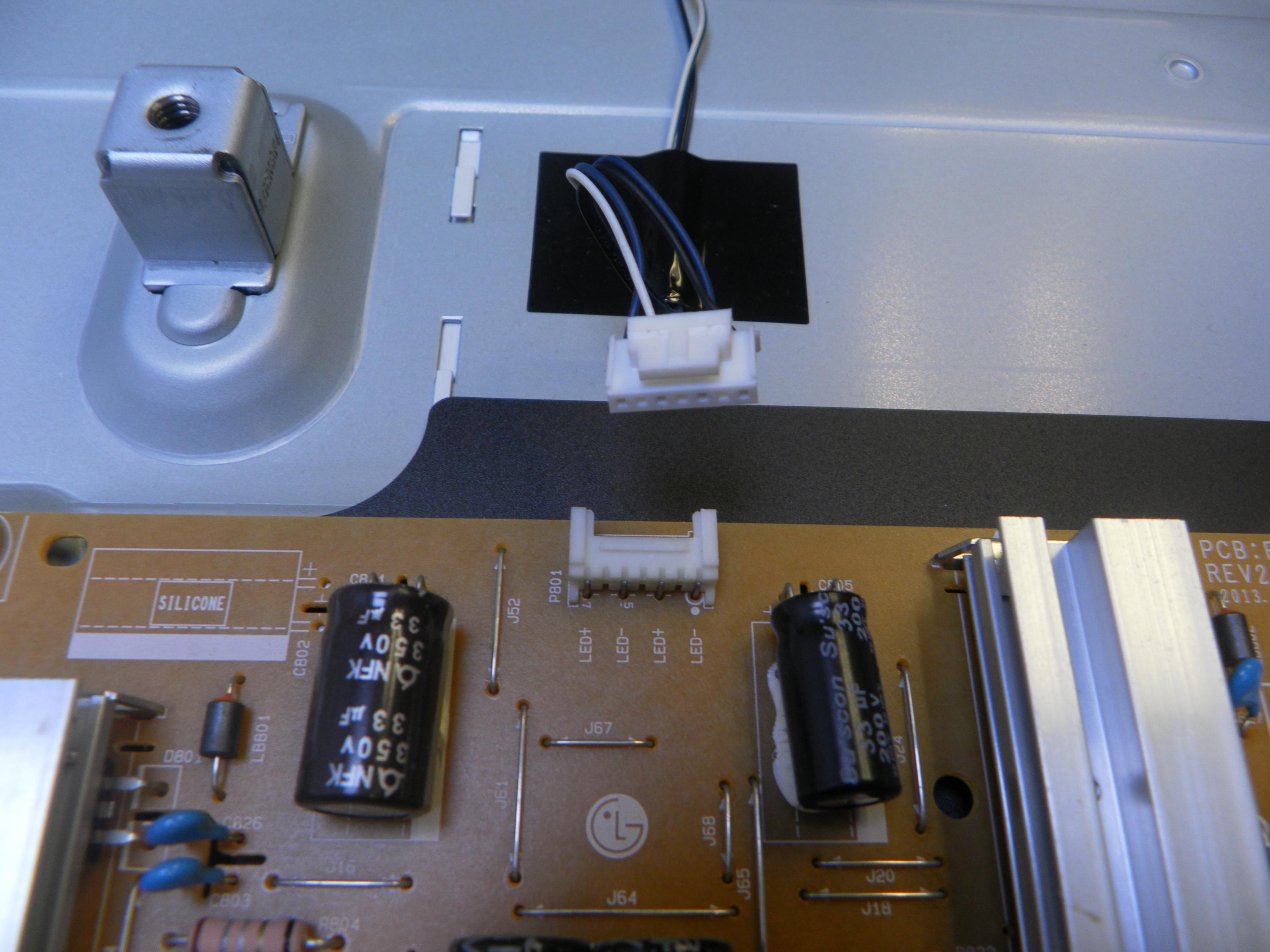

    This TV came in with the picture flashing rapidly on and off. I tested the LED's and they are fine. I then checked to voltages to the led's from the power supply and the voltages were changing from high to low on led+ on the left and changing too fast to tell what voltage's were on led+ on the right. Has anyone ever seen this before?

    I forgot to add that the some of the voltages to the main board from the PS are reading negative. I found pins 1,2,3,5,6,7,9,10,11,14 and 17 are all in the negative. sorry,

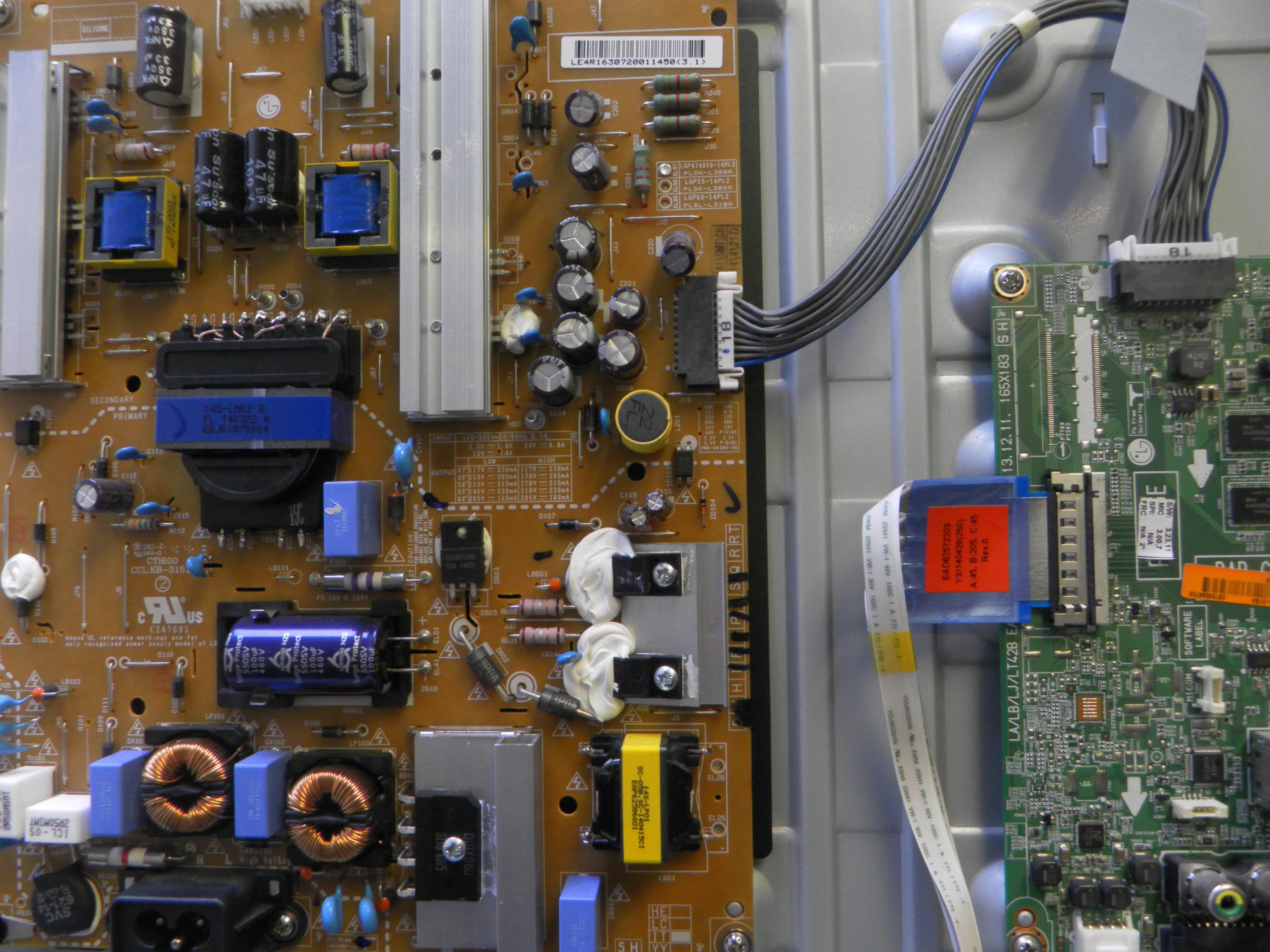

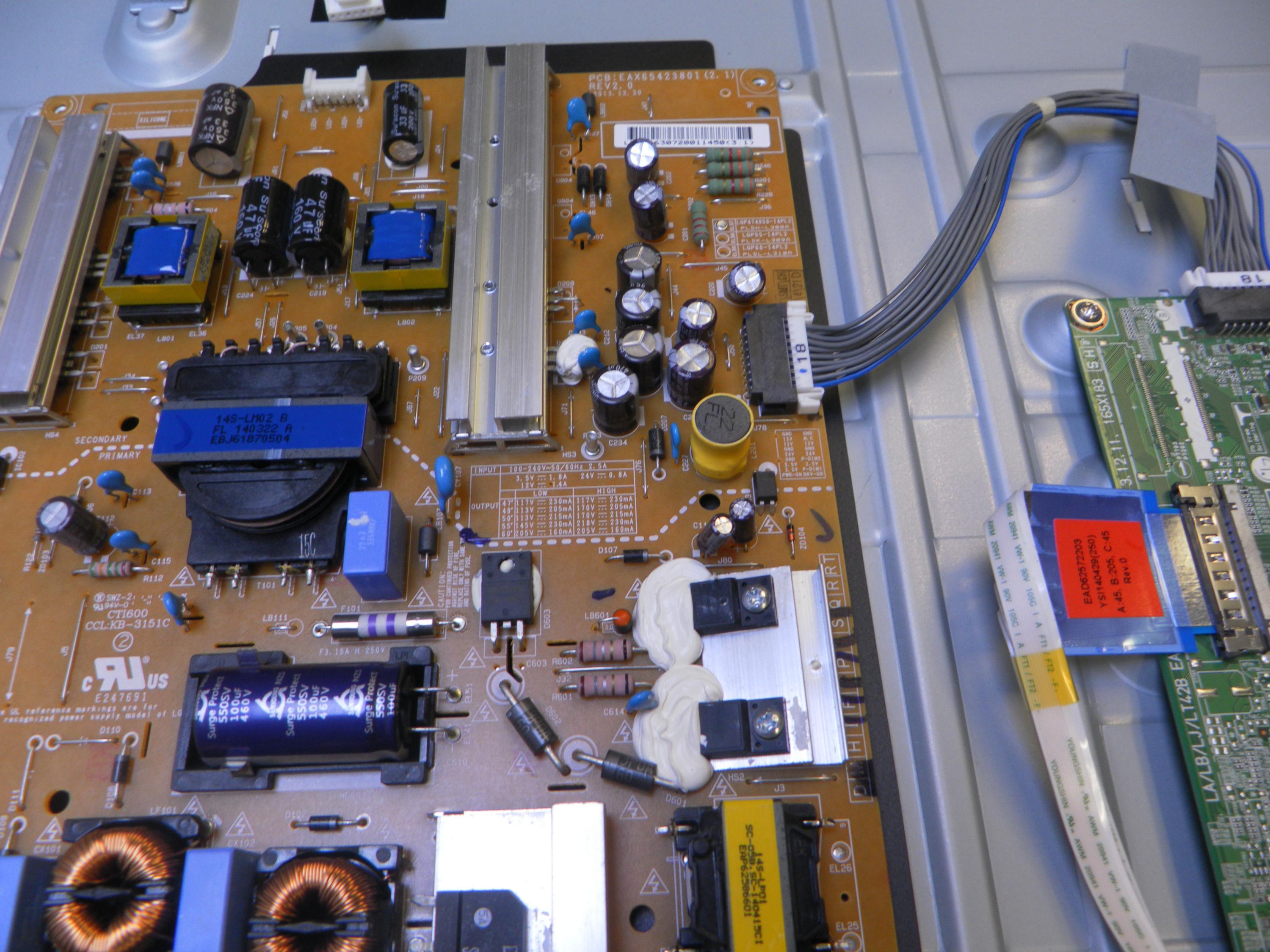

      You have tow boost converter circuits for two LED strings.
      The two LED strings are not the same size.
      How about good clear straight shots of the whole top and bottom side of the board?
      Also what Voltages did you test on the connector of the power supply board that goes to the main board, what are they? You need to put down pin name of each pin and follow by the Voltage reading.

          Re: LG 50lb6300 voltages are reversed
          I do not know why my answer to your last question did not post but here it is again. I put the ground on one of the screws on the back frame.
          1 is pwr-on -
          2 drv-on
          3 3.5v
          4 p-dim1
          5 3.5v
          6 3.5v
          7 gnd
          8 p-dim2
          9 24v
          10 24v
          11 gnd
          12 gnd
          13 12v
          14 12v
          15 12v
          16 nc
          17 and 18 gnd
          even the grounds show neg voltage.
            the point that you are using for "reference" which is the black lead IS NOT at ground potential (most likely floating) and hence any measurement to that "reference" is probably not going to be what you are looking for.
            you can verify ALL your ground points and other areas with the set unpowered / unplugged and measure resistance between various "ground points" that you think should be grounds. They should all measure "0". Once you have determine that, then you can proceed to measuring things again.

                            I suspect the ground screws are not power supply ground, Use P205 or P204 near T101 transformer for ground, or use heatsink (HS4)
