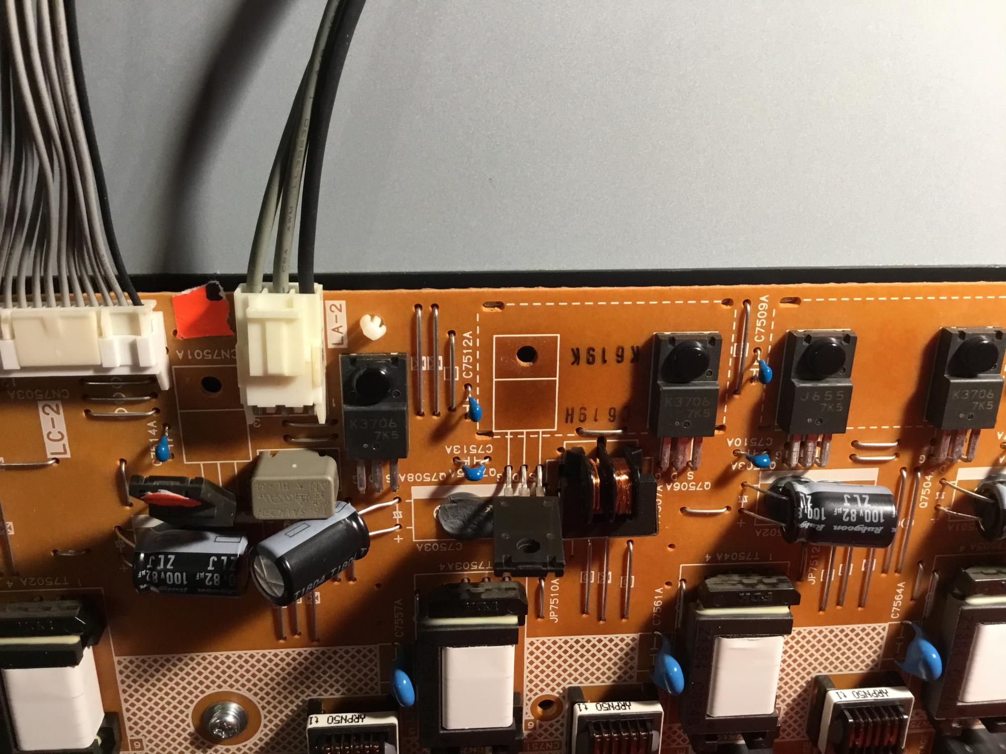

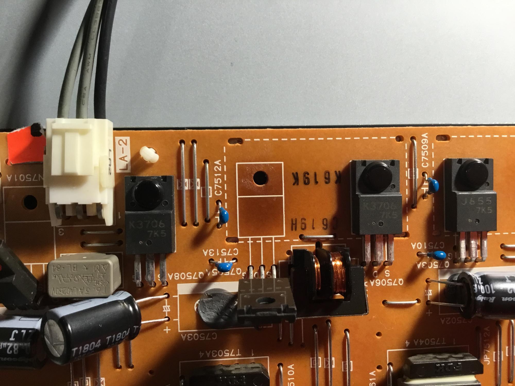

                  Great advice guys! I think i have it narrowed it down to a single mosfet now. I touched up the joints but no go. I made a funnel for the hair dryer and found it this way. I can remedy the the problem on command now by heating the fet and quickly induce the problem by cooling it. Im going to swap its position with another of the same fet on the board and see if the trouble moves with it.

                    Nice work, looks like you found the culprit.

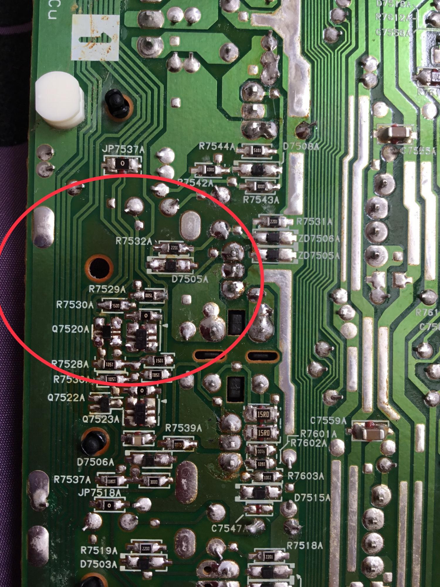

                      So I swapped the suspect mosfet positions with another on the same board but the trouble didn't follow the suspected fet. So it looks now the issue is not the fet but the actual board being heat up. The pad area underneath the problem area looks darkened from prolonged heat and I noticed a very small hairline crack on the top side of the board underneath where the fet was. Now this is the trouble area and heating it up temporarily fixes the issue. I was hoping to find a broken trace or solder joint on the flip side but couldn't find any defects. There is an smd resistor and diode directly underneath where the fet was so I touched up the joints but no go. I did a lot of continuity tests on the traces and pads in the area as well but no improvement. I am uploading some pics of the area. One interesting thing I noticed is when the area is cold and I fire up the set while holding the fet, the screen flickers as usual and you can immediately feel the fet heat up a great amount. Now if I heat up the board with the hair dryer then turn it on the screen comes on immediately no flickering and the fet doesn't get very hot.

                        I would continue reflowing stuff in that area. Another idea that just crossed my mind is to see what transformer that FET is driving and swap THAT with another one, rather than the FET. The heat might cause some strange behaviour in the nearby transformer as well Though you said you tried funneling the heat as much as possible, through conduction some of it may have "leaked" down to the transformer...just my 2 cents at this point.

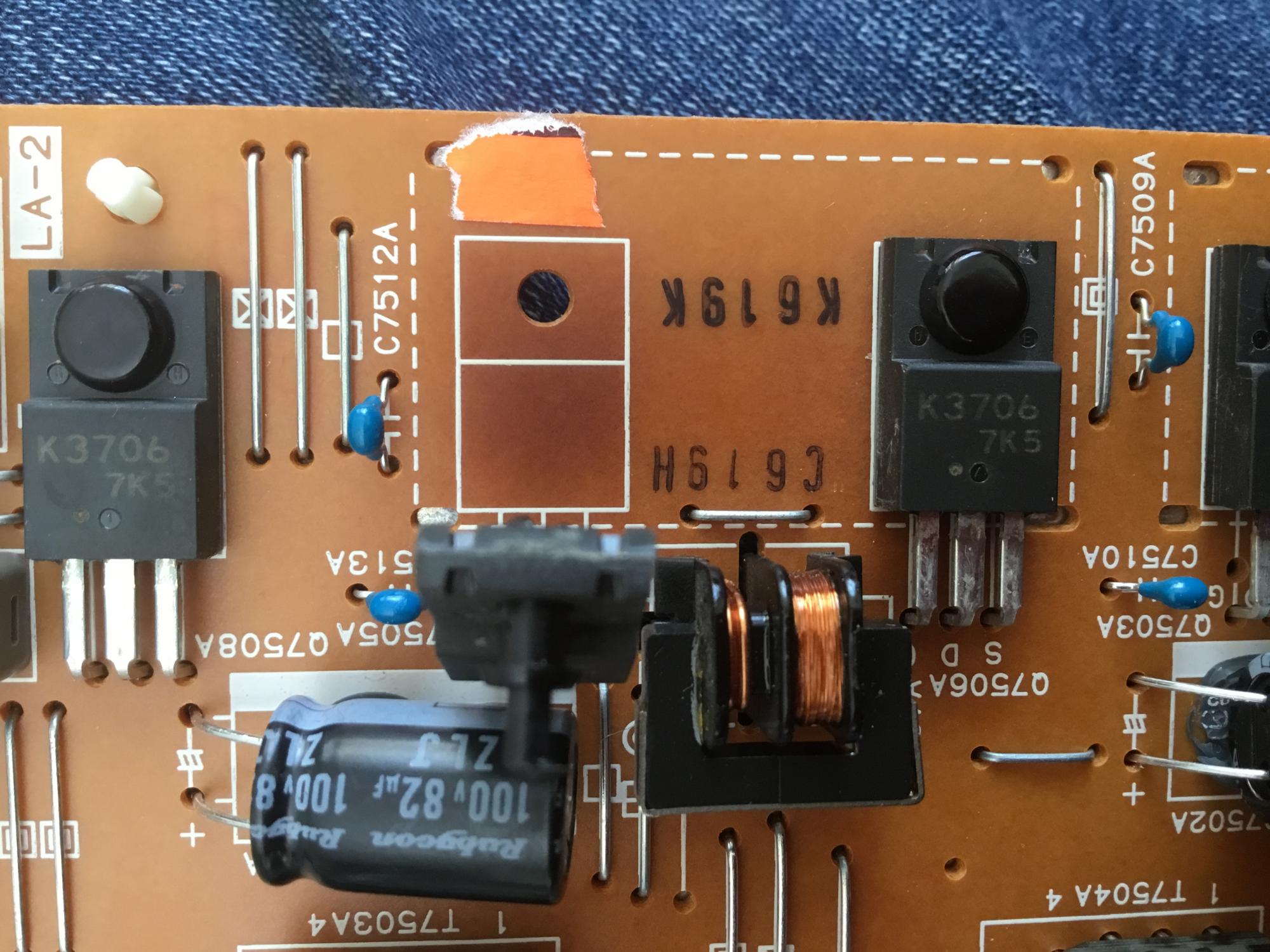

                                Great News! The set is working now. I had to bite the bullet and buy the master inverter board and all looks ok now. It would of been nice to fix the old board but now I have some spare transformers in case of future troubles.
                                What led me to throw in the towel was while trying to measure the gate voltages to the mosfets to see if one wasn't receiving a proper gate voltage to fire, my probe slipped and shorted one FET out. So now my trouble was compounded and i just decided to get the whole board. However I was getting some measurements i didn't understand. There are 8 mosfets on the board, 4 p-channels and 4 n-channels. Now on the n-channel fets i got a reading of around 4.5vdc from gate to chassis but on the p-channels I measured 60vdc on their gates which seemed too high. 60 volts also happens to be the supply voltage to the board. I know a scope is really needed to see the waveform but I wonder if this is some sort of push-pull configuration how the fets are arranged. A big thank you to the great tips and help!
