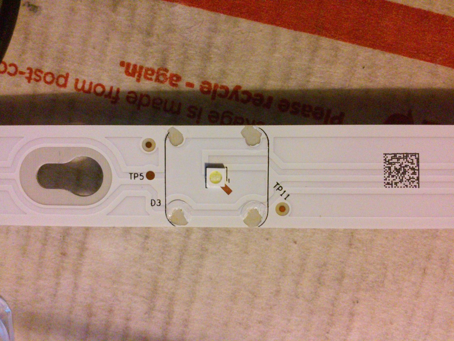

      I thought there was a way to measure the LED.
      But my TV is a TCL 43s405.
      part # LB4308, TOT_43D2900_3X8_3030C_D6T-2D1_4S1PX2 <<< oh damn. 3030 might be a clue. Are all 3030 LEDs the same output? What color temperature are TV backlights usually?
      and the strips look like this...

        Re: How do I find exact replacement LED bead for this backlight strip? and will it la
        I also tried to test the individual LEDs with a 3V battery with 2 needle probes, and no matter where I scratched off the white paint and put the leads, I couldn't get any LED to light up.
        This strip has confusing lead pattern.
        I put the probes at the X's...
        And my probe tester....

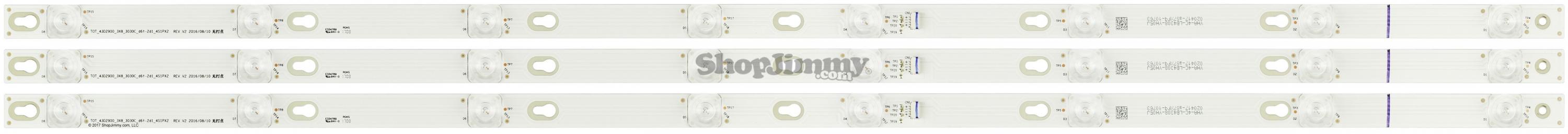

          You have 4 strips so how many strips are not lighting up when they are connected to the TV? What Voltage do you have on LED+ pins and on LED1-, 2-, 3- 4- with all the connectors in place.
          https://www.shopjimmy.com/tcl-lb4308...43s405tdaa.htm
          https://www.shopjimmy.com/catalogsea.../?q=TCL+43s405

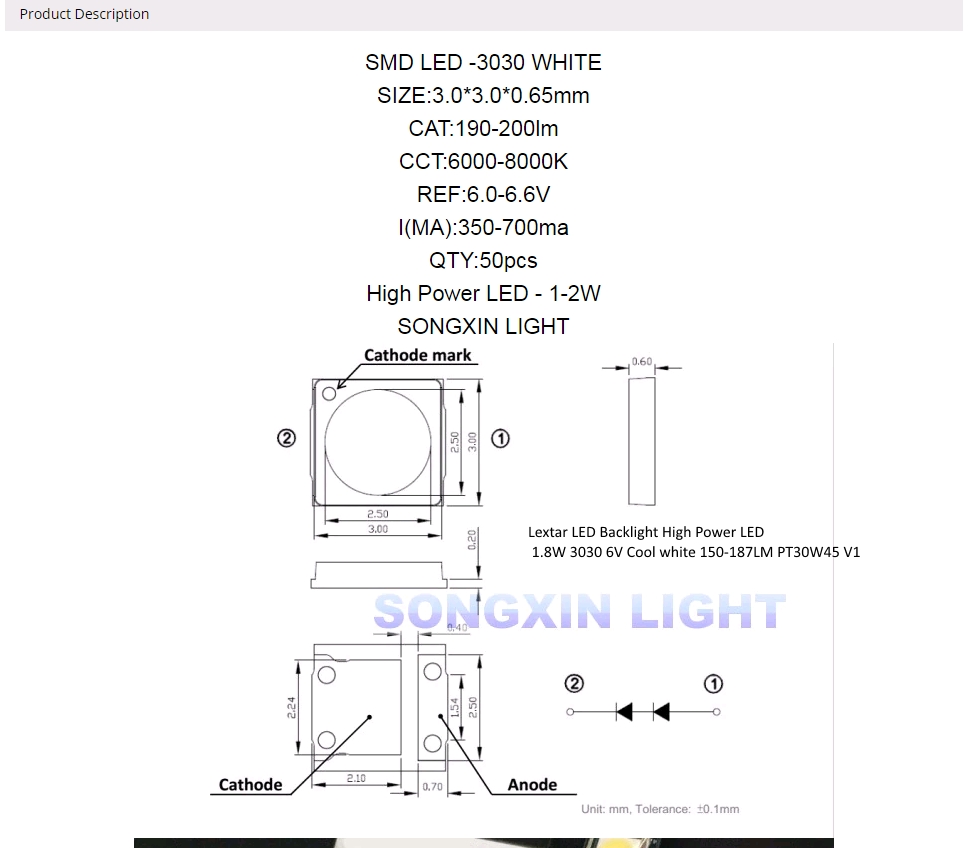

                                I measured the voltage across a single LED at 6.5V, so confirmed this is definitely 6V 3030 LED.
                                So I go on aliexpress and buy "50pcs Lextar LED Backlight High Power LED 1.8W 3030 6V Cool white 150-187LM PT30W45 V1 TV Application 3030 smd led diode"
                                for $2.61
                                and I'm golden?
                                SMD LED -3030 WHITE
                                CAT:190-200lm
                                CCT:6000-8000K
                                REF:6.0-6.6V
                                I(MA):350-700ma
                                QTY:50pcs
                                High Power LED - 1-2W
                                I watched some youtube videos, and one guy did some current adjustment after replacing some LEDs.
                                I hope I don't have to do that, cuz I don't have the tools.
                                I measured the current across one LED at 290mA.
                                Will the LED specs quoted above work?
                                    Hopefully the PCB foot print will match your replacement LED, the replacement LED has large heat transfer pad as Cathode.
                                    The ratings of the LED are OK.
                                    http://www.lextar.com/?sn=90&lang=en-US&c=774
                                      so when those LED specs are 350-700mA
                                      If the TV only supplies 290mA when plugged in, that will still run?
                                        Since we do not have details spec of the LED, the 350 mA rating may be the maximum current rating at 25c, the 750 mA may be the pulse peak current.
                                        You do not want to run the device at maximum spec, you also need to do good thermal management. You always want to have safety margin when operating the device.
                                        The 290 mA you measured may not be the maximum current the LED driver power supply is putting out since you do not know what the backlights setting is at for your TV right now, it may be at max, or 90%, 80%, who knows.
                                        Look at example of the spec sheet.
                                        BTW, looking at your pictures in your post 16, I cannot tell how the strips are wired up together, each strip had 4-pin connector, so it has 4 wires on each connector? The LED's have to connected in series some how.
