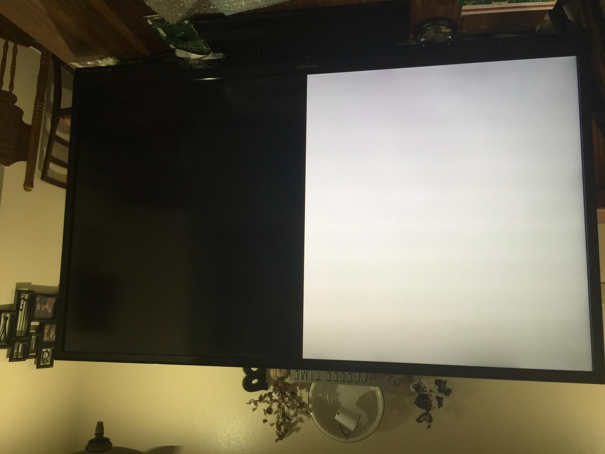

    sharp lc-60le640u
    Working on this unit, I have check voltage to main board and are getting the 13 & 3 volts. I have check voltage to t con board and get 12v on first 2 and zero on last 2 pins. The unit does power on and has backlight but no Video or sound. I was just getting backlight but I have messed with ribbon cables on t con board and now I get some red lines on left side of screen.

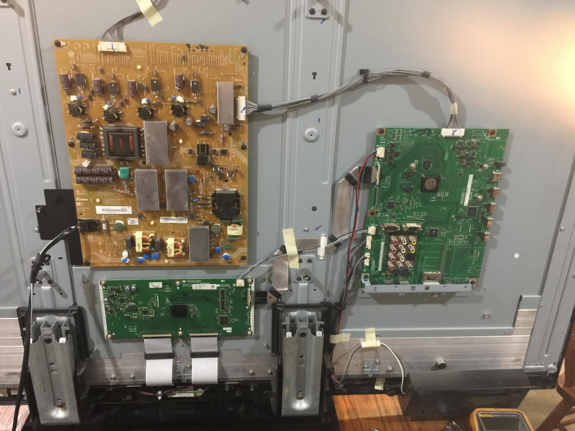

    Re: sharp lc-60le640u
    Here are the boards.

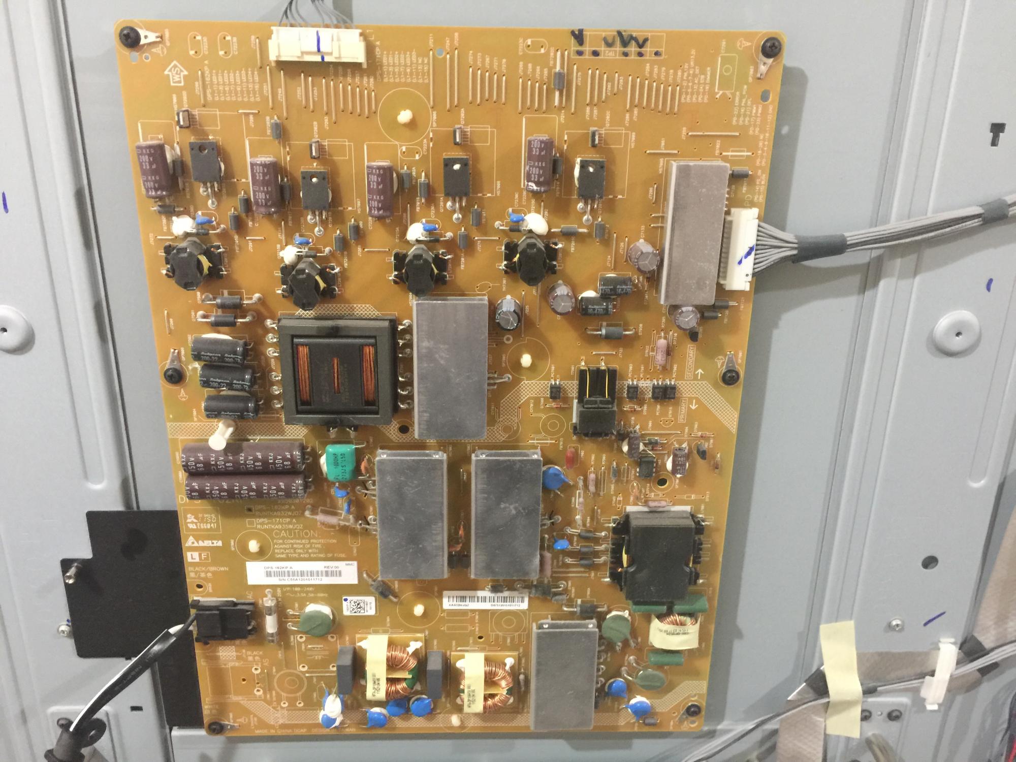

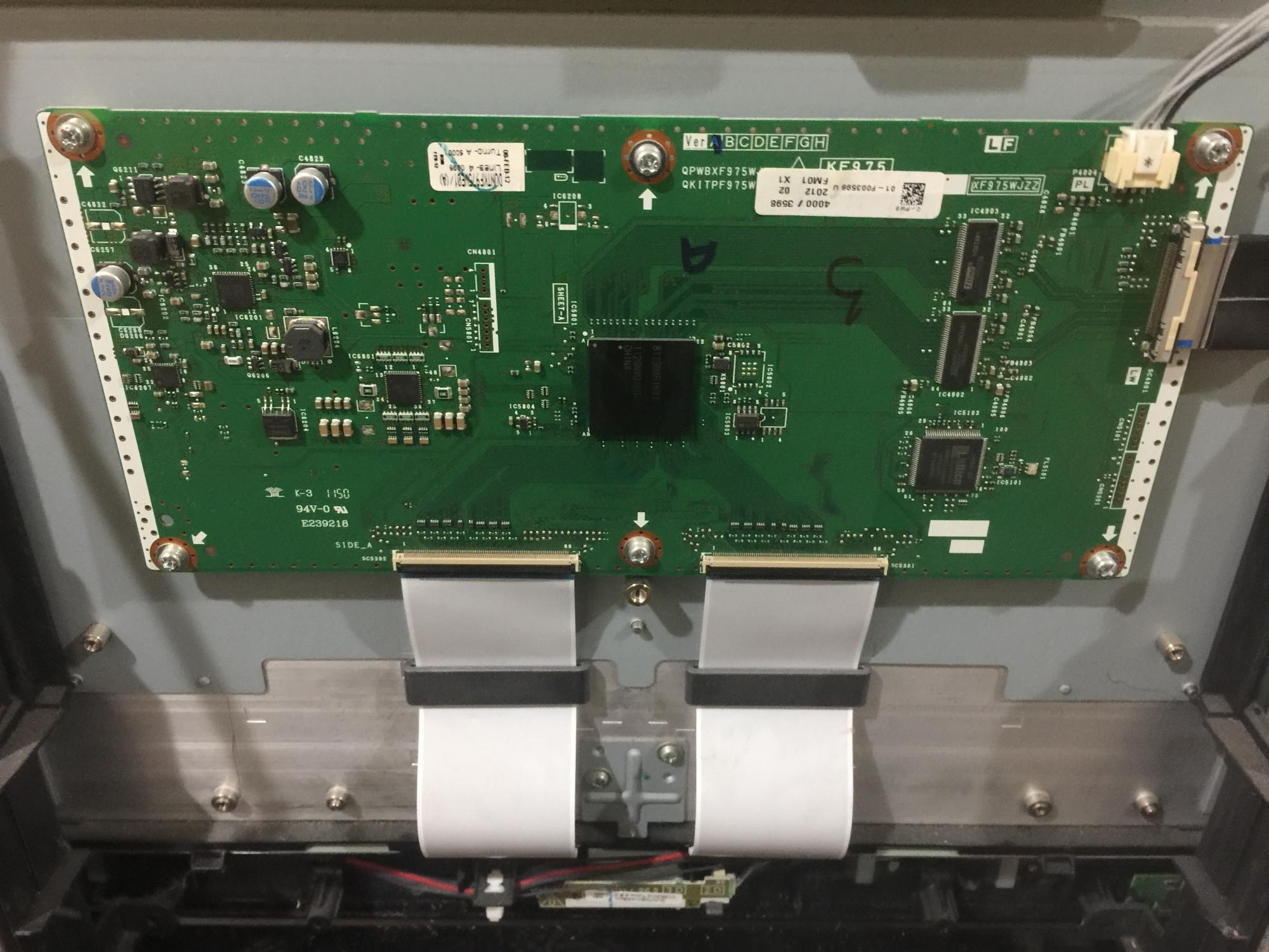

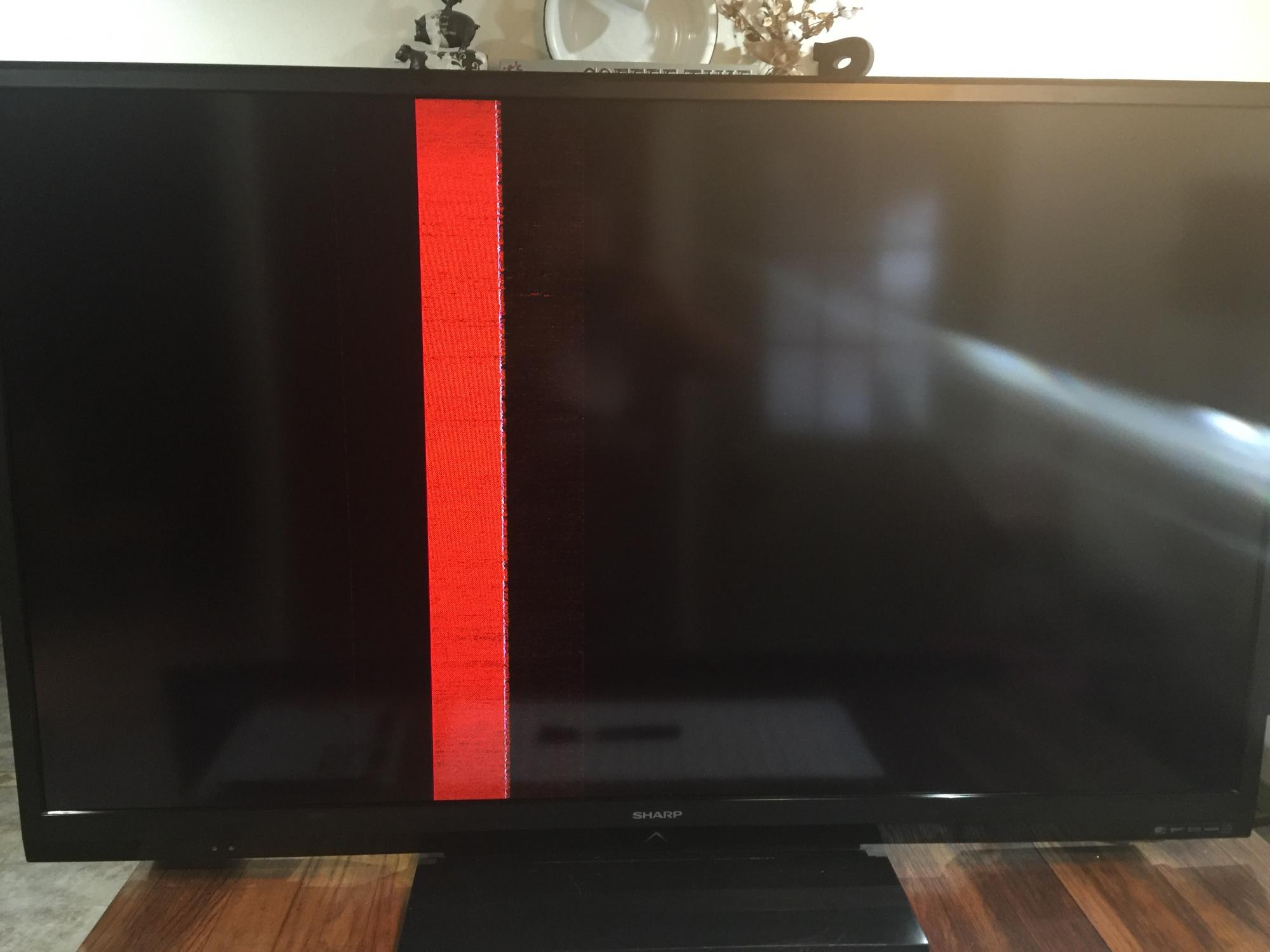

      Replaced t-con for no change except to clear up the red line I caused, back to backlight but nothing else. I got some more reading from top of powerboard.
      1- 12.1v. PNL 12v
      3- -.009 GND
      5- 13.1v UR 13.2v
      7- 13.1v. UR 13.2v
      9- .010. GND
      11- .010. GND
      13- 3.31v. AC_DET
      15- 5.04v. BU 5v
      17- 1.15v. PWM1
      19- 1.3v. Dimmer
      21- 1.15v. OFL
      23- .000v. PWM2
      Any suggestions from that, I can check the readings on the bottom if needed. I am not sure about 17 and 23. Thanks
        Tcon is good. Panel is good. Sharp will fail if tcon cables are messed with while powered up. That's probably what happened. I suspect mainboard. Try heating up the mainboard with a hairdryer. probably bad bga under processor.

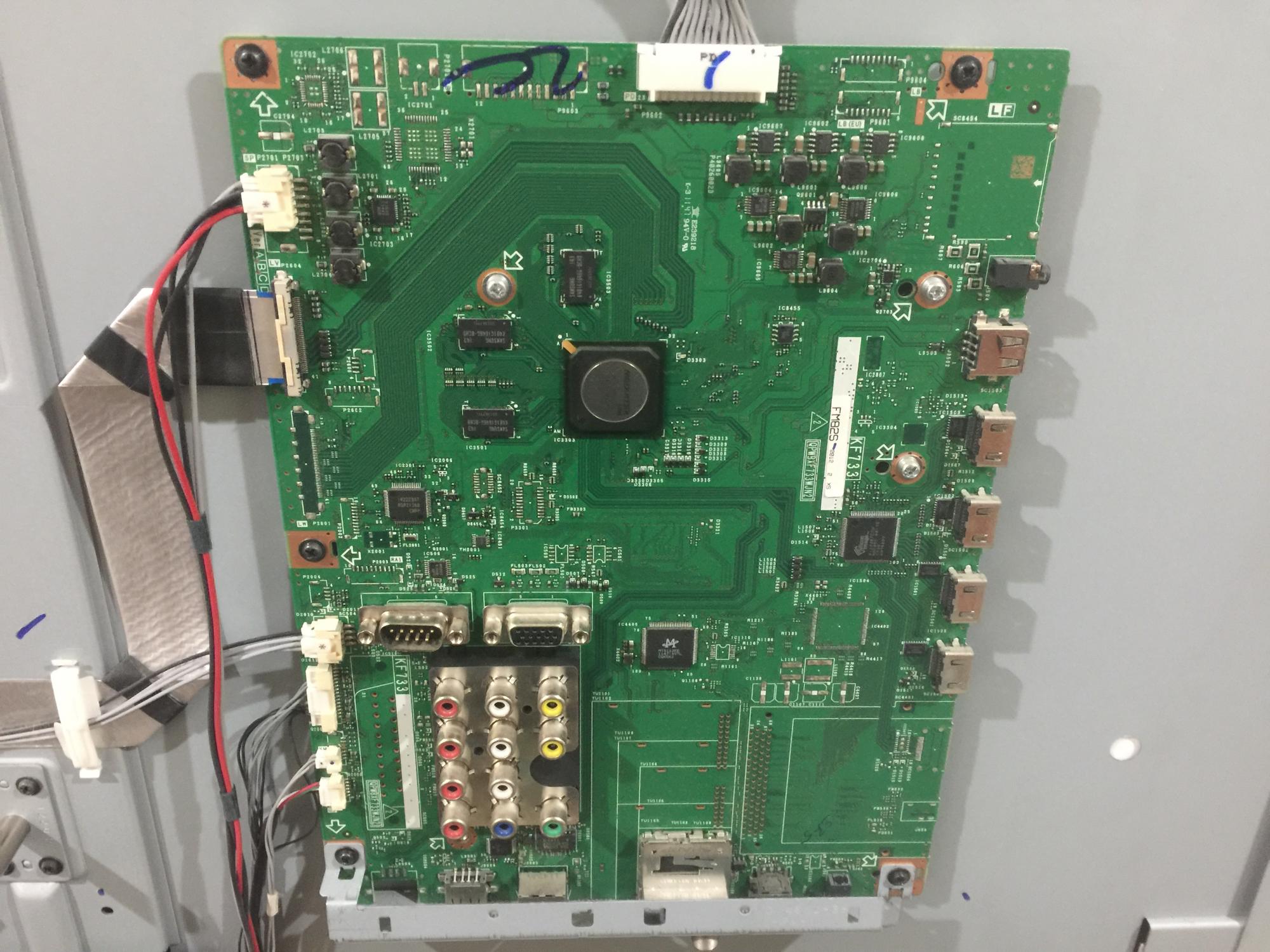

          Thanks for the advice, ordered a main board hope that fixes it.
          • Hornnumb2
            • Feb 2011
            • 218
            Well installed main board today with no change, I have a shop jimmy kit to rebuild power supply. I just know where to go from here. Thanks Michael
              if you disconnect the tcon to panel cables, one at time (with power off), result do you get?
                White one side black the other and vice versa.

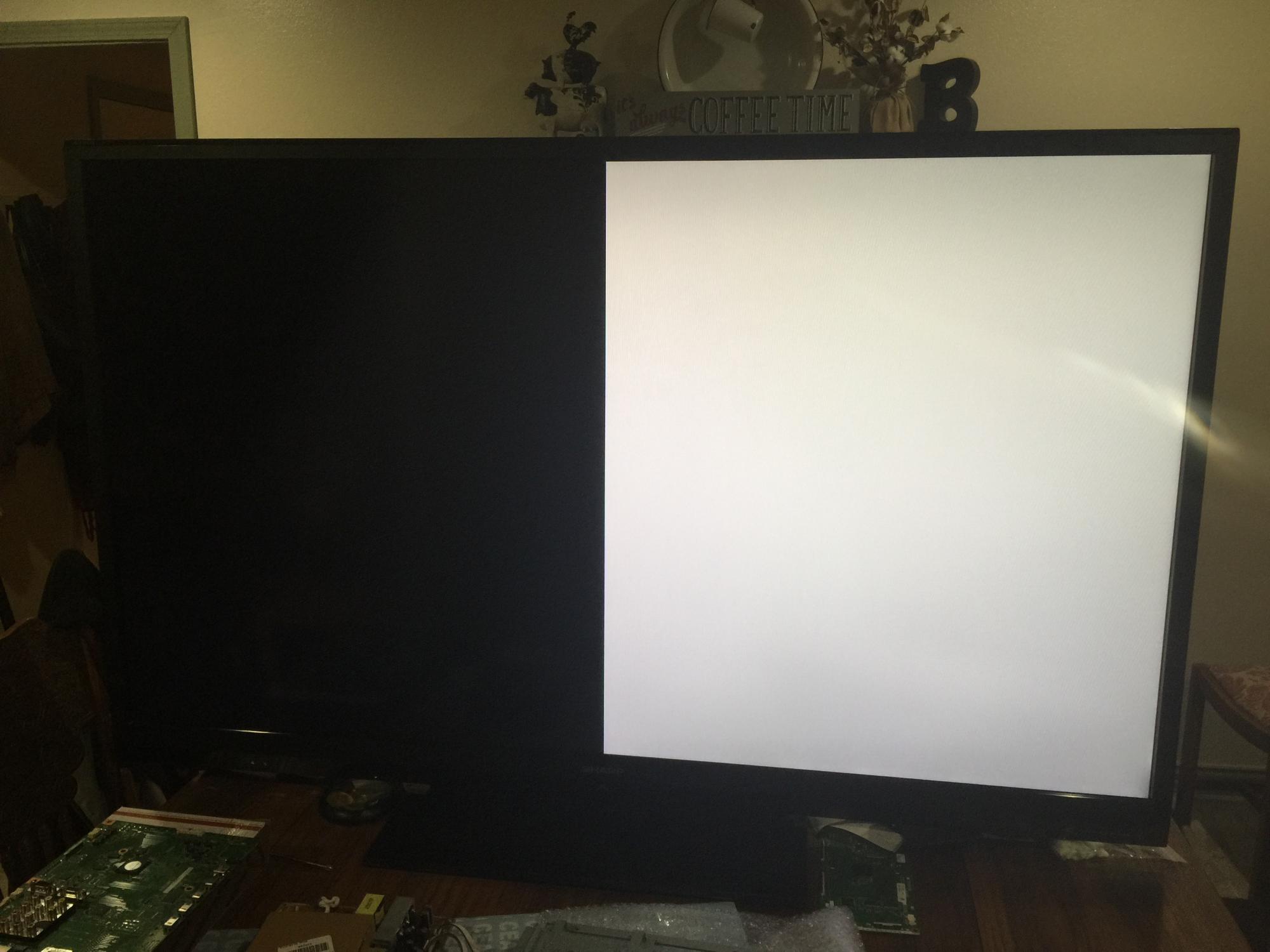

                    somewhat expected (white).... is the white uniform when seen on both sides?
                    based on the card changes that you did so far, my guess would be a problem between the tcon and panel, potentially a smd component on the panel boards.
                    tracing the voltages from / at the tcon (labelled) and following those to the edge board might help.
                    • Hornnumb2
                      • Feb 2011
                      • 218
                      Hard to get a good pic of a white screen, but the look pretty close to same to me.
                      • Hornnumb2
                        • Feb 2011
                        • 218
                        I don’t know why it flipped one pic.
                        • budwich
                          • Jul 2015
                          • 3097
                          no problem... yes indeed they look ok. This appears to show that the panel itself is not a direct problem. However, some how the panel is not being driven.... either no signal or some operating voltage is not getting to the panel. Check the voltages on the tcon.
                            Voltage going into t-con or out? I did measure the 4pin PL line and get 12v on first 2 and nothing on the other 2.
                              See if you have voltage on each side of tcon fuse, negative meter lead on a ground.
                                  there should be a "multitude" of voltages labelled throughout the tcon... those are the ones that you need to measure / post.
