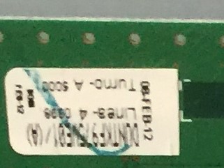

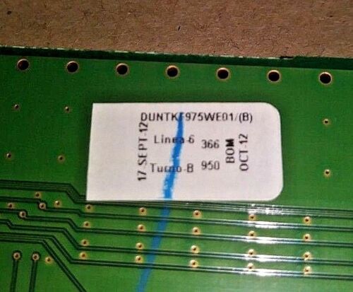

                My t-con says lines 4 and replacement says lines 6 should that matter

                  Info. there, tells you what to look for as in part number and sticker numbers to match up: https://www.shopjimmy.com/catalogsea...q=+lc-60le640u

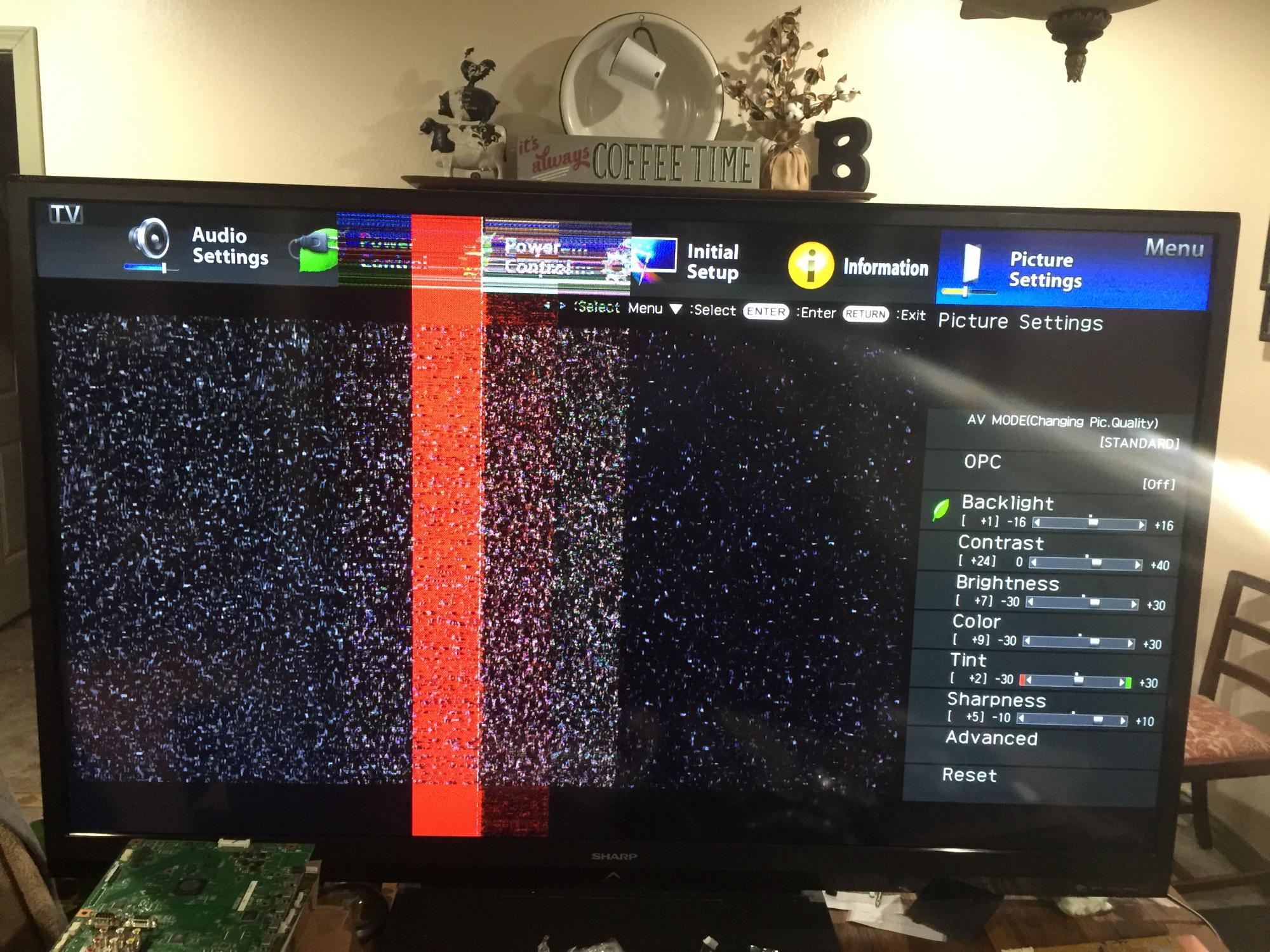

                          Well after trying to rebuild power board twice to just see if it was missing some voltage and it dying both times. I ordered an eBay power board and for the first time got a menu but still have red line on one side of screen. Any ideas now, I did try unhooking ribbon cables and rebooking with no luck. Help please, I have so much money in boards on this thing now it has to work.....
                            I would like to call your attention to this thread I started on an LC-60LE600U. Your TV is similar.
                            https://www.badcaps.net/forum/showth...ht=lc-60le600u
                            Quick background on this thread: I had an LC-60LE600U with bad backlights and an LC-60LE640U fully working but with a broken LCD flap. I attempted to swap the 600's LCD flap in to the 640. The panels were incompatible.
                            The picture you posted of your TV is remarkably similar in appearance to mine after swapping the 600's panel in to the 640. The key thing I see are four even divisions of your screen right above each of the source driver boards. Eventually my screen got vertical lines on it (shown in the pic on my thread) and was way worse than yours in appearance. I thought I country-fried the display.
                            Upon installing the main and T-CON boards from the 600 in to the 640 the picture straightened right out and the TV worked great.
                            Based on this, I'm wondering if someone before you either swapped the wrong LCD flap or the wrong boards in to it and one isn't compatible with the other(s)?
