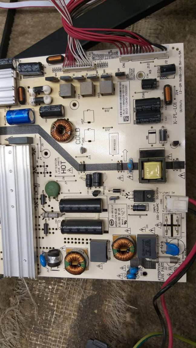

    Please also provide good clear straight shot pictures of the Top and bottom side of the power supply board.
    You need to also provide the Voltages of each pin of the connector of the power supply that goes to the main board when the TV is working OK and when it is not, make sure to provide the pin name follow by the Voltage reading for each pin.

            I need better and clearer pictures of that power supply/LED driver board, I cannot read the pin names of the connectors.
            Is that the schematic for your power supply board?
            Look at the ADJ pin with the oscilloscope.

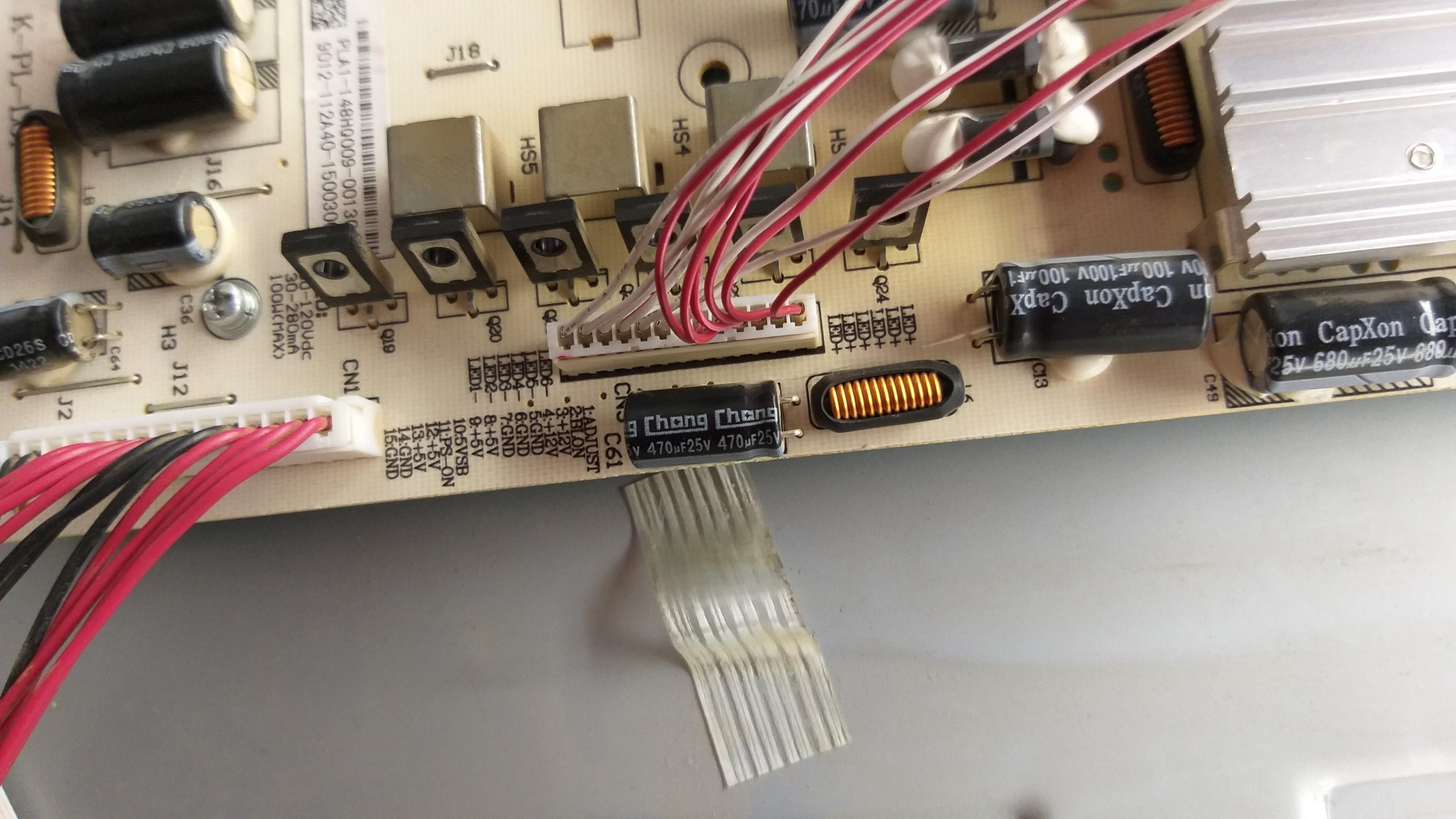

                  Here is a close up of the plug pin layout.

                    Yes Budm, the schematic i had attached is for my PSU, i will now scope the ADJ pin and post pictures soon.
