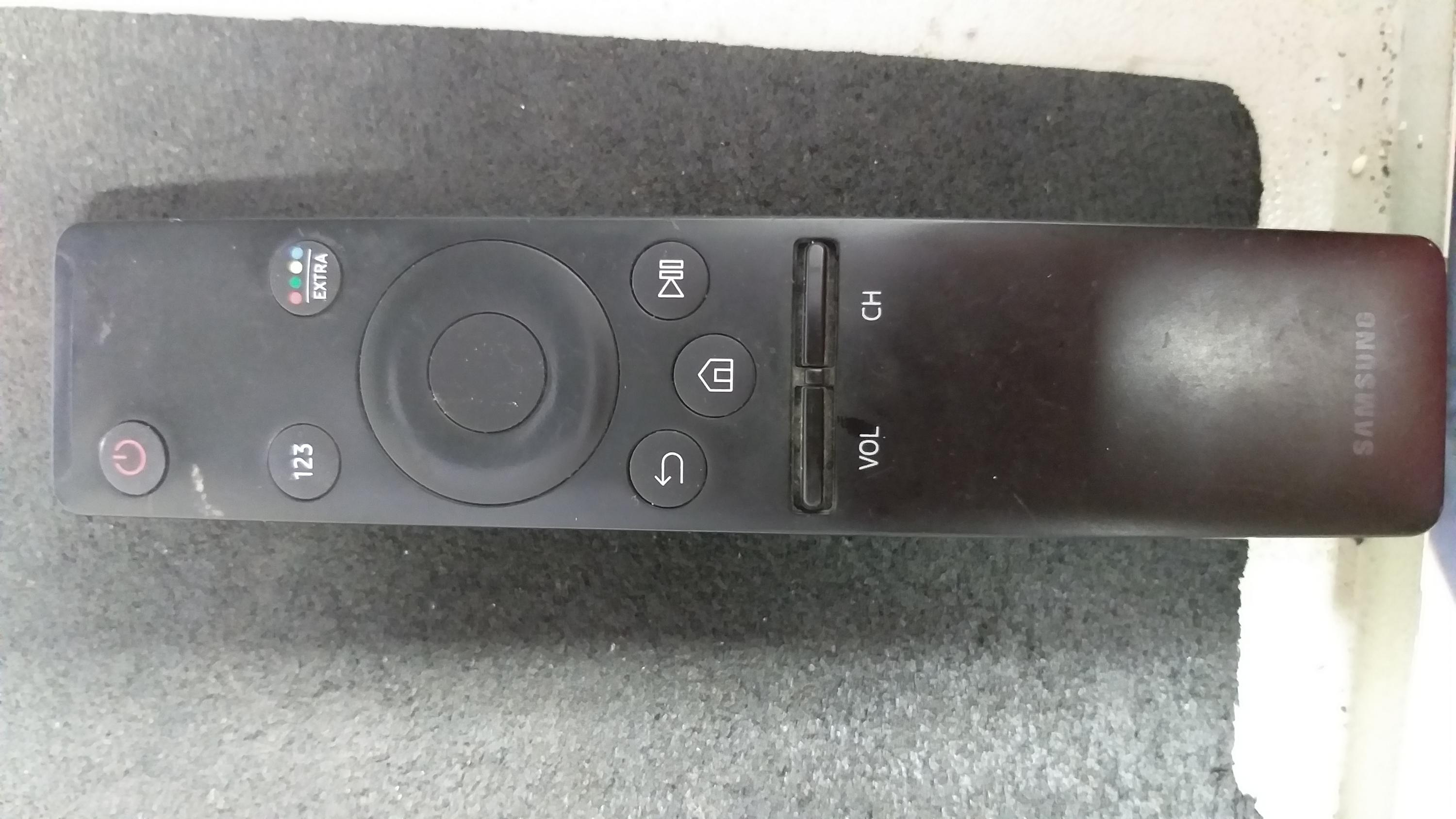

    I have no idea how to access service mode on this set as the remote only has a few buttons.

    I added a picture of the remote
