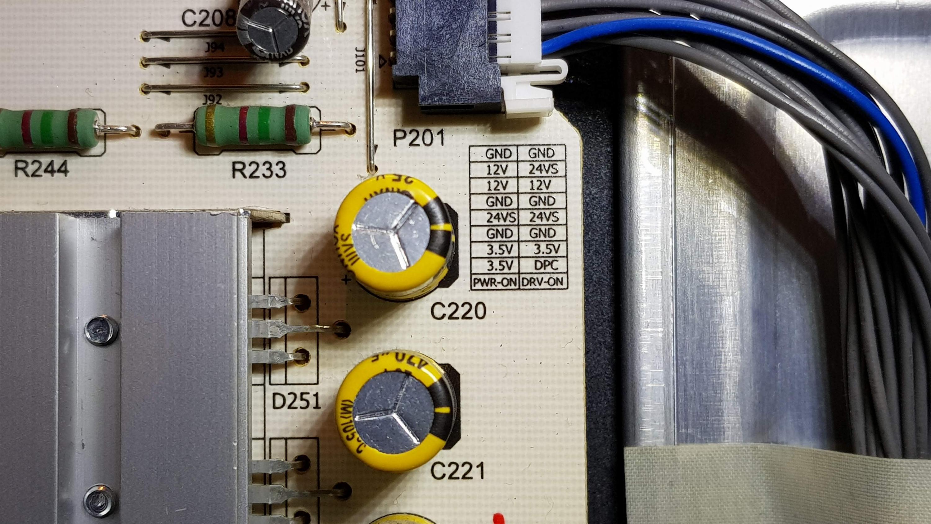

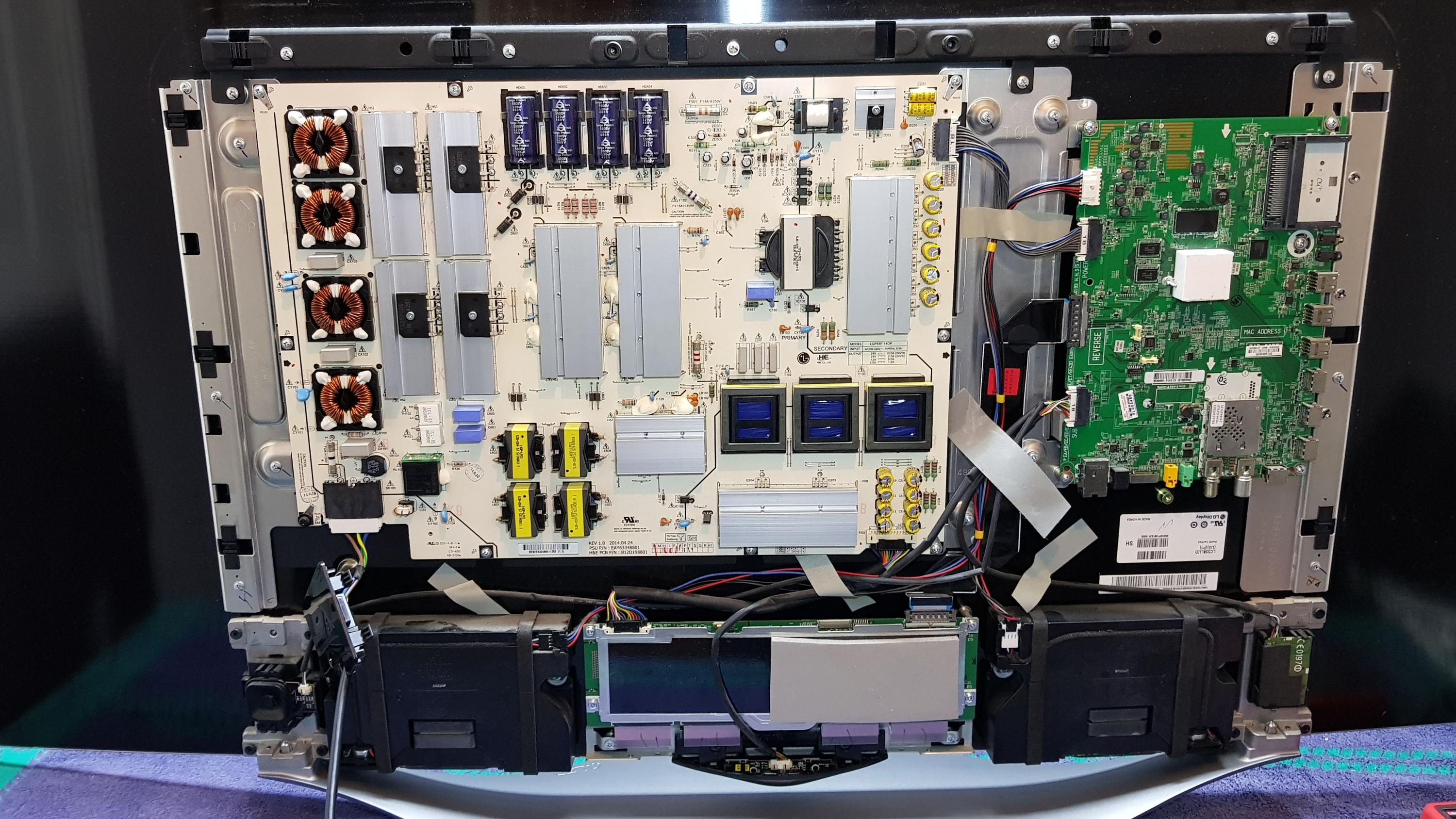

    Good evening all
    I could do with some help if you don't mind. I've pickup up a LG 55EC930V OLED curved set that clicks on with no display or sound then off after 3 seconds. The LG bezel logo is on for the 3 seconds then fades out. The previous owner said the screen went white then powered off and he assured me there was no screen damage. I have tried a replacement main board and there's no change. So, before I buy a TCON board,
    Is there a way to check that the main board isn't in some kind of lock-out mode?
    Am I right in thinking DRV-ON is the signal back from the main board and should be 3.5v?
    Can I manually apply 3.5v to DRV-ON? What should I expect?

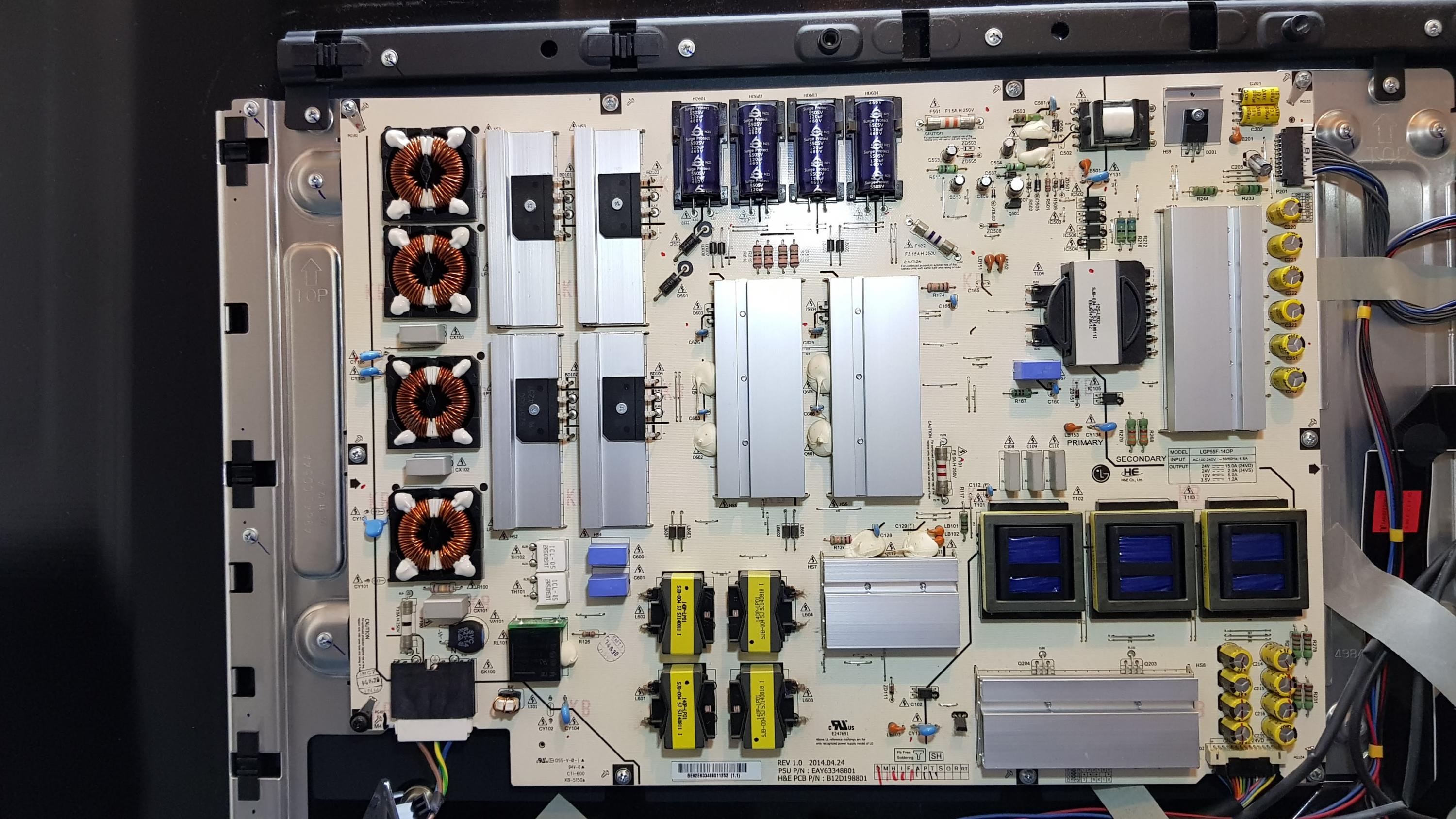

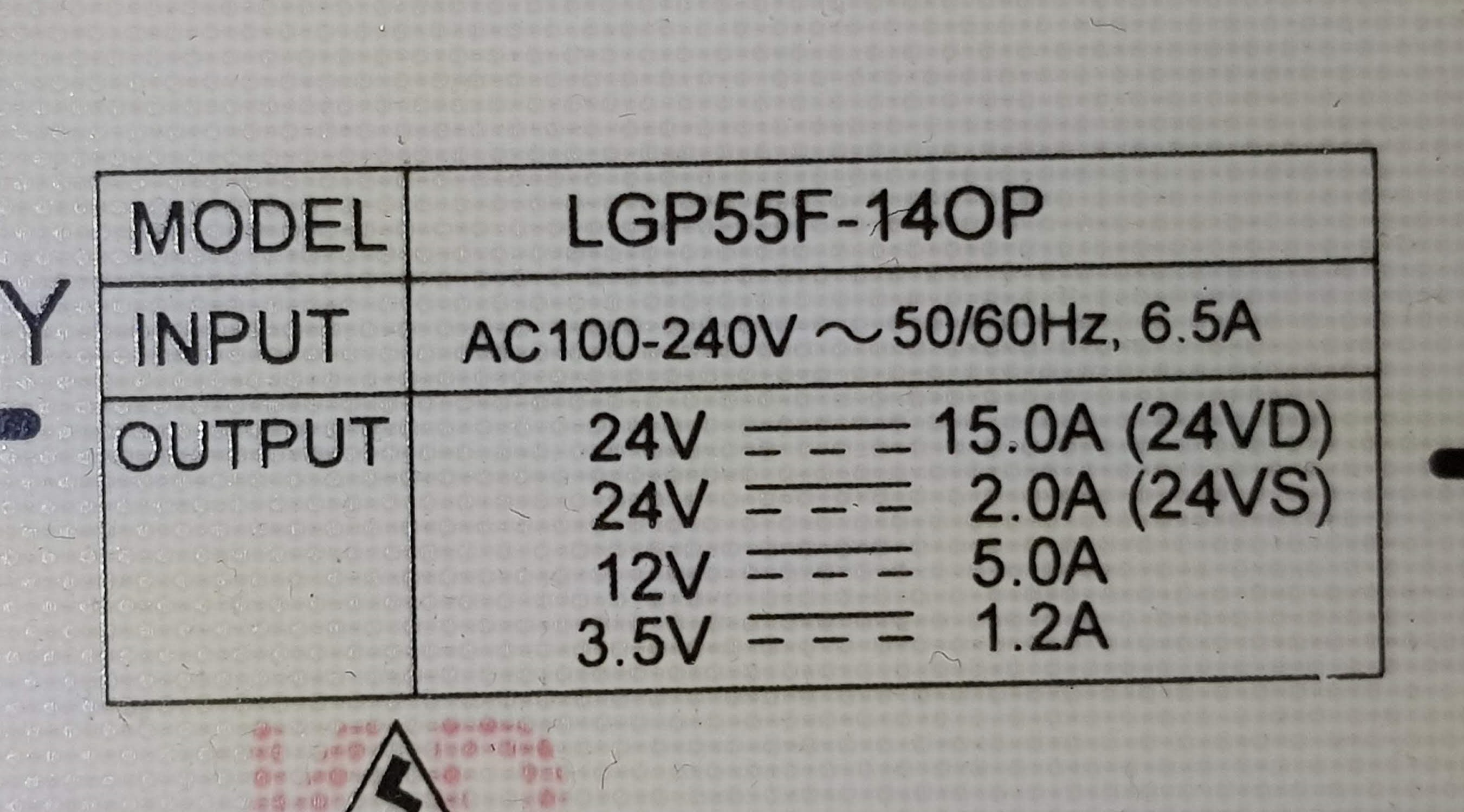

    During the 3 seconds of activity the PS is outputting the following:
    3.5v = 3.54v
    12v = 11.8v
    24v = 25v
    PWR-ON = 3.4v
    DPC = 0
    DRV-ON = 0.08v
    Thanks for your help

              Re: LG 55EC930V OLED - 3 Second Power No Display
              If you disconnect the mainboard does the backlight come on. If not then with the mainboard still disconnected use a 1K resistor and connect between 3.5V and power on and a second 1K resistor between 3.5V and DRV_ON.
              With the two resisters in place and main board disconnected, the power board stays on with all outputs steady including the 24v to the TCON. Screen remains black.
              With the main board connected, tcon receives 0v
              With the four panel ribbons disconnected from the tcon, still 0v to tcon

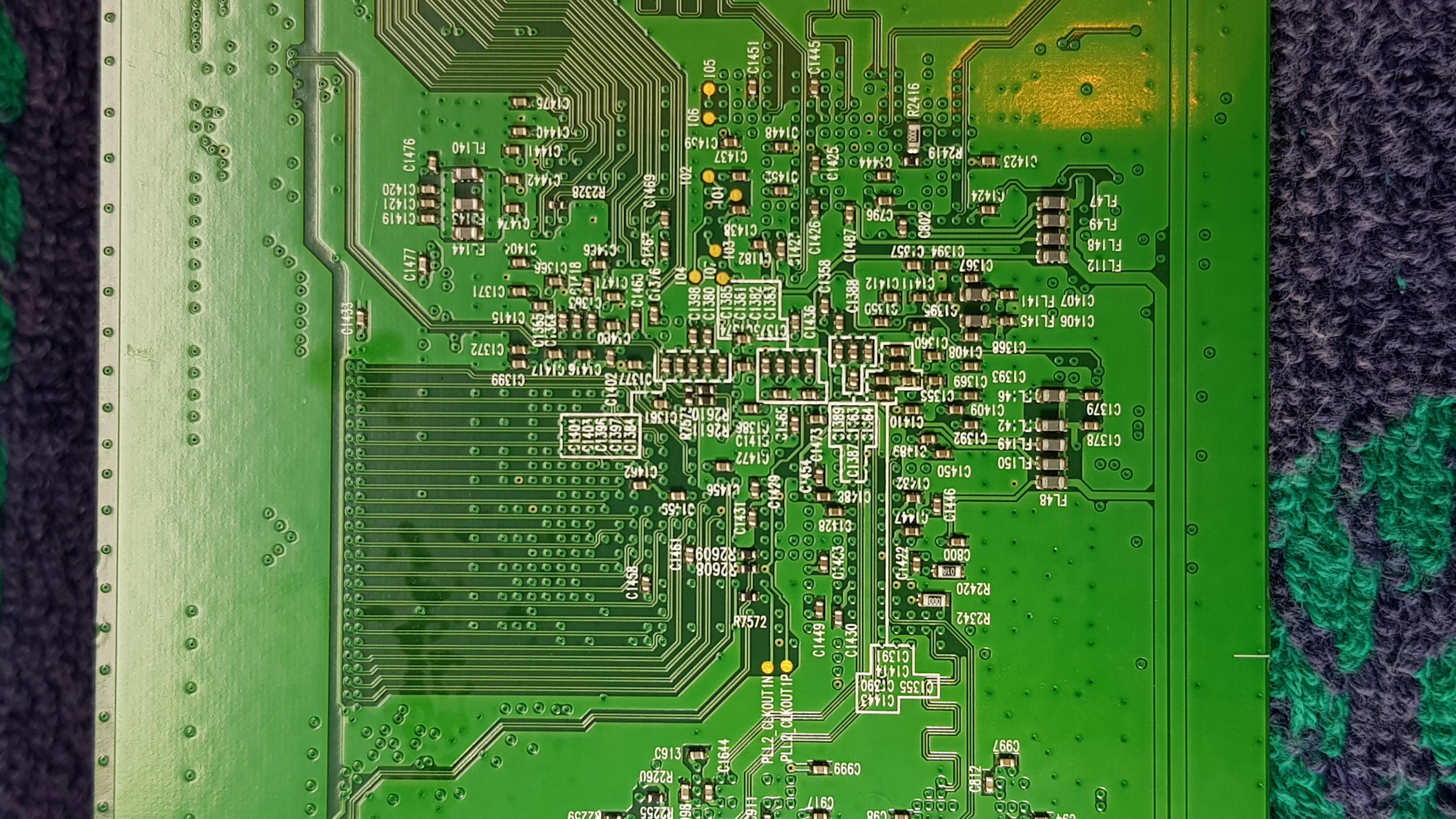

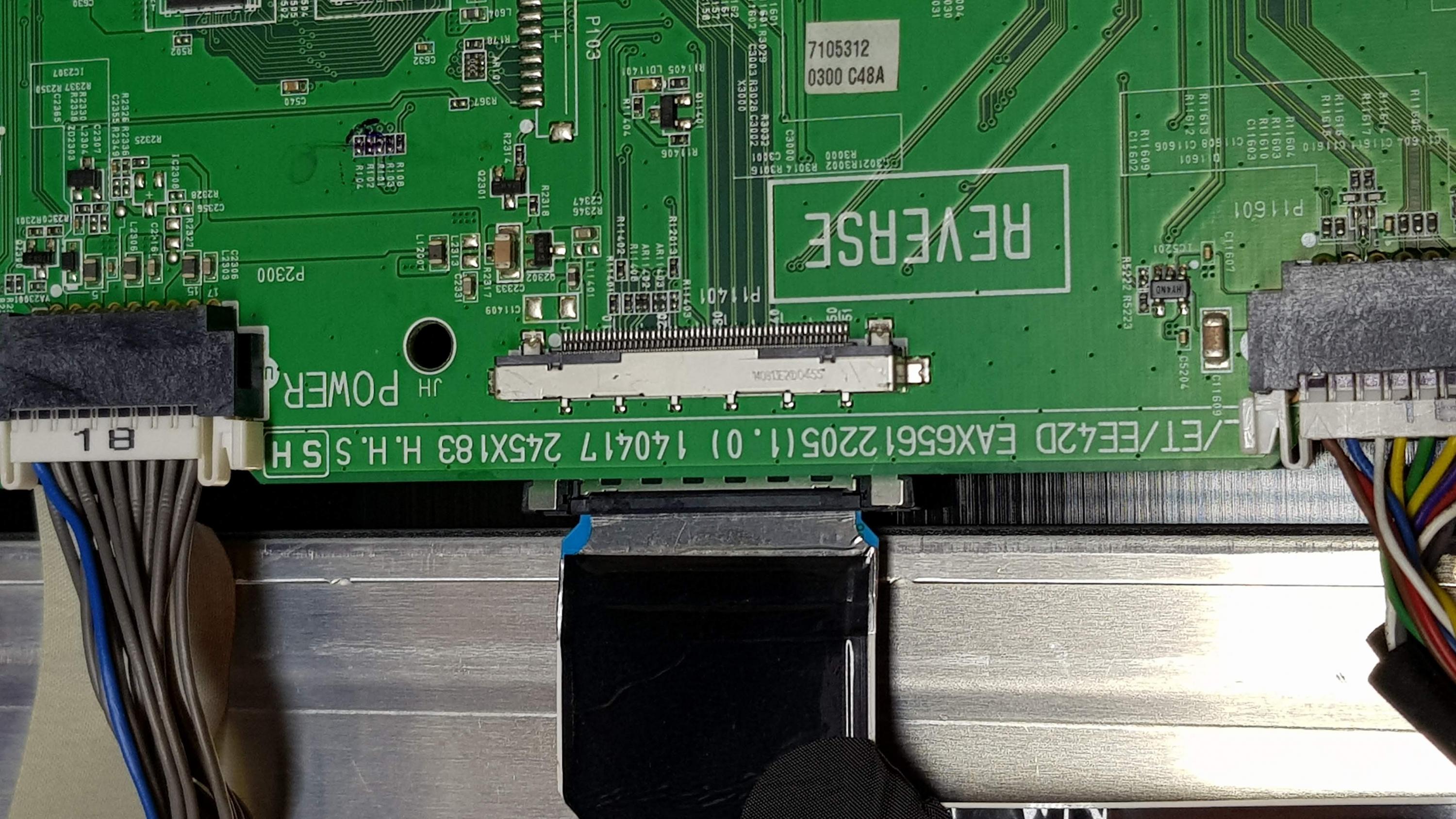

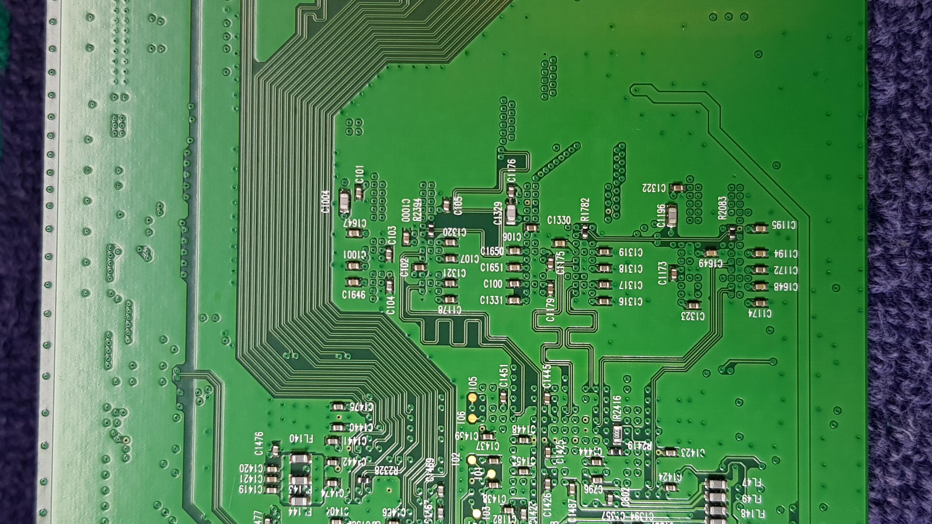

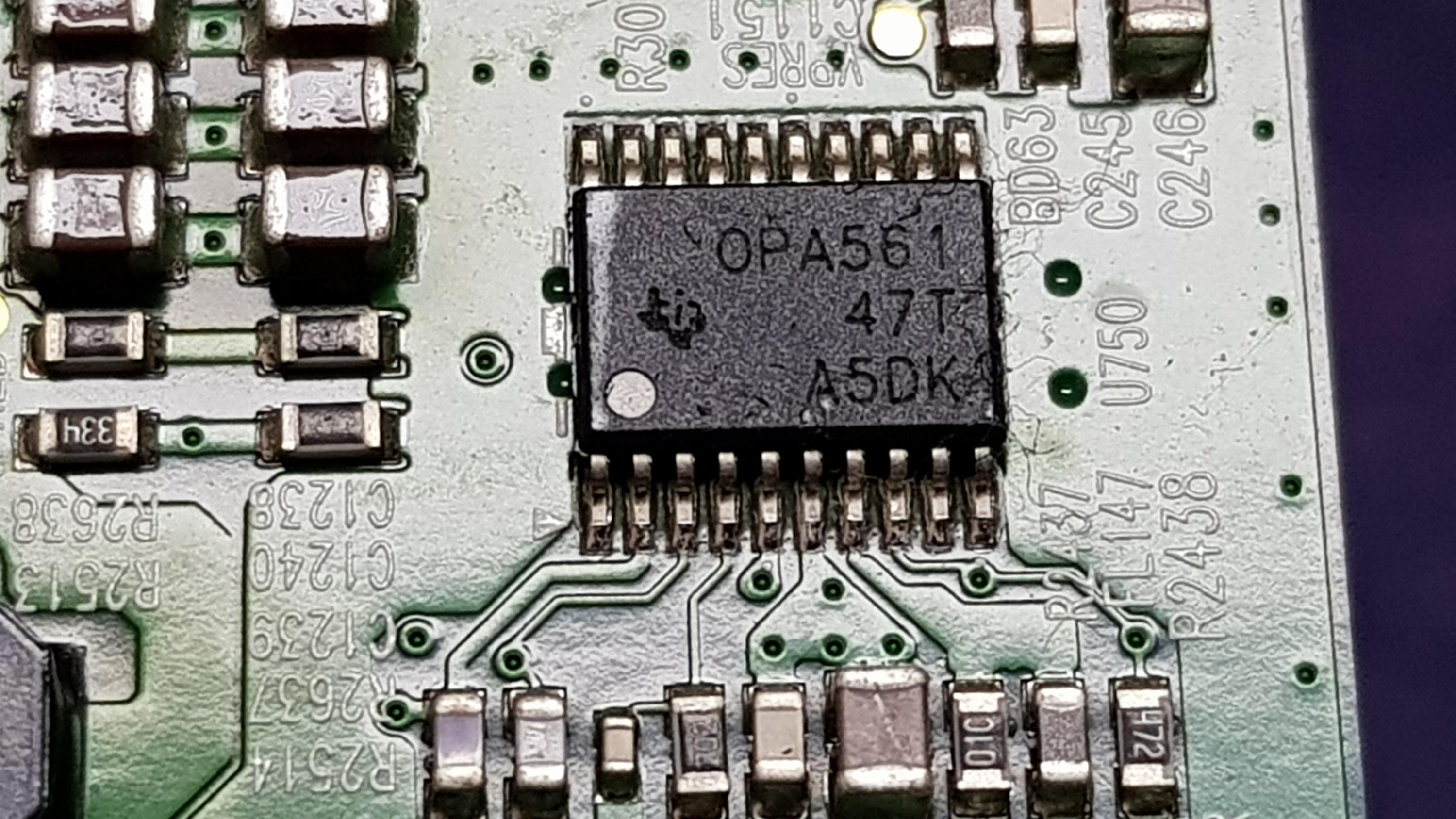

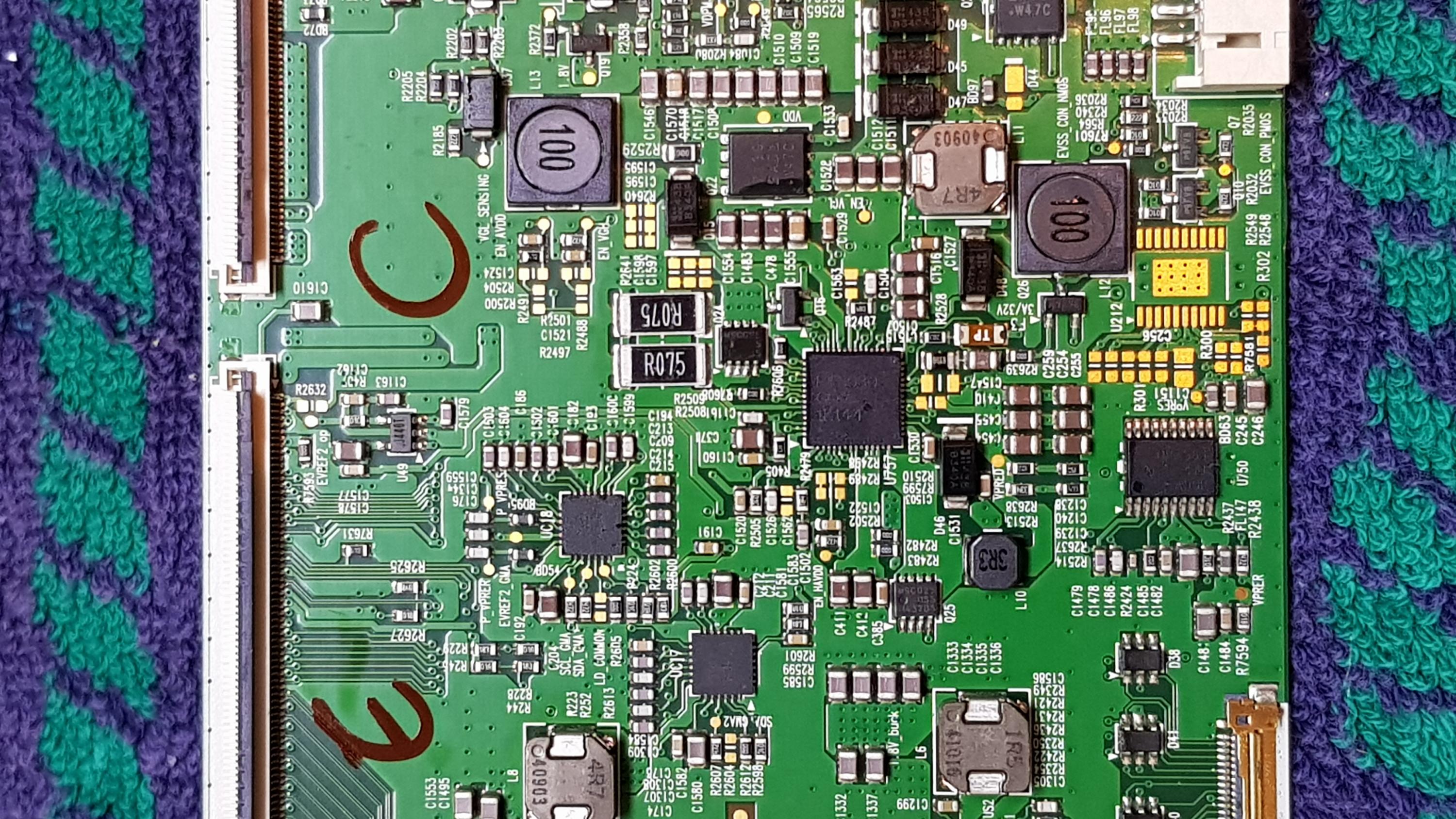

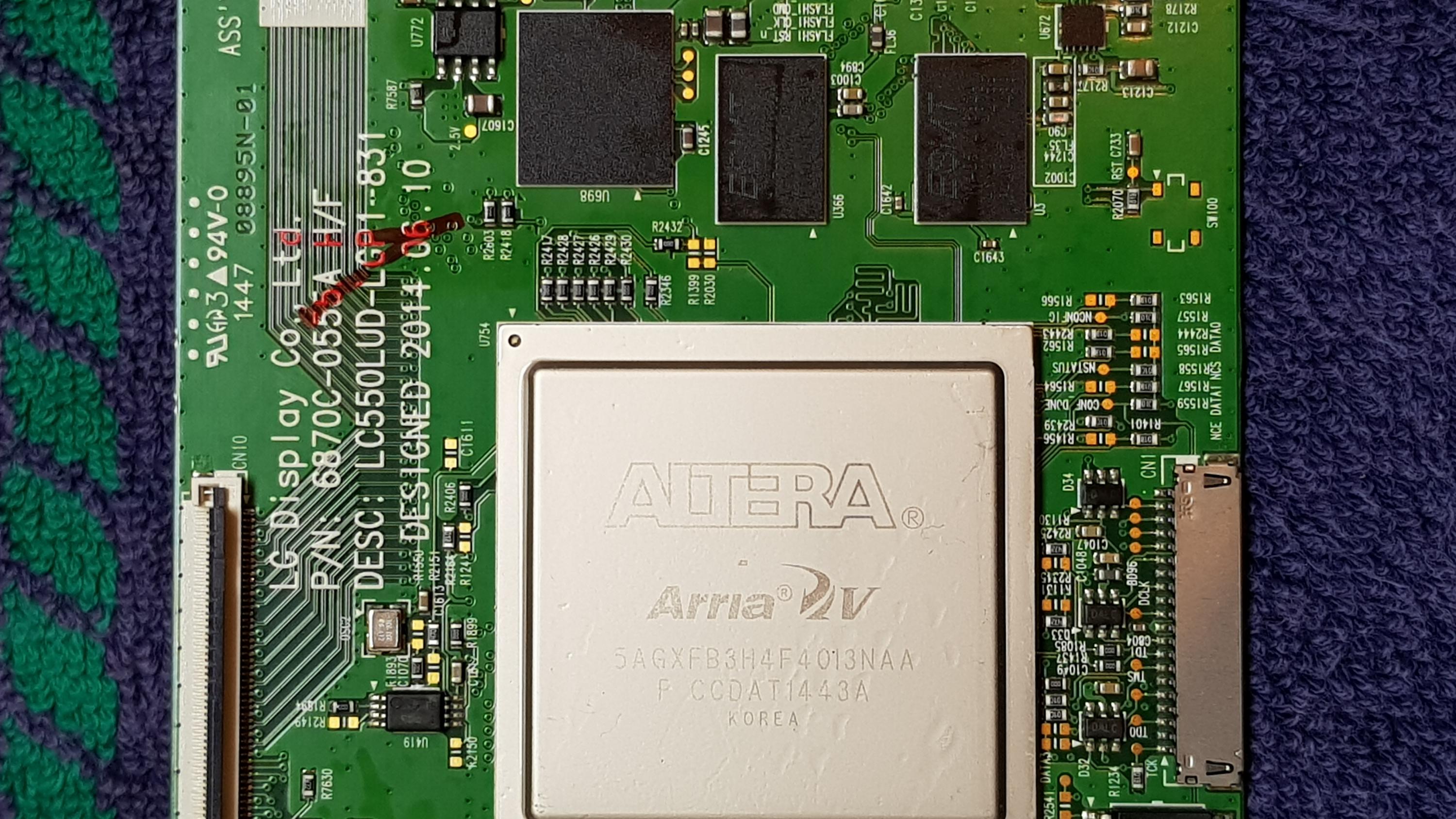

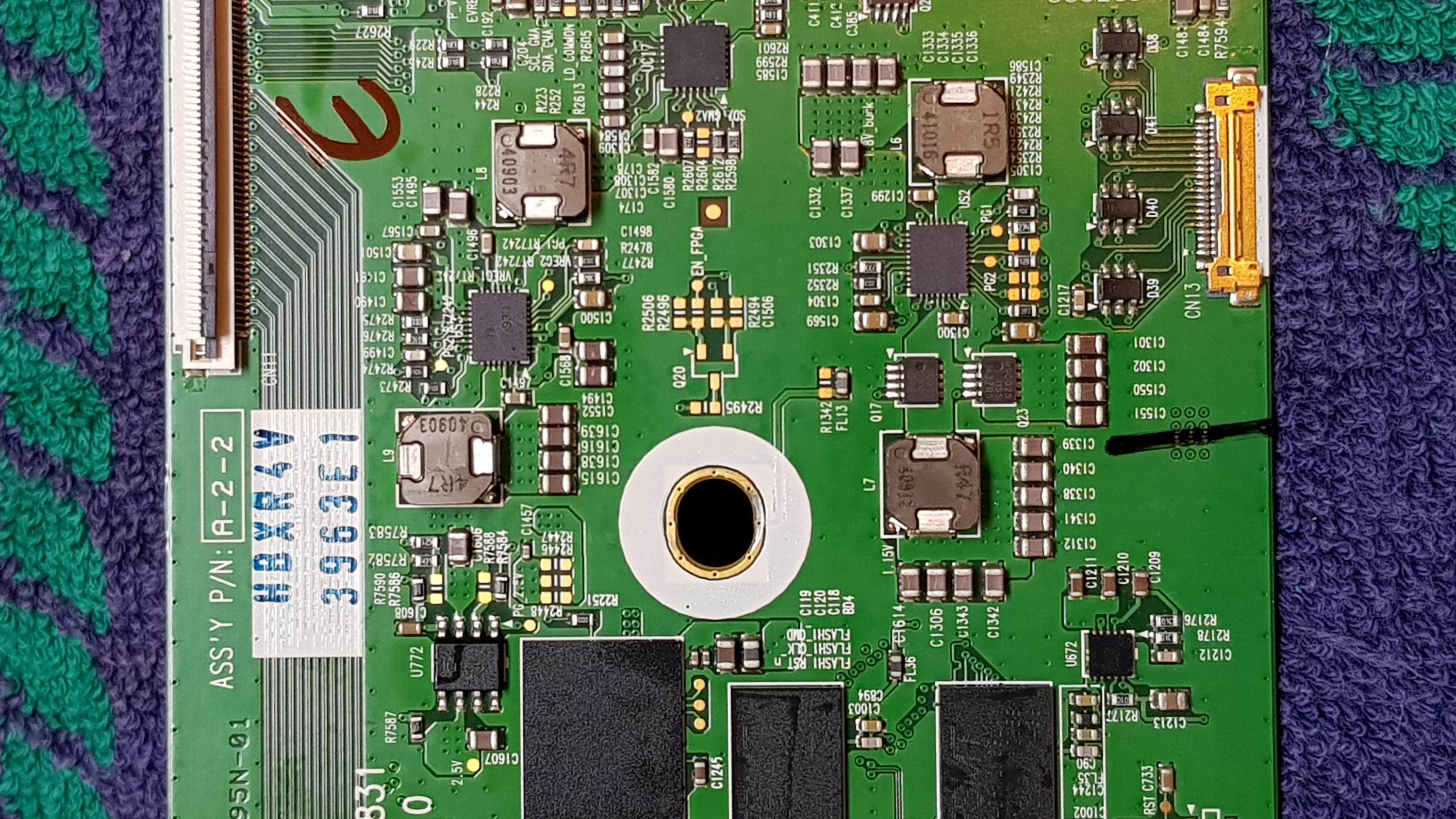

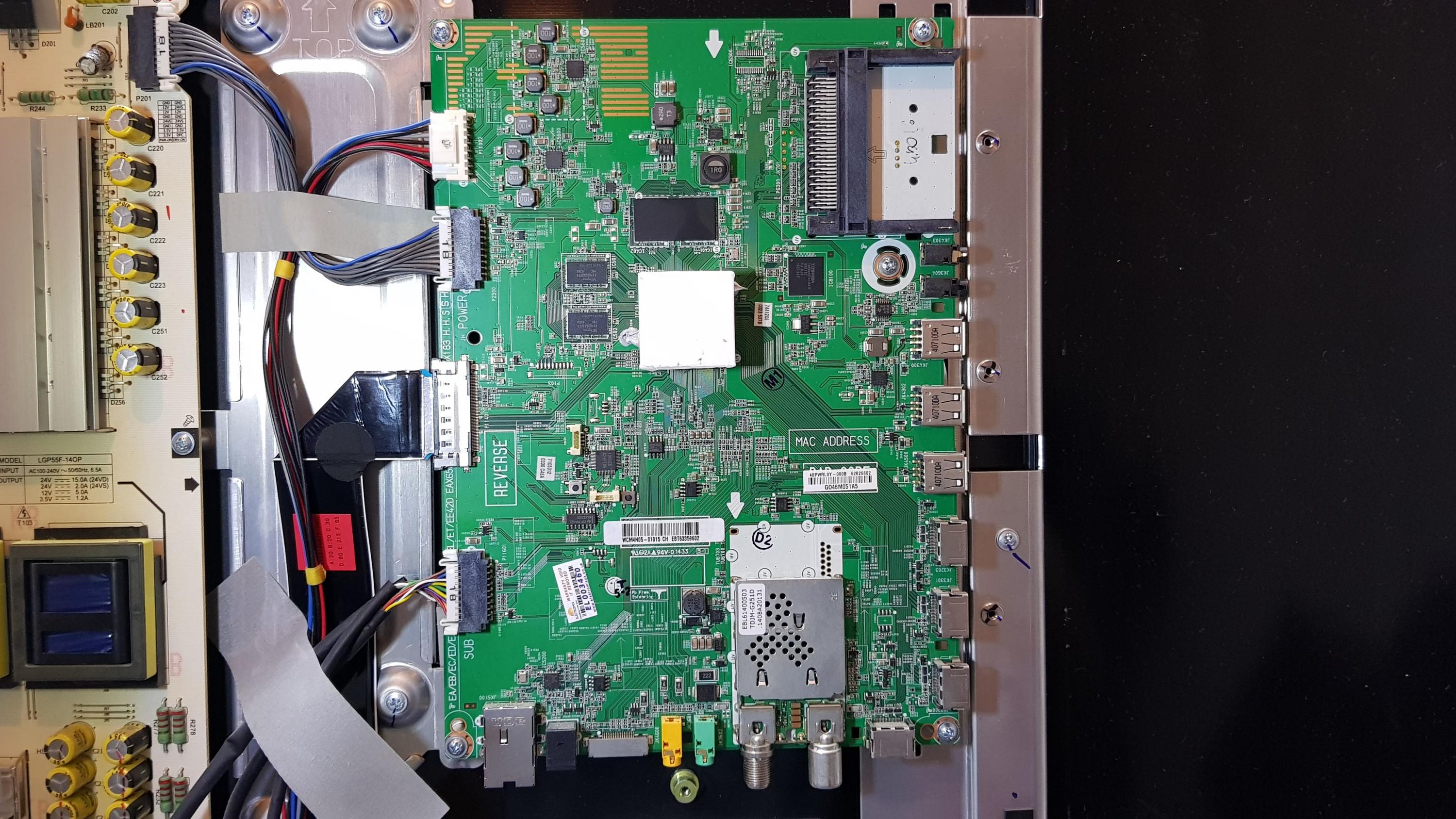

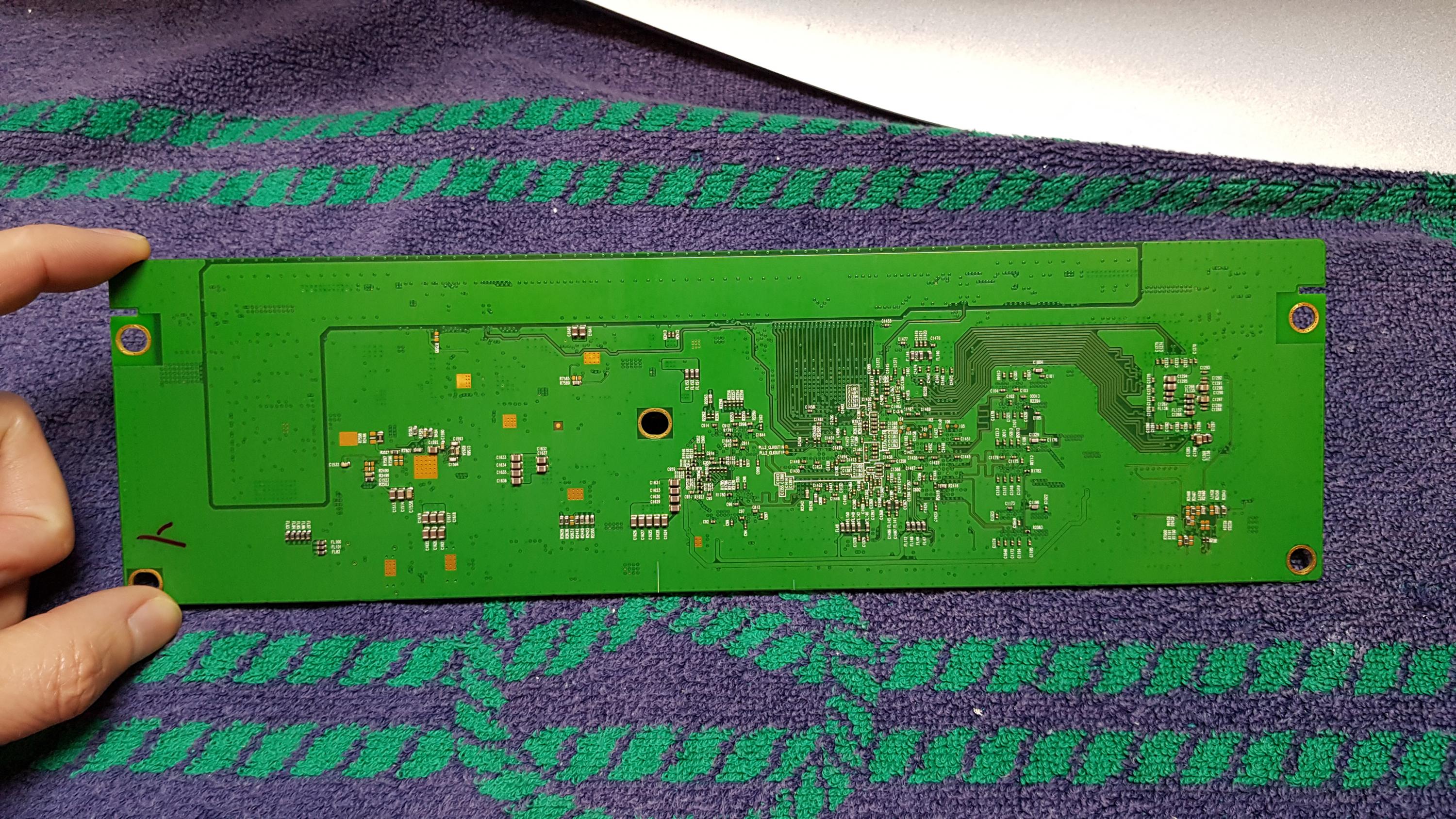

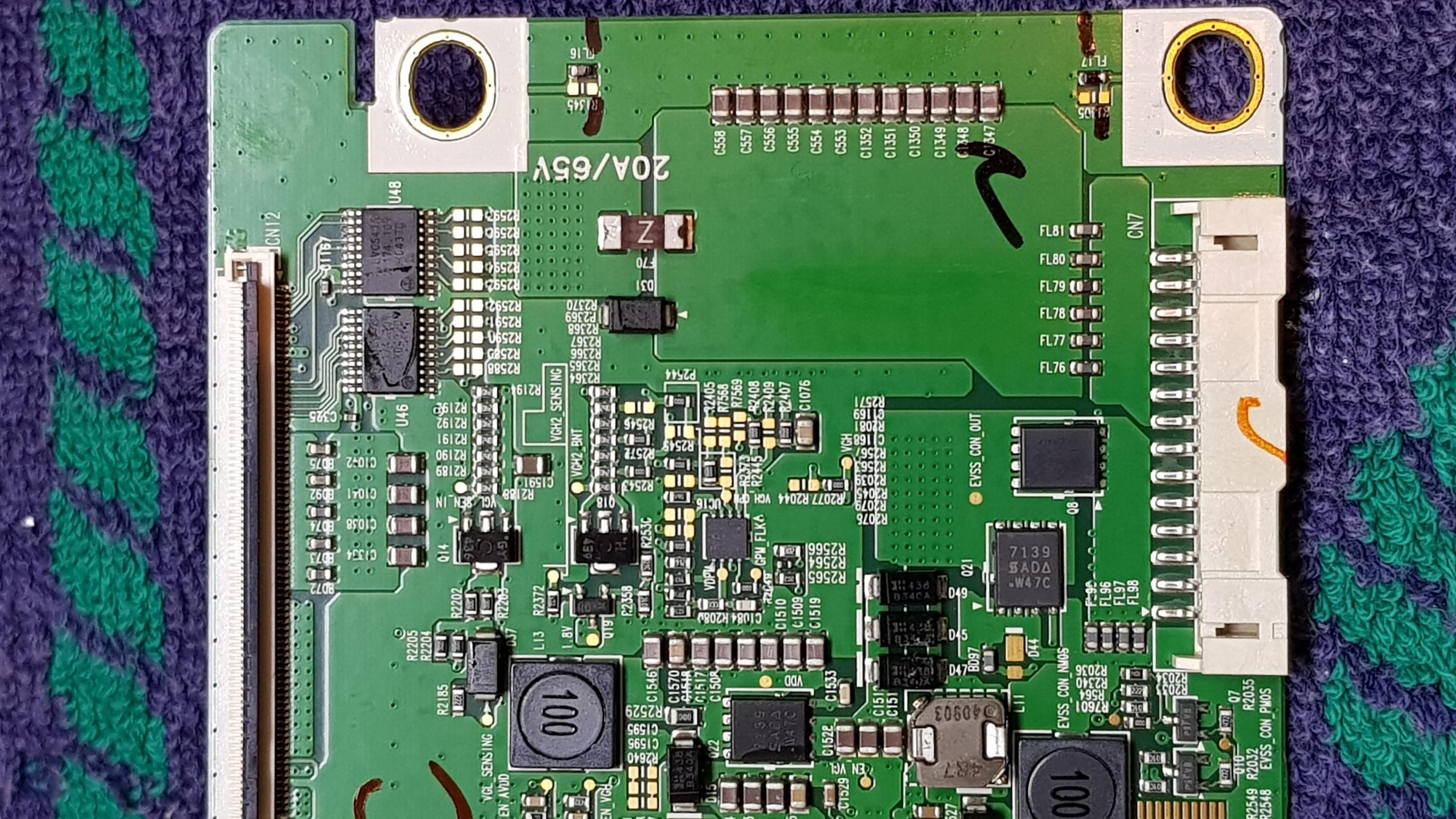

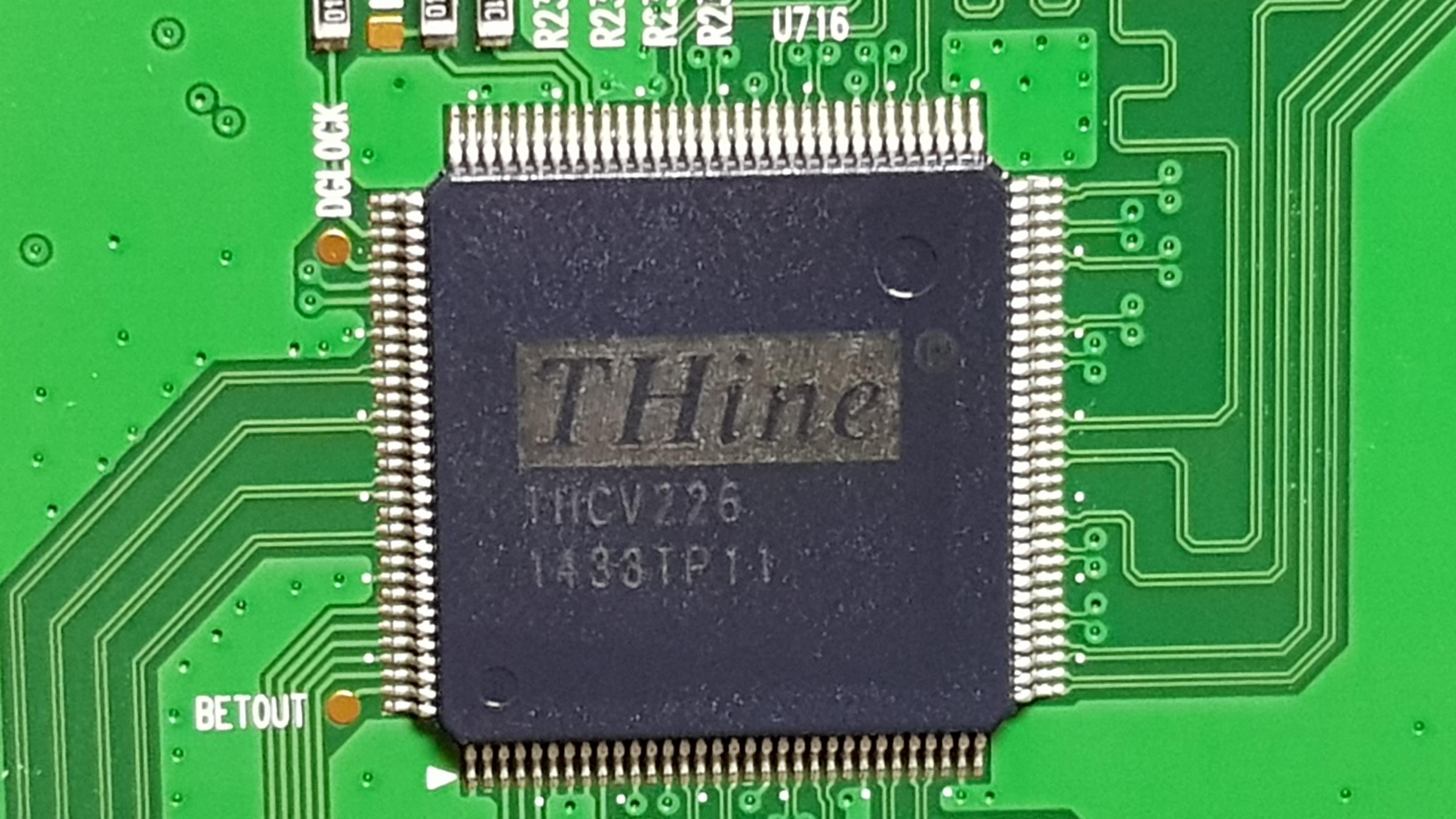

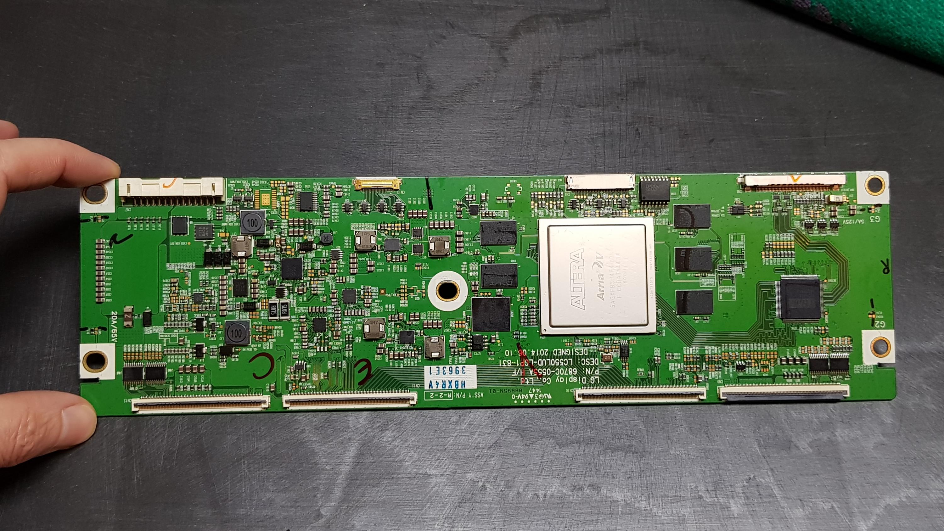

                          how about you take out the metal plate on the panel driver ( T-CON ) and post here photo
                          • Billsy
                            • Oct 2018
                            • 53
                            • United Kingdom

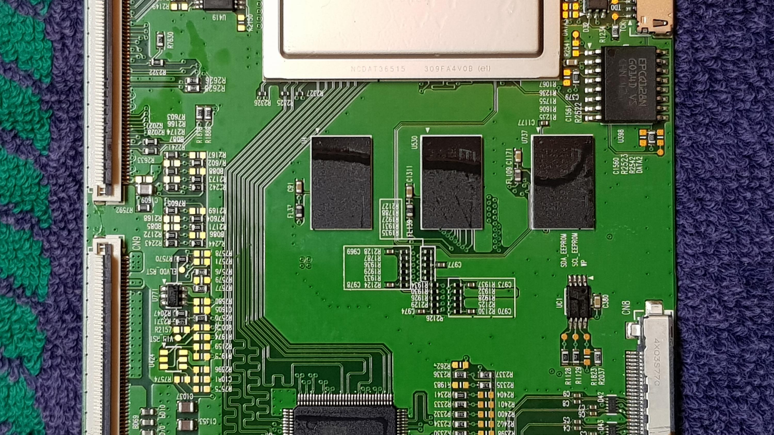

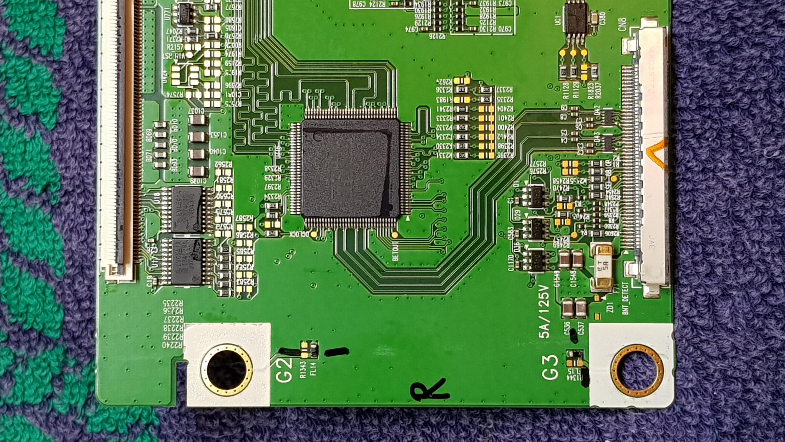

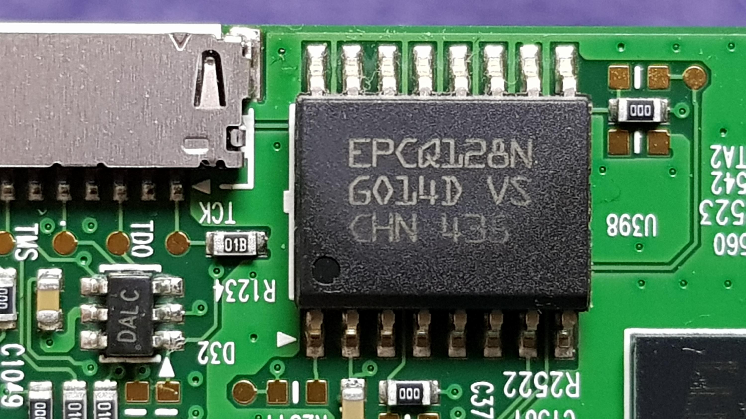

                            Rest of pics are rotated by the forum for some reason.
                            Thanks guys
                            • Billsy
                              • Oct 2018
                              • 53
                              • United Kingdom

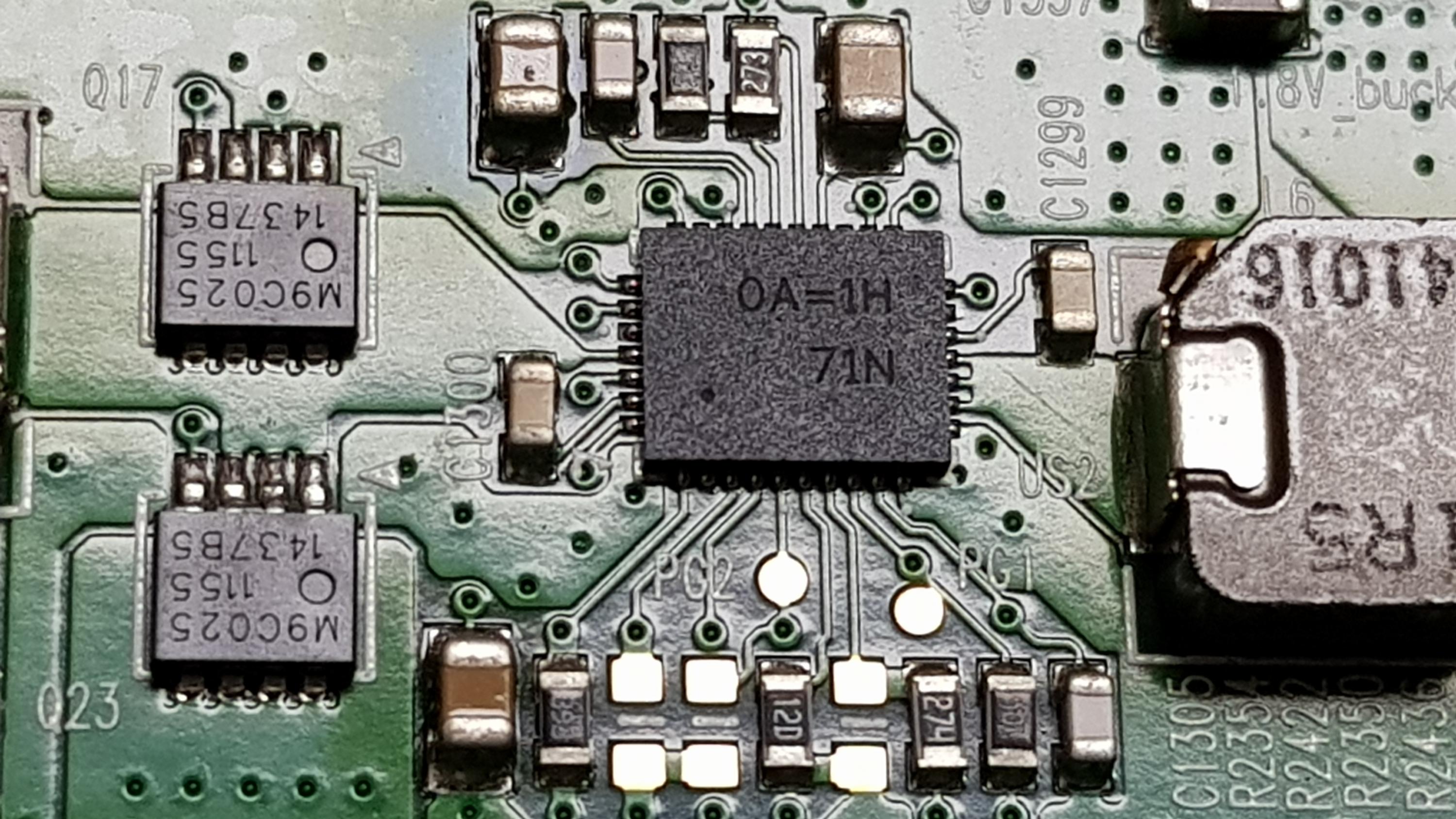

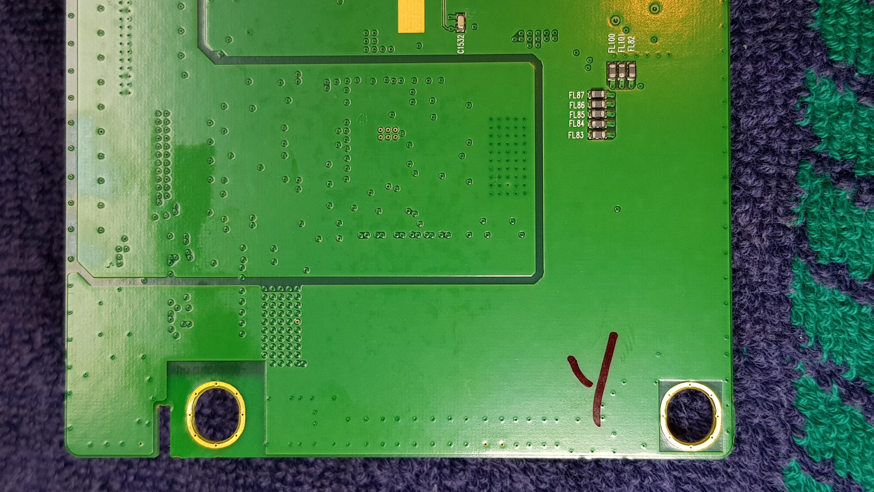

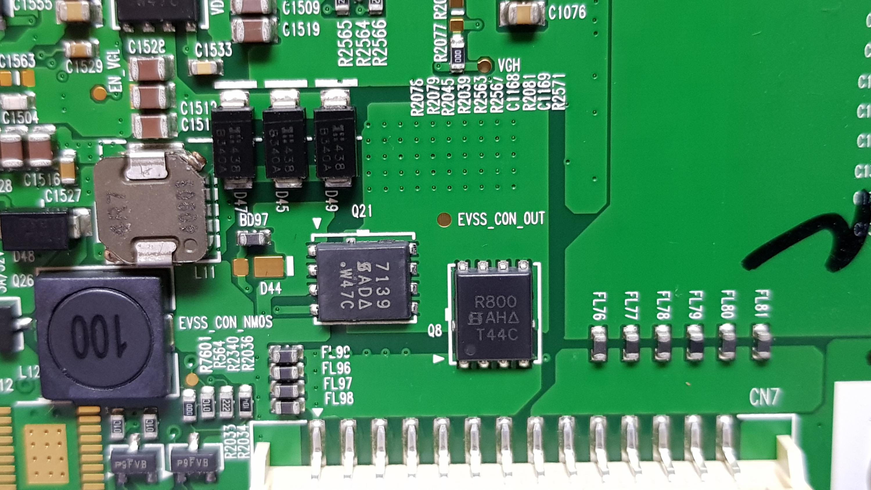

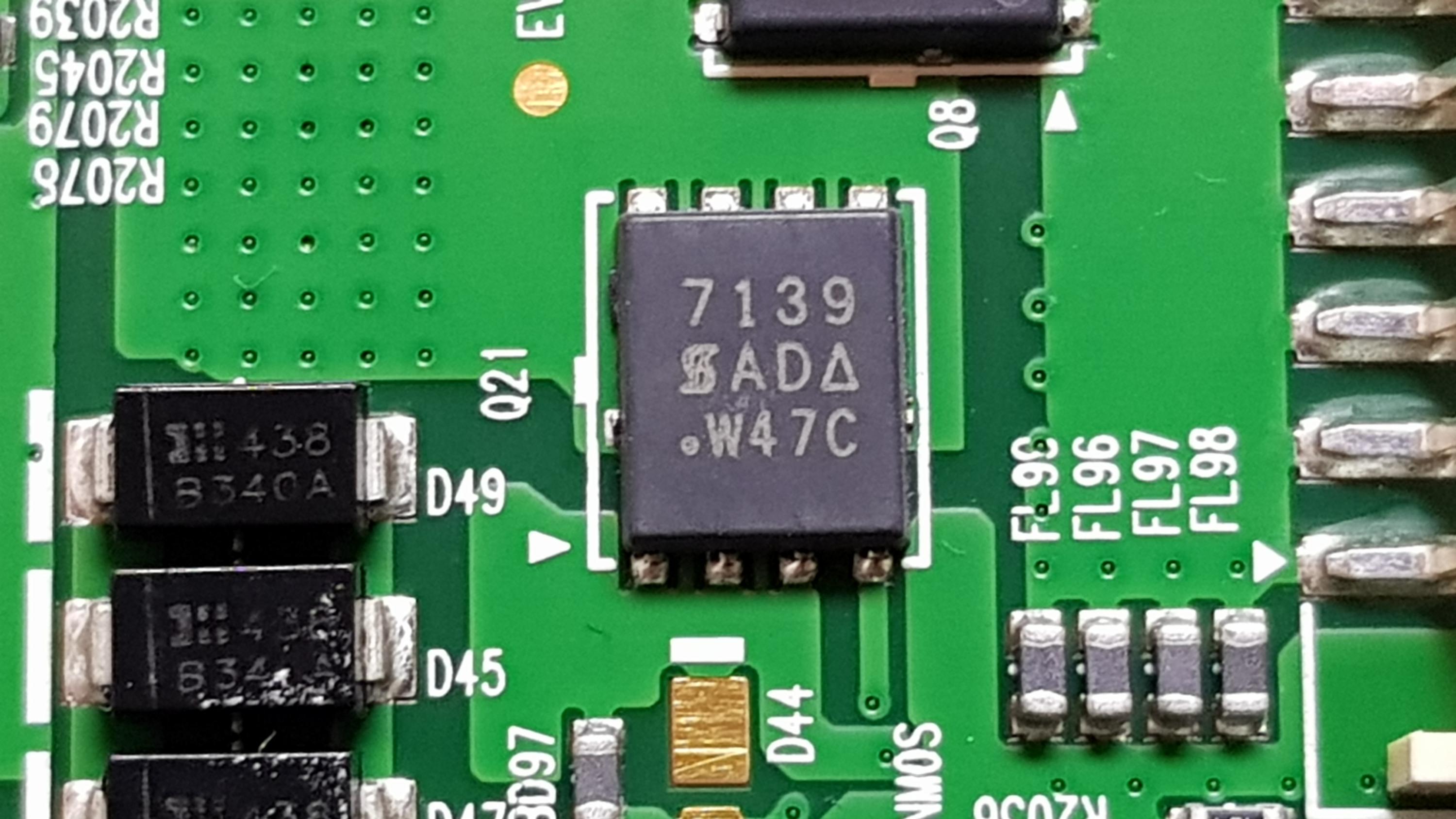

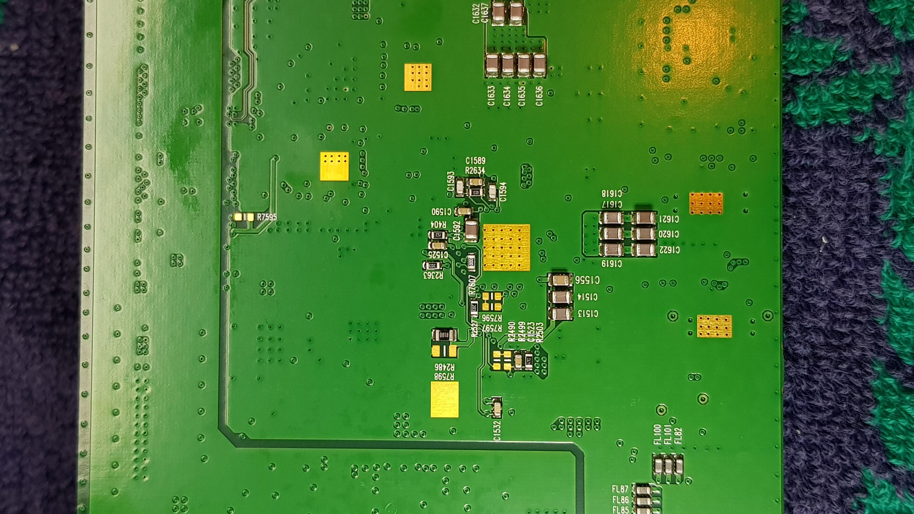

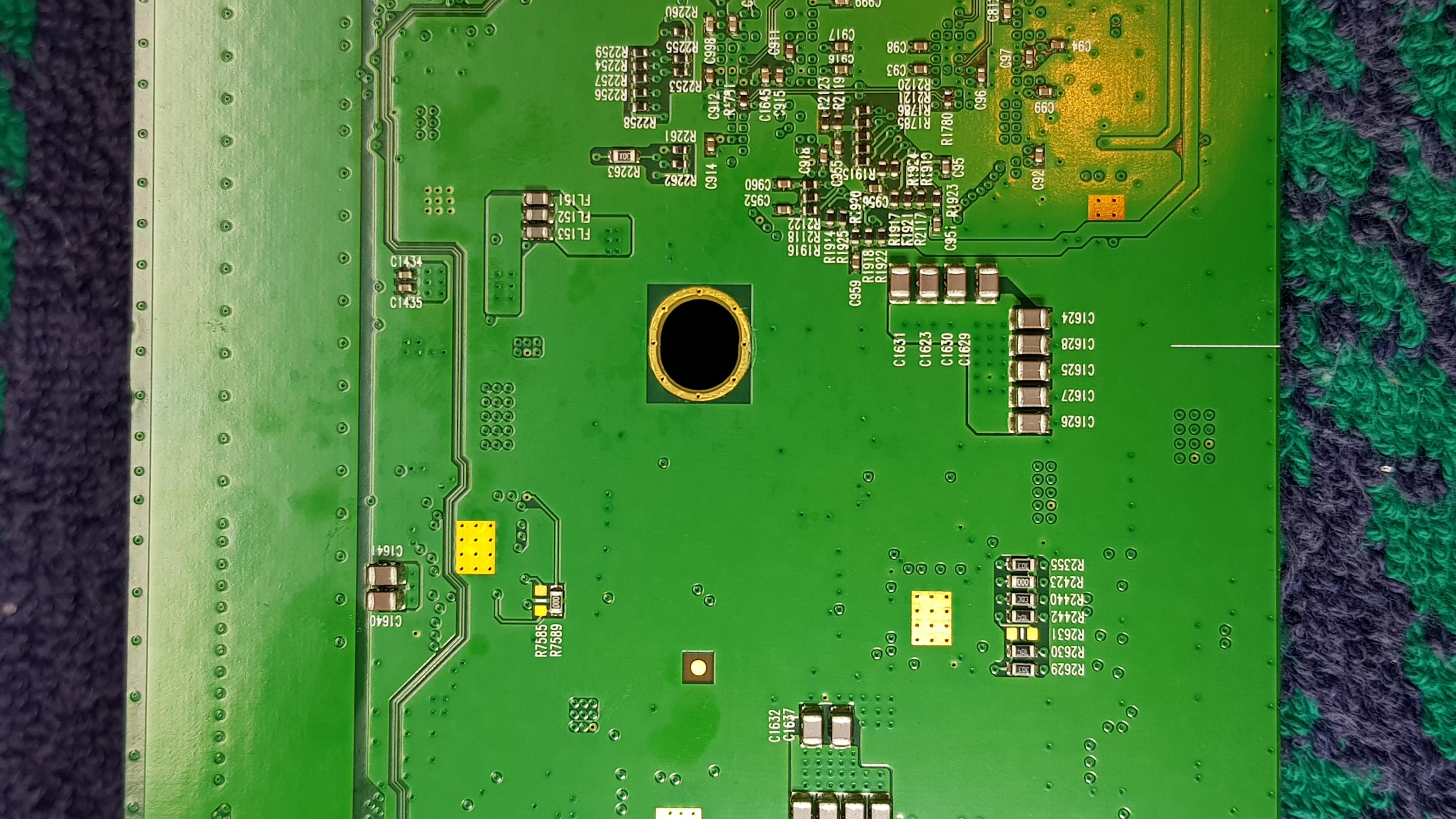

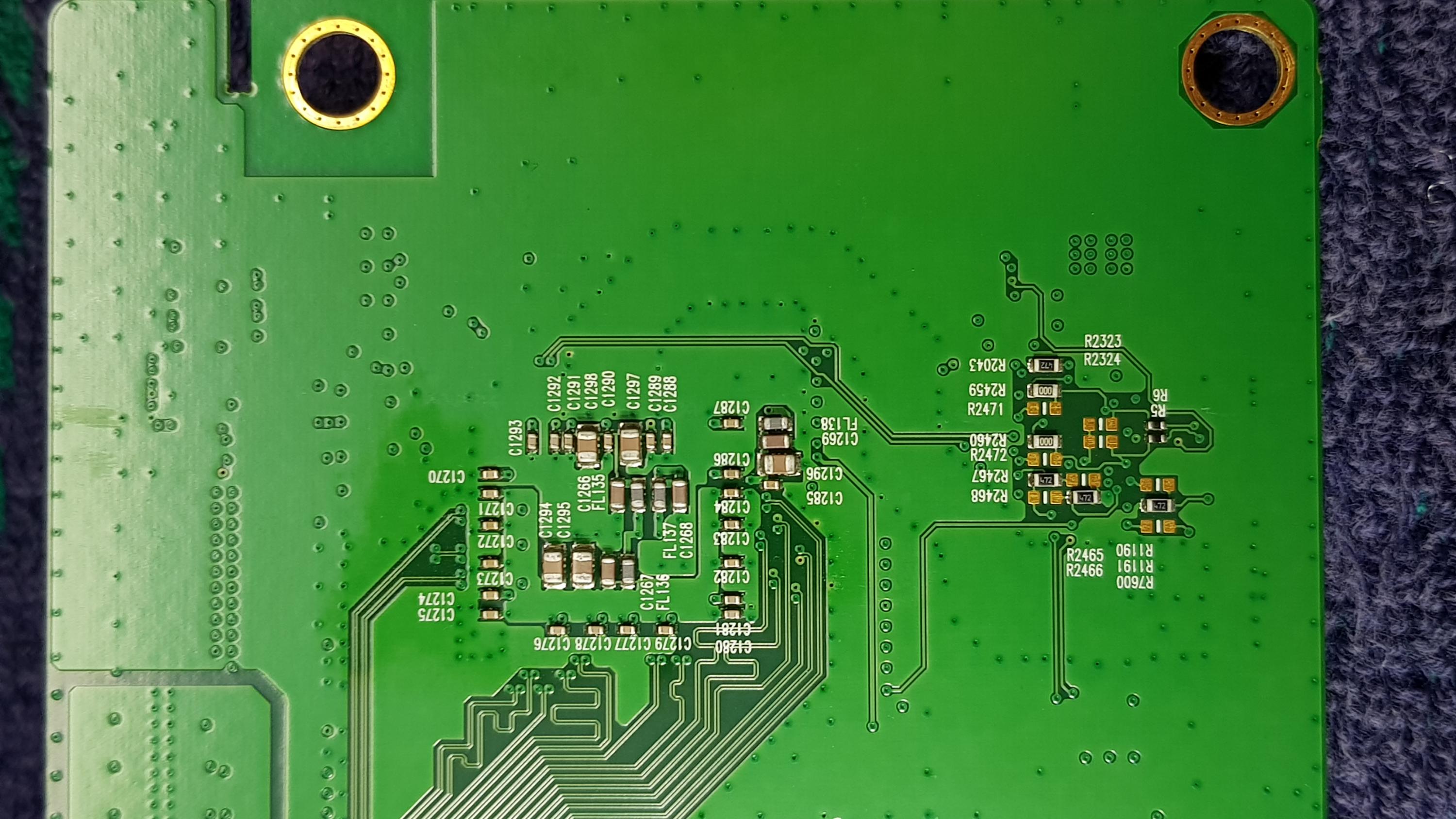

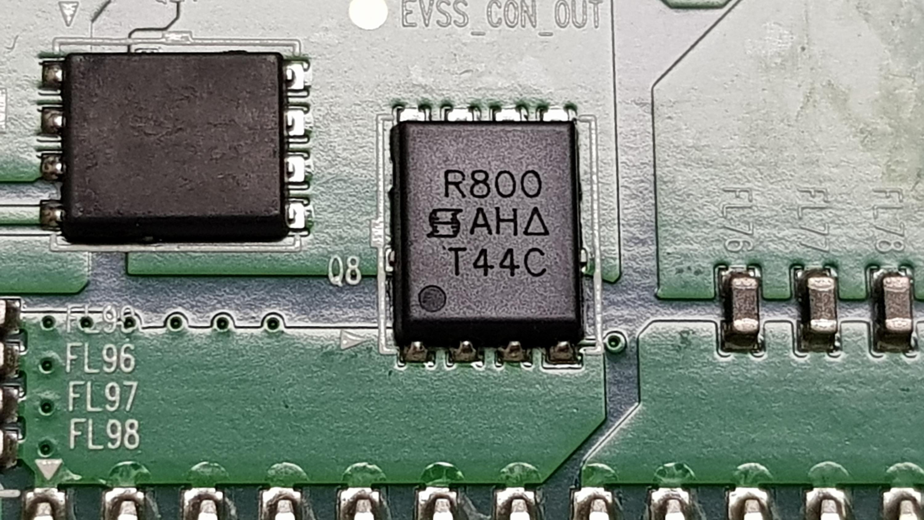

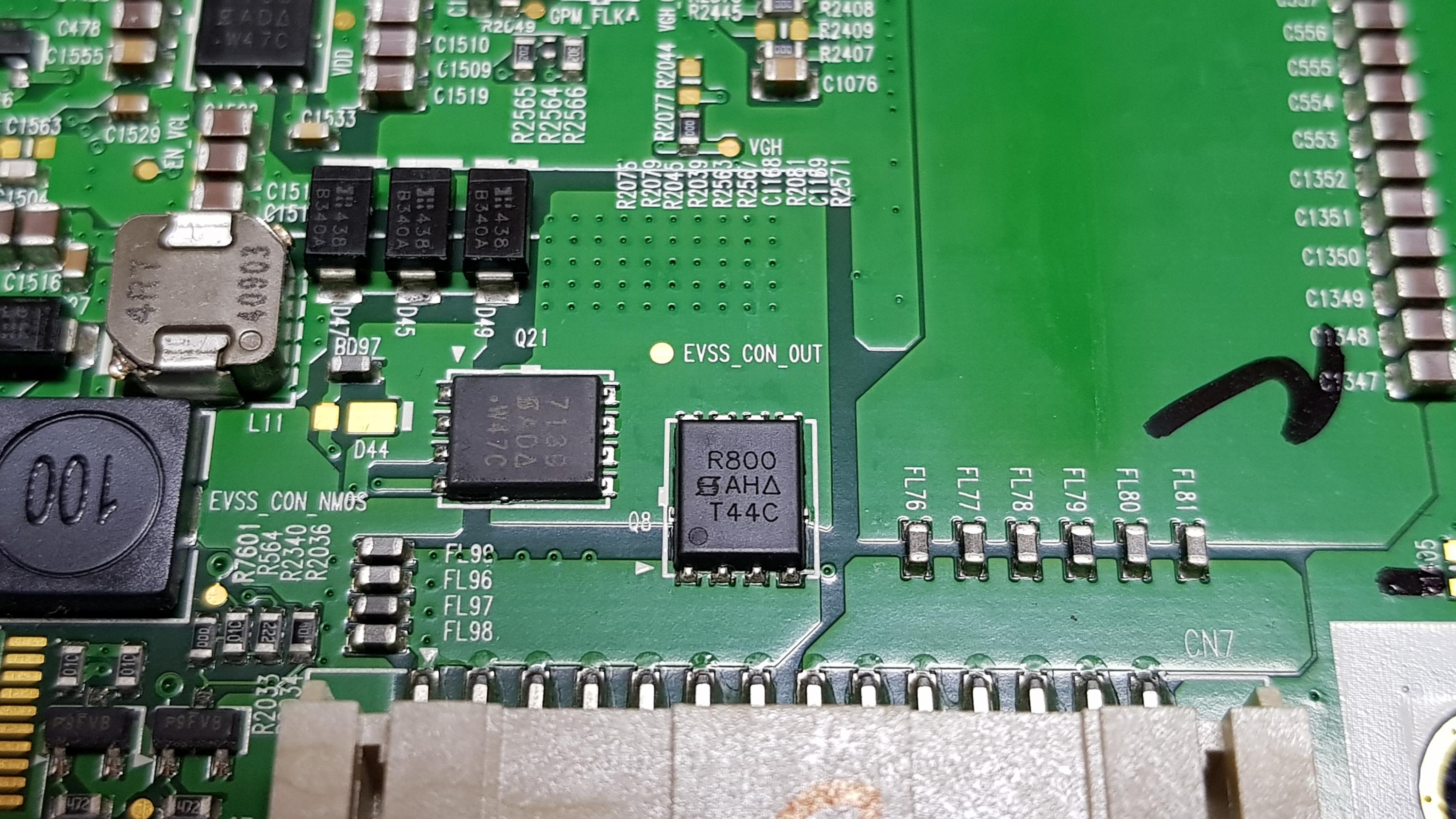

                                Could you take a picture of the bottom side of the board? Curious about something.
                                • Diah
                                  • Feb 2013
                                  • 6427

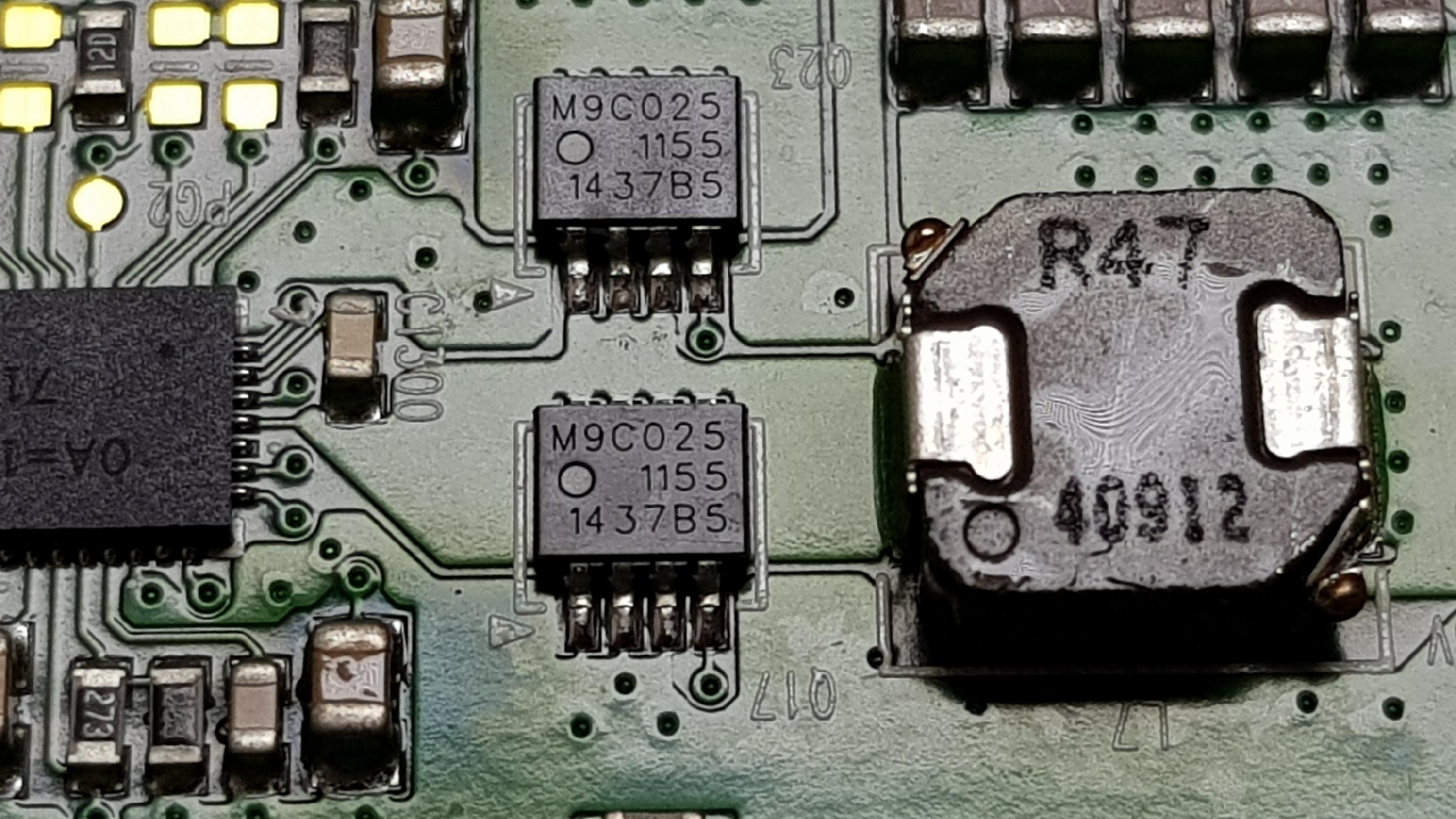

                                  EVSS_CON_ out driver IC burned
                                  • Billsy
                                    • Oct 2018
                                    • 53
                                    • United Kingdom
                                    Here's the back side
                                    • Diah
                                      • Feb 2013
                                      • 6427
                                      if i am i will change this board.
                                      • Billsy
                                        • Oct 2018
                                        • 53
                                        • United Kingdom
                                        Evss_con_ out
                                        From different angle
