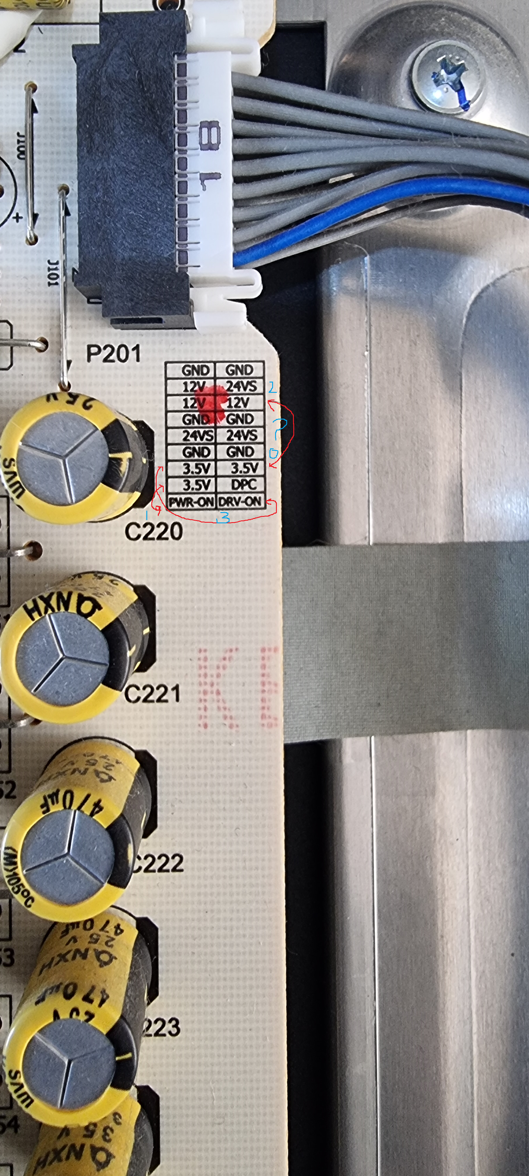

              Diah, when I ran TEST 2 according to the document, the relay on the SMPS began and continued clicking aggressively, is the to be expect?
              I stopped at this stage and unplugged the AC as I am wondering if I jumped the wrong points. Please see the attached image for where I created a jumper for test two (3.5 to 12v)
              FYI Test 1 was successful.

                of course wrong
                1- main boards should be disconnected from power boards
                2- 2 LVDS between mainboards and T-CON driver should be disconnected
                jumpers
                3.5V to Power on
                3.5V to DRV_ON
                you should have on the same socket 12 V & round 24V
                also you need to have round 24V on T-CON EVDD.... and 12V on the T-con 12V... if there are no 12V on t-con you need to fed it with 12V from the sockts to F1 fuse of 12V rail... the screen will turn on and could see if there are issue with OLED cells

                  Okay so progress. I've made the correct jumper connections on the SMPS ant all voltages on the connector (12, 3.5, 24) are present where they should according to the key on the SMPS board. There is 24volts goin to the T-con from the SMPS via the connector joining them. I also found this 24v on the T-con at F70 (next to the connector to SMPS). To get a panel test display should I now be sending 12V to F71 (another fuse next to the T-con to Mainboad connector)? I've attached the service manual for my model if it helps. I also had some more photos of the T-con.

                    yes fed the 12V to Fuse close to LVDS cable... don't forget main boards should be disconnected from PSU and the LVDS disconnected from T-CON side

                      Thanks, connector between PSU and MB disconnected on MB end and jumpers inserted. LVDS to T-CON from MB also disconnected. 12V applied to F71 (fuse on T-CON at LVDS connector) No Panel bars, so I'm guessing possible T-Con issue

                        Did the test again, there is actually a 1 vertical bar down the center of the screen--T-con or module, I guess?

                            My bet is tcon, get one from working set , screen broken in pieces..
