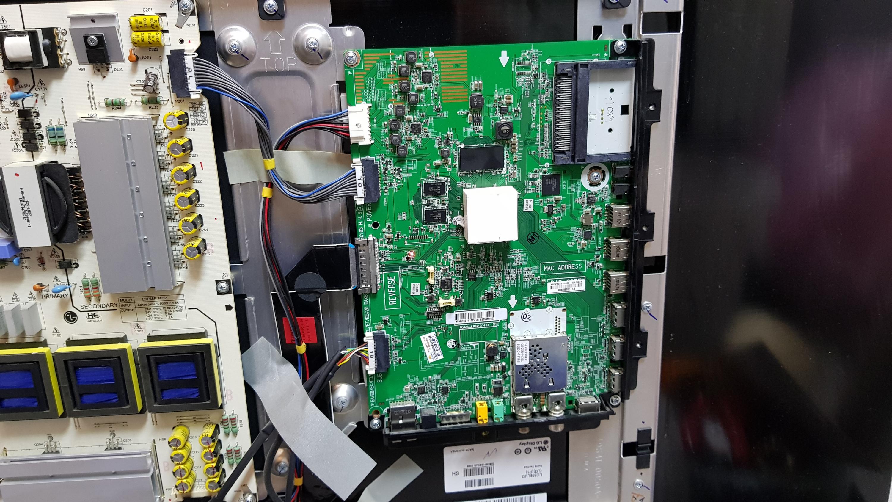

      Re: LG 55EC930V OLED - 3 Second Power No Display
      Originally posted by Diah
      if i am i will change this board.
      Yeah maybe I'll look out for a replacement board.
      • Billsy
        • Oct 2018
        • 53
        • United Kingdom
        I just got an identical set for £80 on ebay with a broken screen. This should be fun!
        • Billsy
          • Oct 2018
          • 53
          • United Kingdom
          Ok so I pulled the tcon from the cracked set, loaded it into the other set and no change.

                • Billsy
                  • Oct 2018
                  • 53
                  • United Kingdom
                  Ahh I see. Yes after initiating power only mode the power will stay on and if I unplug then plug in, it will power again.
                  Trouble is, I can't get any further than the partial dim screen. It doesn't respond to any remote comands

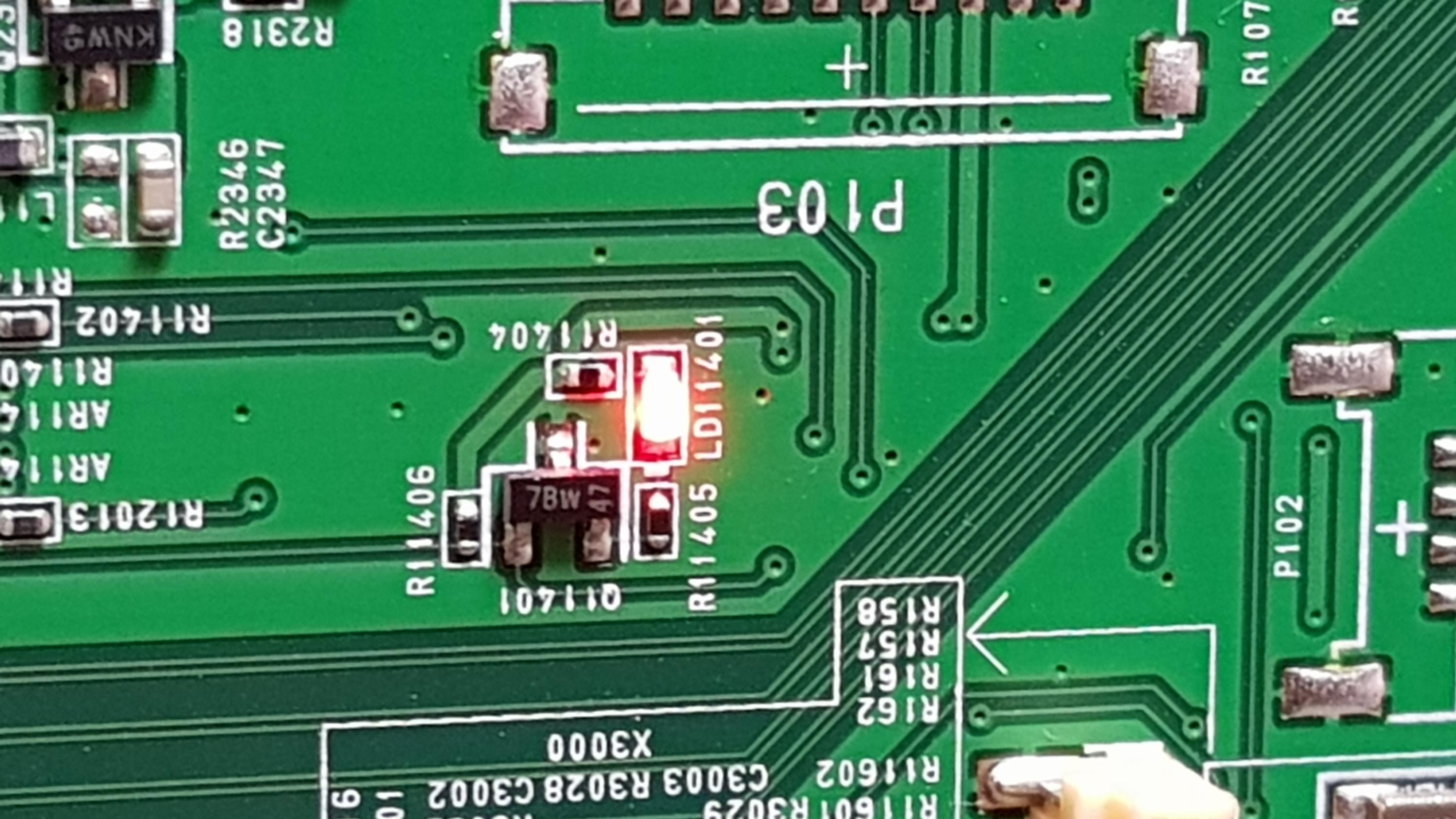

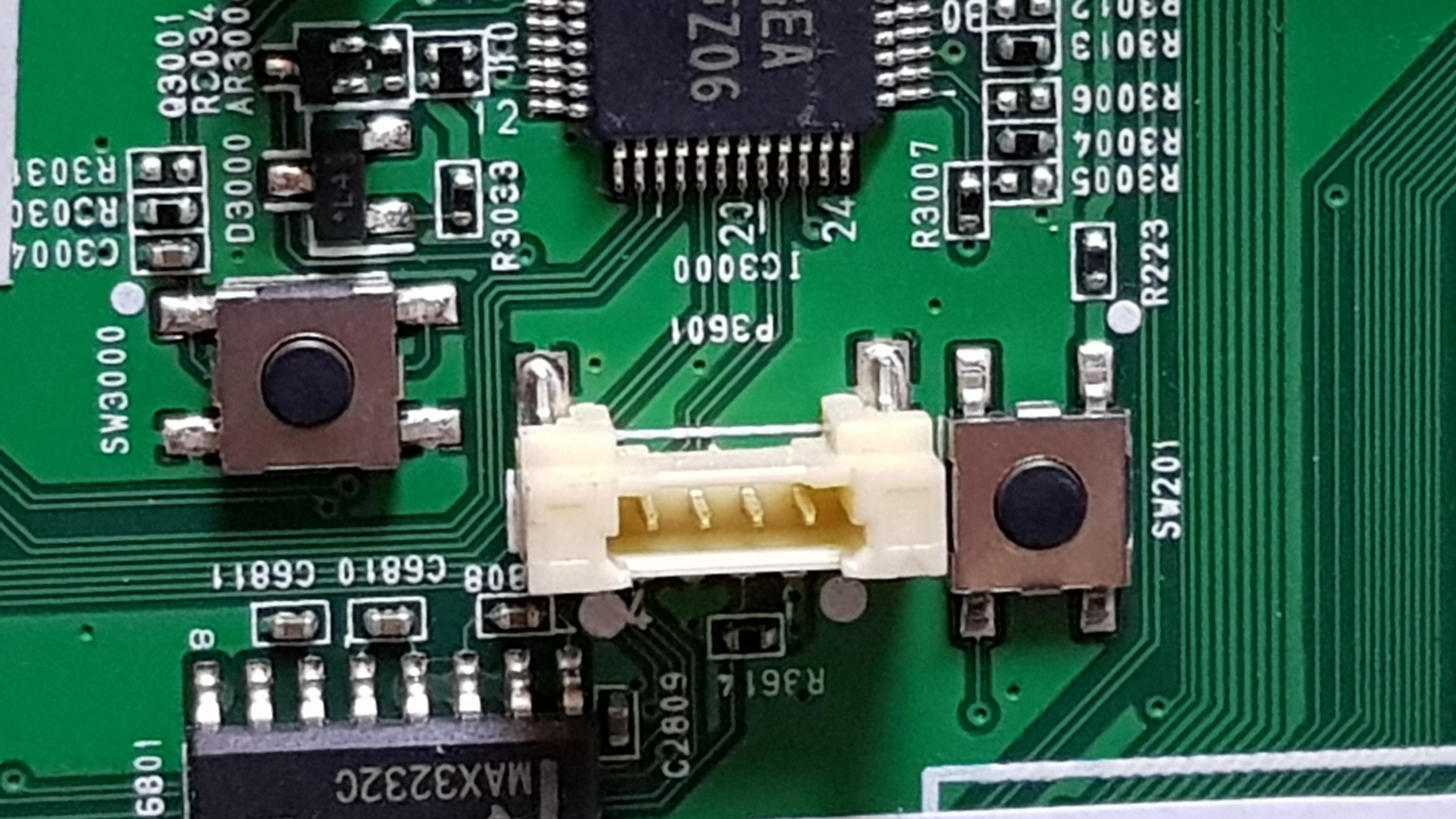

                            The reason you're getting a dim picture is because DRV_ON is enabled. However there is no data being fed to the panel. The fact that you don't have any white vertical lines Is a good sign because these OLED'S love to burn vertical tabs.
                            Those buttons that are on the main board do a reset of the tcon, And the other resets the TV as if you were to unplug it and plug it back in.
                            The system is very finnicky and super sensitive to any over voltage condition of the panel. If it recognizes a gate failure it will shut down. It will attempt to restart 2 consecutive times before a lockout condition occurs. This is sensed by T con board. You're no picture is most likely and invalid T con board with a wrong panel ID number for the panel. (This happened to me until I installed the OEM tcon back in.) Also if the tcon came from a smashed panel it could have shorted blowing a fuse or an inductor.

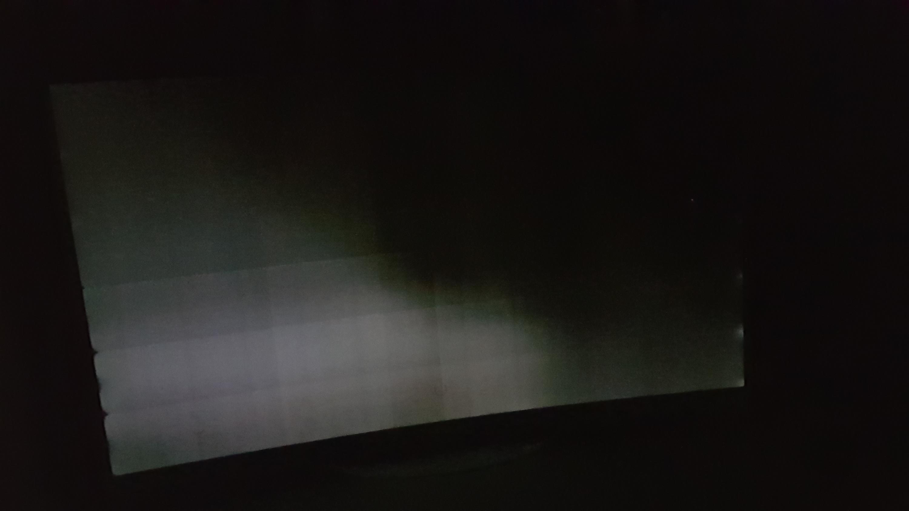

                              I have now systematically replaced all three boards, 5 ribbon cables and both power cables. At each step the result was the same, dim lit screen lower left corner.
                              So I put original boards back in (still same dim screen)
                              Yes without the jumpers in place, in Power_Only mode the tv will remain powered up, doesn't turn itself off and the LG logo stays lit.
                              Using the micro switches on the main board in the following sequence allows me to use the remote to power off and on:
                              In Power_Only mode Hold the left button down (powers down) then hold right button down then release left button (powers up) keep holding right button down and tv will power off and on twice. After this I can use the remote to power off and on.
                              Now when tv is on, LG Symbol fades quickly. Tv doesn't respond to any other remote comands (LG Symbol stays off).
                              Then I discovered I can achieve the same just by pressing exit on the remote when in power only mode.
                              Next I tried disconnecting the 4 ribbons to the panel one by one (with power off) and here's the result
                              If we number the ribbons 1 to 4 from the left as we look from the rear of the tv:
                              Removing ribbon 1 gave this result:
                              Most of the screen flashes on
                              https://youtu.be/t7AnV5v2-08
                              Removing ribbons 2 & 3 results in a black screen for 3 seconds before it powers down.
                              Removing ribbon 4 gave this:
                              A section of the top and bottom flashes on.
                              https://youtu.be/gpPi2CsjXZo

                                In my experience any of the 4 ribbons disconnected will cause this. They all have to be connected. The OLED does not work like a conventional LCD screen. Data transmits from the left cable and out from the right so it has to create a complete cycle.
                                How does it react when you leave all 4 ribbons disconnected attempt to power up using the power only feature?
