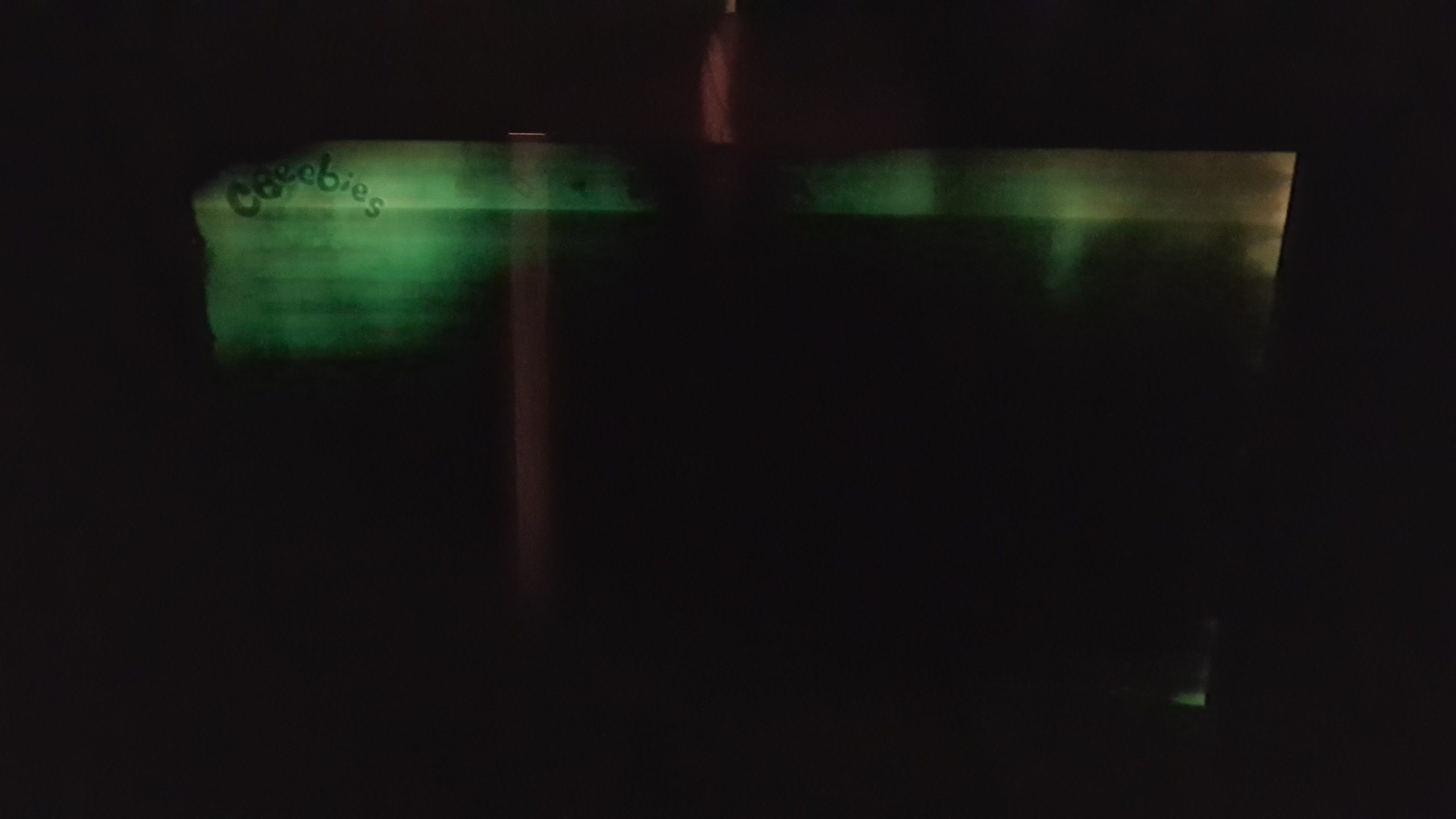

      Re: LG 55EC930V OLED - 3 Second Power No Display
      Hi there fella,
      Ive just suffered a similar failure to you.
      My disabled son was casting some youtube to the 4yr old tv (55ec930v) i was sitting next to him reading.
      When i looked up at the tv the picture was frozen but the audio was continuing. I switched the tv off at the mains, waited 5 mins, the back on, the previous image that was frozen was still on the screen but a much dirtier grainier image. Not good. Unplugged from the wall for an hour, put back on, then all I had was a dark green shadow patch in corner of the screen, the rest was black.
      ive had psu issues on previous tv`s, so took back off. Tested the outuuts, the 12v rail was altiile low at 11.79v, the rest were ok. The 24vdc to the t-con was also ok.
      I`ve plugged in an external portable dvd player into the av socket at the back, audio comes thro ok, no video.
      Also, I can still connect wirelessly to the tv and cast to the tv like before, again audio comes thro spot on but no video.
      I found an engineers faul flow chart pdf on web, followed the flow chart and everything on that points to the t-con.
      I thought i`d try a t-con board, as I gound one on web with the same part number,and as it was only £30. Well worth a try rather than scrapping off the tv.
      Fitted the replacement t-con, exactly the same patchy image on the corner of the screen as before.
      I think the panel has failed.
      Any ideas on what I could try to get it to work.
      Maybe a letter to LG too, as from what i`ve read the panel should have a life of 30000 hours. I doubt mine has done 5000 to be honest.
      Many thanks,
      Anthony.

        Try first send command IN_Stop to reset whole TV to factory condition... we explained here over this threat and forum too by using android device with IR sender.

          Hi Diah
          ok, done what you suggested, the tv did accept the in-stop command (although I couldnt see the passcode box)
          With my android tablet and the lg service menu, pressed in-stop and input the 0413 code and ok and the TV gave a sound of woo hoo, and swiched off, so i know it has accepted the in-stop command.
          This is the screen picture in a dark room, you can see how much light is coming thro and where on the tv screen.
          Teh sound works ok.

            put back your original T-CON driver board in place. and make IN_STOP again. after it goes to stand by. put air mouse at any USB. and put other Pin drive with media content such mpg4 file. then turn on the LG hope the driver of the screen will come back to normal... not help... try to flash firmware... i dont believe yours Panel issue when it frozen at first time of issue... its just firmware driver which this EC suffer from it.
            between if IN_Stop was succeed ... when the TV turn on at first time it should show the first installation... i wounder how you got this picture you attached before.
            so please just Notice this 2 points
            1- you don't need to log in service menu in order use IN_STOP... just from normal operation screen send the command.
            2- disconnect all signal sources ( Cable/ areal/Sat ) or USB drive and plug out any LAN Ethernet connection too.. we need the screen driver will not be occupied from any external signal... just the TV SET SOLO at time you send the command.
            Good Luck
