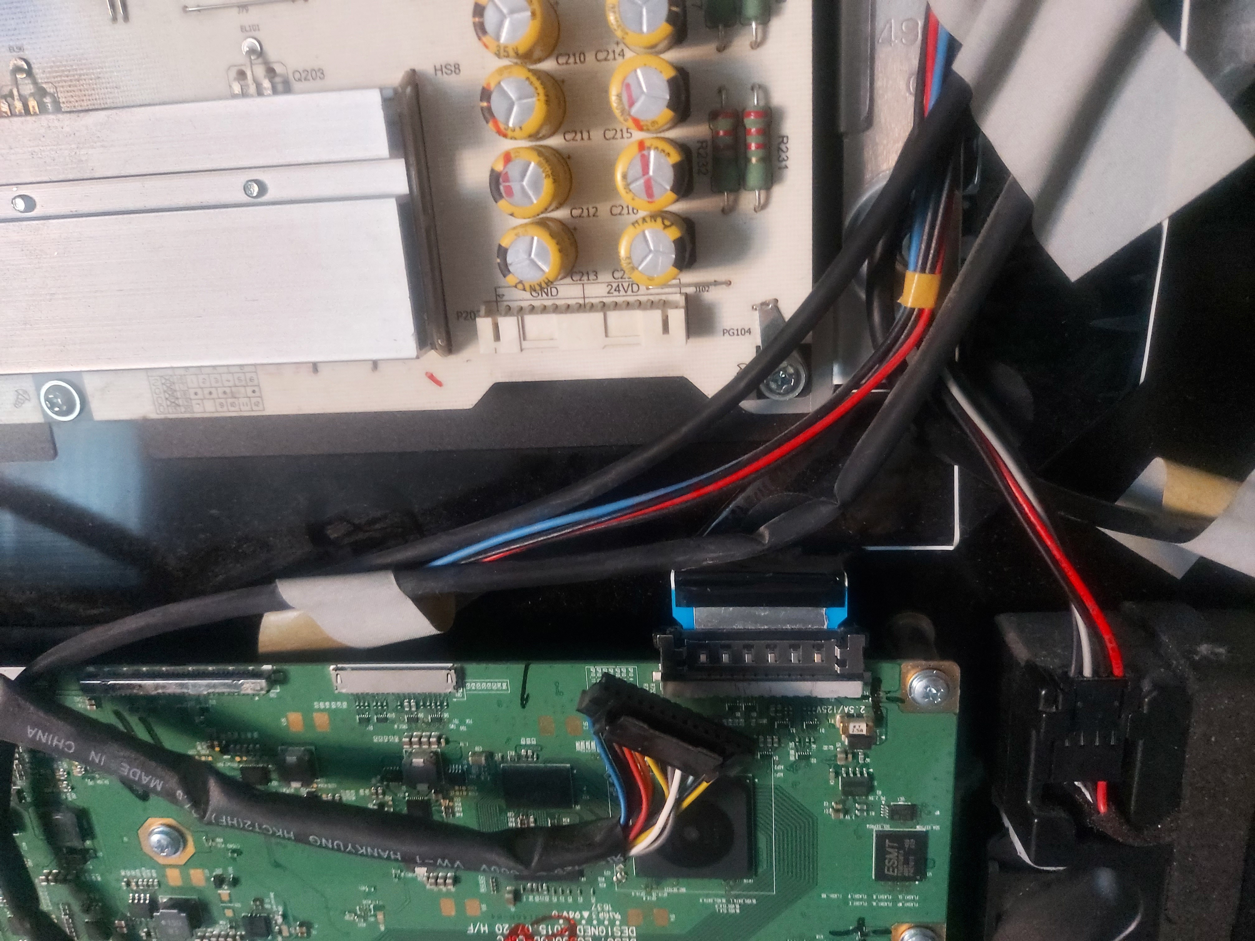

    Originally posted by Dac12
    Earlier it was responding to the remote but I kept tampering with the microswitch and now its not responding. But everytime I press the microswitch the shading and the percentage of screen shaded changes.
    I should have entered the code via a normal remote. But i dont really want to give up on this yet. Is there anyway of getting it back to the lockdown stage? I just disconnected the tcon ribbons and it went back to lockdown.
    I've added two photos and the chip I assume below this ans the rubber is very hot to the touch, maybe a fault?
    Sorry just realised the photo was missing.

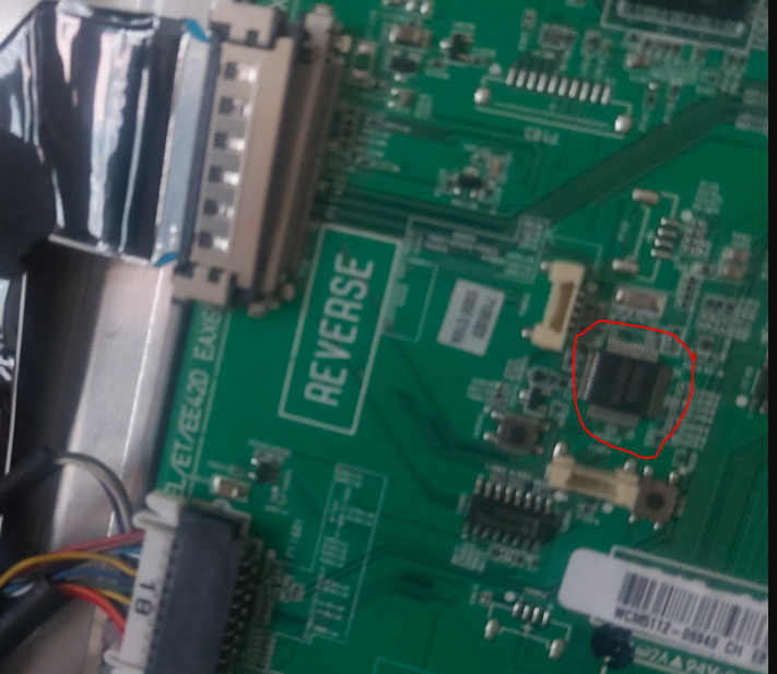

                  But i do not see a chip or rubber, only a screen...

                    #109
                    Sorry fourth attempt at trying to upload the photo. Sometimes it get hot to the touch.
                        I've tried to attach your post but struggling to attach it

                          It is not the first nor the 100th but more of the LG cpu that can be soldering ruined...

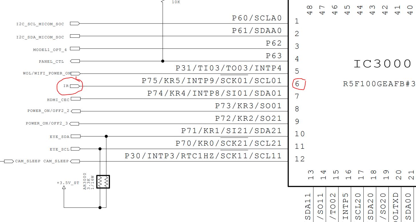

                                  IN_STOP will not work, because the IR sensor of the remote control is connected to pin 6, i.e. the TV will not receive signals from the remote control.

                                    #117
                                    Thank you where would we find this ic3000 ? Would it be on the MB? Secondly if pin 6 is disconnected will the seevice remote work? We checked mainboard but we can't see this ic3000?
                                    Found it , I think please see attached photos- but how would this be disconnected? Sorry I'm new to this

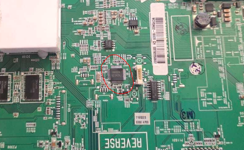

                                      #118
                                      We've found pin 6 but how do we disconnect this? Which one route no 6?
                                      • Dac12
                                        • Aug 2025
                                        • 31
                                        • Uk
                                        #119
                                        QUOTE=lotas;n3707055]IN_STOP will not work, because the IR sensor of the remote control is connected to pin 6, i.e. the TV will not receive signals from the remote control.[/QUOTE]
                                        Ignore this is wrong chip

                                          #120
                                          Here is micom ic3000, but the remote control will not work if you cut the track to the 6 pin
