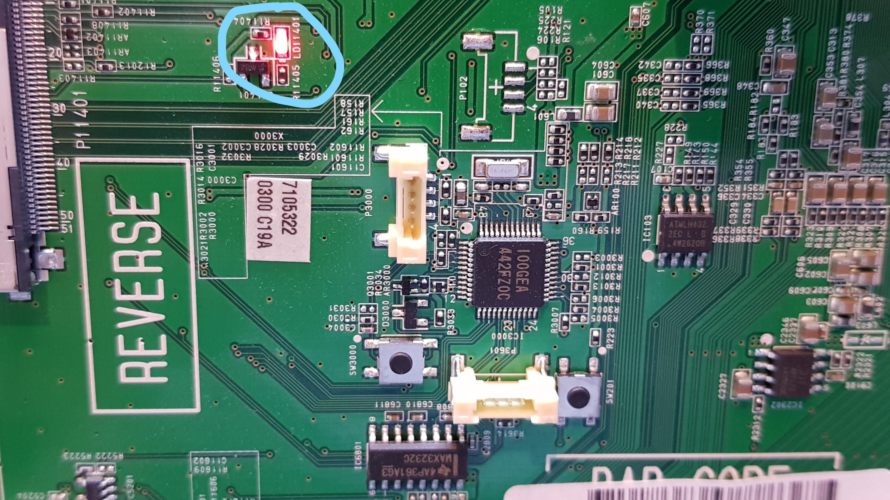

      #42
      Re: LG 55EC930V OLED - 3 Second Power No Display
      Are there any LEDS lighting up on main board? There should be 2 I believe.

          #44
          Yes theres one LED from what I can see LD11401. It is red and is iluminated when TV is powered up.

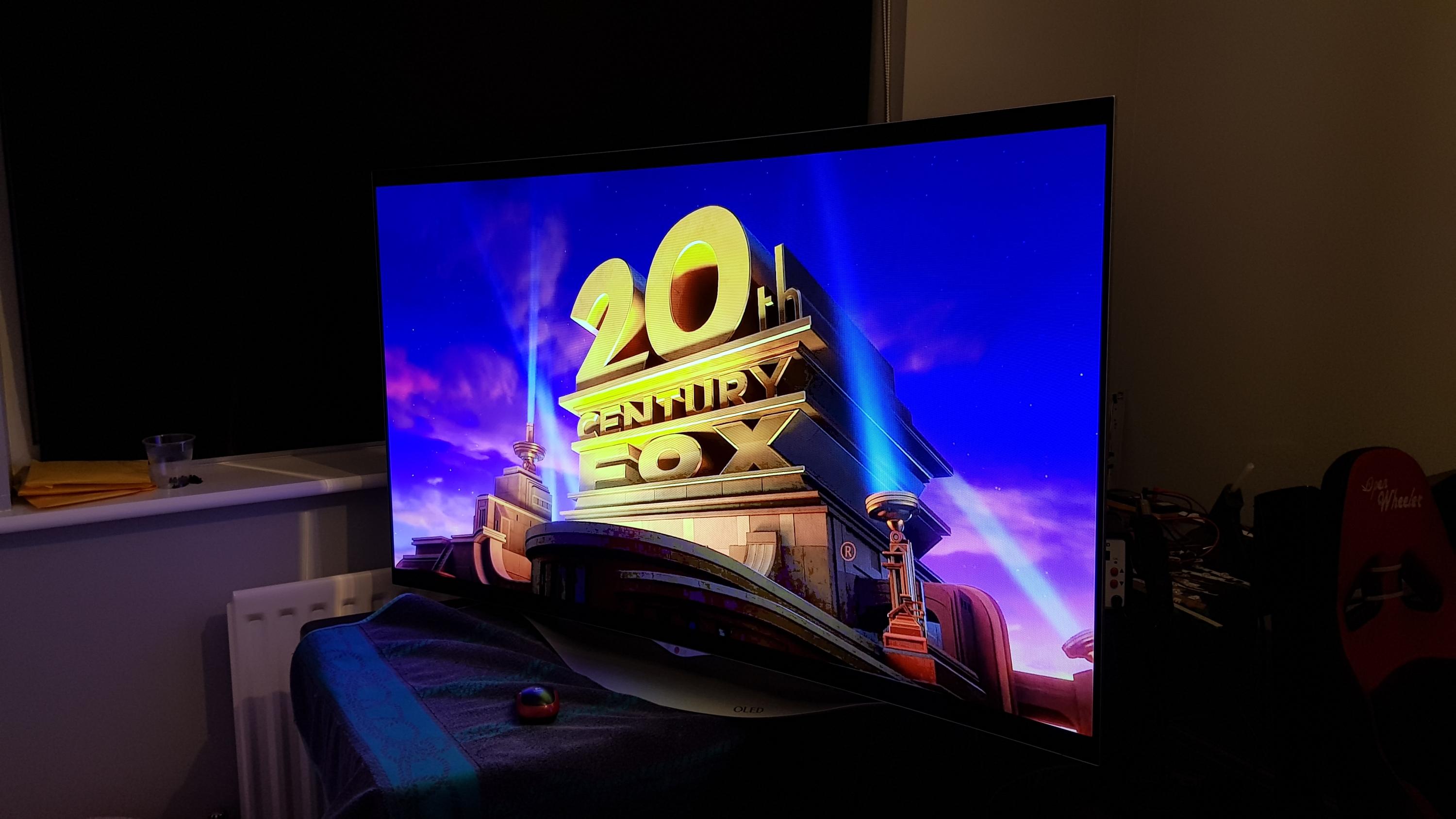

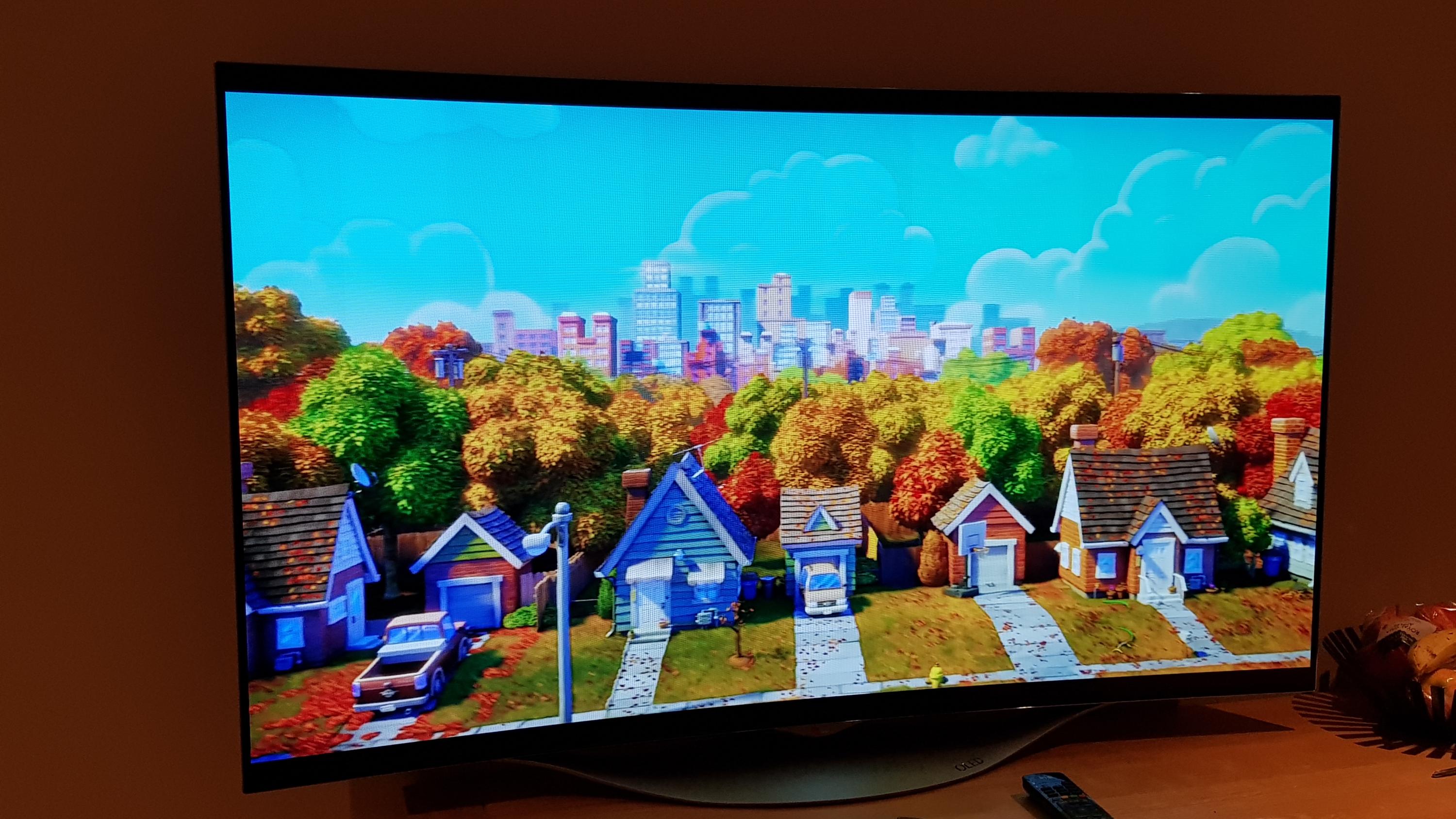

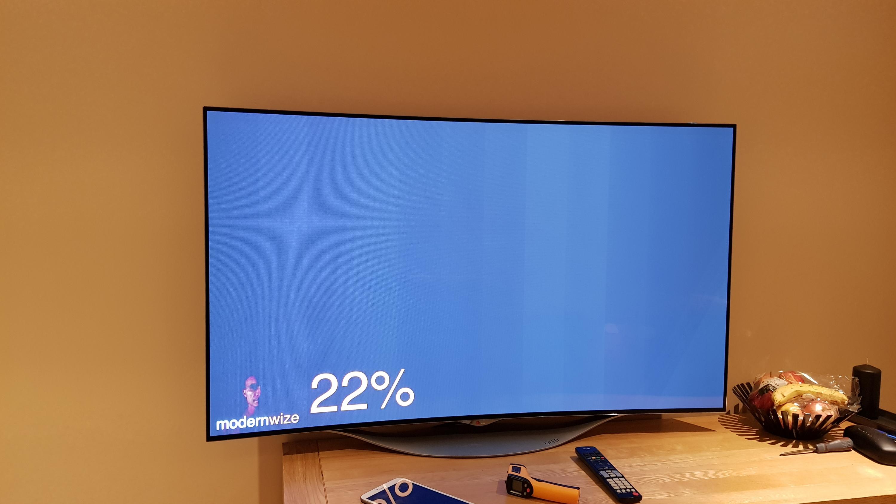

                          #52
                          I'm back guys
                          A quick update and a couple of questions. So after a around 5 hours of run time the posterization has gone and now the picture is great.
                          I've only run the set for around 90 mins at a time as the screen is getting hot. Do OLEDs run hot? What screen temperature should I expect? It's currently 41c after 30 mins.
                          The thing I'm most unhappy about is the vertical banding. It's quite obvious sometimes. Is there a way to correct this like a manual pixel refresh/compensation cycle??
                          Pictures to follow

                              #54
                              OLED Screen specially 65 size above we call it in room winter heating system, at yours 41degree still good. as i guess you have room temperature 22 somethings
                              this effect you have now it will be reduced and away after time use.. it happen now because you removed before the ribbon cable and LVDS. and of sure you didn't brought them each back at its place.. so the reading of LVDS Freq depth has being changed and the set clever enough to adjust this value self.
                              yours main issue was Panel driver didn't load at start up.the air mouse receiver push the driver again to load again as it need display driver at operation

                                #55
                                Thanks Diah. Very thorough as usual. The panel only raised another 2c after an hour so nothing to wory about I guess.
                                Do you think a forced pixel refresh will help with the banding?

                                    doing or schedule pixel refresh on next start up will not harm the panel at all. but there are other way to clean an let panel calibrated automatically. after you finish watching don't put the set in STB. just from working state plug it out from wall socket. next day you plug it in it will be refreshed

                                          #60
                                          Can you take a close up picture of the banding that you're talking about if it's vertical bars that are spread about 2" apart, some are lighter in some are darker this was something I was never able to completely cure as it is a common issue with OLED. The newer TV's have gotten better with this but the older TV's use drivers to drive not only the backlighting system because it's organic but the pixel data at the same time similar to a plasma. It may get better as time goes on and it may not.
                                          Look at the Google forums especially AVS and a pretty sure your see a lot of other units with this banding issue.
