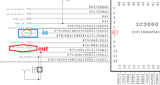

      Originally posted by Diah
      don't miss up with SoC soldering.. .. i wrote MB, not SoC... yours MiCOM firmware distributed because of playing with microswitch which had nothings to do.... try disconnect pin 6 of MICOM and try IN_STOP
      But I'm confused Diah has advised to disconnect pin 6?
      • Diah
        • Feb 2013
        • 6565
        #123
        Originally posted by lotas
        Here is micom ic3000, but the remote control will not work if you cut the track to the 6 pin
        RC will remain to work... this is SOS rail... RC took from other rail the function
        • Dac12
          • Aug 2025
          • 31
          • Uk
          #124
          I'm confused because Diah has advised to disconnect it
          • Dac12
            • Aug 2025
            • 31
            • Uk
            #125
            Yes thank you I understand now. But last question of many how do we disconnect this pin 6?
            • Diah
              • Feb 2013
              • 6565
              #126
              just pull it up from circuit
              • Dac12
                • Aug 2025
                • 31
                • Uk
                #127
                Lol you mean heat it up and pull leg up? Or can the sensor be soldered off?
                • Diah
                  • Feb 2013
                  • 6565
                  #128
                  use thin soldering head with flux,,, don't heat the chip in total

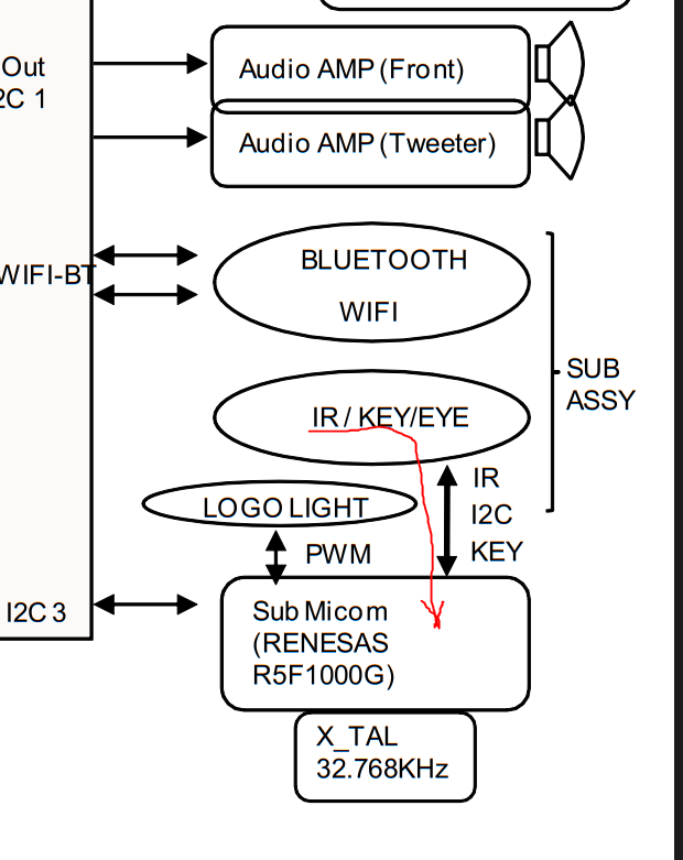

                  • lotas
                    • Jan 2016
                    • 4861
                    • Russia
                    #129
                    Ok, let's see how the remote will work after removing 6 pin. The ir sensor and keyboard (joystick) are connected to this micom.

                          #132
                          Lotas, SOS will but whole TV in lamm RC, Keyw´s and send PSu to shutdown , MICOM as guard beside sequences of the operation. we have here threat where we did deep inspecting on MICOM at same model.
                          BTW : you can see its IN SOS signal not out
                          Davi.p:
                          just say in clear words did you have OLED repaired ?? no more or less... dont act you know the issue and you will not said it to owner of this problem... this is child play... be adult as yours age. .

                            • lotas
                              • Jan 2016
                              • 4861
                              • Russia
                              #134

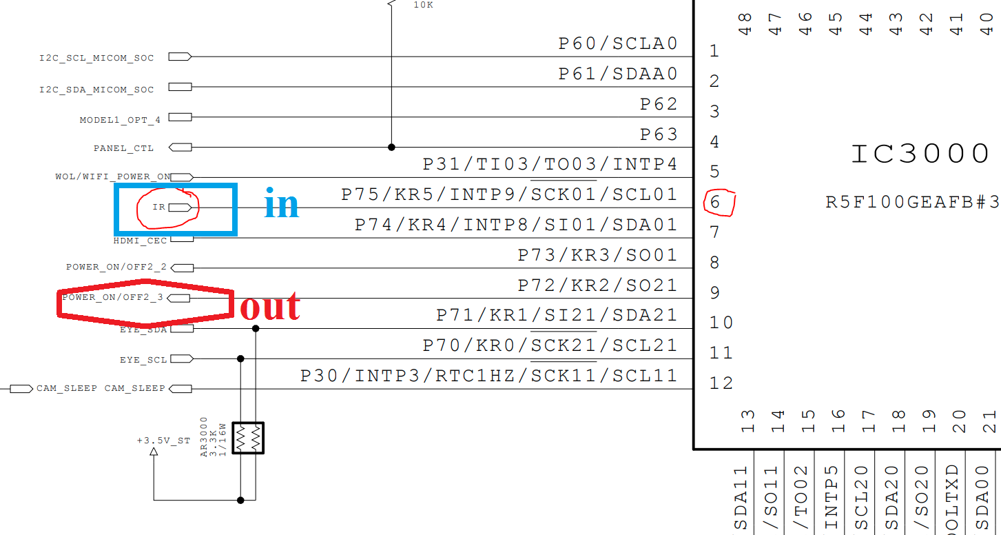

                              IR + KEY ---- MICOM
                              • Diah
                                • Feb 2013
                                • 6565
                                #135
                                IR + KEY ---- MICOM
                                lotas ,,, you are expert.. look on the diagram pin in and out.... in u can take it out... out pins are funktion

                                  Well, everything is correct, the IR sensor receives a signal from the remote control, and from this IR sensor the coding signal comes to the input 6 pin. MiCOM and MICOM gives the command to turn on the TV...

                                      Ok, OP cut 6 pin. on MICOM and give any command from the service remote control and we'll see the TV's reaction, and we'll all have a laugh at the same time.
