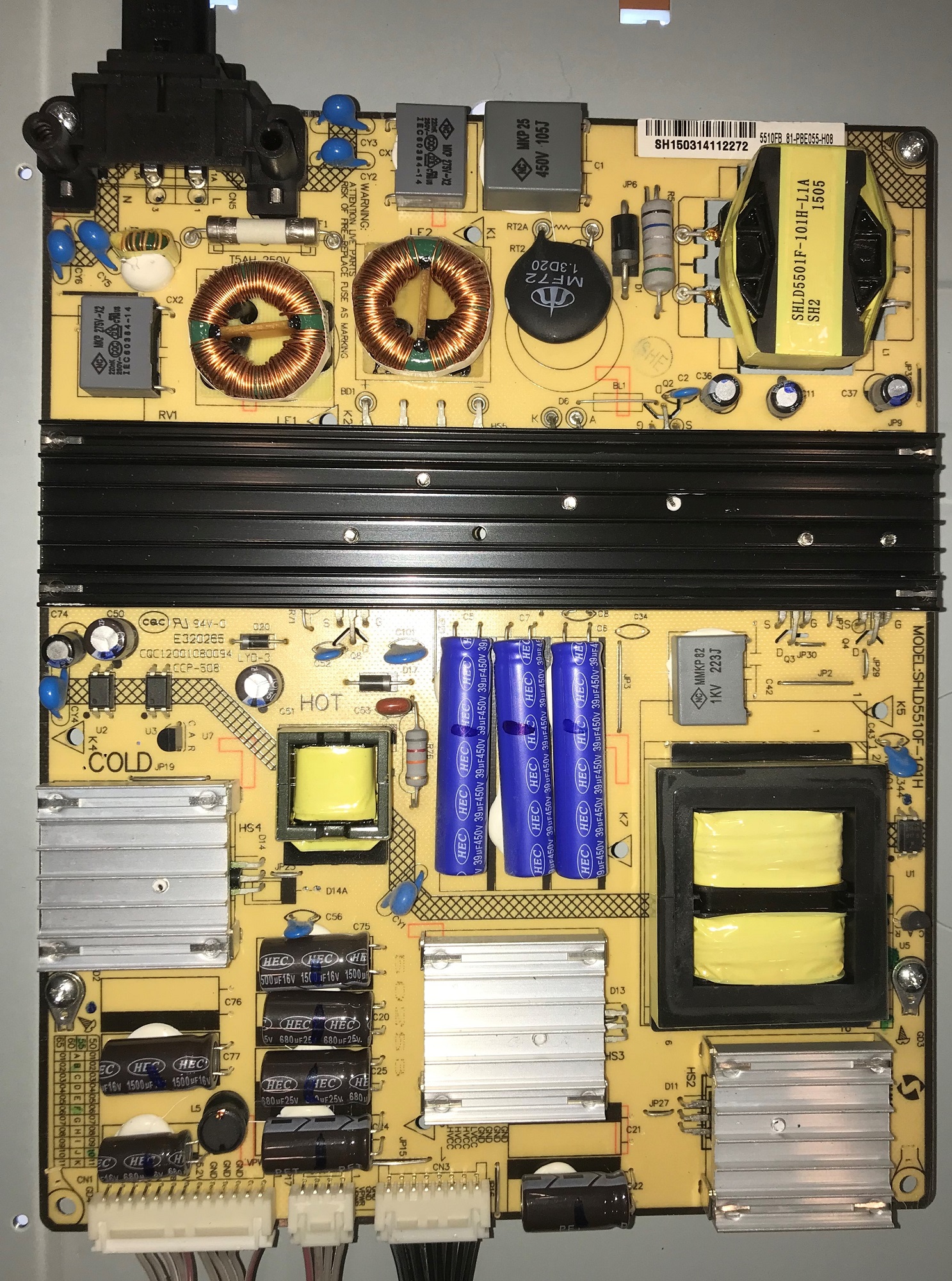

    I thought the power supply might have been bad so I replaced it and it didn't make a difference. Can anyone please guide me on what to check/test/replace next? Thinking it is either the tcon board or the main board. Tcon boards are cheap ($27), main boards are not ($295). Would replacing the EEPROM ($15) on the main board possibly help this issue?

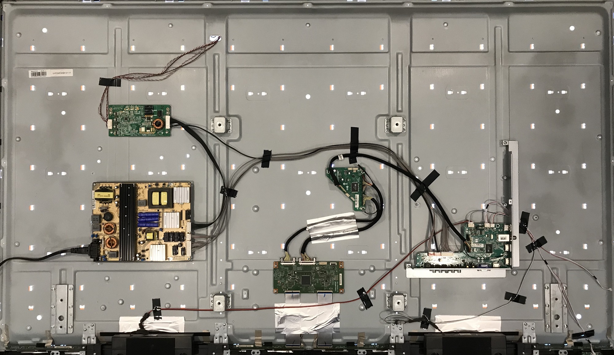

          We do need pictures to us how all the boards are connected together.

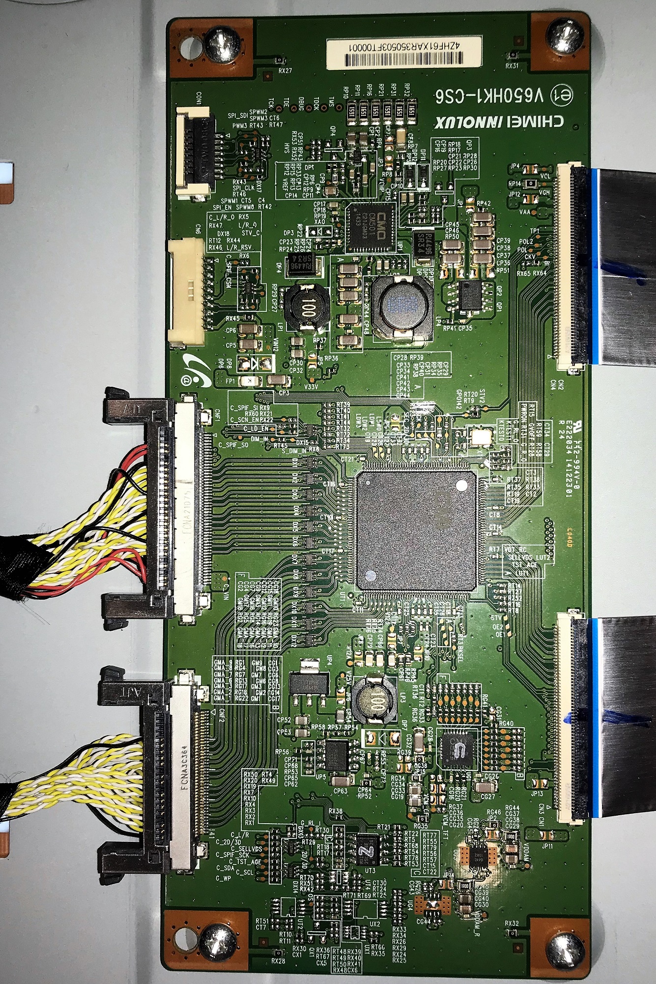

                              Good pic. of the tcon, currently sold out. https://www.shopjimmy.com/sanyo-4z-h...-con-board.htm

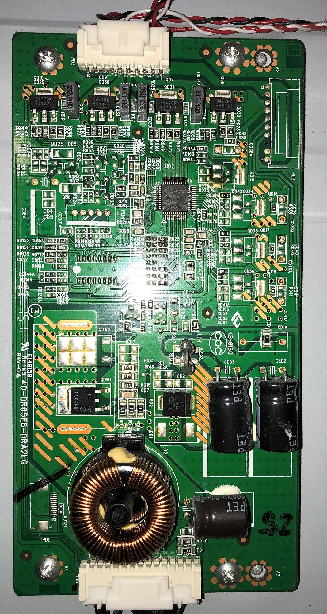

                                OP, looking at the tcon picture that you posted... what's happened in the area in the middle of the board just above the large chip. There seems to be some sort of "smudge" as the printing / tracks are not clear.

                                    I went ahead and purchased a T-con board. However, the new T-con made no difference - still have backlights but no display.

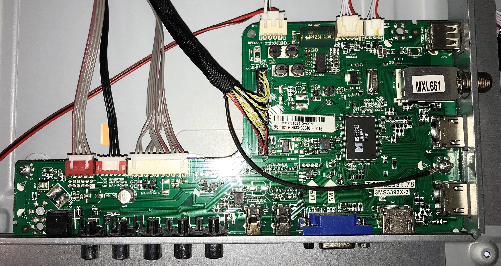

                                        I replaced the main board tonight with one that I ordered from Ebay (supposedly fully tested from a repair shop) and still get backlight no picture - same thing it's always done. I did notice the standby light blinks 9 times now instead of 8 when turning it on. Does anyone know what the blink codes on a Sanyo mean?
                                        I still had the replacement T-con board that I bought and swapped that in but didn't make a difference.

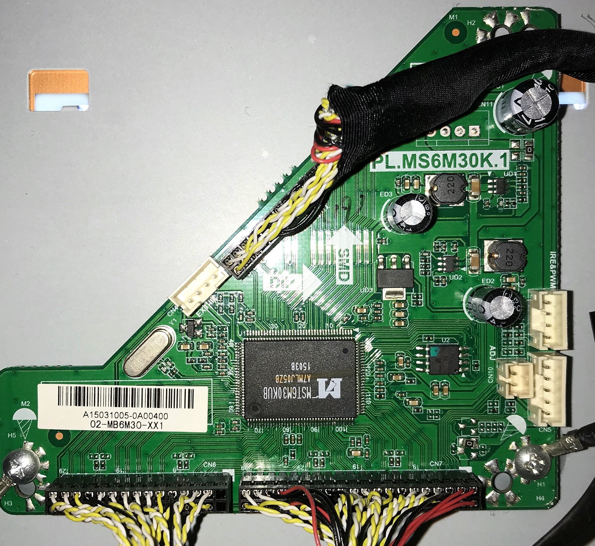

                                        The only board I haven't replaced yet is the FRC board. I can't find one for sale right now used or new for this TV. However, in searching for one, I saw that a RCA RLED6090 FRC board looks identical to my board but has a different part number on the board. Should I bother to try replacing the FRC board? If yes, is there any way the RCA one would work or do I need one specific to this TV?
                                        It appears to me that there is an EEPROM on the FRC board and one on the main board. Are they both EEPROM's or is the one on the FRC board something else?
