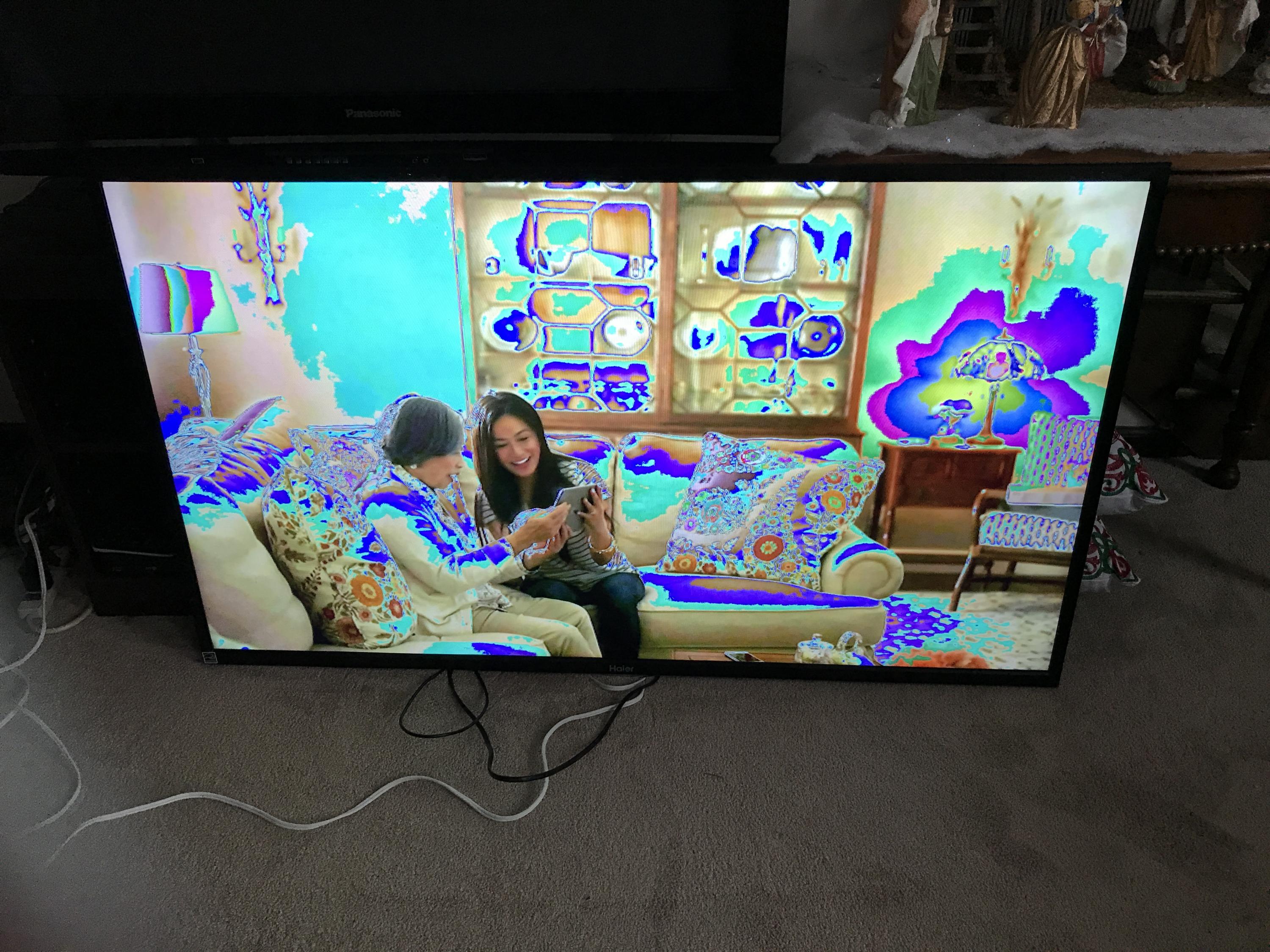

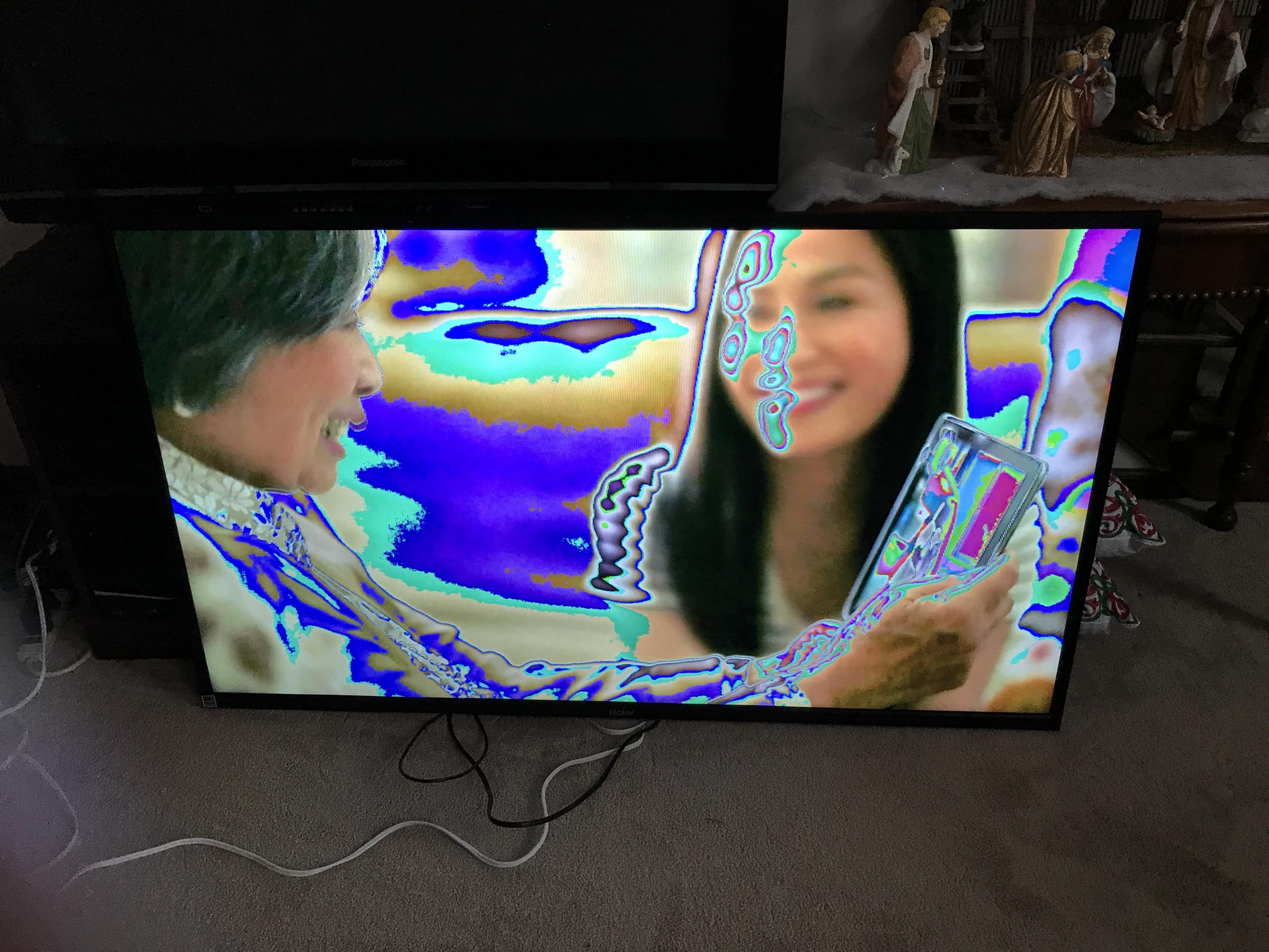

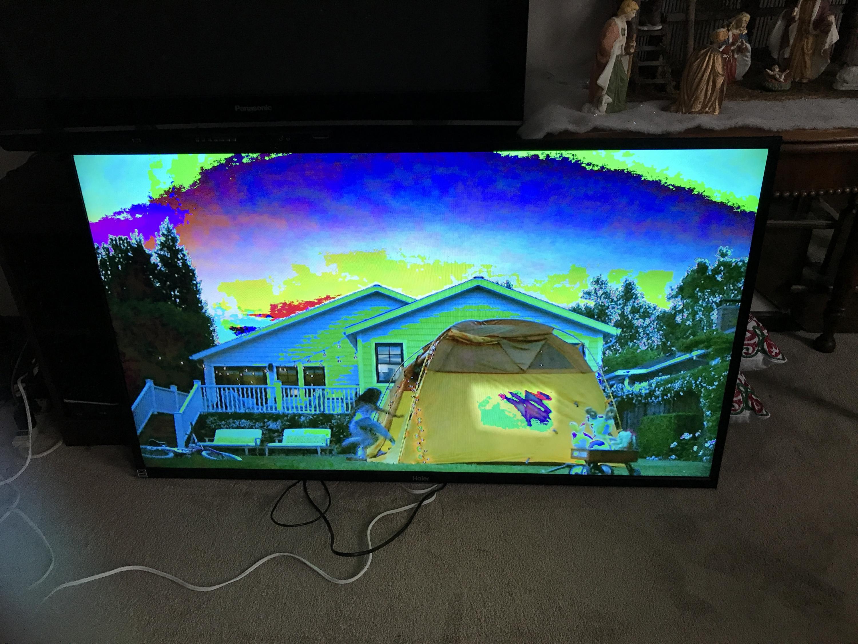

    Need help running this weird one down! Originally this TV was stuck in standby mode, with all power supply sources checking OK. Di the reasearch here and found out about the eprom issues on this and similar sets. So I replaced U18 on main board (MSAV3227-ZC01-01) with a part from shopjimmy. This looks to be the same board used in Haier LE39F32800. I was exited to set the set come back to life but now I have this.. Every thing looks like an Andy Warhol painting!!! Looks like a negative chroma image?? Also, I was able to get into the service menu but saw no setting that would appear to "flip" this issue... any thoughts!! Thanks in advance!!!

    The third one, reminds me of Windows' 4 BPP (bits-per-pixel, a.k.a. 16-colors) fallback, when the video card driver failed, L O L

      can you get into the service menu i think it could possibly be a lvds setting (make a note of original settings first though)

        Do this: update software, go to service menu and do a full reset.
          Re: Haier LE55F32800 Standby but now Andy Warhol video!
          That is GAMMA problem, so it is either the main board is not set to match the LCD panel, or failed GAMMA Voltage reference IC.
          BTW, How did you about matching the new board with the old board: go by PCB Assembly P/N which is usually printed on the barcode sticker or you go by the Blank PCB P/N which printed white silkscreen on the PCB?
          Blank PCB can be stuffed to make many PCBA for many TV models.

            Yeah I did not replace the board only the U18 eprom on the original board. So I am not sure the code in this eprom was correct for my panel. They did not have an eprom listed for my set. This is a 55 inch panel and most boards and parts are listed for the 39 inch version.

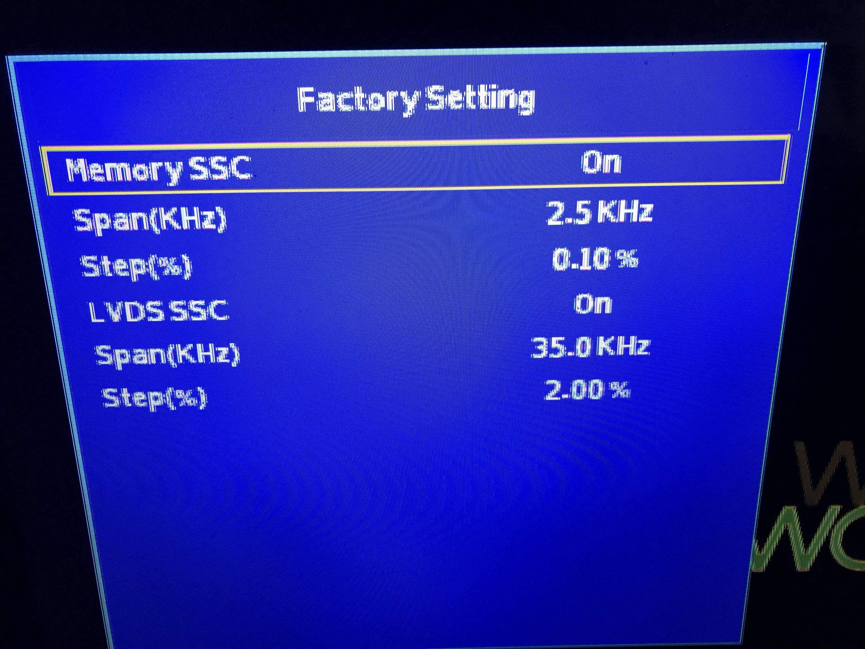

              Vinceroger69 - I do not see an lvds option in the service menu. Would it be listed as something else???

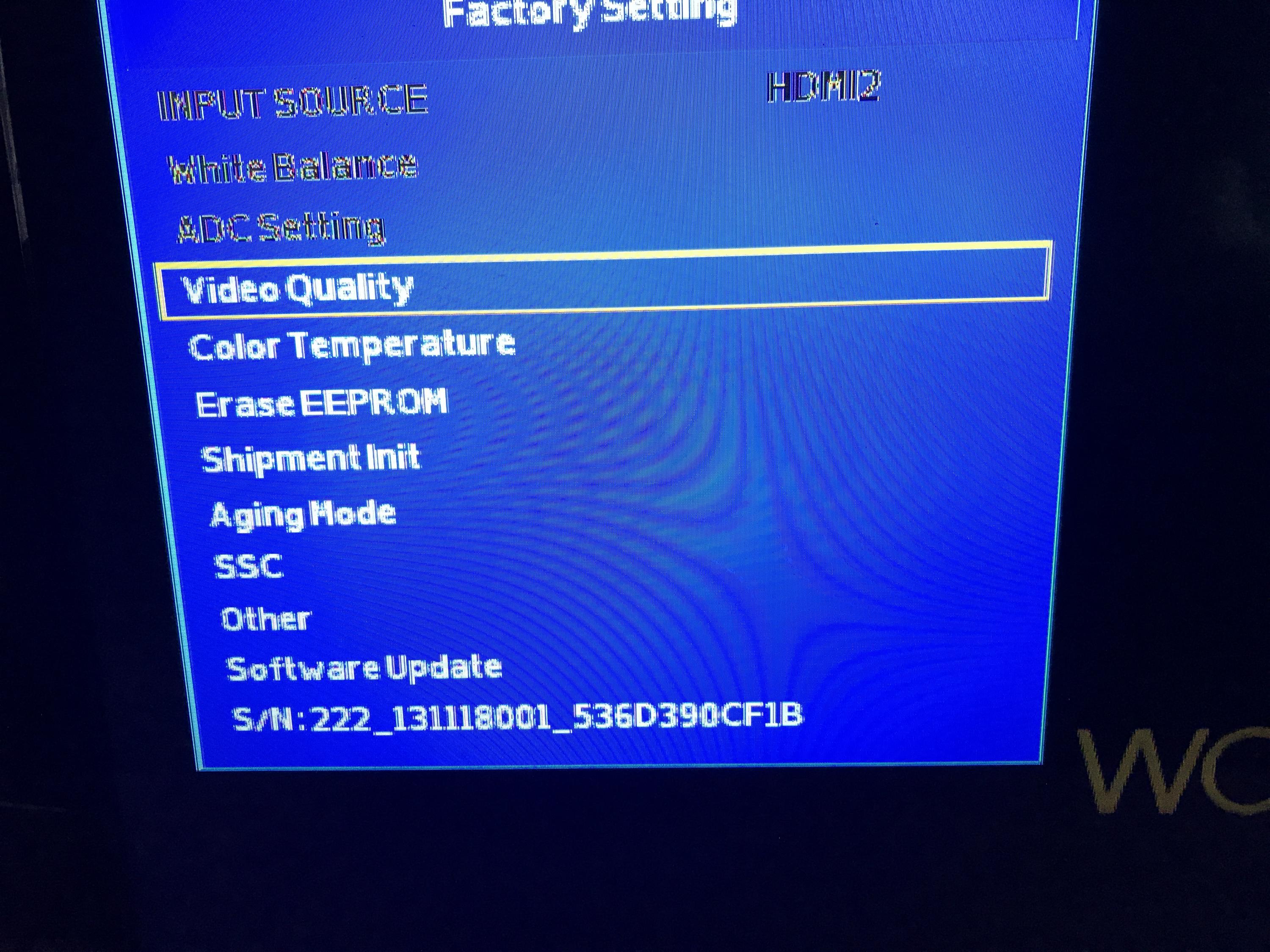

                take pictures of your service menu then maybe we can help more also try suggestion in post 4

                    I have searched high and low for the eprom firmware for this board with no luck. I have been searching by model number but maybe should be using the board number?? I will screen shot the service menu options tonight and post here. Thanks to all so far!!!

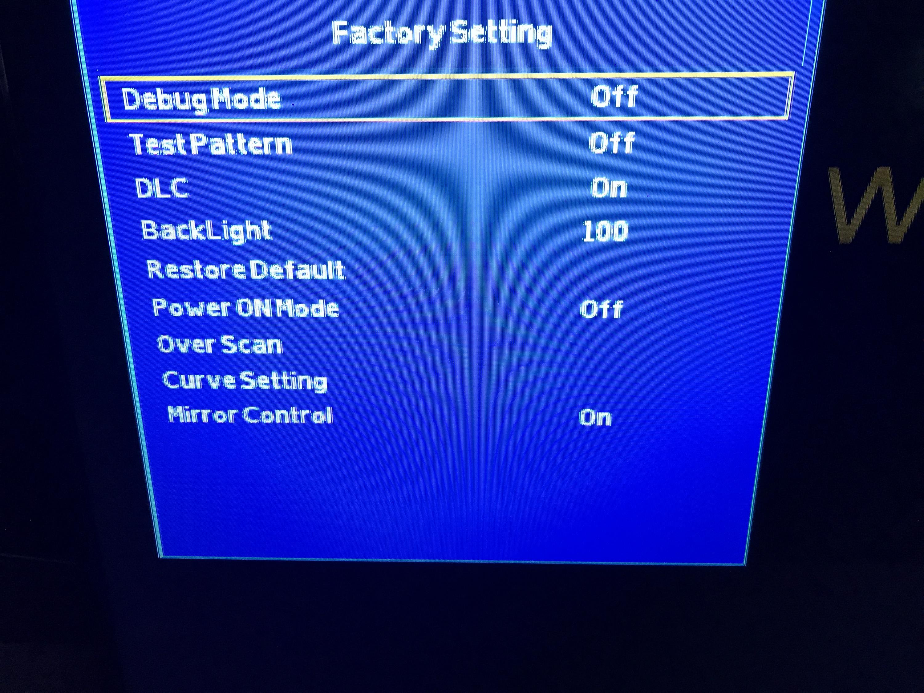

                        Service menu: LVDS Bit mode:change it, display should clear up when you hit the right one. Make note of original setting, in case its not the problem. If its a service menu setting problem, you will be looking for "panel setting", "lvds map setting" "lvds bit mode" make note of original setting, in case you need to revert, might just need to get into panel settings and change to 55.

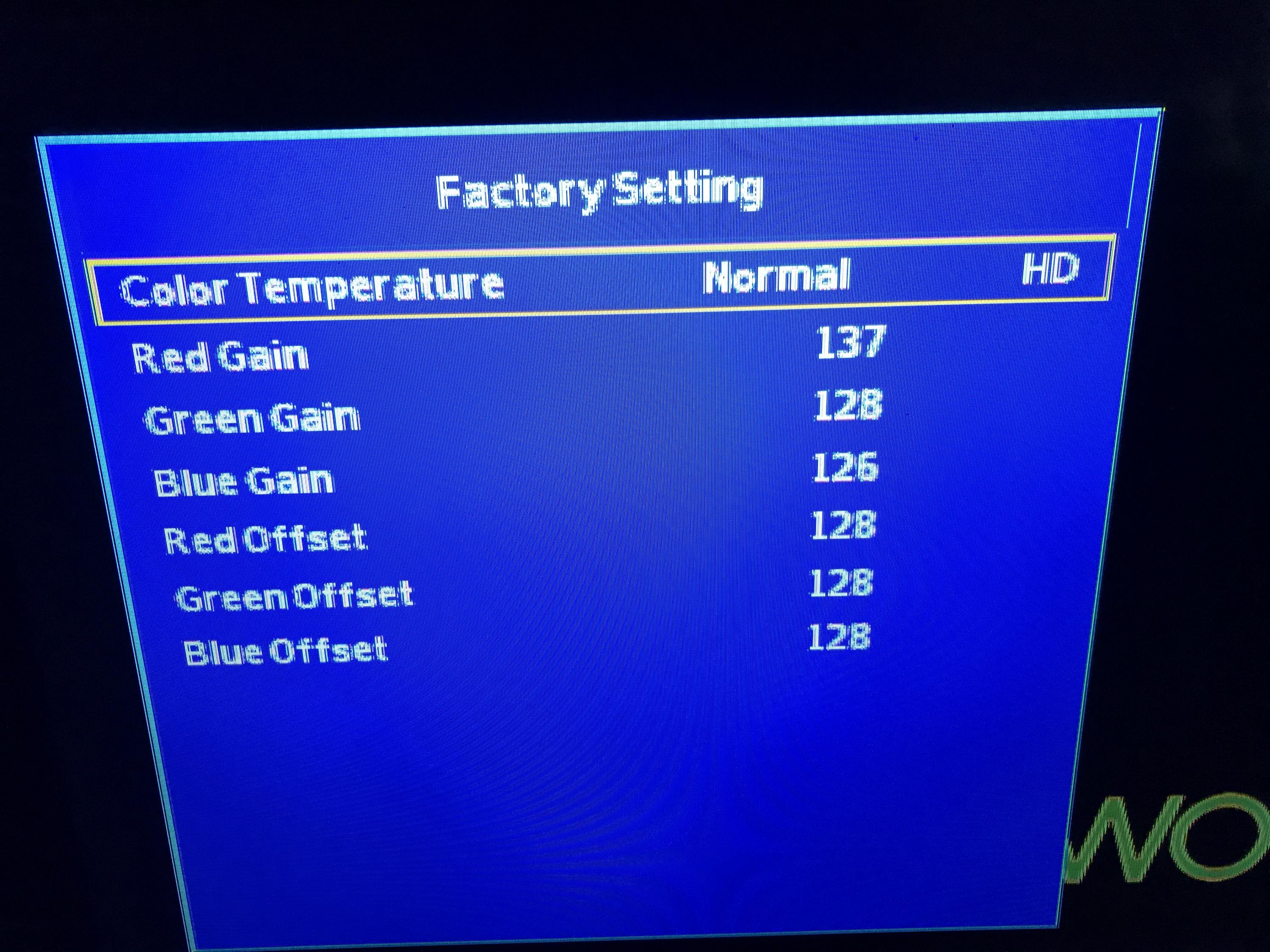

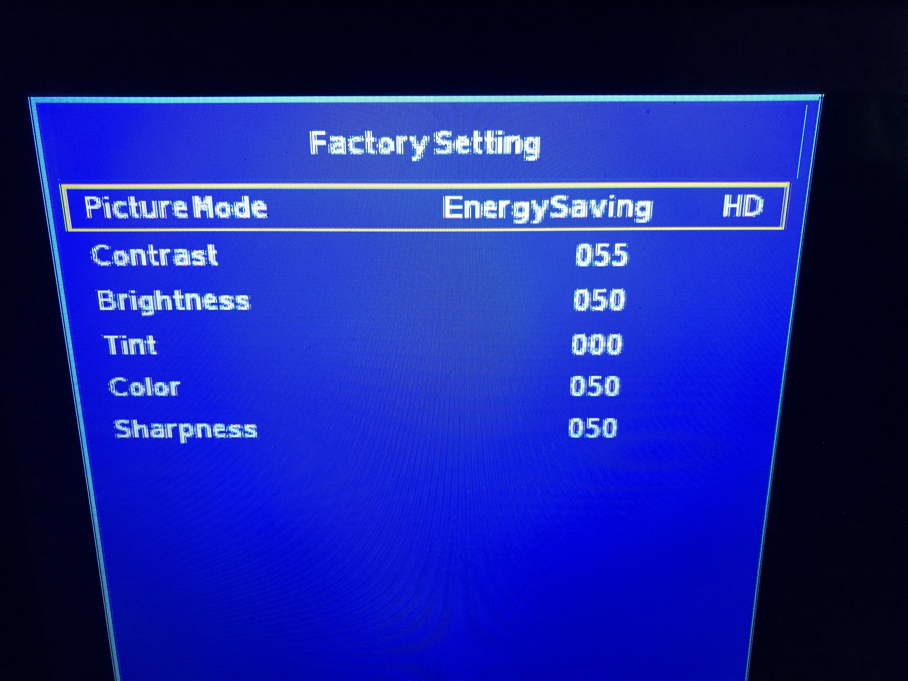

                          OK.. here we go with the service menu options. I do see LVDS under the SSC menu....

                            Also, while investigating the service menu, I got myself stuck in "aging mode" !! Green, Blue, Black, white, Red> repeat.. Tried all typical suggestions (manual power button, hold manual power 30 sec, down-up channel buttons) so any suggestions here would be good!!
