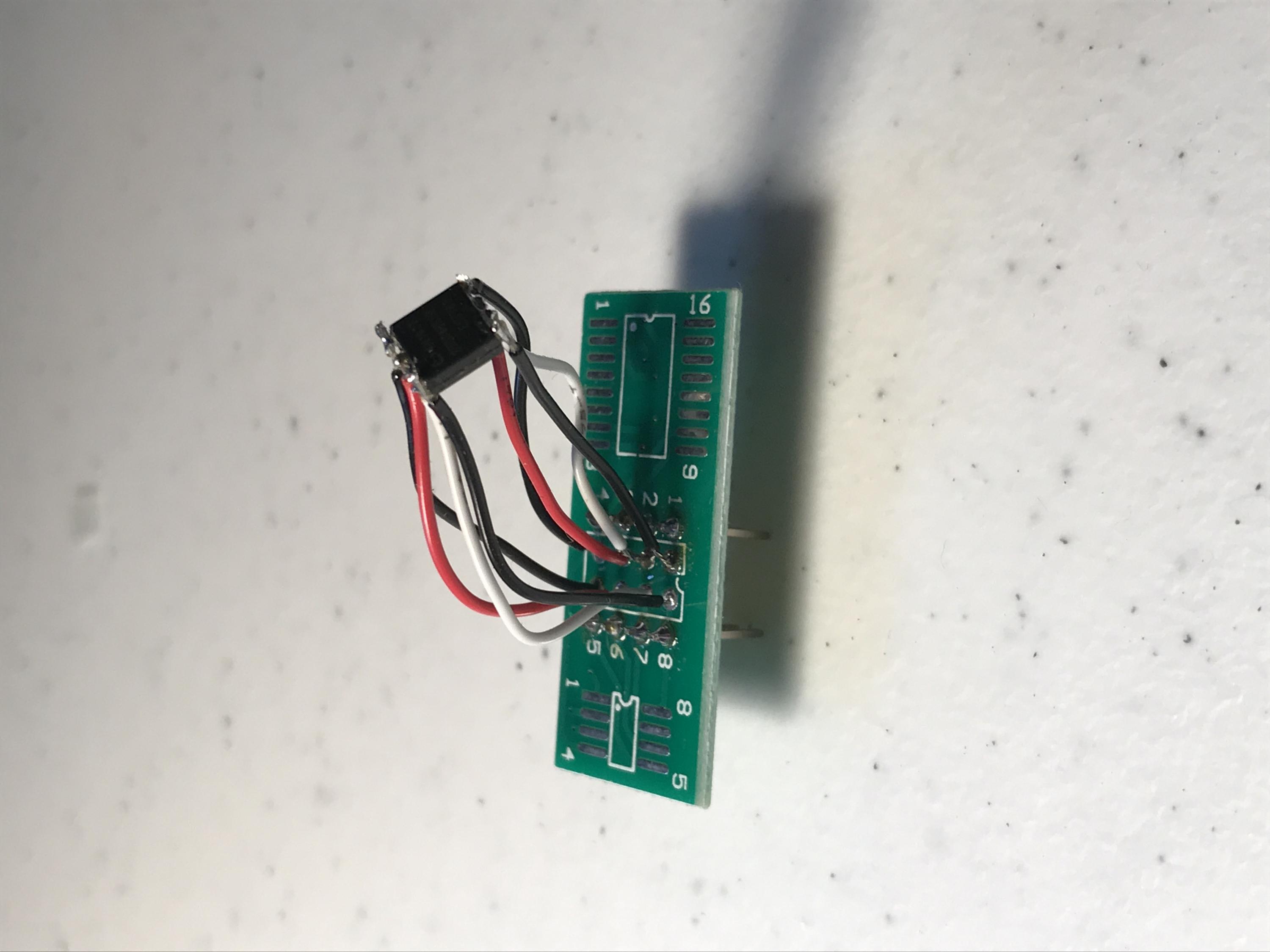

    Re: Haier LE55F32800 Standby but now Andy Warhol video!
    pics
    • smartjohn
      • Feb 2013
      • 116
      #42
      Yep, here we go...

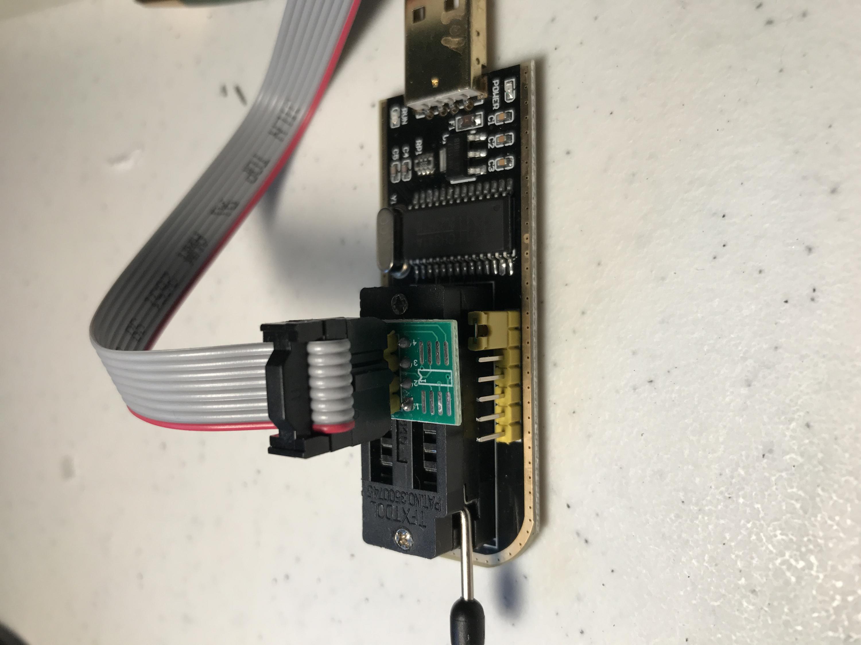

                      Hmmm... do you verify the code after it is written? Also erase that SPI and do a blank check before you write it. Flash it offline and solder it in.
                            yeah, o.k. lets see what that brings. Just thinking you should almost put a soic socket on there!

                                        BTW you show us on the photo you do programming in offline. but you do it on board. onboard only can be used as read.. to write must be outside the board. can be this why my file dont starat and your sj also now dont start.
                                          Yes, not always is possible to read/write inline, this can be due to how much current the board sinks supplied by the programmer and how are connected the pins from 1 to 3, them must be tied to GND to be succesful...
