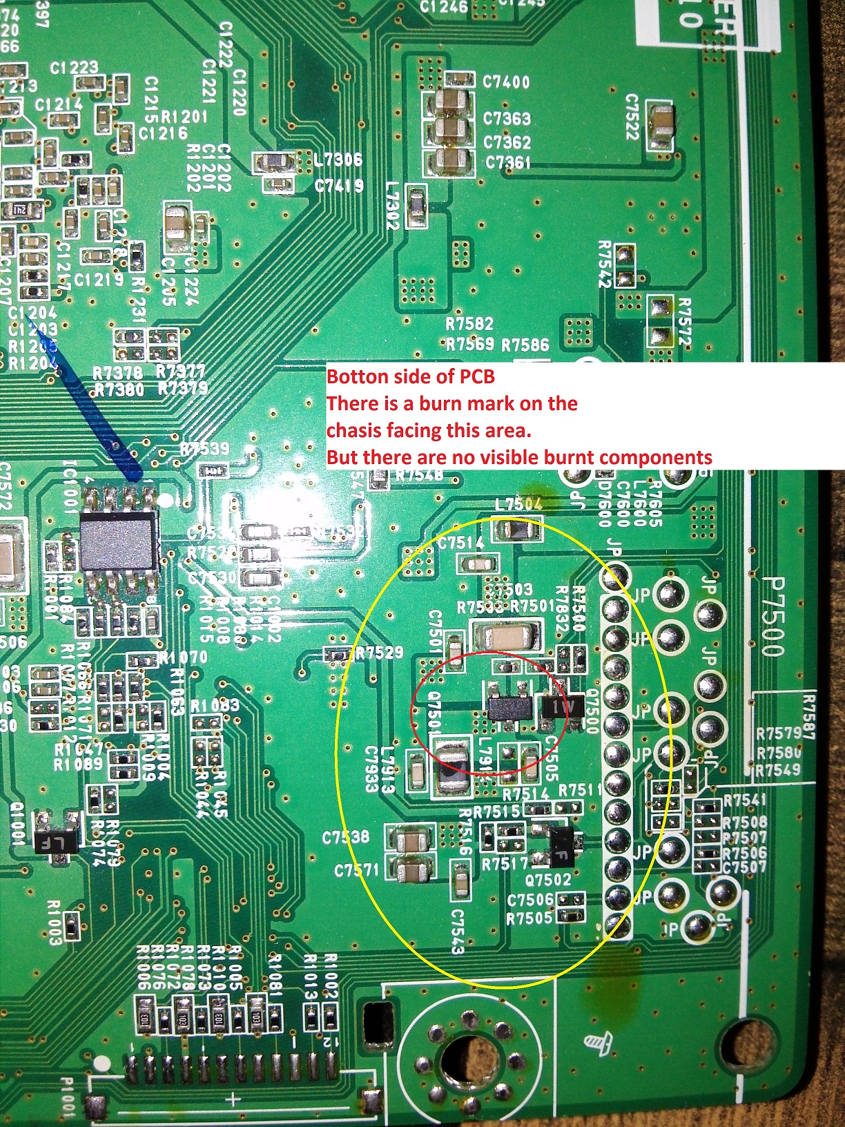

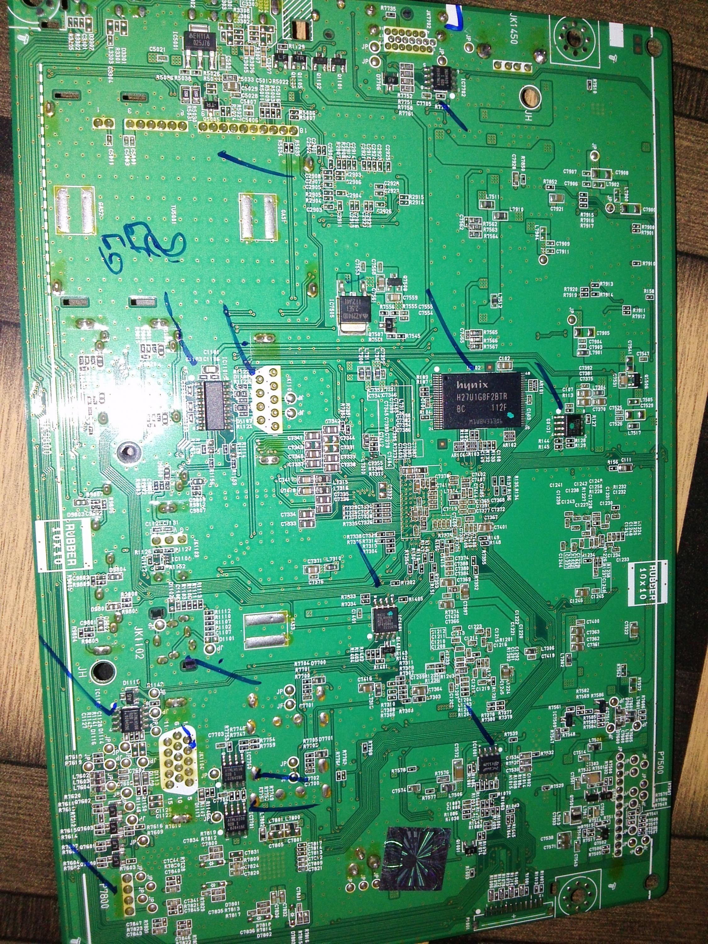

    I have a LG 26le5300 that gets stuck at boot logo after automatically rebooting for 4 or 5 times when switched on.

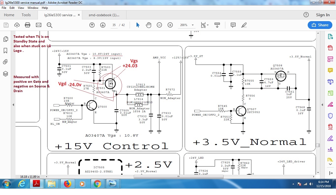

    I suspect some blown components (see image in red and yellow markings on the pcb image and also on the pcb schematic image) in this area, the P channel MOSFET A03407 (Q7501). The voltage reading Vgs should be 10.8 for a 24 volt input bu I get +24.03 volts between Gate and Source. And -24.0 Volts between Gate and Drain. Measured with multi meter's Red lead on Gate and black lead on source and drain respectively.
    Please help:

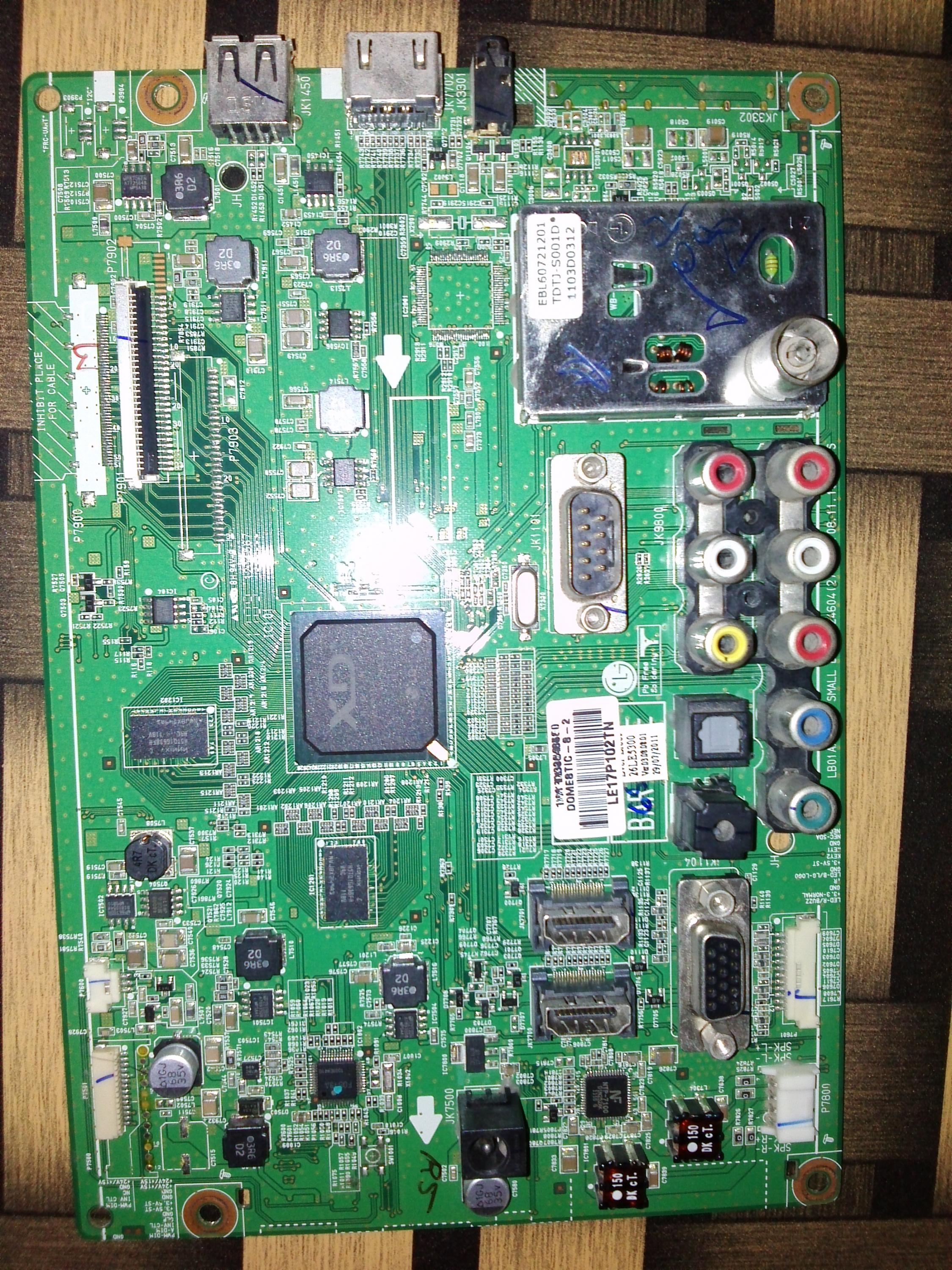

    Can anyone please help me with the main board PCB of lg TV 26le5300. I want to compare my PCB with an actual working PCB to see if any components are missing on the PCB. Is there any complete service manual for the TV . please help.
    Image of both sides of working PCB is what I need at least.

          For Q7501 (P-ch) the GATE Voltage has to be about 3 ~4 V < Source Voltage, you need to use circuit GND to verify the Voltages.
          What Voltage do you have on that POWER_ON pin?
          Q7500 has to be turned on by POWER_ON control Voltage for Q7501 to be on.
          We also need pictures that show how all the boards are connected together.

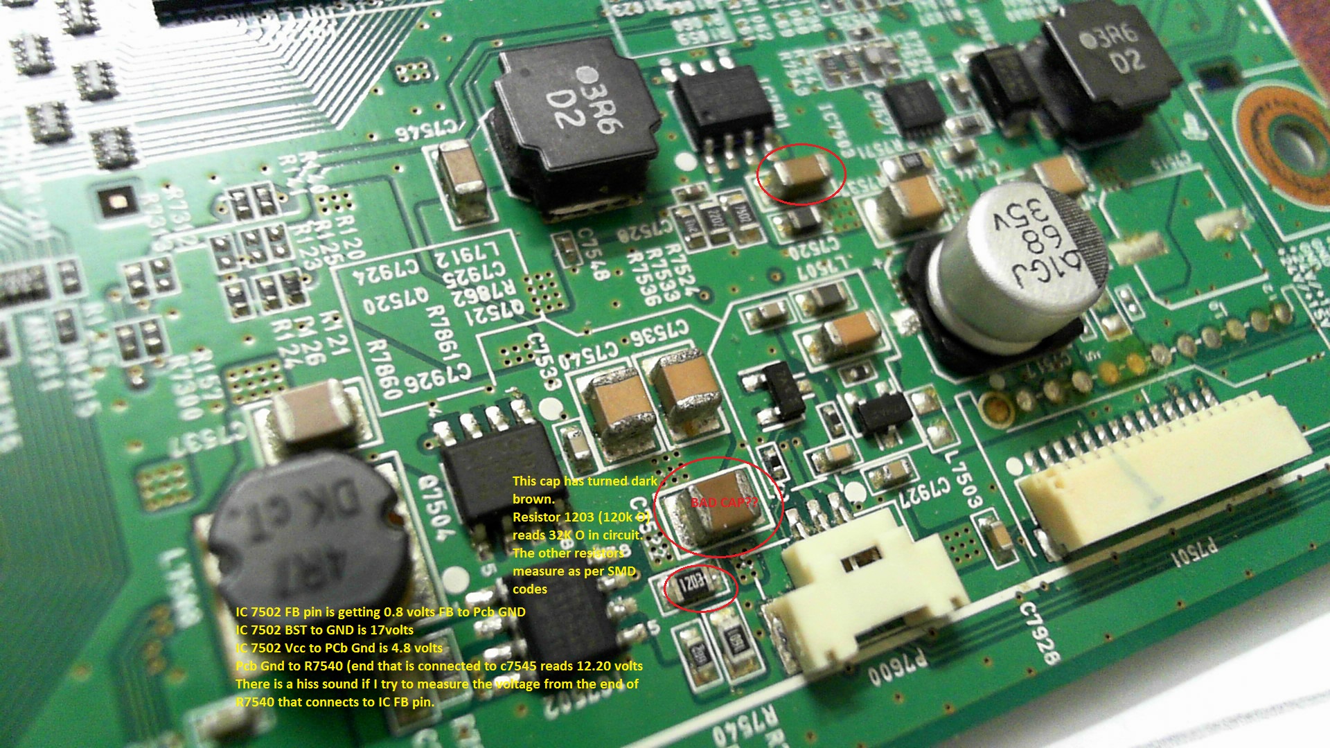

            I get the Vgs 10.8 volts on the a03407A G-S but only for a couple of seconds. The +15 Volts control chart in the service manual page 35.
            I checked all the voltages as per the service manual charts on page 35. There are two areas Power-Det and 24-volt->15 volt chart where the readings does not match.
            in power detect IC7510 vcc pin is not reading +3.5_ST but the IC7509 vcc pin measures +3.5_ST.

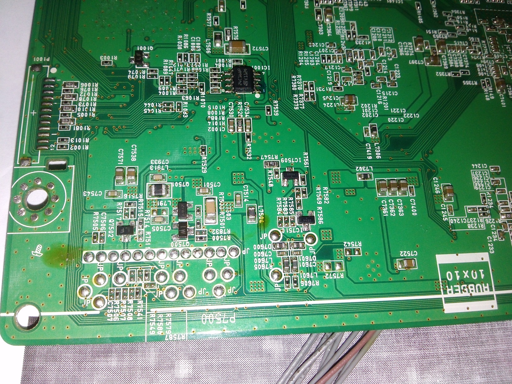

            The other issue is that in 24-volt->15 volt control chart. the R7540 reads 32k Ohms only. the other resistors are ok and as per smd code/markings.The Capacitor 7522 has turned darkbrown seems over heated or about to die but but measures ok.Or it may be already dead. these 2 components along with Q7502 in the first chart in page 35 are abnormal. I will post an image of the pcb along with test voltages below.

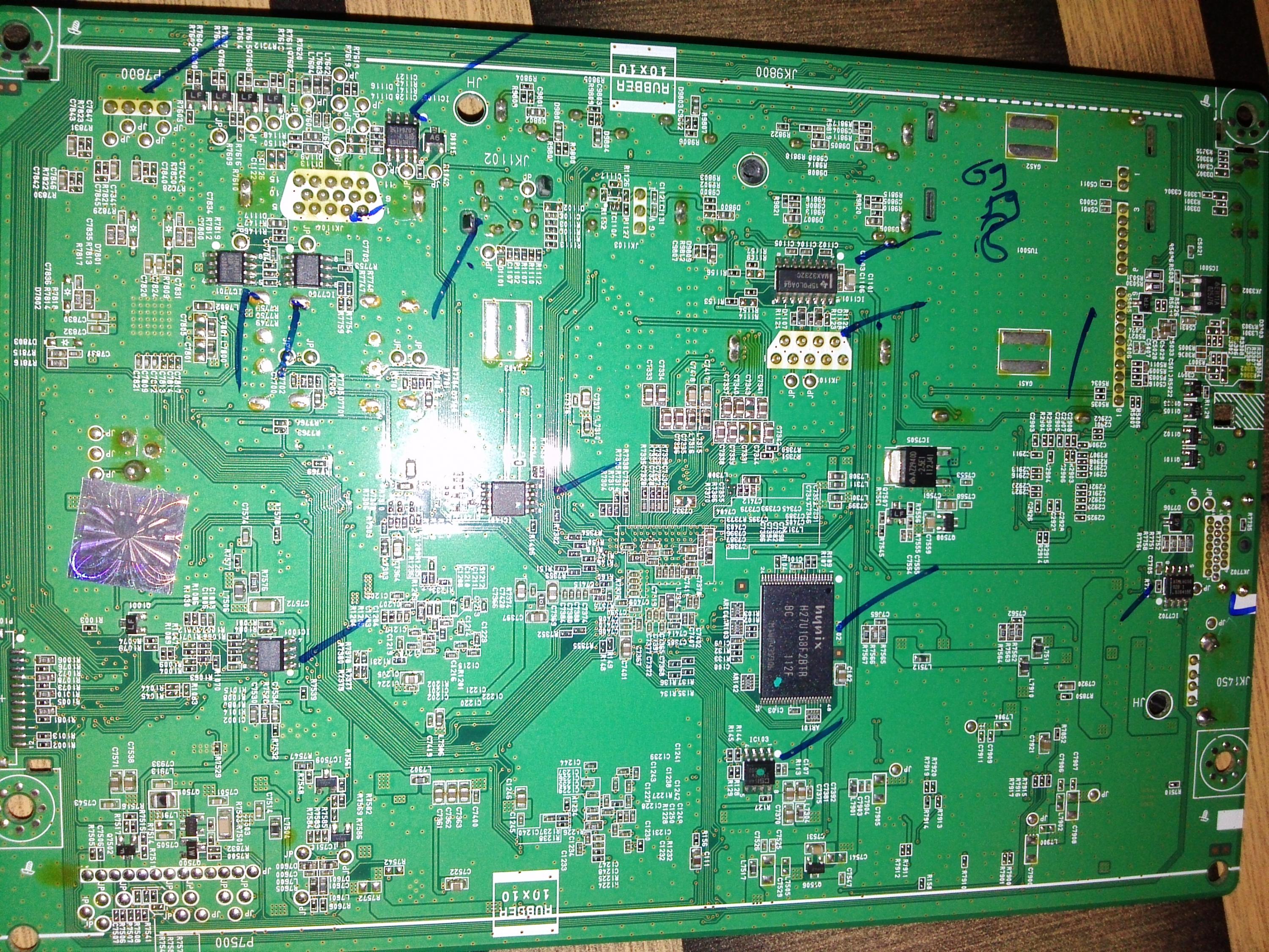

              Additional PCB Images

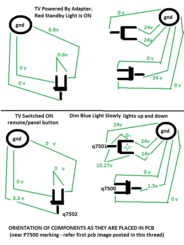

                  Here are the readings of the Q7500, Q7501 , Q7502, orientation as they appear in on the PCB. Thanks a lot for your time sir
                    Re: LG 26LE5300 Boot Loop after power surge hit
                    So you do have 24V with reference to GND Source and also at Drain pin of Q7501, so what is wrong with that? That is what it should have when it is turned on.
                    BTW, you do know how to read schematic, correct? And you do understand how Transistor and MOSFET work, correct?
                    I still do not understand why you have to make other measurement that are not reference to GND, no need to do that right now.
                        Resistors are almost always in parallel with a lot of things in the circuit,especially main boards,it's not a problem if they read less than their rated resistance,but more,for example this 120k reading 200k,that would mean it is defective.
                        These capacitors if not reading 0 OHM are probably good,sometimes they are in parallel with some processor silicon which measures kinda low resistance(5 OHMs or more generally).

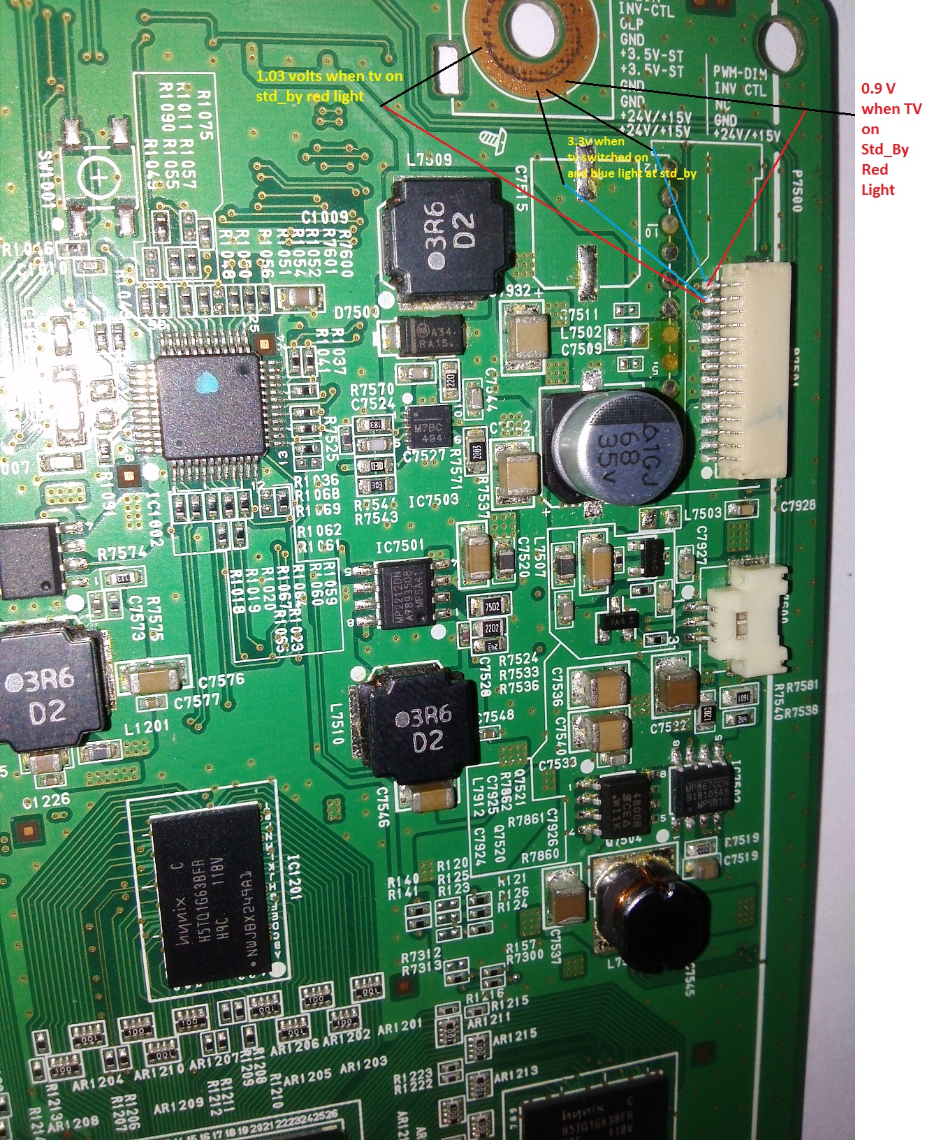

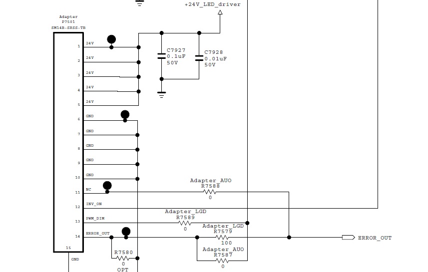

                                Referring to the connector P7501
                                ... the Pin 14 is at 3.3 volts when the TV is switched on (blue std_by light) this pin is Error_Out (output) to IC LGE 101D Error_Out (input at gpio 41).
                                This Pin 14 is at 3.3 volts even when the P7501 connector is not connected to the LCD_PANEL.
                                Pin 14 is at 0.9 volts when the tv is in std_by red light mode.
                                Pin 13 is at 1.03 volts when the tv is in std_by red light mode.
                                When the tv is completely off the Pin 14 to pcb Gnd measures 5.0Mega Ohms.
                                Is this also normal. I have attached the pcb as well as schema for reference.
