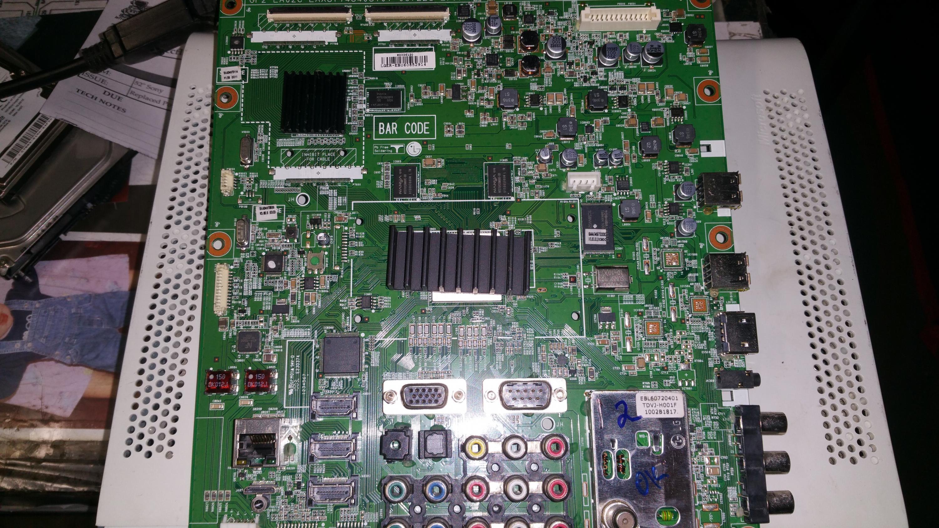

    Another firmware question....
    Got a really nice LG 55"... Powers up, backlights good.. Freezes at the LG Boot Up logo....
    I am thinking firmware issue..
    I have another identical board that has a display issue.. Thinking (hoping) that the firmware is good..
    Now to identify the firmware chip...
    Inspecting all the chips, an IC # caught my eye..
    24C02RP
    Turns out it's an 16Kbit, 8Kbit, 4Kbit, 2Kbit and 1Kbit Serial I²C bus EEPROM
    Would that be my firmware chip???

      Re: LG 55LD650 Display Good Won't Load Past LG Boot Screen.. Firmware??
      Don't think that's it.. I have had those B2 problems as well... But with mine, it was completely dead.. This LG comes up and works fine.. Just can't get past the bootup logo...

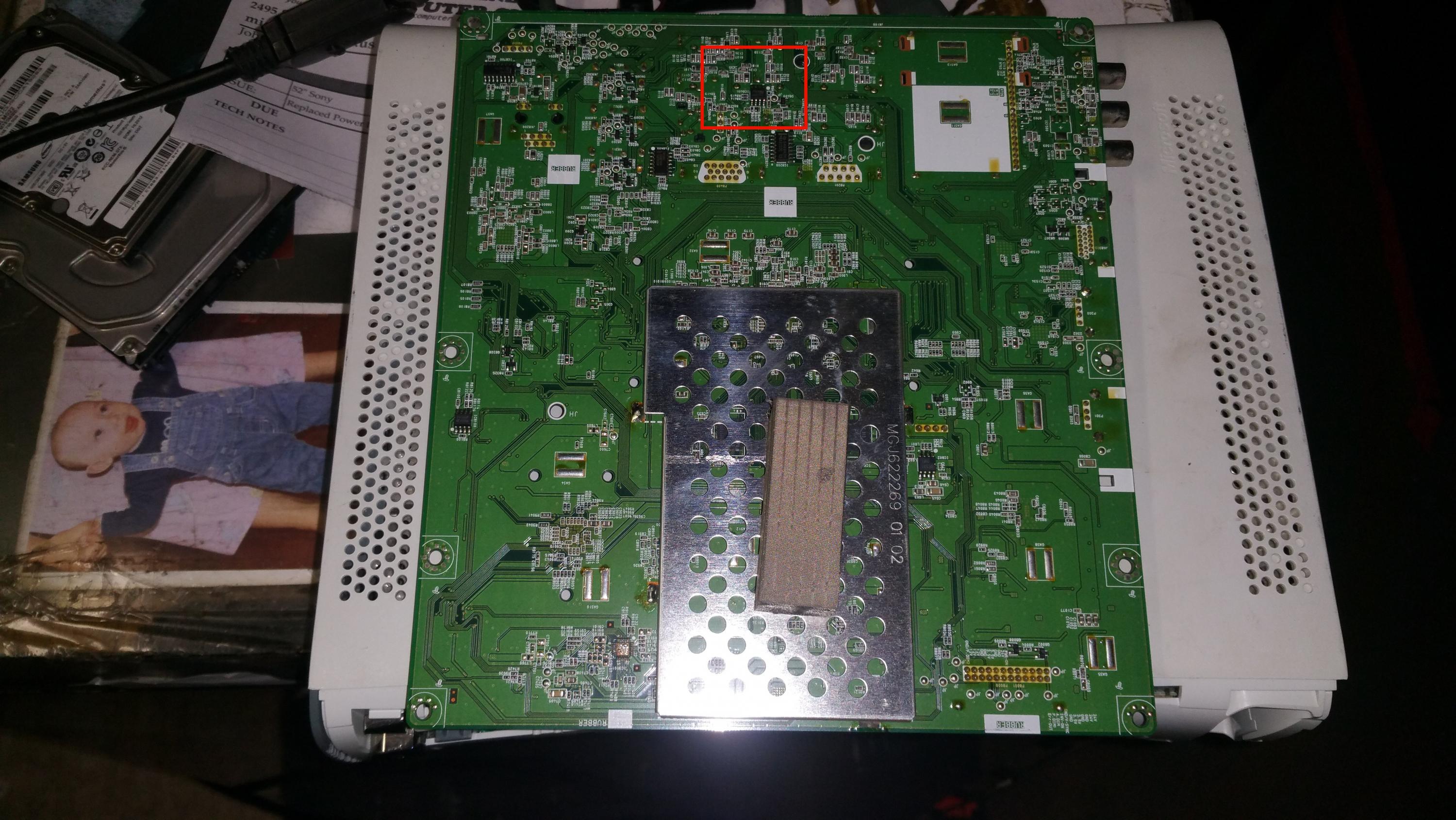

        Common problem with the XXLD560 and XXLD650 series.
        Reflow that square chip in the middle under the heatsink using a heat gun. If youre not sure how, im sure theres tons of other threads with the same problem.
          I would not have thought a reflow would be a possibility..
          I am a BIG fan of reflows.
          I'll give it a shot and report back..
            Well, I'll be deep'ed in sheet!! It worked!!
                  Glad to know you have the tools and ability to reflow.
                  However it's known that the problem often re-occurs. The initial cause is cracked solder joints under the BGA chip due to heat stress and a reflow is only a temporary fix.
                  LG used a small heatsink poorly contacted with tape adhesive for the cooling mechanism. You might want to use a liquid thermal adhesive instead to make good contact with the heatsink. And even better, swap the original heatsink for a larger one. Bear in mind that a larger heatsink might interfere with placing the rear panel back on.
